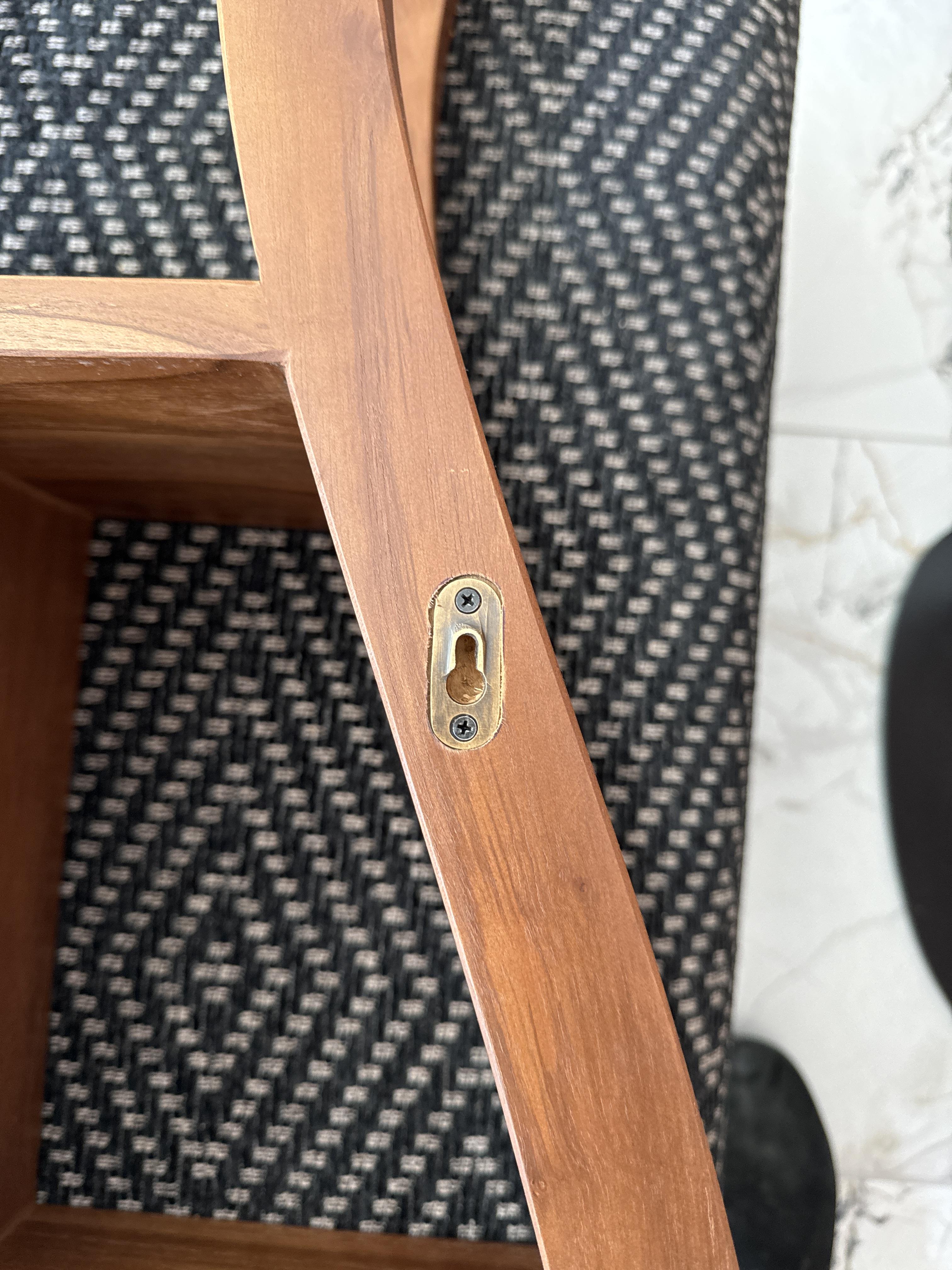

Pocster Posted June 8, 2024 Share Posted June 8, 2024 SWMBO ( ffs ) has ordered a wall mounted bookcase . It’s got these key hole fittings . Now I know ; no matter how hard I try to line these up exactly I’ve got no chance of getting it spot on . Is there a small wall fitting ( which would be hidden by the unit ) you mount but the sticking out ‘screw’ head can be adjusted in all dimensions ? . Maybe with a grub screw or small Allen key …. Link to comment Share on other sites More sharing options...
joe90 Posted June 8, 2024 Share Posted June 8, 2024 Large piece of cardboard covering the back of it, poke holes through marking the fixings, hold cardboard against the wall and mark for drilling 🤷♂️ 1 Link to comment Share on other sites More sharing options...

MikeSharp01 Posted June 8, 2024 Share Posted June 8, 2024 I would make a pattern from a piece of thin ply, say 6mm. Mark out the distances, drill a tiny hole and put a screw through the ply do it sticks out the other side a little. Then measure for the other screw, drill & fit another screw. Check the bookcase fits on the plywood then drill a very small hole in the wall. Lodge one of the sticking out screws in that hole and scribe a small arc, 5mm each way on the horizontal. with the other screw. Use a spirt level to get the horizontal from the small hole over to the arc, then drill the second small hole. 2 Link to comment Share on other sites More sharing options...

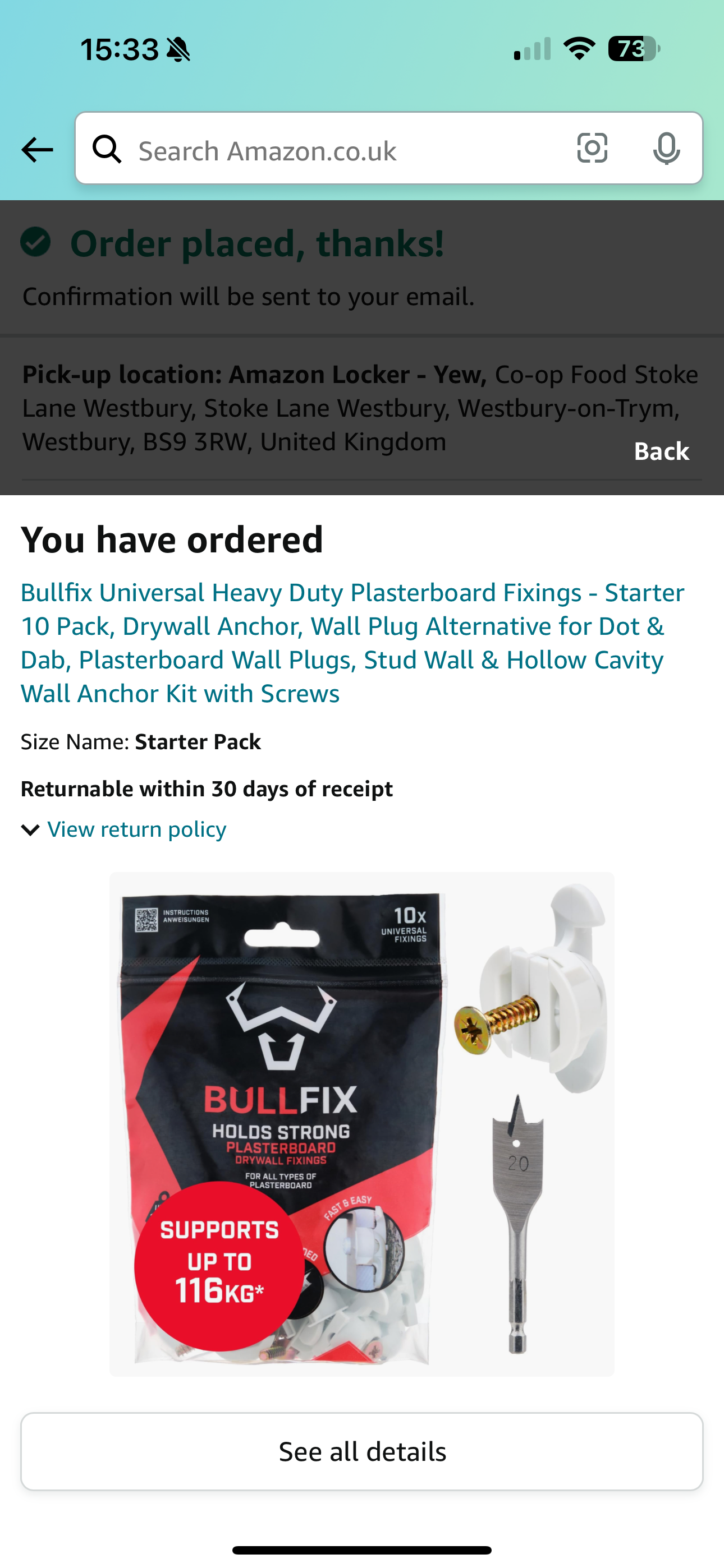

Pocster Posted June 8, 2024 Author Share Posted June 8, 2024 Thought I’d try these on the pb 1 Link to comment Share on other sites More sharing options...
joe90 Posted June 8, 2024 Share Posted June 8, 2024 40 minutes ago, Pocster said: Thought I’d try these on the pb Please report back as good fixings on PB are not easy (IMO) 1 Link to comment Share on other sites More sharing options...
Pocster Posted June 8, 2024 Author Share Posted June 8, 2024 6 minutes ago, joe90 said: Please report back as good fixings on PB are not easy (IMO) I won’t test the supposed 116kg limit !! 1 Link to comment Share on other sites More sharing options...
joe90 Posted June 8, 2024 Share Posted June 8, 2024 These are the best I have found and the screws are removable/demountable. https://www.screwfix.com/p/easyfix-hollow-wall-anchors-8-16mm-m5-x-52mm-10-pack/12229 Link to comment Share on other sites More sharing options...

garrymartin Posted June 17, 2024 Share Posted June 17, 2024 The problem with most of the plasterboard fixings is that they require something to be fitted flush to the plasterboard to hold the fitting in place, and you just want the screw to be poking out. Not an easy fix. You might be able to try something like a Rawlplug with the setting tool as they have a shoulder that will hold the fixing in place, but even that I'm not sure will work too well over time without anything hard up against it. On the subject of marking out, the best option I've found is to take a long enough spirit level and to mark in pencil where the two holes go. Then you can use the level to a) make sure it's level (!) and b) transfer the exact placement to the wall. 1 Link to comment Share on other sites More sharing options...

SimonD Posted June 17, 2024 Share Posted June 17, 2024 On 08/06/2024 at 15:34, Pocster said: Thought I’d try these on the pb I don't trust those. These are much, much better: https://www.tcfixings.co.uk/category/toggler-snaptoggle-plasterboard-anchors/1001 which I use to fix radiators to plasterboard. Or, I use these to fix towel rads to plasterboard (because they get pulled about with towels etc. which are solid as: https://www.geefix.com/ 1 Link to comment Share on other sites More sharing options...
