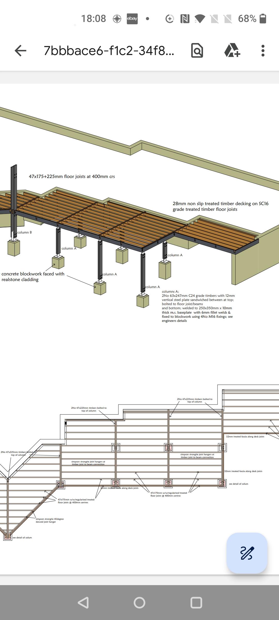

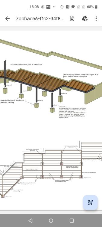

JohnMo Posted June 5, 2024 Posted June 5, 2024 A snippet of our drawings for our deck structure, we moved the hill about instead of a big support structure. Fairy simple steel, galvanised and wood between. 1
JohnMo Posted June 5, 2024 Posted June 5, 2024 On 05/06/2024 at 16:56, Lift span said: At 1.5 m high Expand You really should be getting a structural design done for the decking and the balustrade structure. Didn't realise the fall was quite that much. You have several issues Decking lift in the wind Balustrade wind and protection loadings Decking collapse due to loading or pulling away from the ledger board To name a few

Lift span Posted June 6, 2024 Author Posted June 6, 2024 (edited) On 05/06/2024 at 17:11, JohnMo said: A snippet of our drawings for our deck structure, we moved the hill about instead of a big support structure. Fairy simple steel, galvanised and wood between. Expand The more I look at this the more I like it! What’s the maximum height of those columns in your deck? Thanks. Edited June 6, 2024 by Lift span
JohnMo Posted June 6, 2024 Posted June 6, 2024 I think some of the where about 3 to 4m. But we have a similar arrangement holding down our roof overhang and they must be about 7 to 8m. On 06/06/2024 at 09:28, Lift span said: The more I look at this the more I like it! What’s the maximum height of those columns in your deck? Thanks. Expand 1

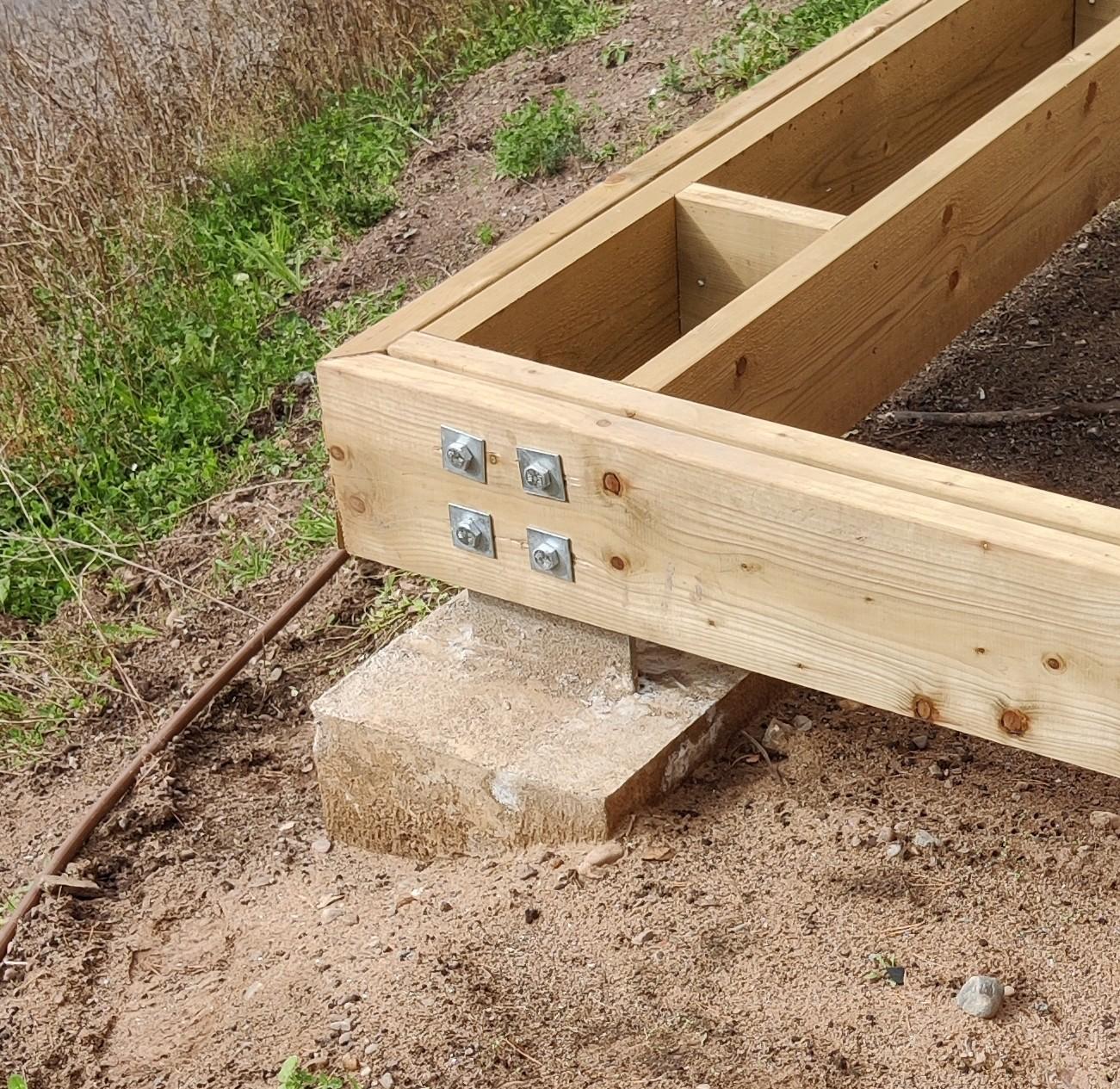

Lift span Posted June 6, 2024 Author Posted June 6, 2024 Here are some photos just to give some perspective. Vertical supporting posts would be around left hand side of that scaffolding.
Iceverge Posted June 6, 2024 Posted June 6, 2024 A picture paints 1000 words. Ok, the slope isn't mega. I had visions of a cliff like fall. Also your access is pretty good. Looking at your sketches I would be concerned about the maintenance of the wood that near to all that vegetation. Also I would be worried that the crawlspace would be a haven for undesirable wild life. Could something like building up the ground into a patio work instead? 1
