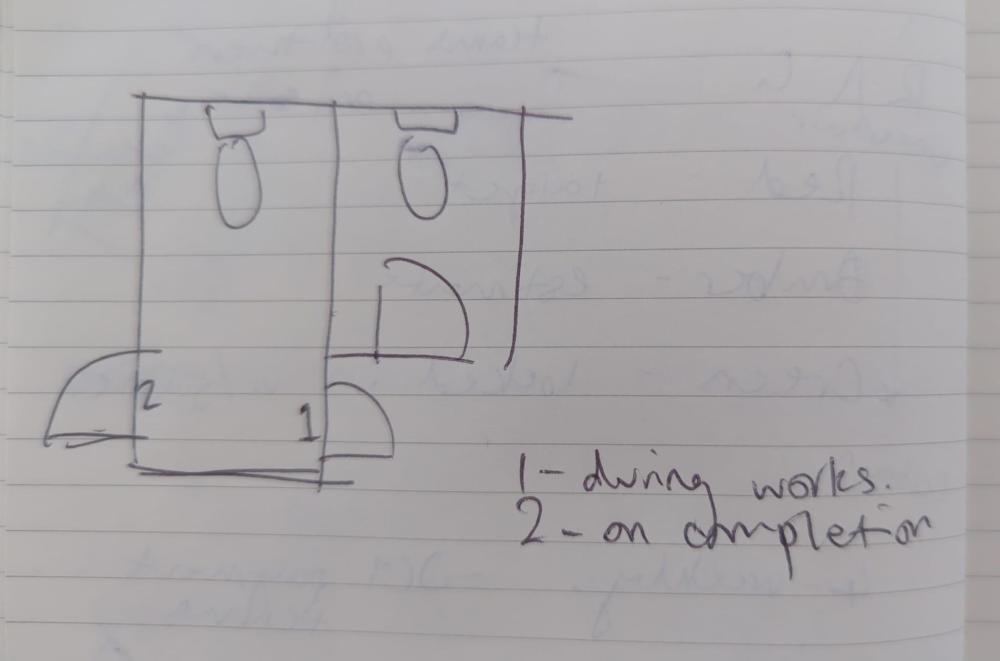

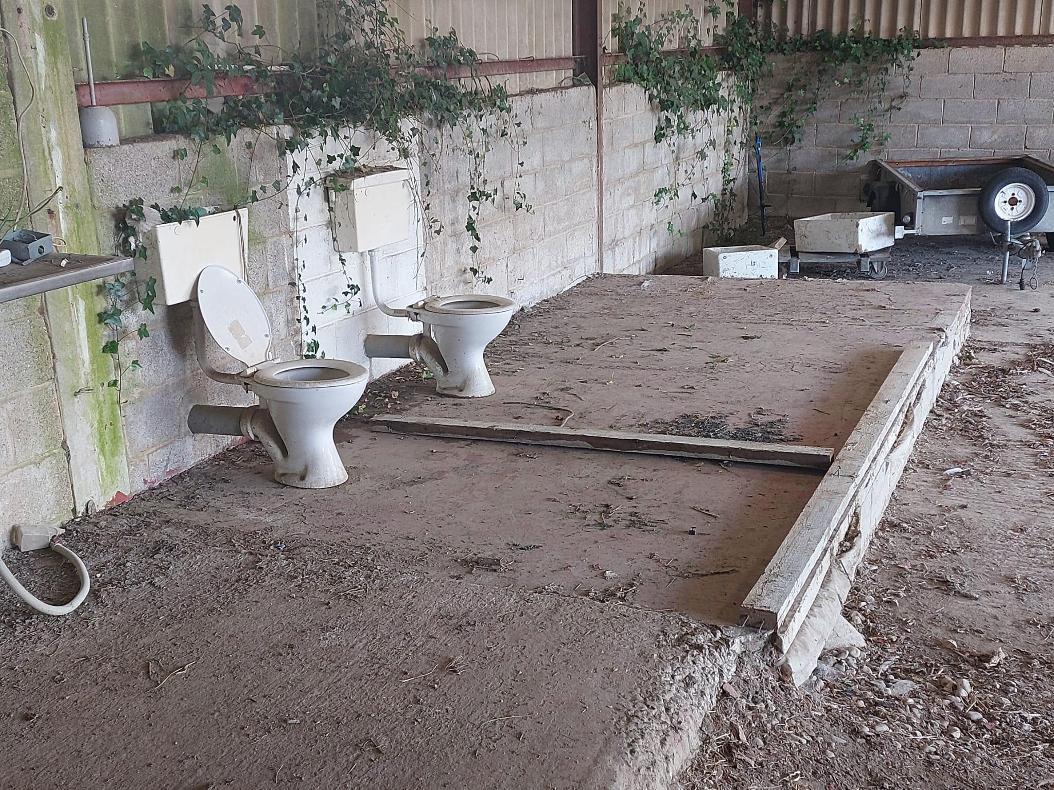

saveasteading Posted June 4 Share Posted June 4 I'm going to knock up a temporary toilet block in an outbuilding. There are already a pair of wc s with no enclosure, connecting to a 'country' septic tank , but they are scabby so I will use new wc s. It will be the site toilets and then eventually become one garage and one garden facility. Stud and osb walls, no need for ceilings, but maybe a couple of joists to stop it rattling. 2 salvaged doors. No fancy inner decoration at this stage. Stud in 38 x 63 seems flimsy so perhaps go for 38 x 89. £50 more. Am I being conservative here? OSB in 18mm or 11mm. I'm thinking 11mm is enough. £110 difference. perhaps the thinner osb should be screwed on rather than use a nail gun. I have to set an example in economy here, plus I actually want to keep the costs down, but a wobbly old thing will do the opposite. Link to comment Share on other sites More sharing options...

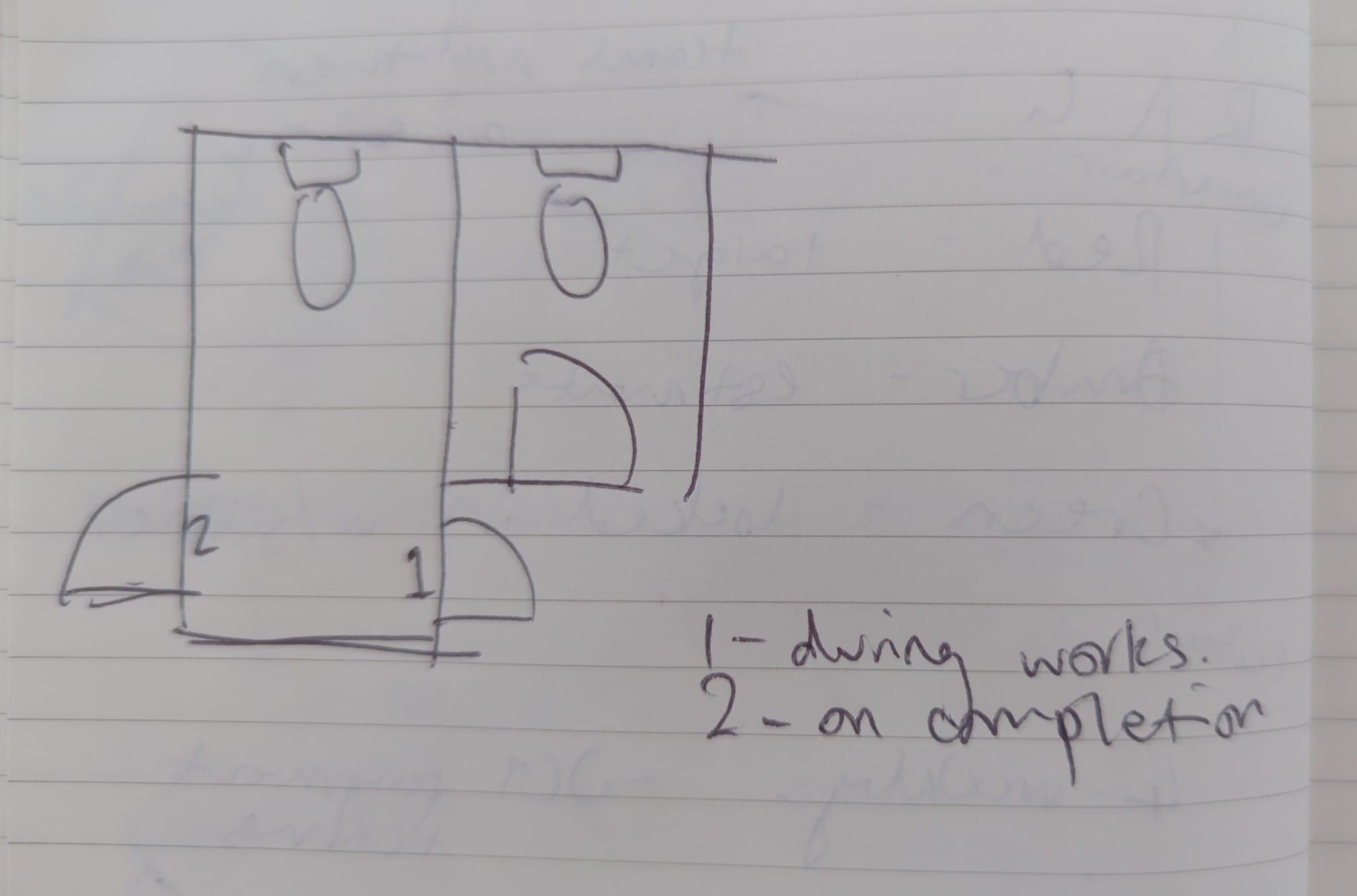

saveasteading Posted June 4 Author Share Posted June 4 1. Scope for improvement. 2. detailed design. Actually we will carry on right across to where the trailer is. as a cubby hole. Link to comment Share on other sites More sharing options...
SimonD Posted June 4 Share Posted June 4 1 hour ago, saveasteading said: 1. Scope for improvement. 2. detailed design. Actually we will carry on right across to where the trailer is. as a cubby hole. I'd go 38 x 89 at 600c/c and use 11mm OSB with a sole plate especially if you carry across. Change door no. 1 to inward opening so there is no risk of someone going into or coming out of to other loo getting smacked by outward opening door. Question for the BH masses - do any toilet doors open outwards? Link to comment Share on other sites More sharing options...
