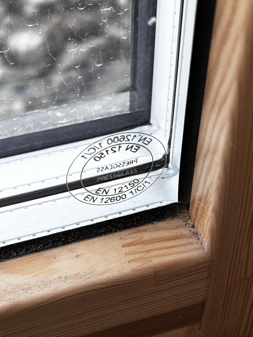

Mr Blobby Posted May 24, 2024 Share Posted May 24, 2024 Our recently installed internorm widows include some with low-G glazing units and some laminated units to reduce noise by a few dBA. How do I know if they are installed the right way round, with the outside pane on the outside? I can't see any obvious markings on the glazing so how would the window fitters know which way round to insert the glazing units into the frame? Link to comment Share on other sites More sharing options...
Kelvin Posted May 24, 2024 Share Posted May 24, 2024 (edited) It should have a kite type mark on the inside pane like this. Excuse the dust as still sanding and painting 😭 Actually ours has that on both sides so that doesn’t help! All of our glazing units have a slight blueish/purple tinge on the outside pane which is presumably the Low E coating. Edited May 24, 2024 by Kelvin 1 Link to comment Share on other sites More sharing options...
Mr Blobby Posted May 24, 2024 Author Share Posted May 24, 2024 (edited) 1 hour ago, Kelvin said: It should have a kite type mark on the inside pane like this. Ours seem to have window specification codes on both the inside and outside panes. No kite marks. So not so easy to figure out, unless of course I've missed some small markings somewhere. I'd post a picture I took earlier to explain better but I left my phone in the builder's van. 🙄 Edited May 24, 2024 by Mr Blobby Link to comment Share on other sites More sharing options...
Mike Posted May 24, 2024 Share Posted May 24, 2024 5 hours ago, Mr Blobby said: How do I know if they are installed the right way round, with the outside pane on the outside? If you have a low-e coating on one pane, you can shine a LED light through the glass and work out which layer the reflection is coming back from (it will have a different colour). If you specified a pane of toughened or laminated glass, then it should have a marking similar to @Kelvin's photo. Otherwise you'd need a specialist laser-based detector. I do remember some old research saying that it wasn't uncommon for units to be fitted the wrong way round. So worth checking if you can. Link to comment Share on other sites More sharing options...
craig Posted May 25, 2024 Share Posted May 25, 2024 European glass will likely be marked on the spacer bar and not on the glass, some will. Link to comment Share on other sites More sharing options...
Dan F Posted May 25, 2024 Share Posted May 25, 2024 (edited) Sometimes you can tell based on spacer sizes. If the glass is say (3+1+3:/18/4/16/:4 Ar 90%) then you can check the wider spacer is on the outside. Edited May 25, 2024 by Dan F Link to comment Share on other sites More sharing options...
Alan Ambrose Posted May 26, 2024 Share Posted May 26, 2024 I replaced some DGUs recently. They came with big stickers with the spec on and a big ‘this side out’ notice. Suggest a proper supplier like Internorm would probably do something similar. Link to comment Share on other sites More sharing options...
Kelvin Posted May 26, 2024 Share Posted May 26, 2024 22 hours ago, craig said: European glass will likely be marked on the spacer bar and not on the glass, some will. Yes ours is European and is marked both on the spacer bar and the glass. Link to comment Share on other sites More sharing options...
