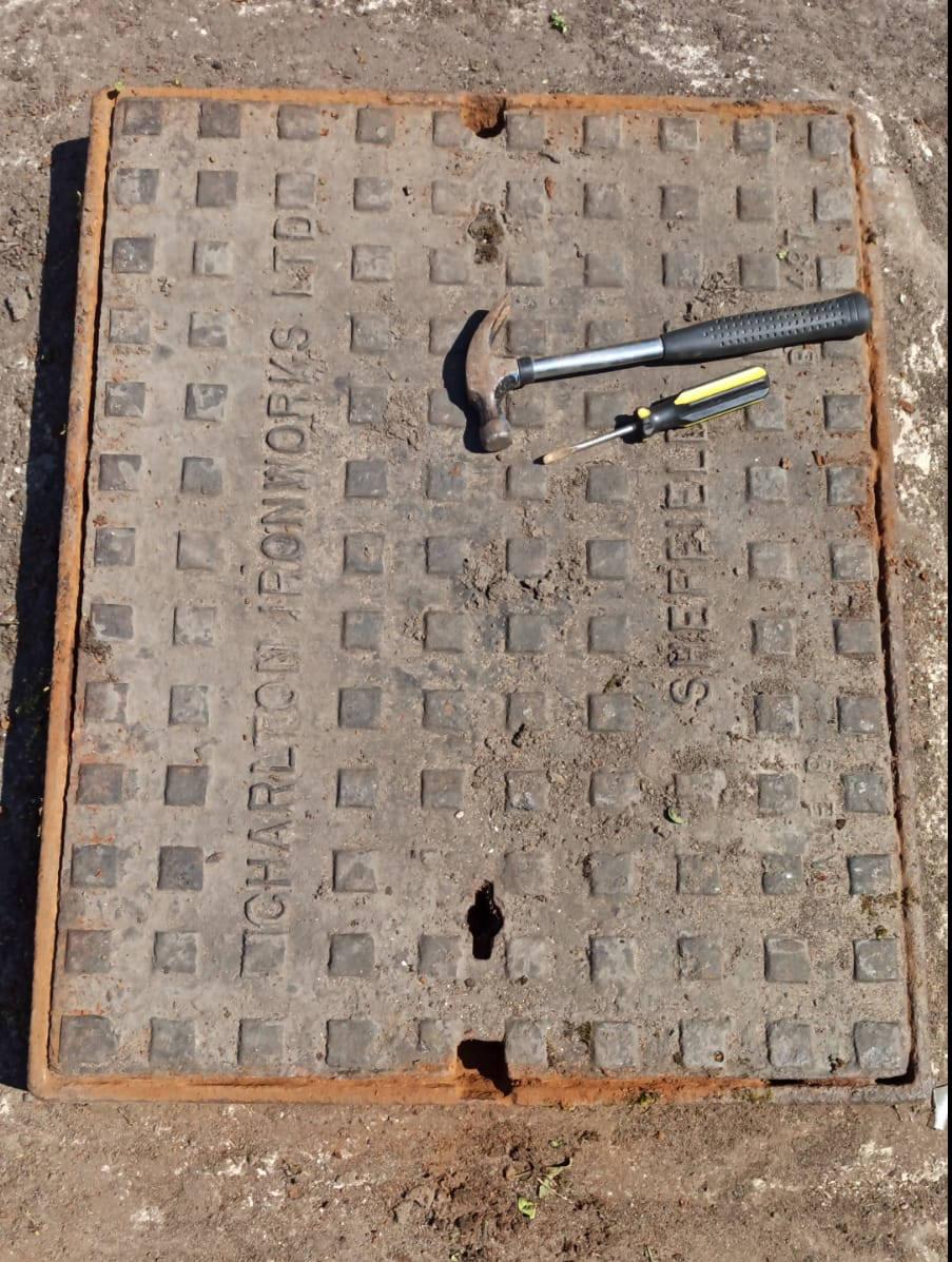

JohnBishop Posted May 19 Share Posted May 19 (edited) Hi All, I hope you are well. I hope you are enjoying premature summer in England, Scotland and Wales. I hope it stays like that. If I didn't have enough on my plate already I commenced the work in my front yard. I started restoring the fence but then I realised there is too much overgrown grass to clean it properly so the thick lawn carpet intertwined with moss has been taken off. I think I turn it into a driveway. I reckon 4/5 of these 40sqm is going to be grid and stone/gravel then 1/5 grass and a small tree or something like that. We need to put a retaining wall (dwarf wall) to keep it level. I think it would be good to improve the drainage a bit so I am thinking about the soaker way, potentially join it together with the existing one that goes under the concrete. I also have this big lid that was installed I reckon when the house was build ~80-90 years ago. It goes at a weird angle. Not sure what is the purpose. The sewage goes on the other side of the building. It looks like it's rust bonded. What would you recommend to use (e.g. a chemical). Ideally I don't want it to break in case it's still in use. The lid is at an awkward angle but it's also the cast iron bit is above the pavement level. I can see some people have these large trailers parked in their front yards. I think I I do the same and park it where "TRAILER" is written. The trench you see on the picture is the Internet cable. I have to figure out if I put it deeper under the soaker way or above it. I am not sure if I have enough slack on it. Please feel free to make any suggestions at this stage. Thank you Edited May 19 by JohnBishop Link to comment Share on other sites More sharing options...

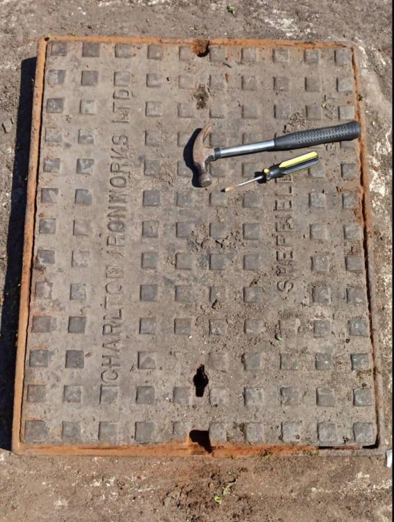

Mr Punter Posted May 19 Share Posted May 19 You will probably need consent from the local council to make this into a driveway. You may also need to have the kerb dropped at the road edge of the footpath and the path resurfaced, all by an approved / fully insured contractor. Try harder to lift the chamber lid. A couple of long lifting keys will help. 1 Link to comment Share on other sites More sharing options...
JohnBishop Posted May 19 Author Share Posted May 19 3 hours ago, Mr Punter said: You will probably need consent from the local council to make this into a driveway. You may also need to have the kerb dropped at the road edge of the footpath and the path resurfaced, all by an approved / fully insured contractor. Try harder to lift the chamber lid. A couple of long lifting keys will help. do you work for the council by any chance? 😁 Link to comment Share on other sites More sharing options...

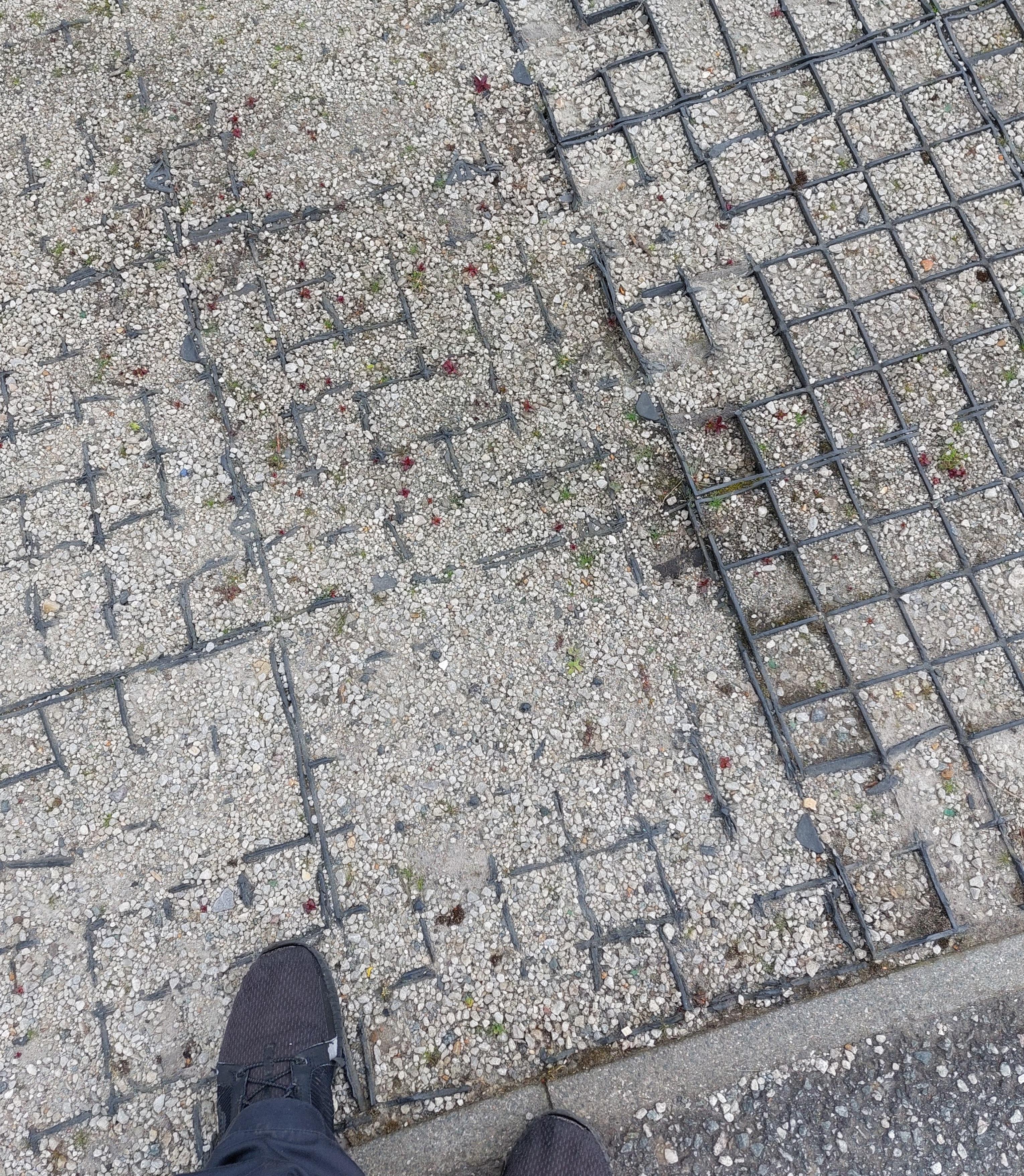

saveasteading Posted May 20 Share Posted May 20 12 hours ago, Temp said: some makes last longer than others when driven over regularly. I'm currently organising maintenance on grids that have been car parking for 15 years. There is quite a lot of damage to the top, say 10mm, and some areas of slight sinking. Compared to tarmac or concrete, I'm really happy with it. With regular maintenance in topping up the gravel, it would have incurred less damage. Underneath is type I but it slopes to a French drain. This photo is the worst area by far as it had most use. The gravel was larger when originally laid. 1 1 Link to comment Share on other sites More sharing options...
JohnBishop Posted May 20 Author Share Posted May 20 (edited) 37 minutes ago, saveasteading said: I'm currently organising maintenance on grids that have been car parking for 15 years. There is quite a lot of damage to the top, say 10mm, and some areas of slight sinking. Compared to tarmac or concrete, I'm really happy with it. With regular maintenance in topping up the gravel, it would have incurred less damage. Underneath is type I but it slopes to a French drain. This photo is the worst area by far as it had most use. The gravel was larger when originally laid. right, where did you source the grid? I can see some grids have their own barrier so the gravel does not mix with the sand and MOT aggregate underneath. You said about French drain. What would you recommend? In my case the house is sitting pretty much on sand - no clay so I should not be too paranoid about rainwater however I would want to reduce moisture around the house by implementing this French drain or these plastic/aluminium drains. On the picture the soil on the surface is not original, it has been accumulated by previous owners over the many years which is great if I go for grass otherwise only moss and some weeds grow on the sand. The front yard point in the direction of north-north-west. The bottom of the trench is sand. I will have to remove some of the soil, quite a lot of it and replace with MOT. I am thinking if I need the retaining wall all the way or only where the aggregate/grid is going then slope it down where the grass is going to be. Initially I though about building the wall about a foot away from the concrete but now I think I bring it closer. The gap will only be for the French drain or other drain. Edited May 20 by JohnBishop Link to comment Share on other sites More sharing options...

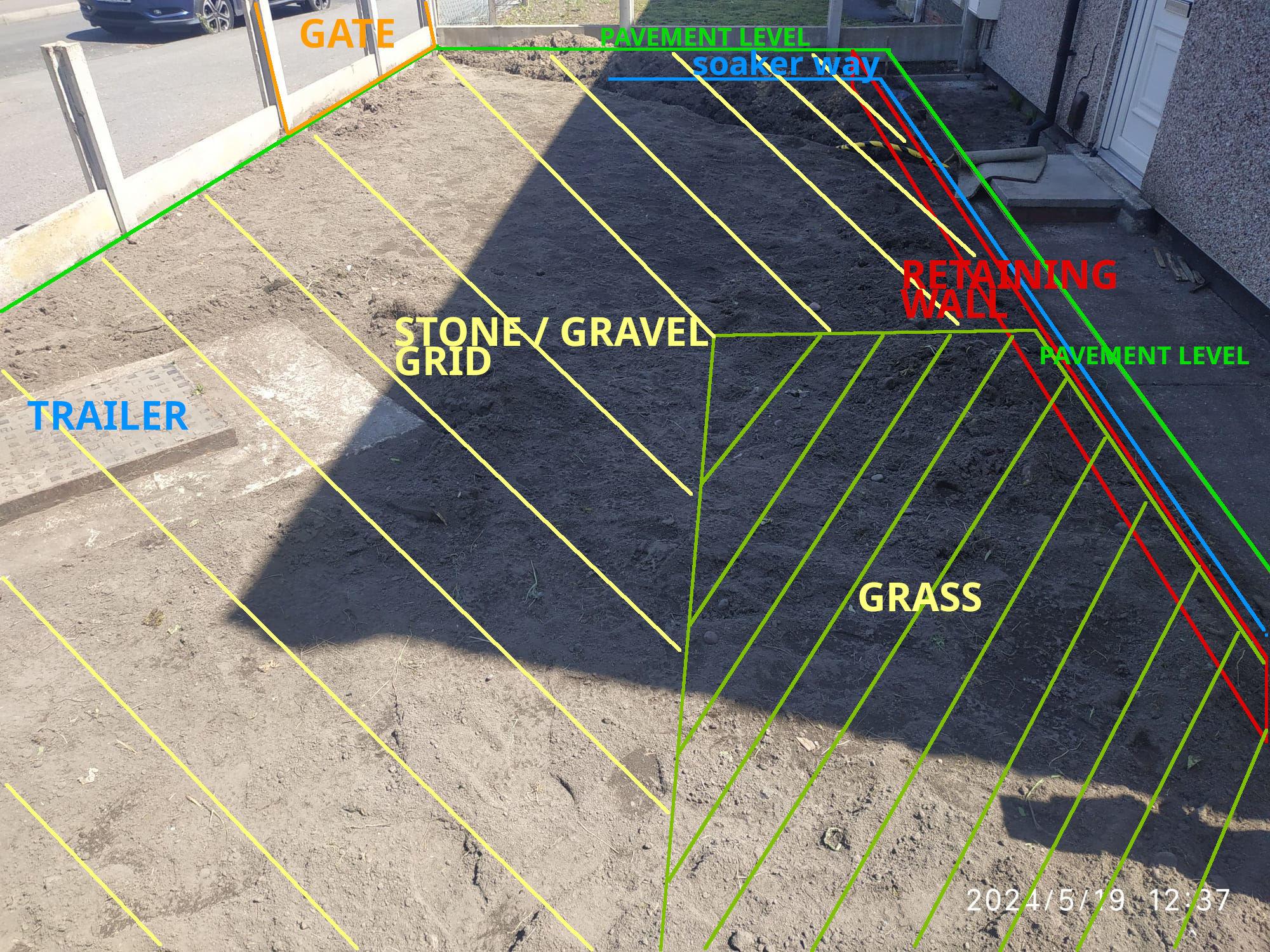

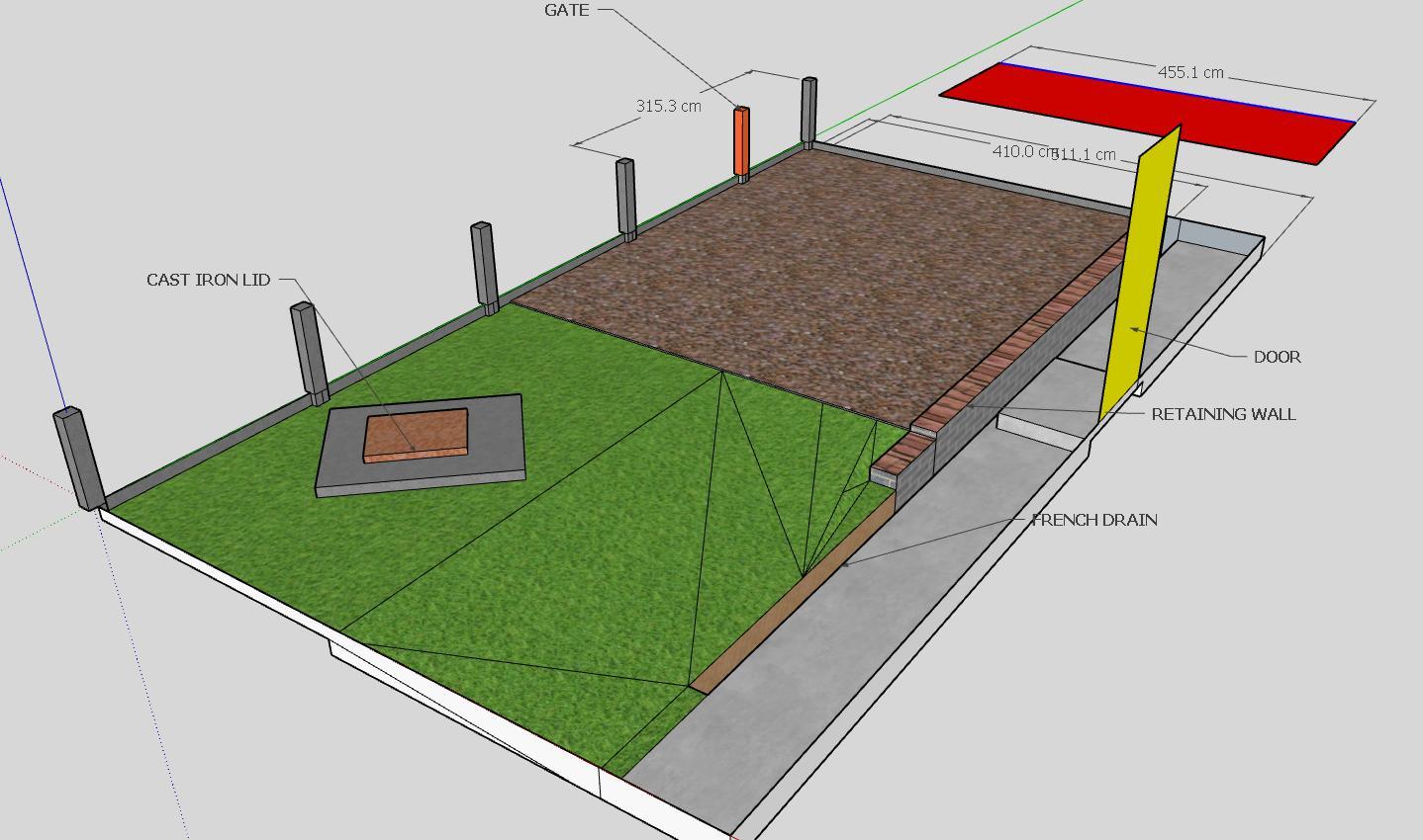

JohnBishop Posted May 22 Author Share Posted May 22 (edited) This is what I have come up with. The existing soaker way goes perpendicular towards the gate (on the other side of the door pedestal), I reckon it connects with that drain somehow but I am still waiting for the lid keys to open it. I also poured some coke over it few times hoping it will dissolve the rust. It looks like it's bonded solid. It is at an angle which is a bit strange. The other thing is that this French drain between the retaining wall and the existing concrete is taking space. The car is 455cm so it will be sticking out over the retaining wall or parked at an angle. Do I really need it? Or should I make it narrower e.g. 5cm rather than 15cm. Edited May 22 by JohnBishop Link to comment Share on other sites More sharing options...
saveasteading Posted May 22 Share Posted May 22 Soakaway must not connect to a main drain. The whole point is that your drain doesn't reach streams or sewers and add to flooding. It all adds up. 1 Link to comment Share on other sites More sharing options...
JohnBishop Posted May 23 Author Share Posted May 23 22 hours ago, saveasteading said: Soakaway must not connect to a main drain. The whole point is that your drain doesn't reach streams or sewers and add to flooding. It all adds up. Right so soakaway is a dead way. The sewage line is on the other side of the building so still wondering what is this manhole for. What flexible pipe should I use for the French drain? How is it called? Link to comment Share on other sites More sharing options...

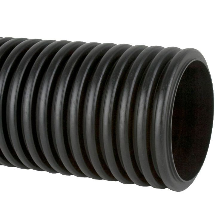

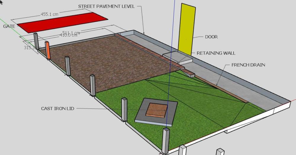

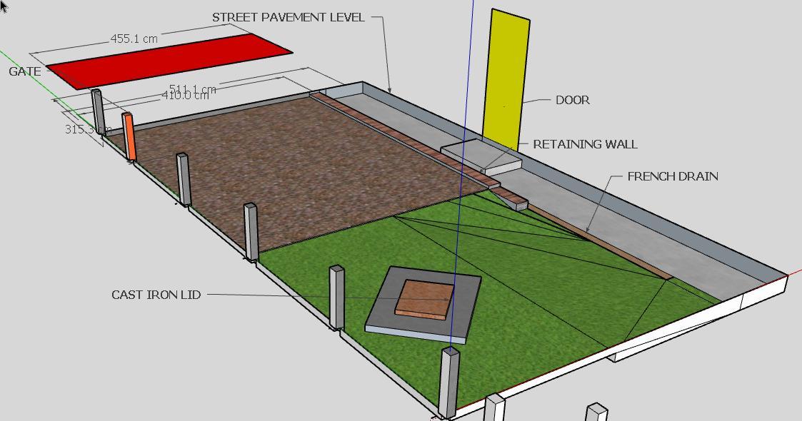

JohnBishop Posted May 23 Author Share Posted May 23 (edited) In this article I can see the spec for a retaining wall https://www.pavingexpert.com/featur03#retain I can see I need a drainage board. This wall is going to be ~25cm high + 15cm concrete footing. Should I use bricks (using English or Flemish bond) or blocks and decorative bricks on top? I mean apart from visual difference is there any structural difference? I understand the retaining wall should be at least 20cm wide (2 bricks bonded or a block). Edited May 23 by JohnBishop Link to comment Share on other sites More sharing options...
saveasteading Posted May 23 Share Posted May 23 7 hours ago, JohnBishop said: What flexible pipe should I use for the French drain perforated drain pipe there is posh stuff that allows precise flow, and there is cheap stuff that is tricky to get exact. wrap it with geomembrane so that roots and silt don't get into the pipe, then surround in gravel. 1 Link to comment Share on other sites More sharing options...
JohnBishop Posted May 23 Author Share Posted May 23 (edited) 1 hour ago, saveasteading said: perforated drain pipe there is posh stuff that allows precise flow, and there is cheap stuff that is tricky to get exact. wrap it with geomembrane so that roots and silt don't get into the pipe, then surround in gravel. what geomembrane for domestic use? this is not a weed barrier right? I have some thick weed membrane left. Is it something I can get from a DYI store or better order online? I will order the pipe online as this will not fit into my car anyway. Edited May 23 by JohnBishop Link to comment Share on other sites More sharing options...
