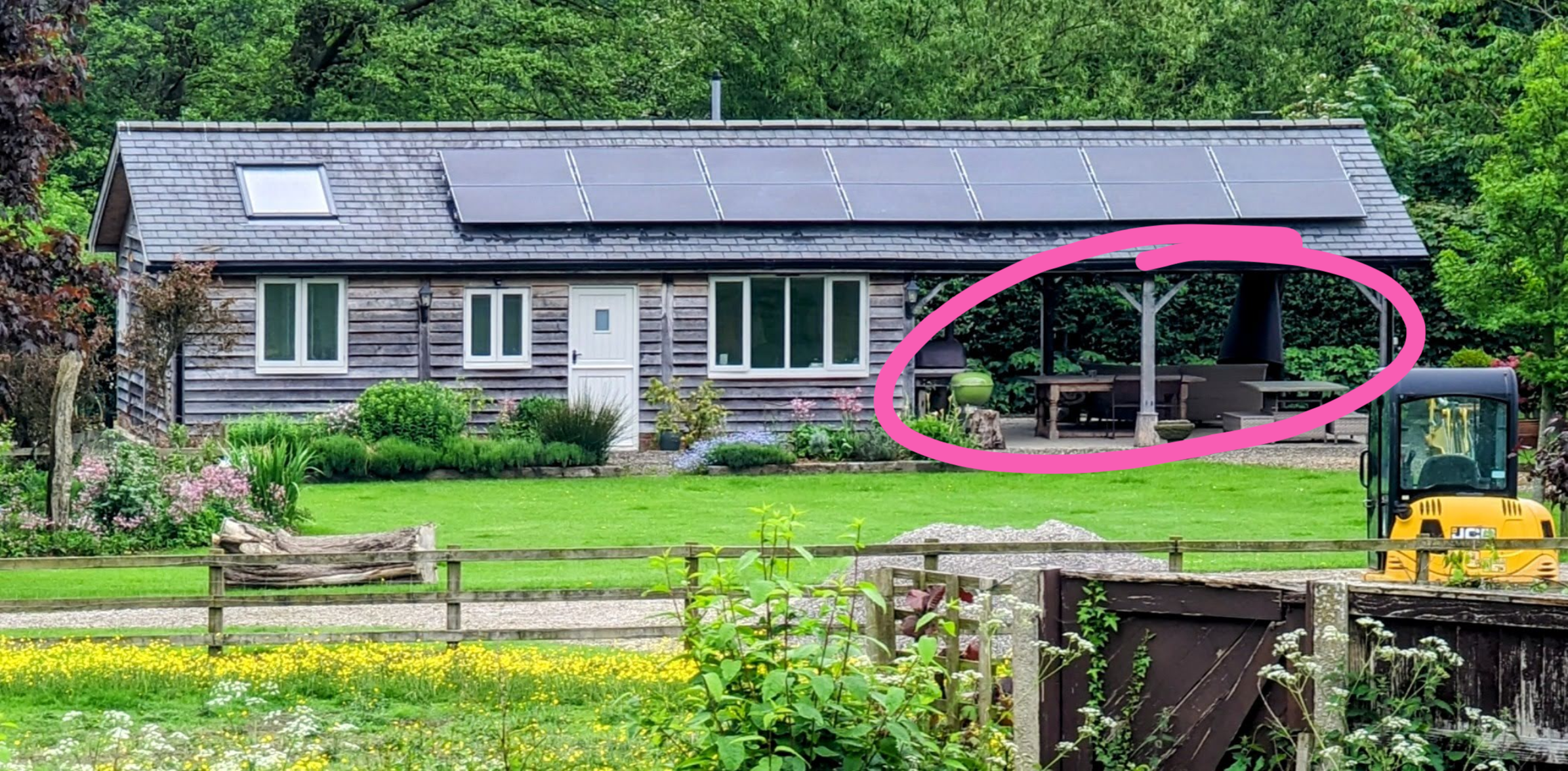

Permitted Development and covered area
Have a look at this image please ...
Does the covered area (highlighted) count towards the calculation of the '... total area of ground covered by building ... '
There's a bit of me that says - it is , and a bit of me that says it isn't.
What do you think?

From the planning portal……
The rules governing outbuildings apply to *sheds, greenhouses and garages as well as other ancillary garden buildings such as swimming pools, ponds, sauna cabins, kennels, enclosures (including tennis courts) and many other kinds of structure for a purpose incidental to the enjoyment of the dwelling house. This includes a container used for domestic heating oil or petroleum gas.
So I believe it is counted as “area covered by building….”
p.s. surprised me a tennis court was also counted 🤷‍♂️

Any covered area attached to a garden building is included in the building floor area, I’m guessing this is to prevent 36sq/m garages having another covered space at the side.
