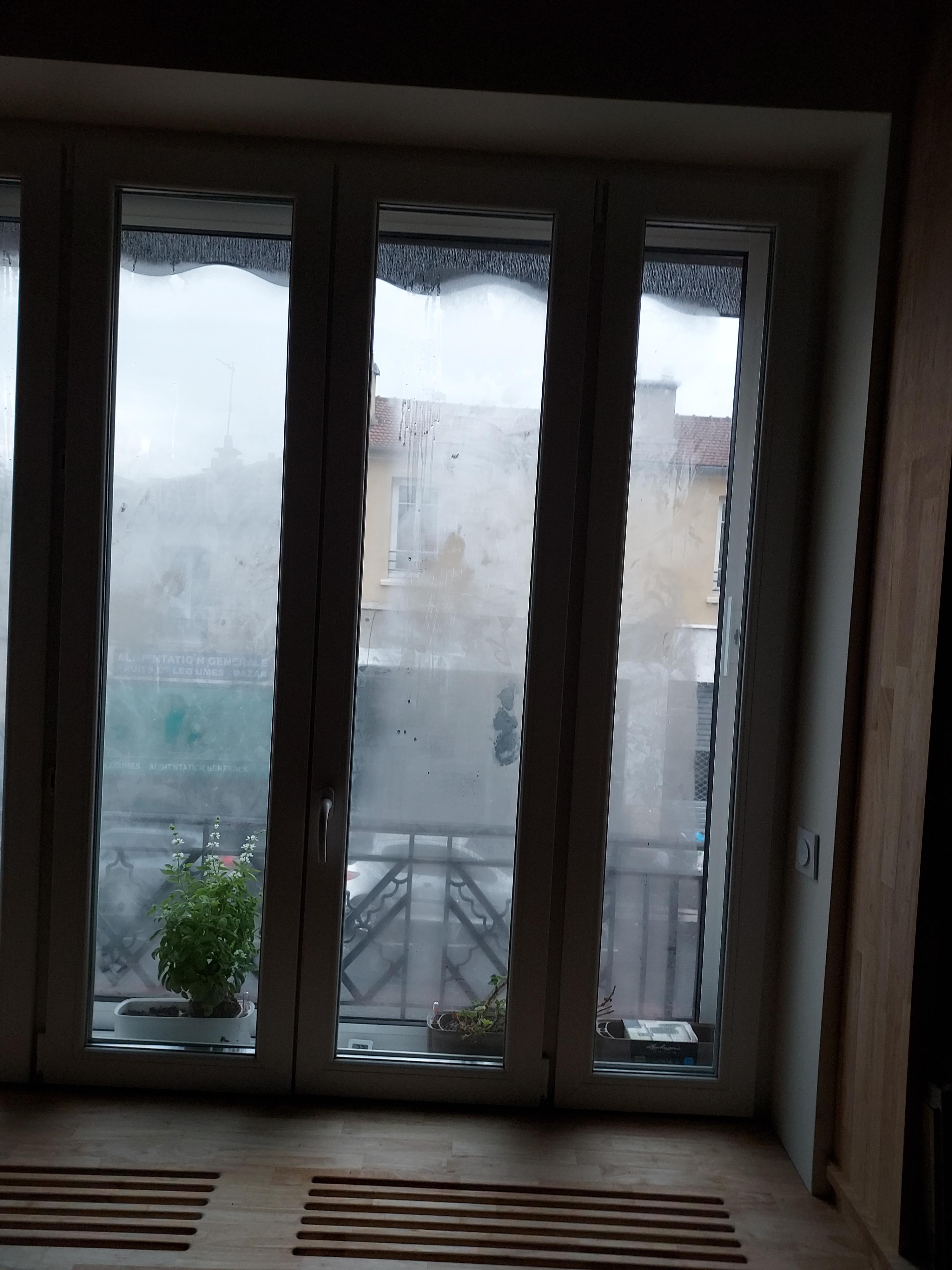

Garald Posted May 17, 2024 Posted May 17, 2024 As you know, I have two identical double windows now. (Double glazing on the inside, 18cm space (which I have lined with 2cm cork on all sides, for sound absorption), thick single glazing on the outside.) One has condensation on the outer pane, the other one not. This is obviously a problem I need to solve. What could be the reason? I imagine that the two windows must not be really identical. I can think of two possibilities: (a) in the "bad" window, there is a ventilation exit (from the space between the windows to the outside world) that is blocked or never existed in the first place, or (b) in the "good" window, there is a ventilation exit from the room to the space between the windows that is blocked. Any other possibilities? (For what it is worth, I have PIV - positive-input ventilation: that is, air is drawn in by a fan, and expelled by ventilation exits that are discretely tucked into window frames and the like.. Or so the builder tells me - I can never find them. Not sure the folks who installed the outer windows really understood this (though I've been asking them, to no avail). I do not know whether this is the issue or a red herring.)

Garald Posted May 18, 2024 Author Posted May 18, 2024 (edited) Huh. Left hygrometers/thermometers inside each inter-window space, and the results are not at all what I expected! "Good" window (no condensation): 29.2 C, 74% humidity "Bad" window (condensation) 34.8 C, 52% Temperature indoors: 22.5C Temperature outdoors: 18C Small basil plant in the "bad" window, a pelargonium and a sad geranium in the "good" window. Edited May 18, 2024 by Garald
Garald Posted May 18, 2024 Author Posted May 18, 2024 90 minutes later: "Good" window: 39.5 C, 57% "Bad" window: 43.3 C, 42% Temperature indoors: 23 C Temperature outdoors: 19 C
Alan Ambrose Posted May 18, 2024 Posted May 18, 2024 Hmmm interesting - if I understand correctly that means the good window's dew point is ~30C and the bad window ~25C. That is, with outdoors temps at 19C (and the inside of the outside pane approximately the same) you should have condensation in both. But that's assuming that the RH doesn't change inside each window as air moves in and out through heat expansion/contraction. I guess the numbers at say 3-4am (when it's coldest) would be most indicative. When DGUs fail the condensation gathers and generally stays once the seal is broken. Maybe that's what's happening here. In any case, I think the easily available options are either silica gel (and maybe a better seal) or maybe venting the void better. I should say that this isn't my subject though More knowledge people will be along shortly...
Garald Posted May 19, 2024 Author Posted May 19, 2024 (edited) I am now (on a cloudy day, 17C outside) getting almost identical readings on both windows: "Bad" window: 22.8C, 79% humidity "Good" window: 23.5C, 78% humidity - and yet: fresh condensation has set on the inside of the "bad" outer window, and not on the good window! I can try switching the basil and the pelargonium. Waiting for the more knowledgeable people to chip in Edited May 19, 2024 by Garald

Garald Posted May 20, 2024 Author Posted May 20, 2024 Wow. I left the plants switched overnight, and now the "good" window (which now has the basil plant between the two panes) has condensation, and the "bad" window does not! "Good" window with basil plant and condensation: 27.2C, 83% "Bad" window with pelargonium and no condensation: 32.2C, 51%
Alan Ambrose Posted May 20, 2024 Posted May 20, 2024 Well that's wacky, but congrats on the scientific method. >>> basil plant between the two panes Ah, the plants are *between* the DGU and the single glazing? Well they do do the transpiration thing of course.
Garald Posted May 20, 2024 Author Posted May 20, 2024 (edited) Update: the window that now has the pelargonium has some condensation... and the one that now has the basil (and before had no basil and no condensation) now has a stunning amount of condensation (and a stunning 91% humidity at 21.9C). Basil plants are apparently transpiration monsters. Edited May 20, 2024 by Garald

Garald Posted May 21, 2024 Author Posted May 21, 2024 50 minutes ago, Alan Ambrose said: Maybe you can find some commercial use for that hard won knowledge Hah. If I remember correctly, one of the clauses of my job as a French civil servant is that I should not have another career at the same time, with a single exception: writer. More seriously - I've now put the basil plant outside the kitchen window. An alternative would have been to pair it with a plant that thrives in humid conditions - an orchid perhaps?
