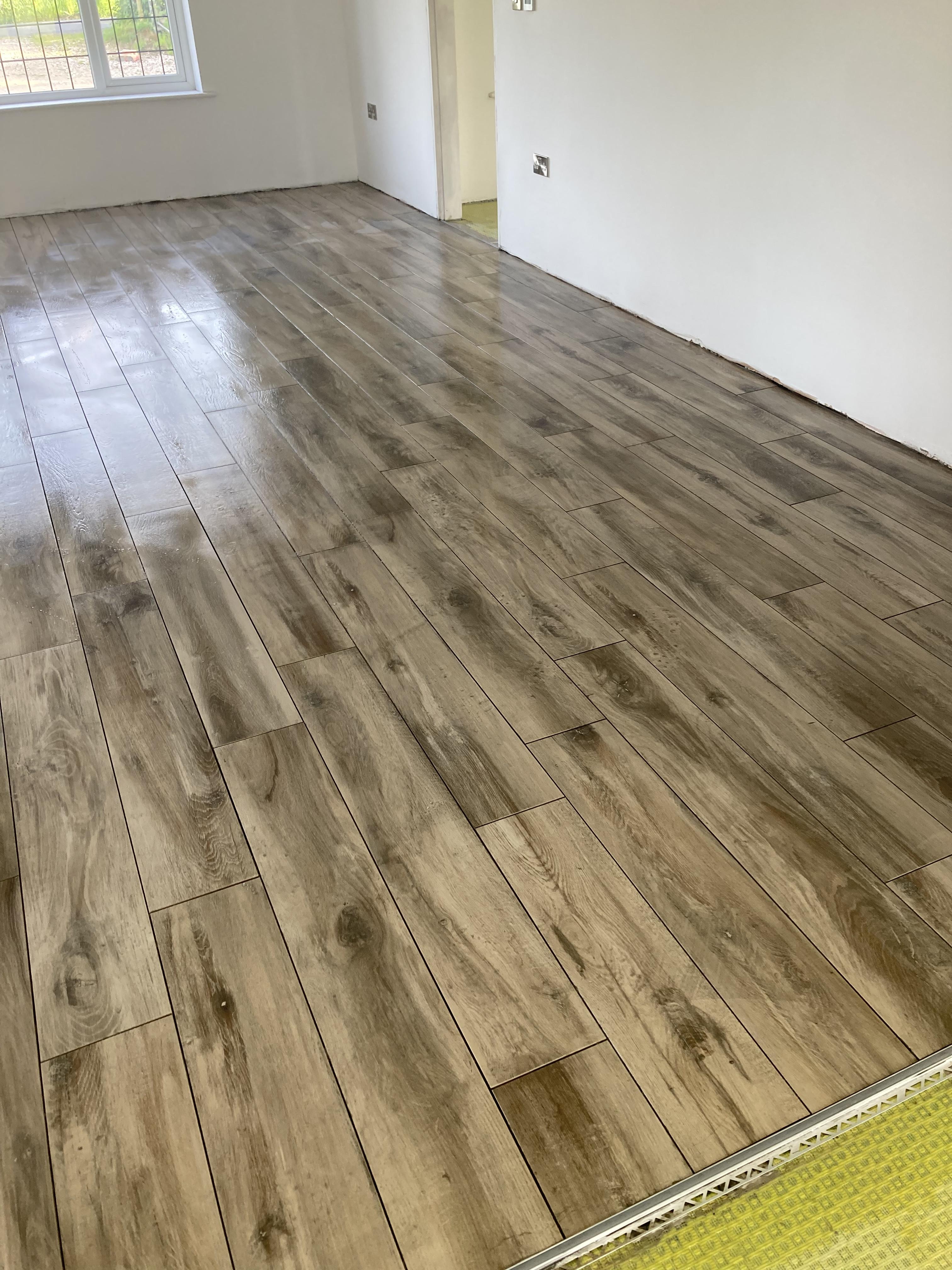

nod Posted May 16, 2024 Posted May 16, 2024 A normal 30m2 bathroom should take a tiler three days start to finish and then the floors Usally all three in a day Half a day prep work half a day grouting I’ve just tiled three out of four of our bathrooms A bit less than three days each While I’ve been tiling for forty plus years I don’t to much tiling these days But like with other things I refuse to have the lads that work for me do anything at our SELF build I’ve started laying the porcelain planks on the GF and I’m getting about 25-30m down pair day I’m 62 So you can imagine how quick the younger guys are The guys that work for me are site guys and are very good and extremely quick I pay £22 m2 for floors So they need to hit the ground running everyday 2
MortarThePoint Posted May 17, 2024 Author Posted May 17, 2024 Thanks @nod ! So it's sounding like the 3 bathrooms should take the tiler 12 days total (3 days per room for walls and then 3 days for all floors)? Or was it 9 days total including prep and grouting? I've been quoted £52/m2 for bathrooms to include adhesive and grout and then £12/m on top of that for laying decoupling mat (inc adhesive but ex mat itself). That's a lot more than I had expected and so I was wondering if I was underestimating the time it would take. The rooms aren't complex (i.e. no alcoves). 8 hours ago, nod said: I’ve started laying the porcelain planks on the GF and I’m getting about 25-30m down pair day Looks fantastic. 25 - 30m2 per day at £22/m2 is really good money ~£600/day, but I guess that doesn't include the prep work. I see yellow decoupling mat. Is that Durabase or Nassboard?
nod Posted May 17, 2024 Posted May 17, 2024 42 minutes ago, MortarThePoint said: Thanks @nod ! So it's sounding like the 3 bathrooms should take the tiler 12 days total (3 days per room for walls and then 3 days for all floors)? Or was it 9 days total including prep and grouting? I've been quoted £52/m2 for bathrooms to include adhesive and grout and then £12/m on top of that for laying decoupling mat (inc adhesive but ex mat itself). That's a lot more than I had expected and so I was wondering if I was underestimating the time it would take. The rooms aren't complex (i.e. no alcoves). Looks fantastic. 25 - 30m2 per day at £22/m2 is really good money ~£600/day, but I guess that doesn't include the prep work. I see yellow decoupling mat. Is that Durabase or Nassboard? I hadn’t seen your chart Two days should clear all the walls A day for the floors and a day for grouting and polishing Tilers can earn good money ex specially on commercial work Where floors can be 1000s m2 and several days without getting a tile cutter out But everything has to be perfect With heavy machinery or cars going on there As a tiling contractor I never see the prices being quotes on here Even for large format tiles 1
