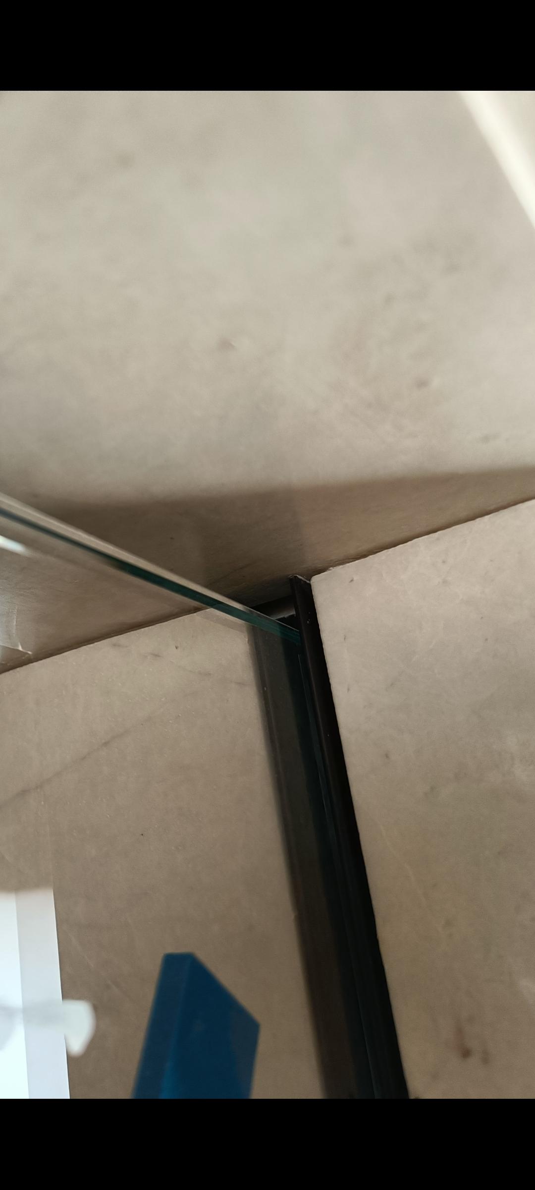

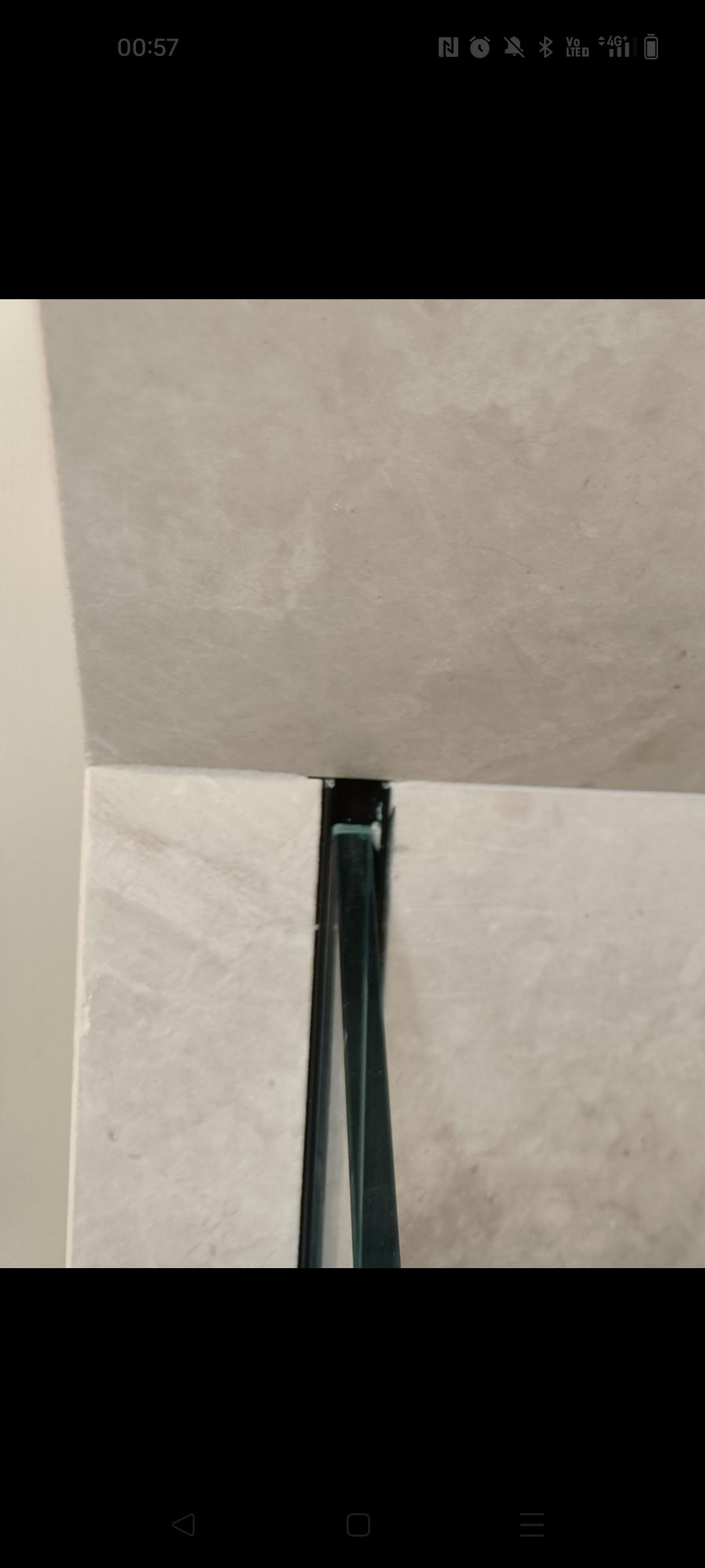

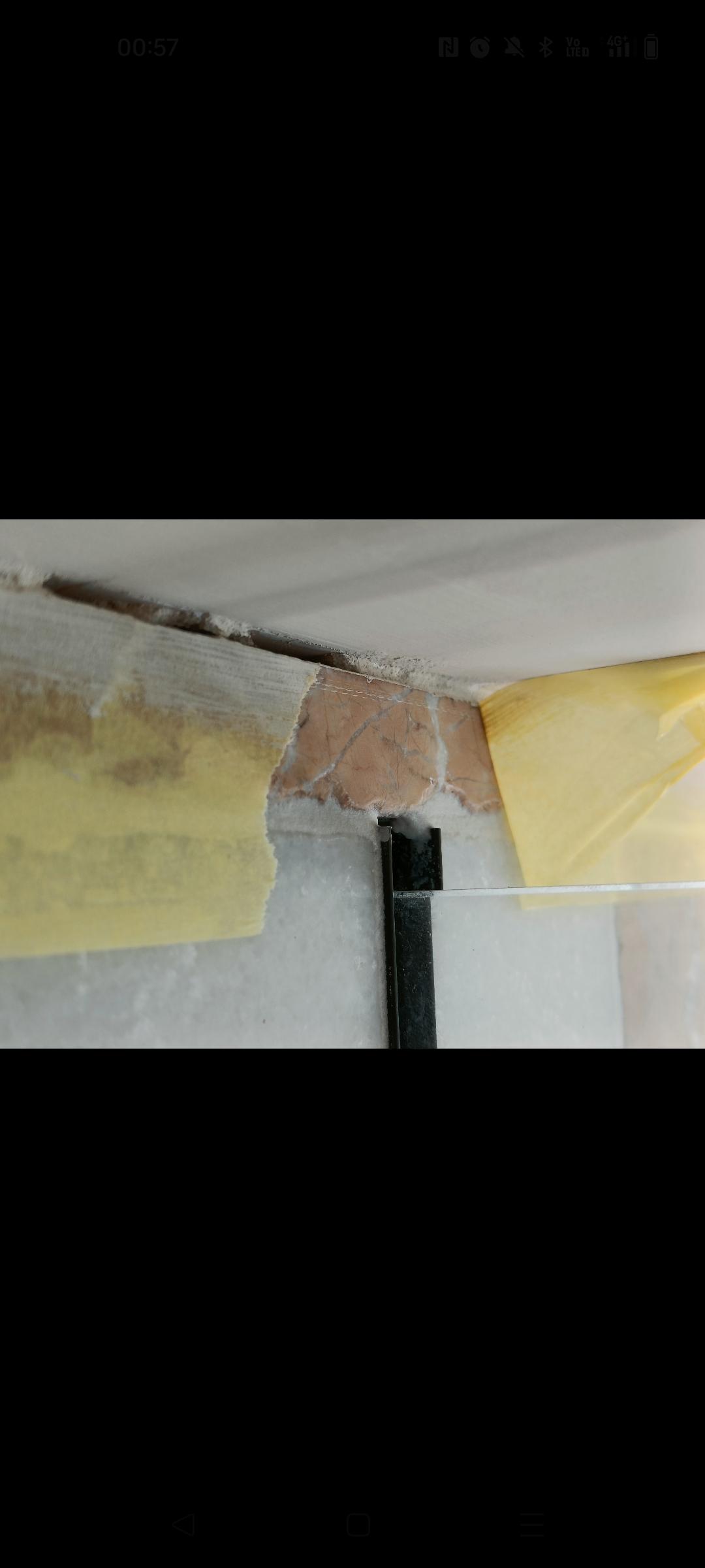

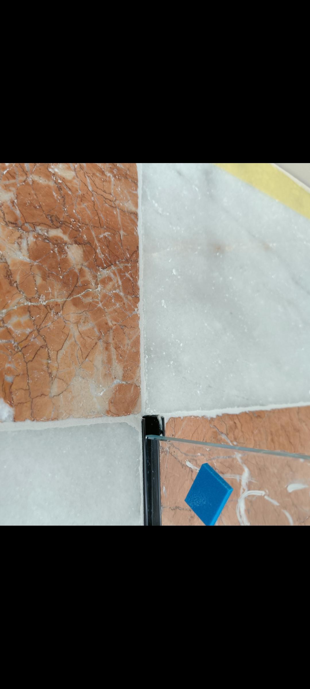

bmj1 Posted May 15, 2024 Share Posted May 15, 2024 Glazing has been cut too low for the channel. Glazer says they can't redo unless the tile above is removed as not possible to slide it in, and is blaming the builder. Builder says they can't remove the tile above, and is blaming the glazer. I'm stuck in the middle, trying to figure out the best way to fix it, my current thinking is to use some kind of saw to grind back the channel above the glass, and then fill it with marble dust. Thoughts? Link to comment Share on other sites More sharing options...
Andehh Posted May 15, 2024 Share Posted May 15, 2024 Black silicone inside it and smooth it over? Then it just looks like a consistent black channel /divider? Link to comment Share on other sites More sharing options...
gaz_moose Posted May 15, 2024 Share Posted May 15, 2024 pack it with some kind of black window fitters trim. Link to comment Share on other sites More sharing options...
Alan Ambrose Posted May 15, 2024 Share Posted May 15, 2024 >>> Black silicone inside it and smooth it over? Then it just looks like a consistent black channel /divider? +1 Link to comment Share on other sites More sharing options...
scottishjohn Posted May 16, 2024 Share Posted May 16, 2024 don,t look that bad to me and iwouldn,t do anythig unless to intend to fit a black angled strip with blck sikafllex on inside and give a black surround look Link to comment Share on other sites More sharing options...
Alan Ambrose Posted May 16, 2024 Share Posted May 16, 2024 If it really bothers you, you could get a teenager to 3d print a filler for it ... at a bureau if you want the best result. I think you won't notice it though after about a week. Link to comment Share on other sites More sharing options...
