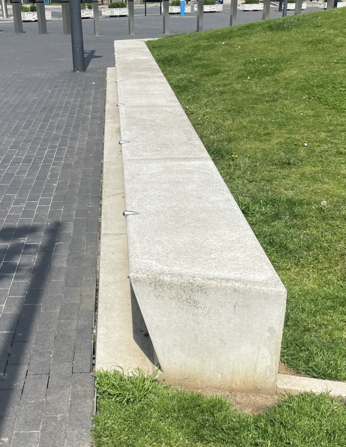

AdaminCymru Posted May 14 Share Posted May 14 (edited) I require a new retaining wall in the garden, 0.6m above ground level and 18 metres in length including a few slight bends. The current plan is to build from blocks and then clad with some form of stone cladding. Whilst in London I came across this and wondered whether it could work as an alternative, avoiding the need to clad, and offering integrated seating into the design. I imagine it would be easy to power wash and I wouldn't need to worry about damaging any cladding adhesive with this option. I have called around a few pre-cast concrete suppliers and none seem to be able to offer this. Does anyone have any suggestions on where I could look into this further? Am I crazy to think this might work out cheaper than building with blocks, cladding, and then sorting an integrated seating option? Any ideas welcome Thanks Adam Edited May 14 by AdaminCymru Make it clearer Link to comment Share on other sites More sharing options...
Mr Punter Posted May 14 Share Posted May 14 That will be very very expensive. Think 6x the price of blockwork. 1 Link to comment Share on other sites More sharing options...
markc Posted May 14 Share Posted May 14 14 minutes ago, Mr Punter said: That will be very very expensive. Think 6x the price of blockwork. Yep! They look very close to some precast benches we were asked to lift in. When the guy said they were around a grand for each 2m block he was told to “drop them in place” his self. 1 Link to comment Share on other sites More sharing options...
saveasteading Posted May 14 Share Posted May 14 What the Spanish municipal authorities would do is build this in brick or block, then rough render it to shape, then render or tile it. There are well designed kit systems for retaining walls , with stone effect as an option. Your photo is an example of spending someone else's money. 2 Link to comment Share on other sites More sharing options...
SteamyTea Posted May 14 Share Posted May 14 52 minutes ago, markc said: When the guy said they were around a grand for each 2m block Easy enough to make your own mould up and cast yourself. 1 Link to comment Share on other sites More sharing options...
saveasteading Posted May 14 Share Posted May 14 14 minutes ago, SteamyTea said: make your own mould up Using fancy plywood for reuse and a good finish. Then pour 0.5m3 each pour? Site mix. And adapt for corners. Or forget the municipal look and go for a rustic board finish. 1 Link to comment Share on other sites More sharing options...
SteamyTea Posted May 14 Share Posted May 14 (edited) 48 minutes ago, saveasteading said: Using fancy plywood for reuse and a good finish Polypropylene lined. Get a great finish at a low cost. (I used to make concrete moulds, Reigate junction on M25 was one of mine and a flood defence in Swansea) Edited May 14 by SteamyTea 1 Link to comment Share on other sites More sharing options...
AdaminCymru Posted May 14 Author Share Posted May 14 1 hour ago, saveasteading said: What the Spanish municipal authorities would do is build this in brick or block, then rough render it to shape, then render or tile it. There are well designed kit systems for retaining walls , with stone effect as an option. Your photo is an example of spending someone else's money. Thank you. I am concerned that with the render option, as this is a retaining wall (lawn), we would have problems down the line with water damage to the render Link to comment Share on other sites More sharing options...
