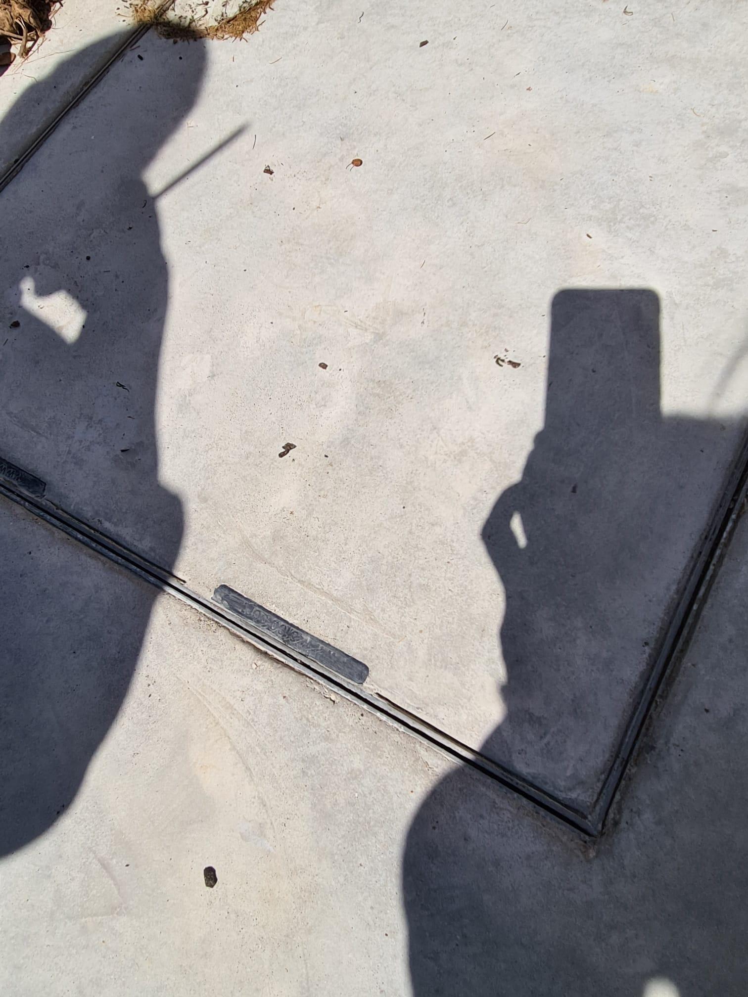

scnb Posted May 9, 2024 Share Posted May 9, 2024 Hello, I had my outdoor terrace done in polished concrete. The manholes urgently need to be opened, but can't even be opened by a professional surveyor, who says he needs to get his fingers under the handle, but are filled in with concrete. He also tried suction cups. Does anyone have any ideas? Trying to get the polished concrete company to take responsibility, but they'd been paid 6 months ago, so good luck to me. Link to comment Share on other sites More sharing options...

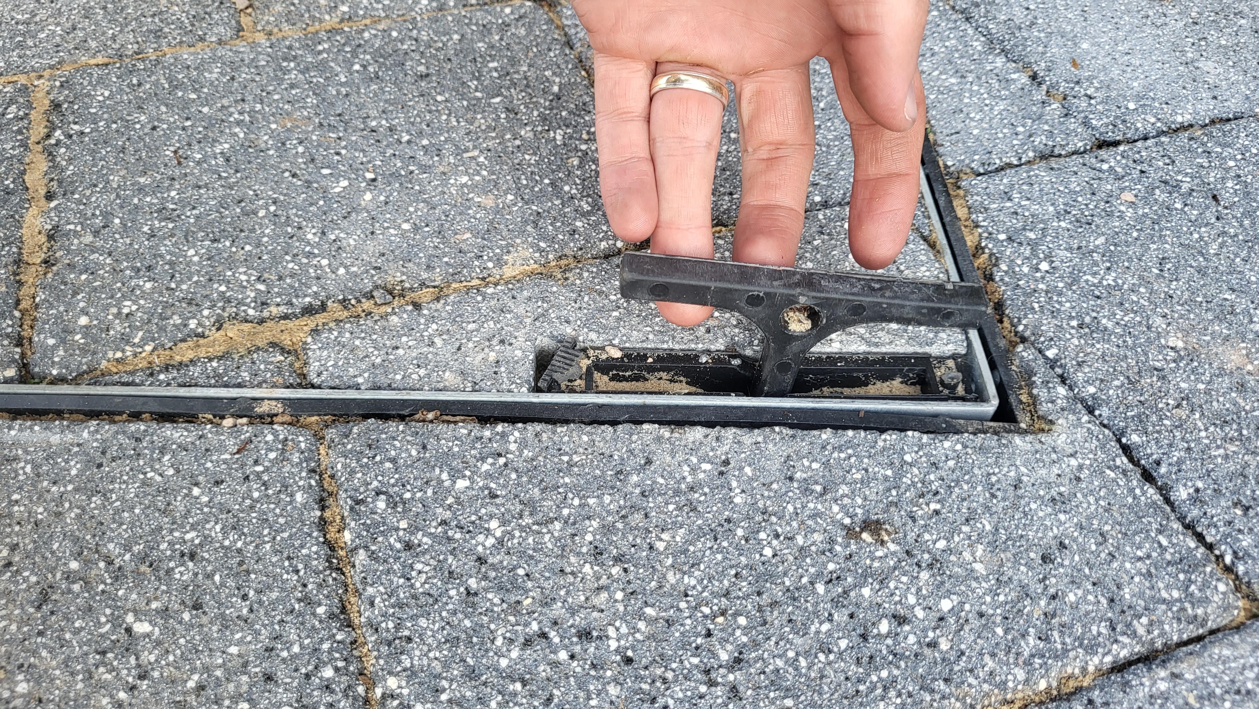

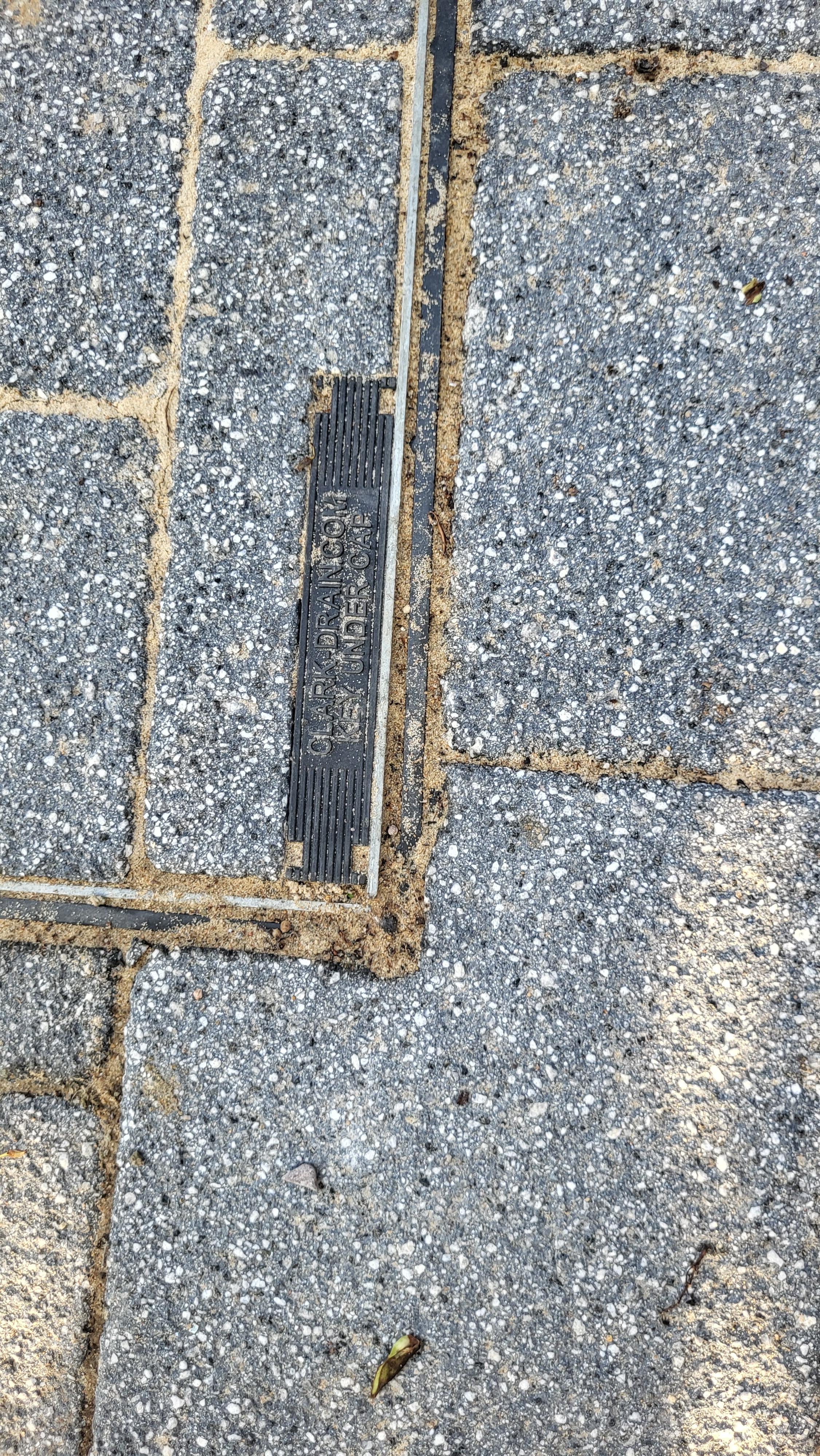

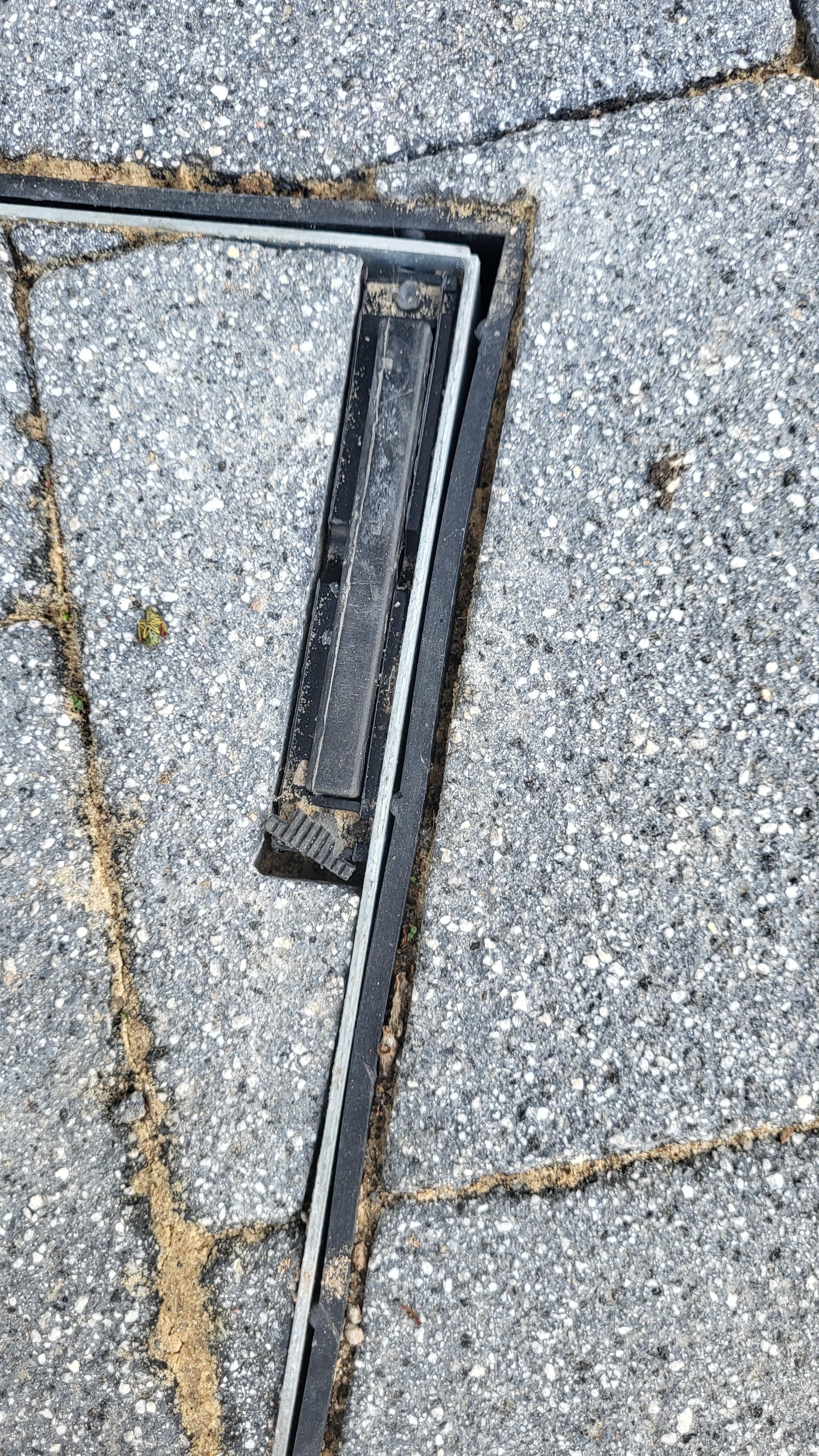

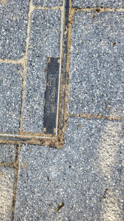

Dave Jones Posted May 9, 2024 Share Posted May 9, 2024 they look same as our recessed covers, those plastic bits slide off and expose the handle underneath. I did snap this cover on one before we installed as it was soo tight. try knocking it off with a chisel to expos the handle. can allways dab it back on with a bit of silicone after 1 Link to comment Share on other sites More sharing options...
Andehh Posted May 9, 2024 Share Posted May 9, 2024 Some before and after pics from my weekend job just gone..... Just in case it helps show what you're looking for! 1 Link to comment Share on other sites More sharing options...
