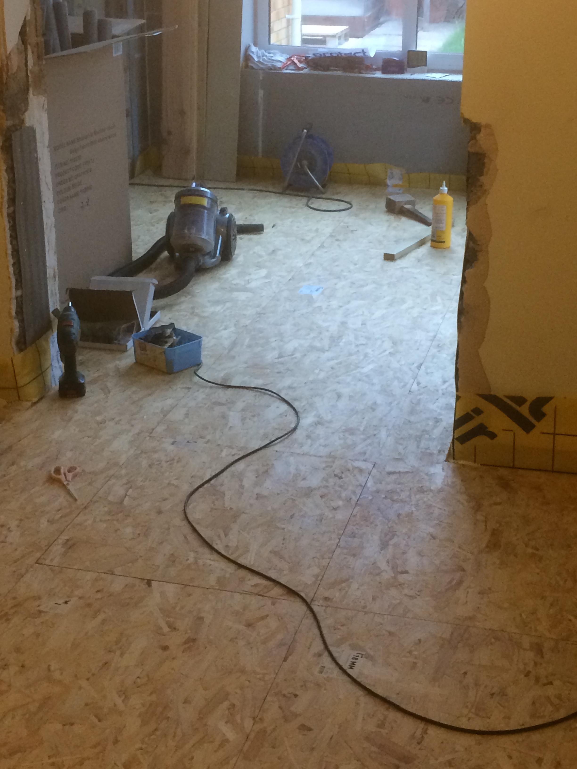

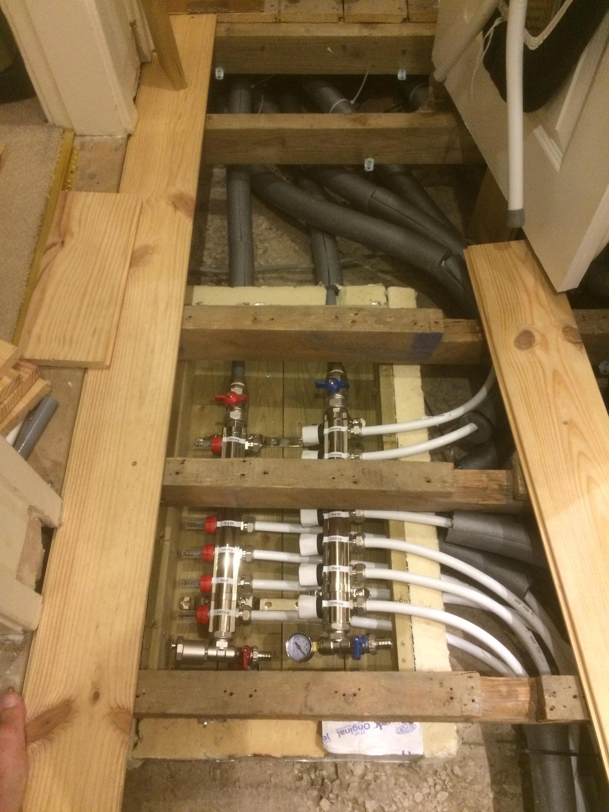

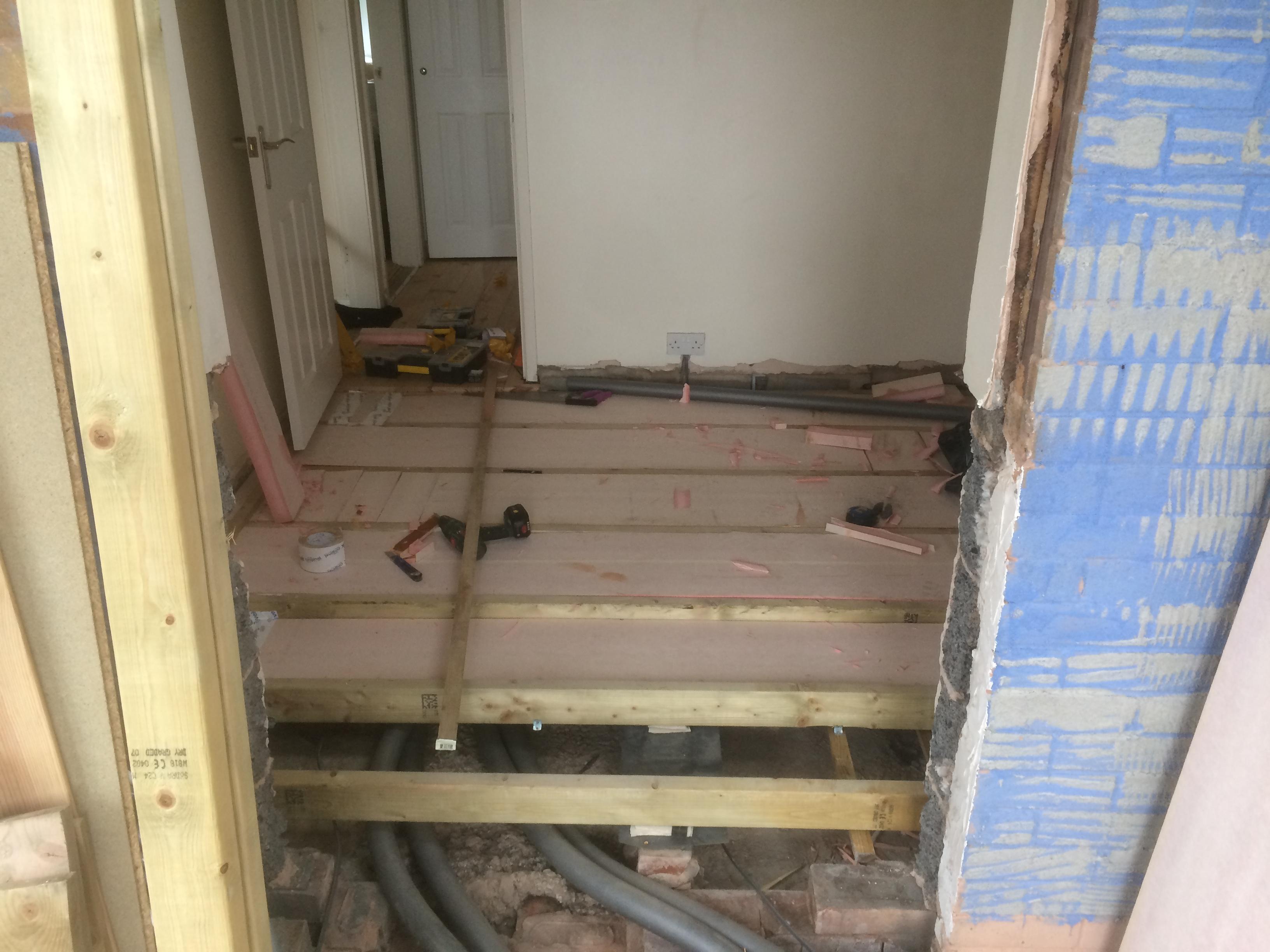

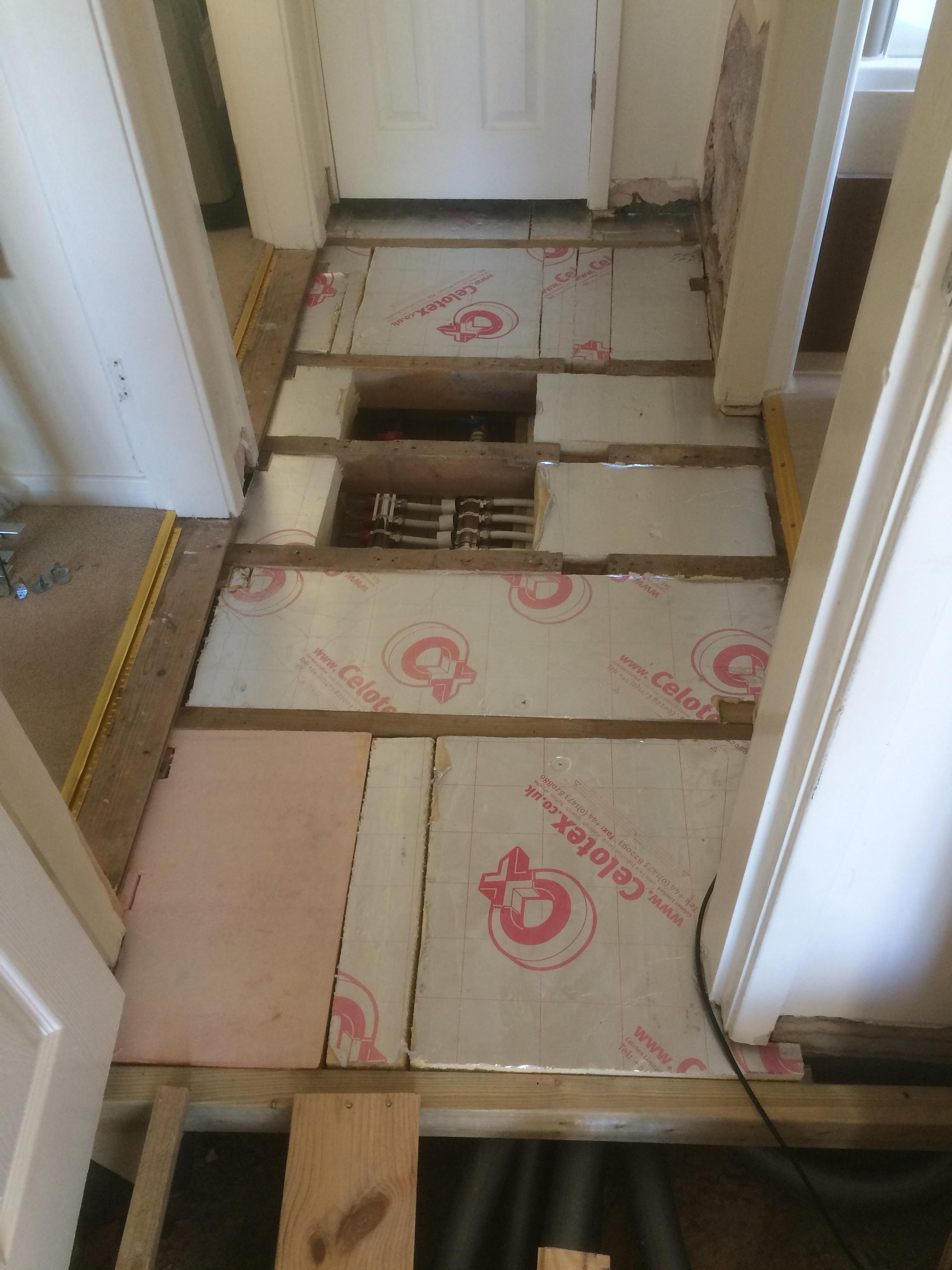

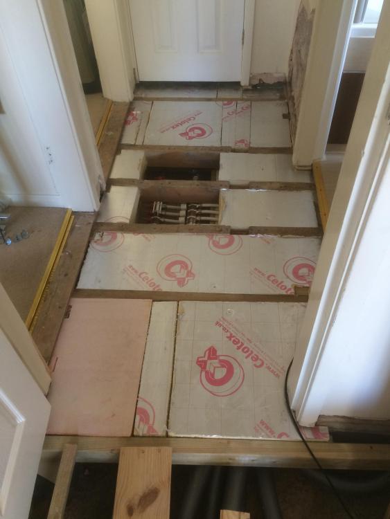

MikeGrahamT21 Posted September 10, 2018 Author Posted September 10, 2018 Just thought i'd give a quick update to this post, since I connected this all up yesterday, despite still not having all the radiators in situ! My wifes health is still not great, so i've just been doing stuff where I can, she is at home now and due to the early autumn weather we seem to be getting, she promptly requested the heating to be able to work. So after months of work which involved cutting out all of the existing woodwormed timber, underpinning a 60mm masonry wall, cleaning out under the floor of crap (6 rubble sacks full from the hallway and little room!), installing the manifold and all new pipework, knocking through and laying the insulation and new timber floor, here is where we have arrived: And yes that is a straight joint on the wood floor above, by the time i noticed it (was running on empty), the glue had already dried, its sat on a joist anyway, and seems absolutely fine. For the benefit of others, I've also picked up a few tips doing all this, from jobs which i'd done previously and thought were done. Turns out friction fit of PIR insulation even when done really well, isn't that good, in the rooms which I have already insulated I found many examples of insulation which had dropped through and was no longer doing its job, clearly i couldn't sort that out as part of this work, and will have to lift the floors to fix at a later date, but from now on I've been using some little L shaped brackets which protrude the bottom of the joists, to hold the insulation in place. I've also found that rather than using 1 layer of 100mm, which will obviously have joins in it, was to use 50mm (this was by total accident, supplier had ran out of 100mm phenolic, so ended up with 50mm), and to put the larger pieces with less joins in at the bottom, and then use up all of the offcuts on the top, along with a good helping of expanding foam to hold everything in place. I can now stop rushing quite as much, fearing the cold weather coming, and complete the rest in a reasonable pace. I've pretty much just got to plaster the new room now, and then put the final finish flooring down, we've decided on bamboo for this, looks really nice, extremely hard, and also sustainable which is quite important to me. 3 1

Oz07 Posted September 10, 2018 Posted September 10, 2018 What pipe did you use? Would it be better to use that 16mm ufh stuff for this scenario. Because of the metal barrier it bends and holds shape really well. No need for elbows.
MikeGrahamT21 Posted September 11, 2018 Author Posted September 11, 2018 Exactly so, yes I used MLCP 16mm pipe, and it worked brilliantly. So the only joints in the system are the manifold, the radiator valves, and the 22mm copper to plastic connection to adhere to the boiler guidelines of using plastic pipe (first bit has to be copper). Really impressed with the 16mm pipe, would definitely use it again, as you say its so easy to shape, and with a pipe bending spring, you can get almost any angle you want, and it stays put. Funnily enough the few odd leaks I had were on the traditional 15mm connections, all of the 16mm eurocone connections were spot on.
Nickfromwales Posted October 2, 2018 Posted October 2, 2018 @MikeGrahamT21, just glanced over this and spotted the bottle vent on the manifold laying flat. As you'll have the rads as the high points for bleeding air out I'd cap that off. They cant stay in the horizontal position or they wont work and will leak like a bugger.
MikeGrahamT21 Posted October 10, 2018 Author Posted October 10, 2018 On 02/10/2018 at 17:33, Nickfromwales said: @MikeGrahamT21, just glanced over this and spotted the bottle vent on the manifold laying flat. As you'll have the rads as the high points for bleeding air out I'd cap that off. They cant stay in the horizontal position or they wont work and will leak like a bugger. Yeah i've bought some caps for the end if it becomes an issue, i had thought that myself, but it seems fine at present, it is angled upwards, so isn't totally flat. Cheers for the heads up. Will get some more photos of progress up soon, taken delivery of our engineered wood flooring today, hoping to start laying that this weekend ? Oh and we've had building control sign off too which is always nice.
Nickfromwales Posted October 10, 2018 Posted October 10, 2018 53 minutes ago, MikeGrahamT21 said: Yeah i've bought some caps for the end if it becomes an issue, i had thought that myself, but it seems fine at present, it is angled upwards, so isn't totally flat. Cheers for the heads up. Will get some more photos of progress up soon, taken delivery of our engineered wood flooring today, hoping to start laying that this weekend ? Oh and we've had building control sign off too which is always nice. It maybe ok for now but unless 100% vertical it will fail I assure you Chop it out now as the air will vent into the rads anyhoo. ? Be good to see some pics ?

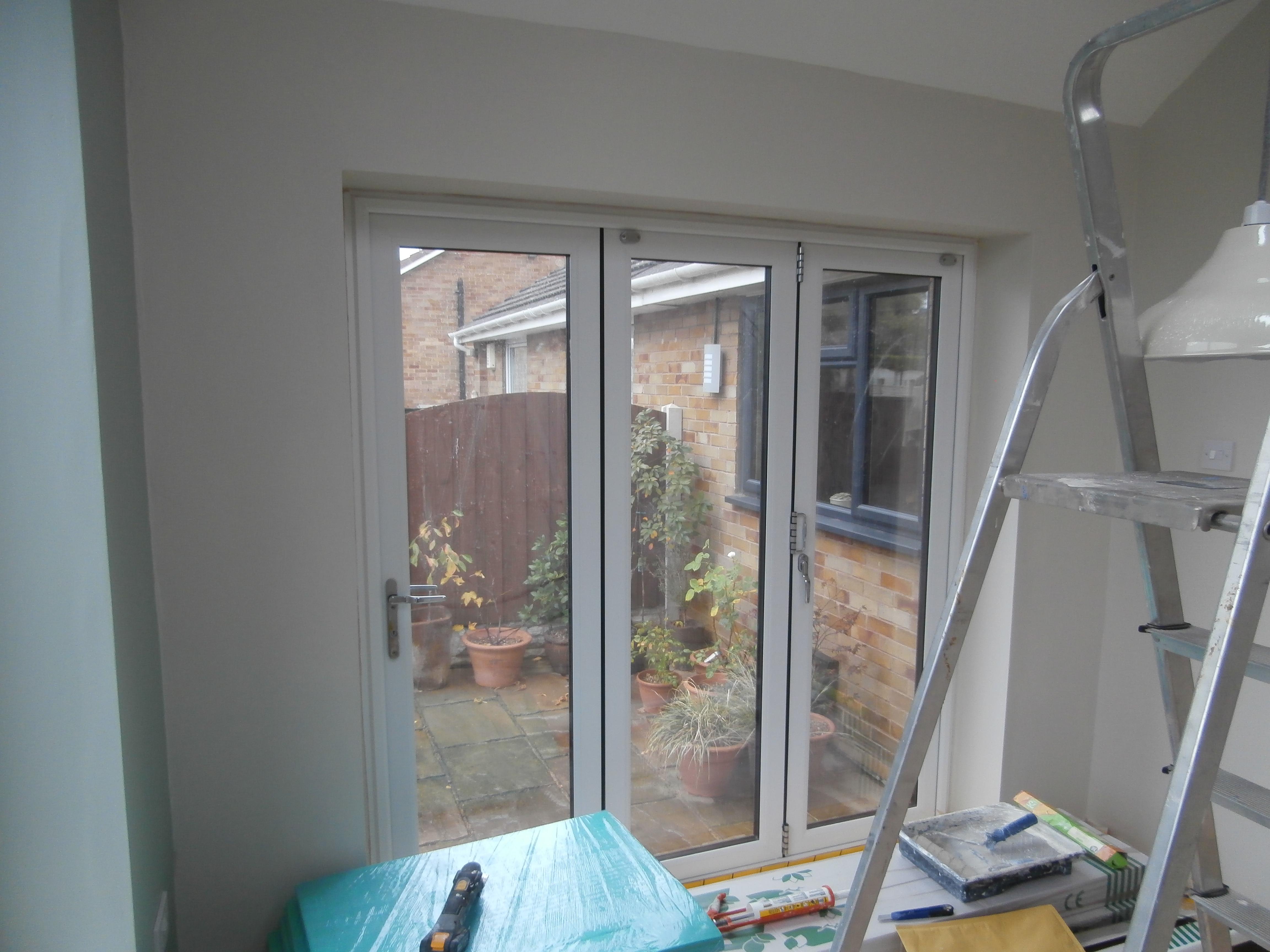

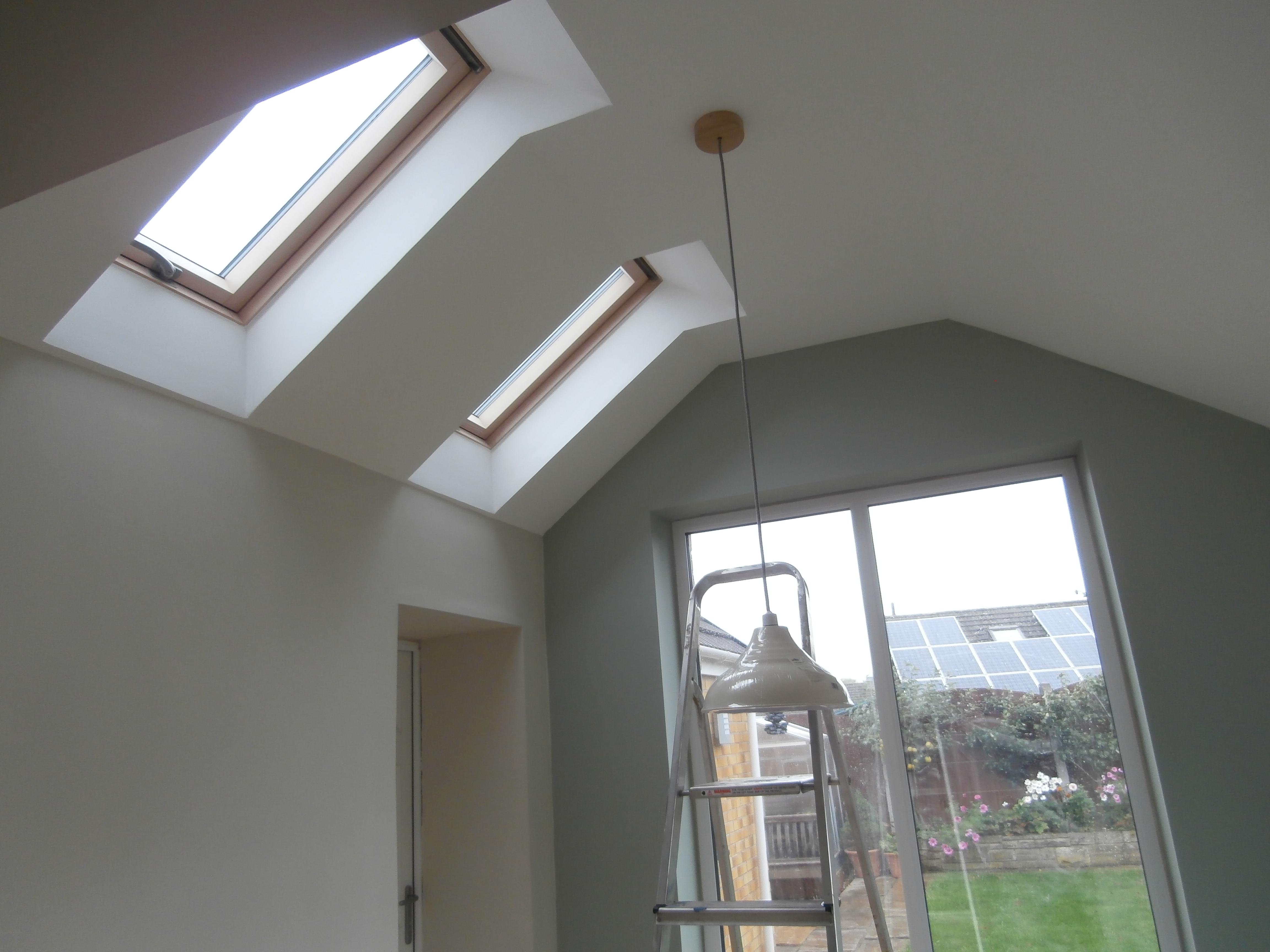

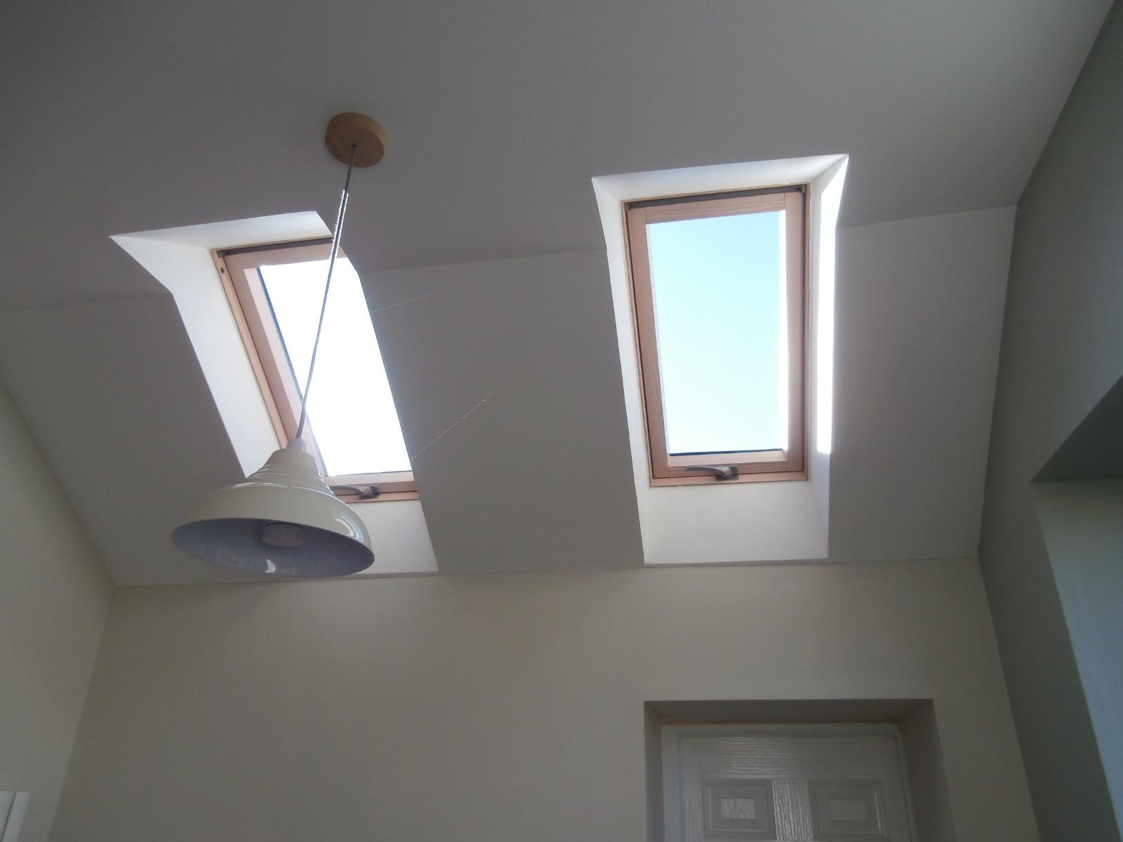

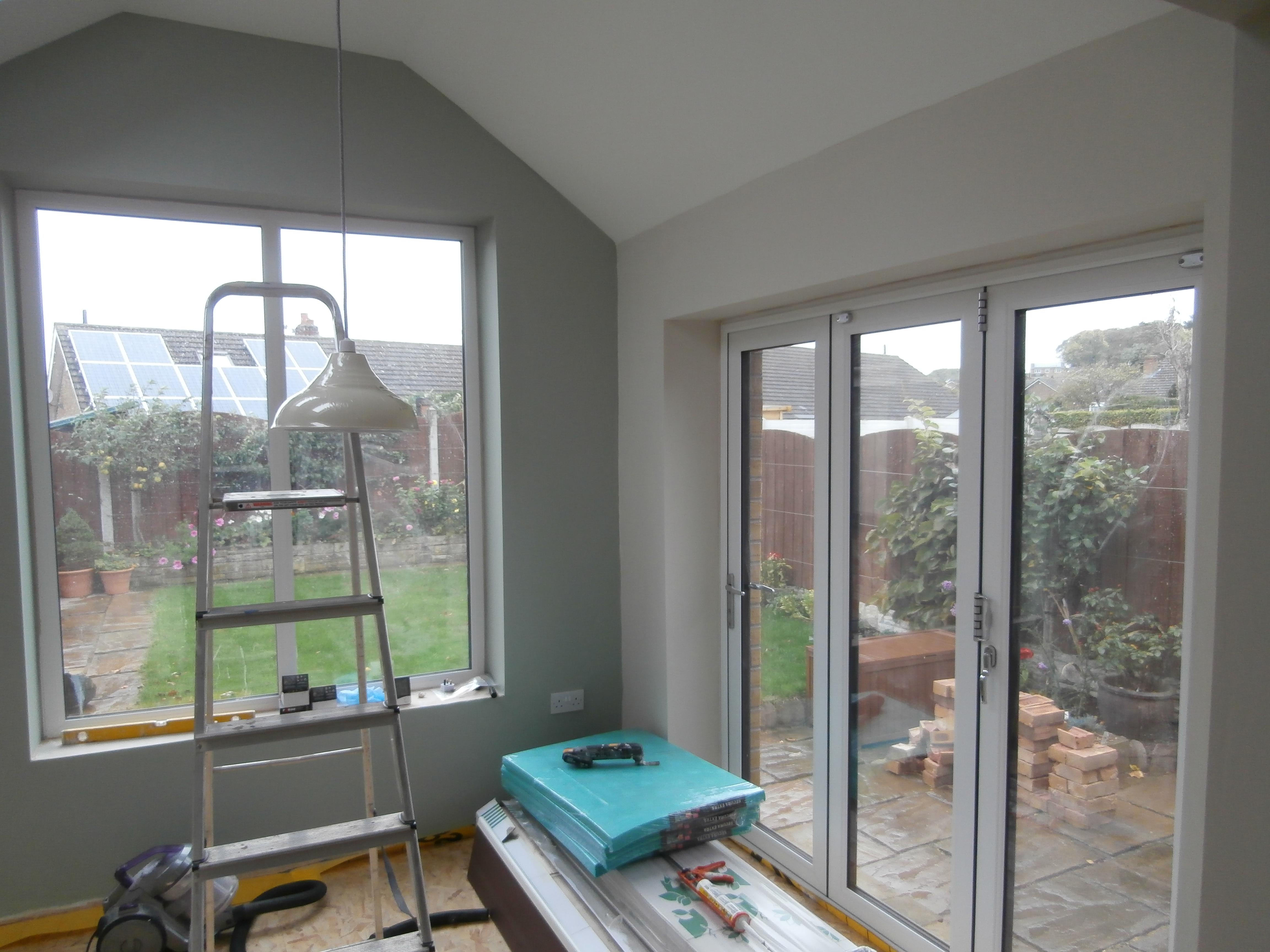

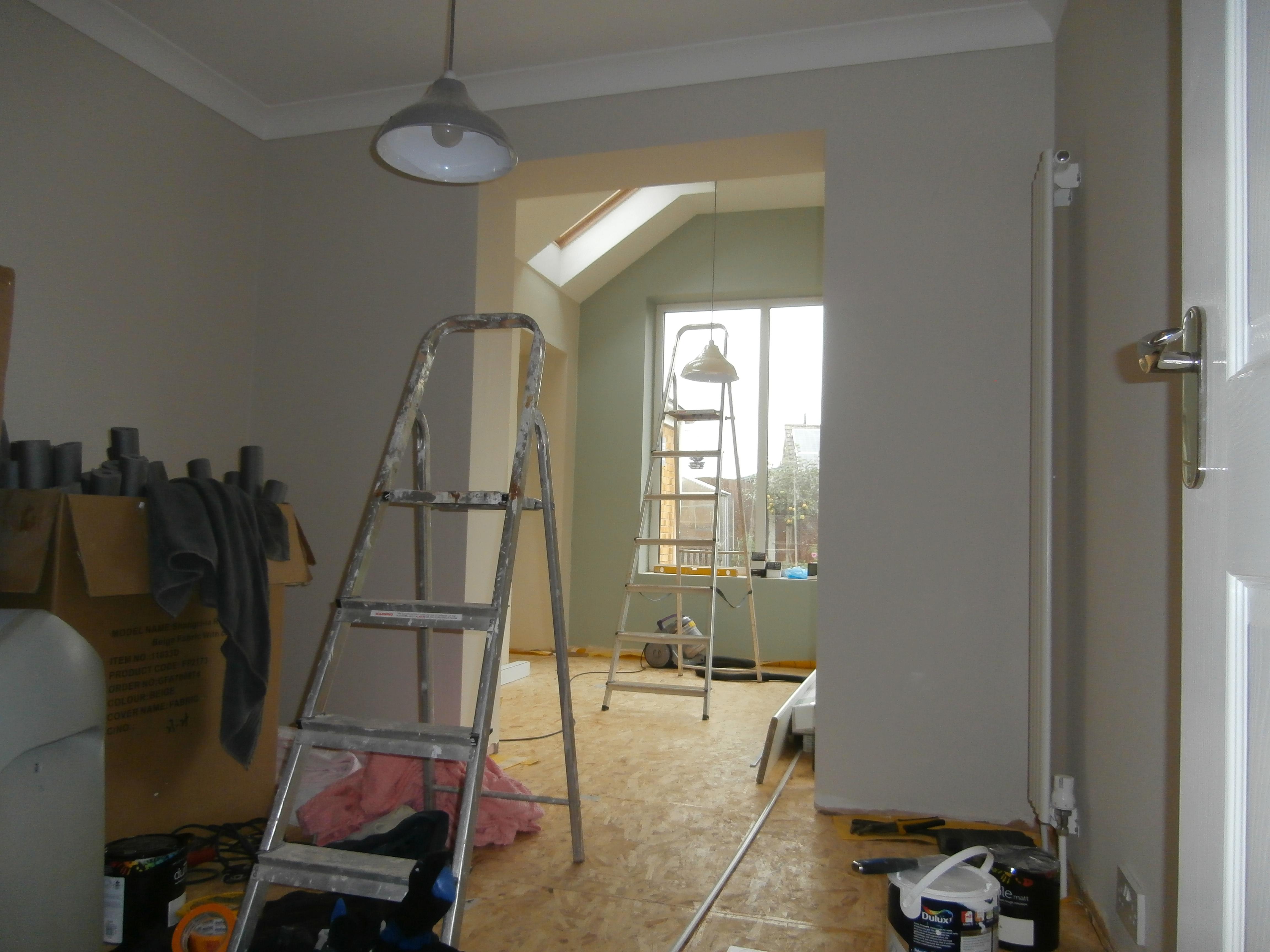

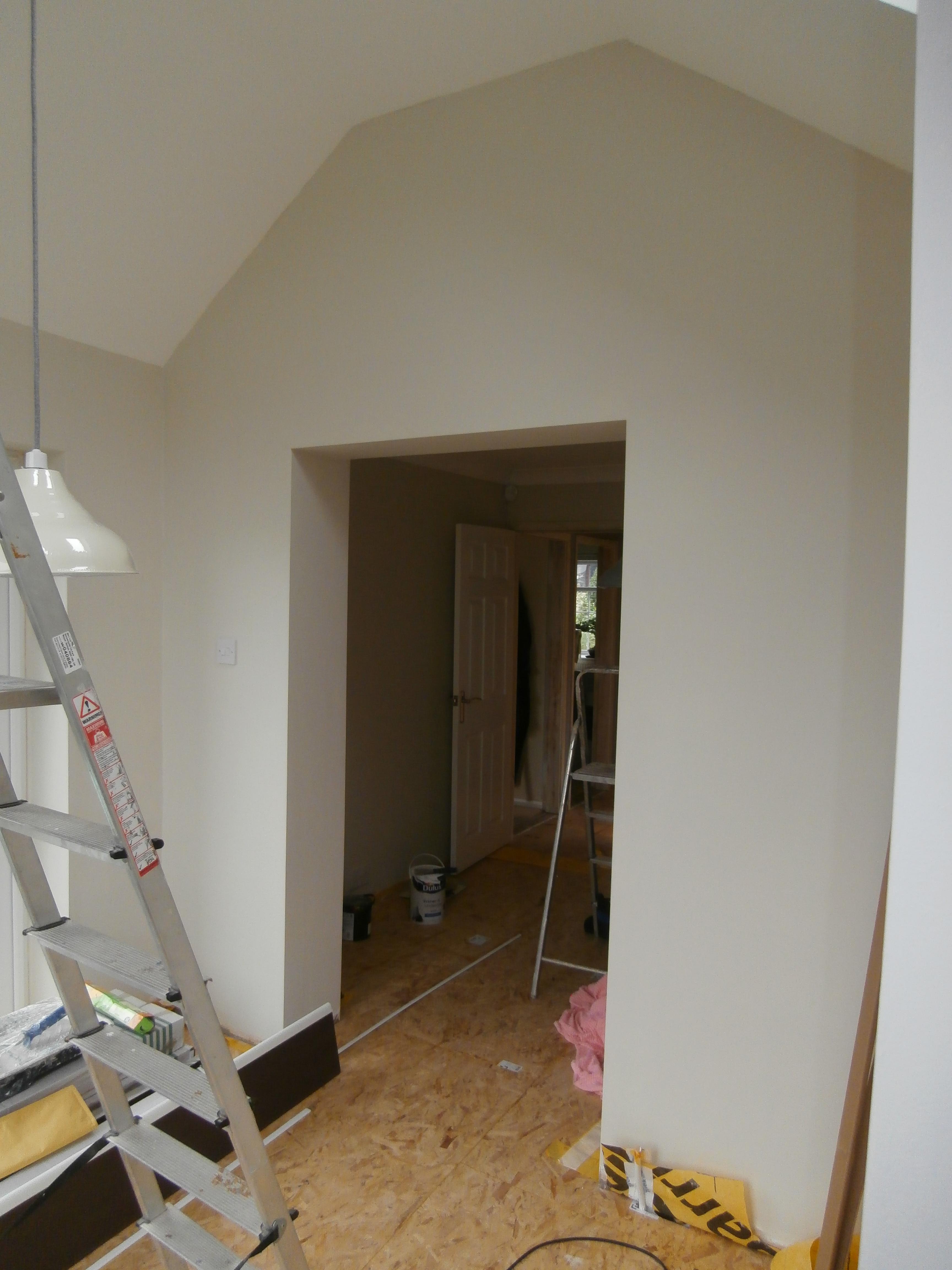

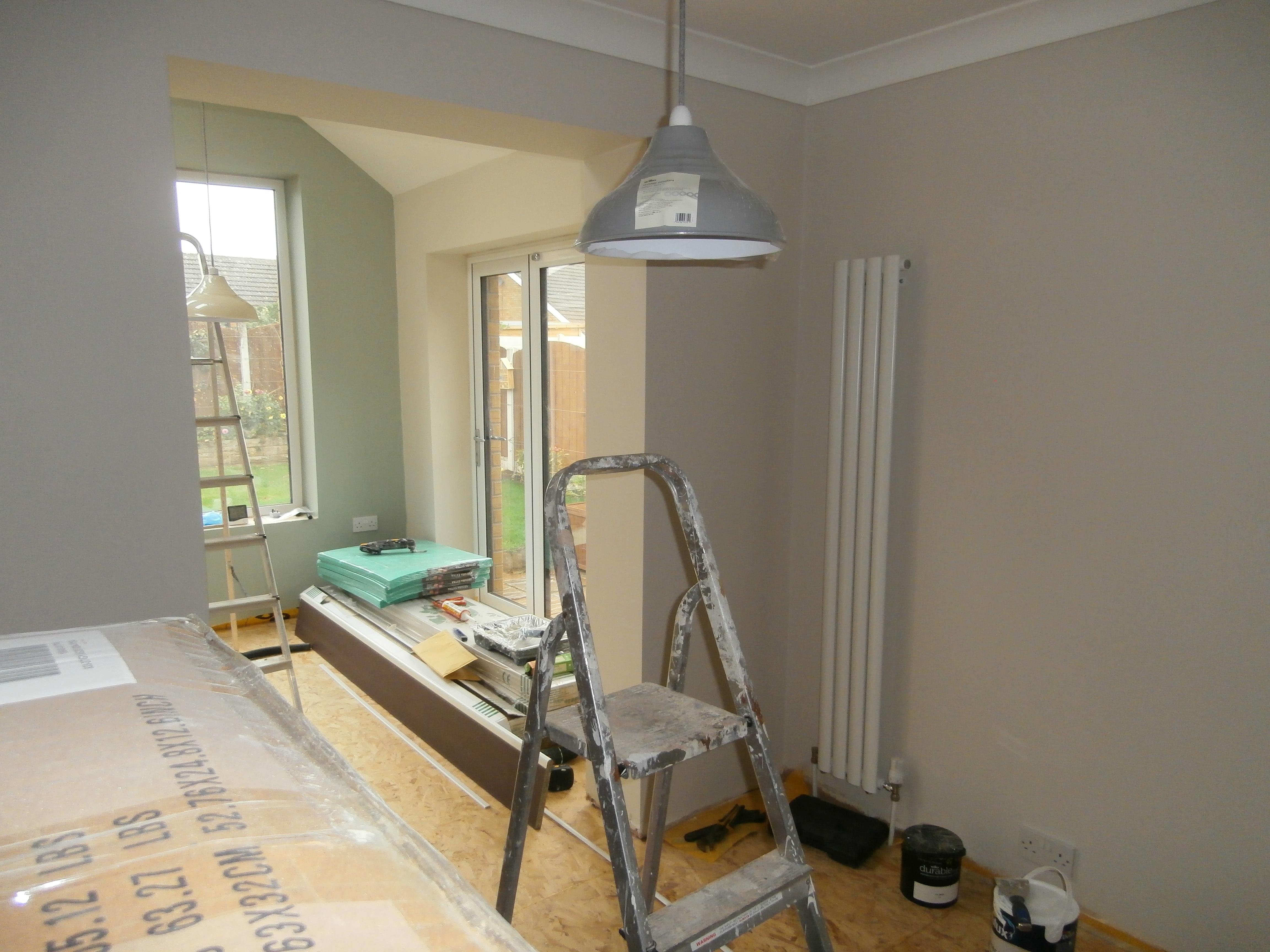

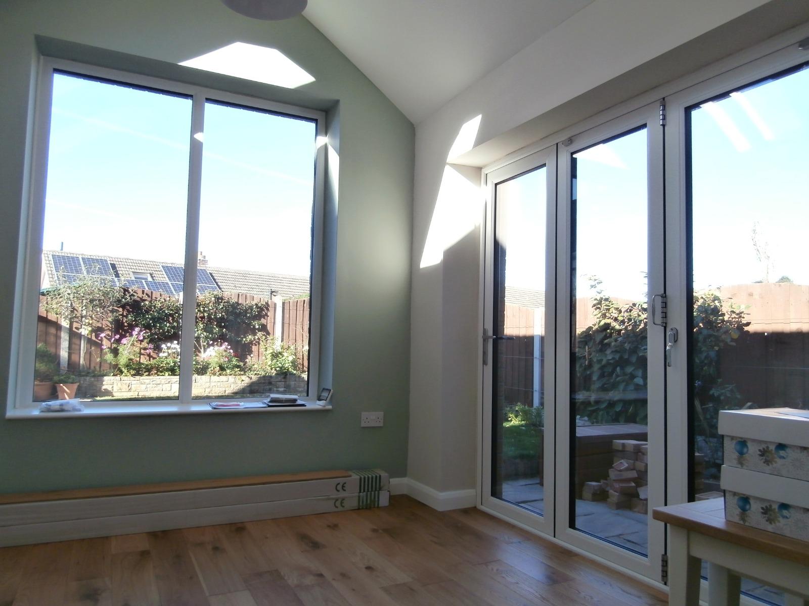

MikeGrahamT21 Posted October 12, 2018 Author Posted October 12, 2018 (edited) Updated photos as promised. The light fittings are lower than their final position, i've had to put the step ladders underneath them as I keep banging my head! lol Grey one is going to get put on a hook to move it nearer the radiator wall, and the other just needs shortening, i made it longer so that my wife couldn't say can you make it a bit longer, covering all bases and all. Big pile of wood flooring will hopefully be down very soon! Edited October 12, 2018 by MikeGrahamT21 2
MikeGrahamT21 Posted November 6, 2018 Author Posted November 6, 2018 Well, we finally made it, 3 years from when i first started! Just got some blinds to go up at the windows which haven't come yet, but otherwise done and dusted. Just wanted to say thank you for all your help, both from this forum and ebuild (thats how long its taken me lol!) The room itself is performing as expected, with an average temperature of 21C and humidity of between 40 and 50% (with hardly any ventilation at present, just the vents in the roof windows). The radiators I put in were massively over-specced, but at the time it was hard to imagine the room being easy to warm, indeed the calcs were correct and they rarely come on, even on the coldest of days, though it hasn't had its true test yet, but overall really pleased with this. 2
