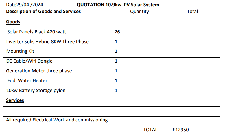

CalvinHobbes Posted April 29, 2024 Share Posted April 29, 2024 (edited) I can see he hasn't specified the make of the panels, plus we dont need the eddi since we will have an ashp.Also we will hold off on batteries. I would like one of those switches that means we can use our own electric if the neighbourhood electric is shut off. What should I ask him? Scaffolding already there. Edited April 29, 2024 by CalvinHobbes Link to comment Share on other sites More sharing options...
SteamyTea Posted April 30, 2024 Share Posted April 30, 2024 So an 8 KW inverter, rather than an 8 kW, and the battery is 10kw rather than 10 kWh. This gives a total system power of 10.9kw. 1 Link to comment Share on other sites More sharing options...
CalvinHobbes Posted April 30, 2024 Author Share Posted April 30, 2024 That's worrying when he is telling me it's 11.6! Thanks. Link to comment Share on other sites More sharing options...
Dillsue Posted May 1, 2024 Share Posted May 1, 2024 Top of the quote says 10.9kw so probably just cut and pasted from previous quote Link to comment Share on other sites More sharing options...
Bramco Posted May 1, 2024 Share Posted May 1, 2024 1 hour ago, Dillsue said: Top of the quote says 10.9kw so probably just cut and pasted from previous quote 420x26 is 10.9kW - so his mental maths when he's talking to you is not as good as his calculator which he used on the quote. Simon Link to comment Share on other sites More sharing options...
Conor Posted May 1, 2024 Share Posted May 1, 2024 I'd be wanting an itemised quote. And I said in your other thread, no need for the Eddi. Link to comment Share on other sites More sharing options...
