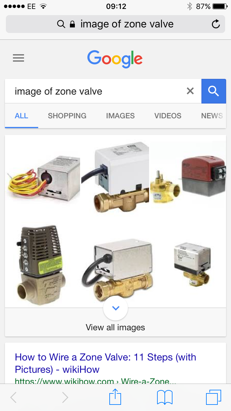

Nickfromwales Posted October 13, 2017 Share Posted October 13, 2017 Or just is it on 1,2 or 3? This may be a motorised zone valve not opening properly / fully if it's a system boiler on S-plan. An you see the motorised valves @Dee ? Make / type? I can tell you the first checks to do then. Link to comment Share on other sites More sharing options...

Dee Posted October 14, 2017 Author Share Posted October 14, 2017 @Nickfromwales Motorised valves? Can you describe what I'm looking for? ... Or should I get a plumber in? Thanks a gain Link to comment Share on other sites More sharing options...
Nickfromwales Posted October 14, 2017 Share Posted October 14, 2017 58 minutes ago, Dee said: @Nickfromwales Motorised valves? Can you describe what I'm looking for? ... Or should I get a plumber in? Thanks a gain Something like these Link to comment Share on other sites More sharing options...
