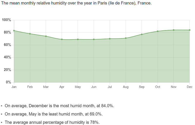

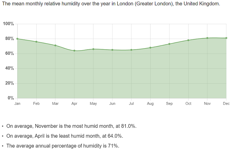

SteamyTea Posted April 28 Share Posted April 28 Paris is a relatively high humidity city. London Link to comment Share on other sites More sharing options...

JohnMo Posted April 28 Share Posted April 28 (edited) 28 minutes ago, Garald said: always above 55% in Paris, except on those short periods when it's very hot It is just about everywhere. But the relative humidity drops with temperature rise. We are currently at 7 degrees outside and 74% humidity outside. Our summer house for example with a simple dMEV fan is at 19.5 degrees with a humidity of 35%. Our house with MVHR 20.5 is at 40%. 28 minutes ago, Garald said: energy diagnostics guy was recommending was ventilation fans that would be sensitive to *interior* humidity That is exactly what I was recommending, but to make the piv responsive to internal humidity. The shelly H&T sits in room or two, it then uses a shelly relay to move the speed up or down on the piv unit. You now have closed loop control of the piv responding to internal humidity. No extra fan etc or upheaval. Edited April 28 by JohnMo 1 Link to comment Share on other sites More sharing options...
SteamyTea Posted April 28 Share Posted April 28 33 minutes ago, JohnMo said: relative humidity drops with temperature rise. Paris is quite warm in the summer, mean is above 20⁰C from end of April to almost beginning of October. So just ventilation is not much use. Maybe duct in a dehumidifier. Link to comment Share on other sites More sharing options...

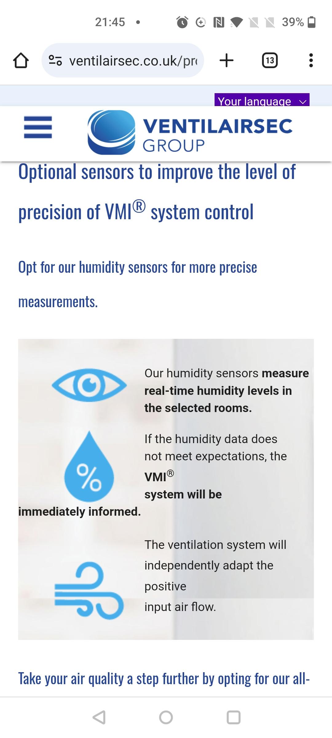

JohnMo Posted April 28 Share Posted April 28 1 hour ago, Garald said: Right, but the reality is that I *have* PIV Did you end up installing vmi unit? As they seem to have humidity sensing as an option? Link to comment Share on other sites More sharing options...
Garald Posted April 28 Author Share Posted April 28 (edited) 14 minutes ago, JohnMo said: Did you end up installing vmi unit? As they seem to have humidity sensing as an option? Right: I have a VMI unit, with a Hydro'R module (pre-heating only; incidentally, their more ambitious claims as to how much that can help with heating efficiency can't possibly be right - it's just like having an extra radiator there where the air comes in). I will ask the builder whether it comes with a humidity sensor (he hasn't been giving me the receipts; there was a third person involved in all of this, thankfully no longer involved - more about that juicy disaster story at some point). I imagine not, as I do not have it in writer. I better rig my own feedback system using the remote control in the way you suggested. Or I can contact the VMI company to see whether the optional sensors can be installed post facto. Edited April 28 by Garald Link to comment Share on other sites More sharing options...
