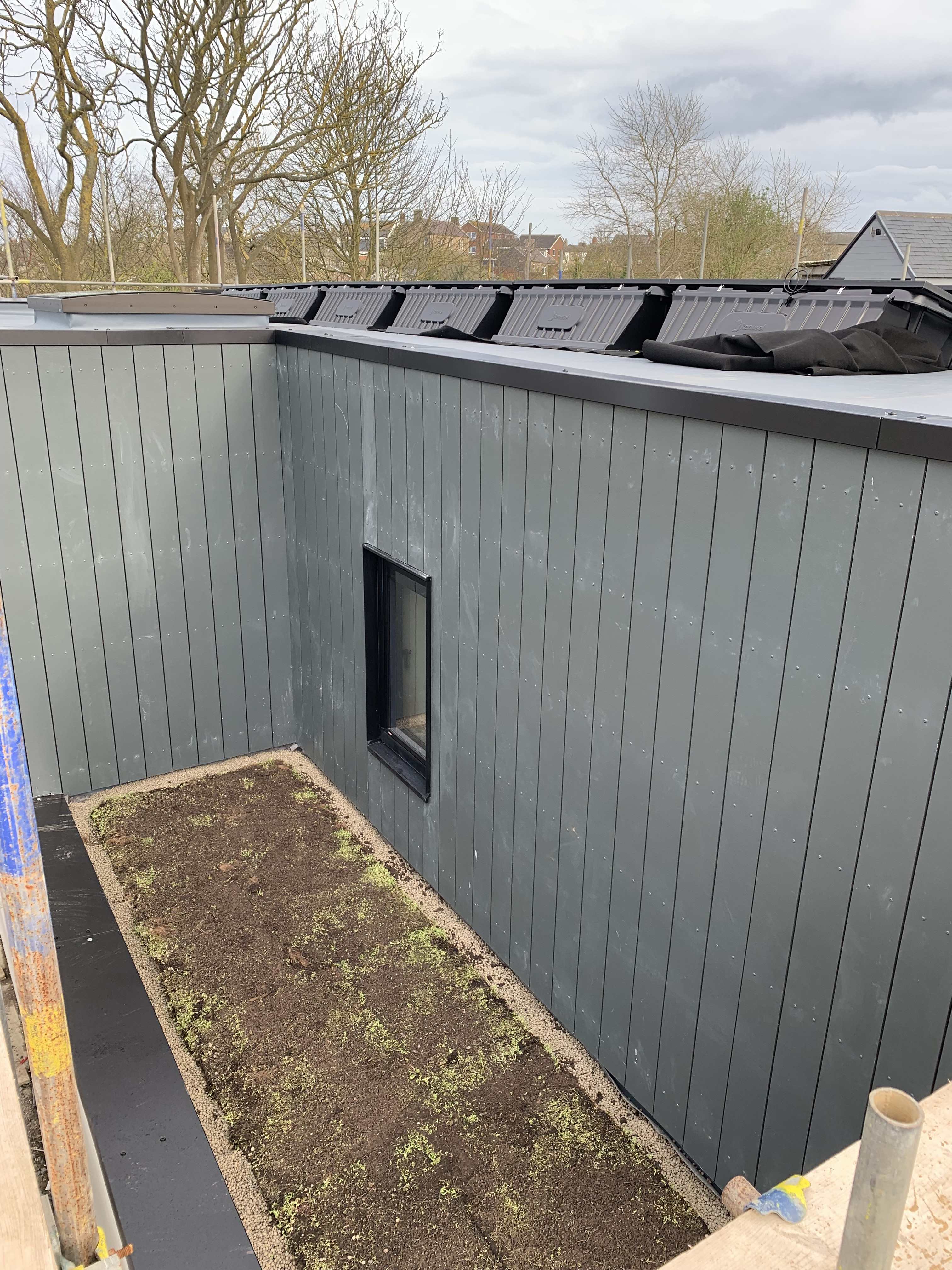

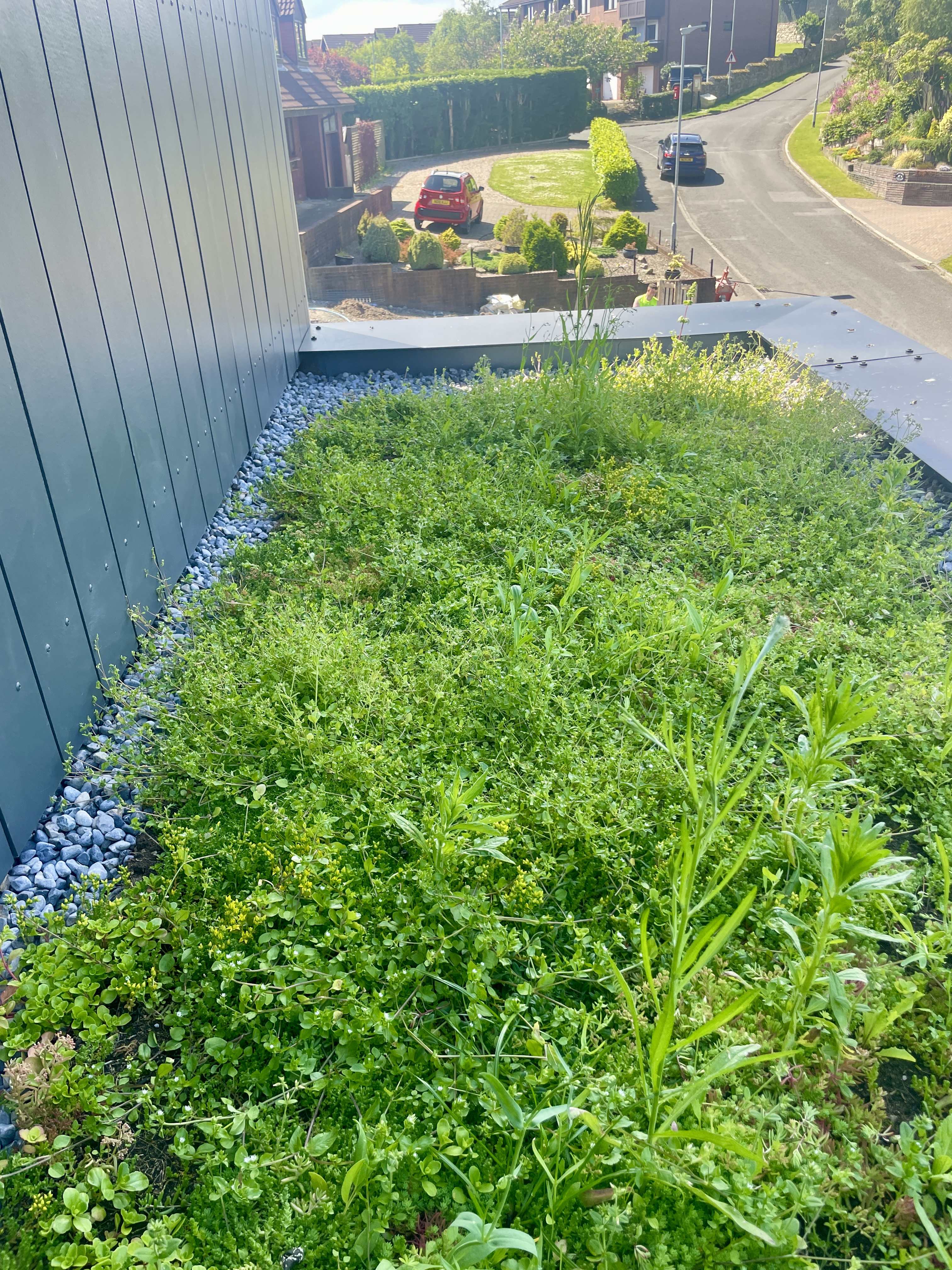

PNAmble Posted September 23, 2024 Share Posted September 23, 2024 Our builder installed this system, https://www.greenroofsdirect.com/products. but we added additional soil under it and put down additional wild flower seeds. it’s sitting on a single ply (memtec) warm roof. only a small area. The photos are April 24 when it was laid and June 24, by July it had lots of cornflowers and other plants. It’s still going strong and will need to climb on to cut it down in the next couple of weeks, in preparation for winter. The builders laid it, we could have done it, but as they were up on the roof we thought it easier for them to do the lifting. 2 Link to comment Share on other sites More sharing options...
