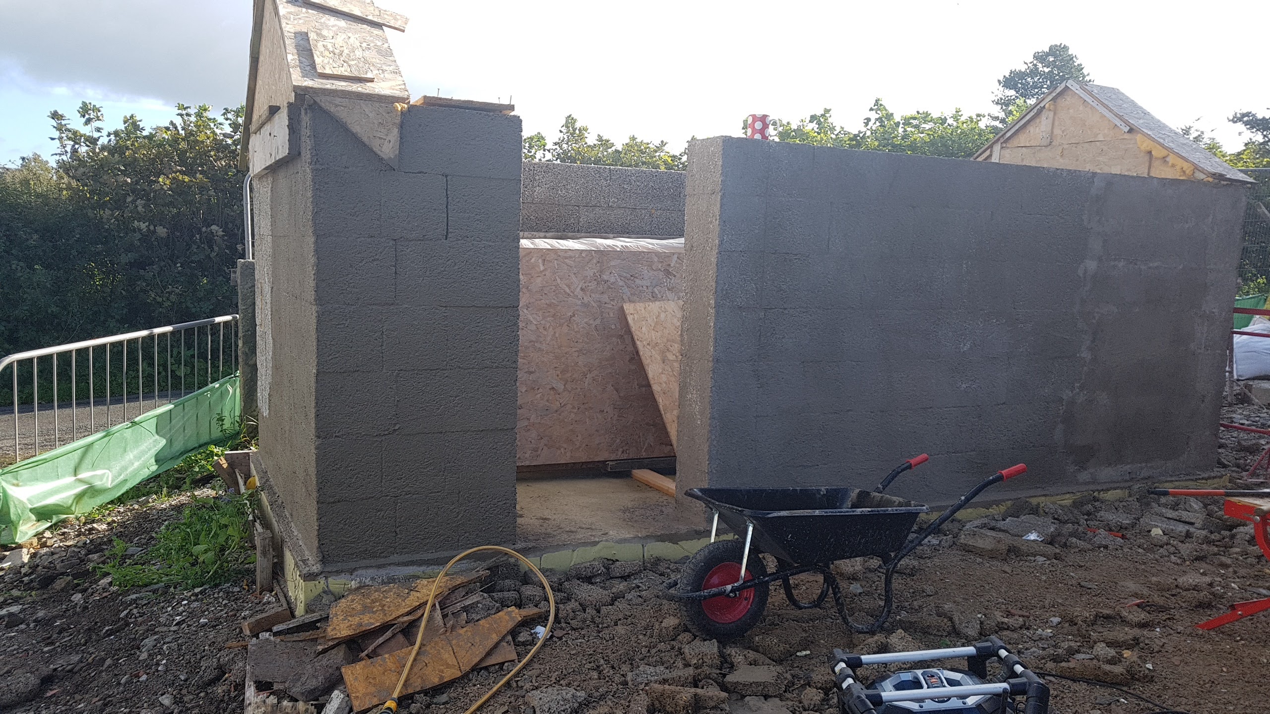

ToughButterCup Posted October 10, 2017 Posted October 10, 2017 You are very welcome. It didn't take long between me approving your membership and the first post... Might even be a record. In terms of ICF. I have a little experience of just one method, but there are several out there. The system I use is relatively cheap, but I would ask you to have a look at some of the problems I have encountered (just search for Durisol on this site) . Those problems would be significantly reduced for a single storey build.... Here's a single storey one I made earlier. (I never got the Blue Peter badge; still rankles after more than 50 years) The problem I refer to is bursts occurring during the pour. Frankly on a single storey it's a non-event; shovel it up, put in a barrow, make a bit of shuttering, fasten it, re-pour. We are building with Durisol. Have a look at the many other systems there are. The other key factor is the skill - level of those building with and for you. If you are doing this on your own, even as a complete newbie, I would guess that skill level is almost irrelevant. The push to get it right first time is intense. Have a target U value in mind, choose the system, build. Couldn't be easier. (Yeah, right) We look forward to your comments and questions. I don't know where you are but if you are passing J33 on the M6, you could drop in and poke around to your heart's content. We are 2 minutes away. Ian
