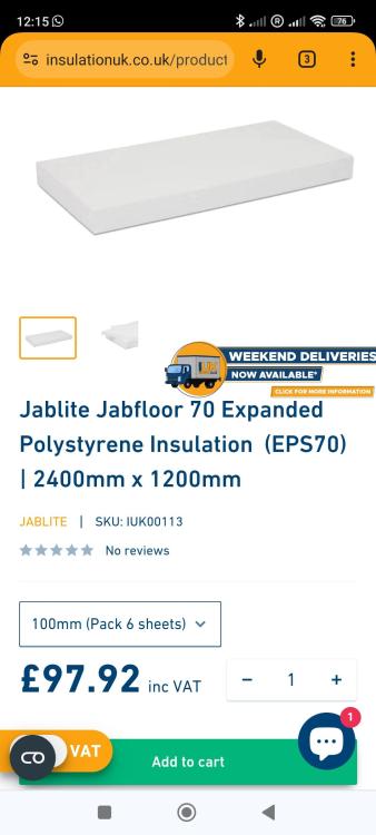

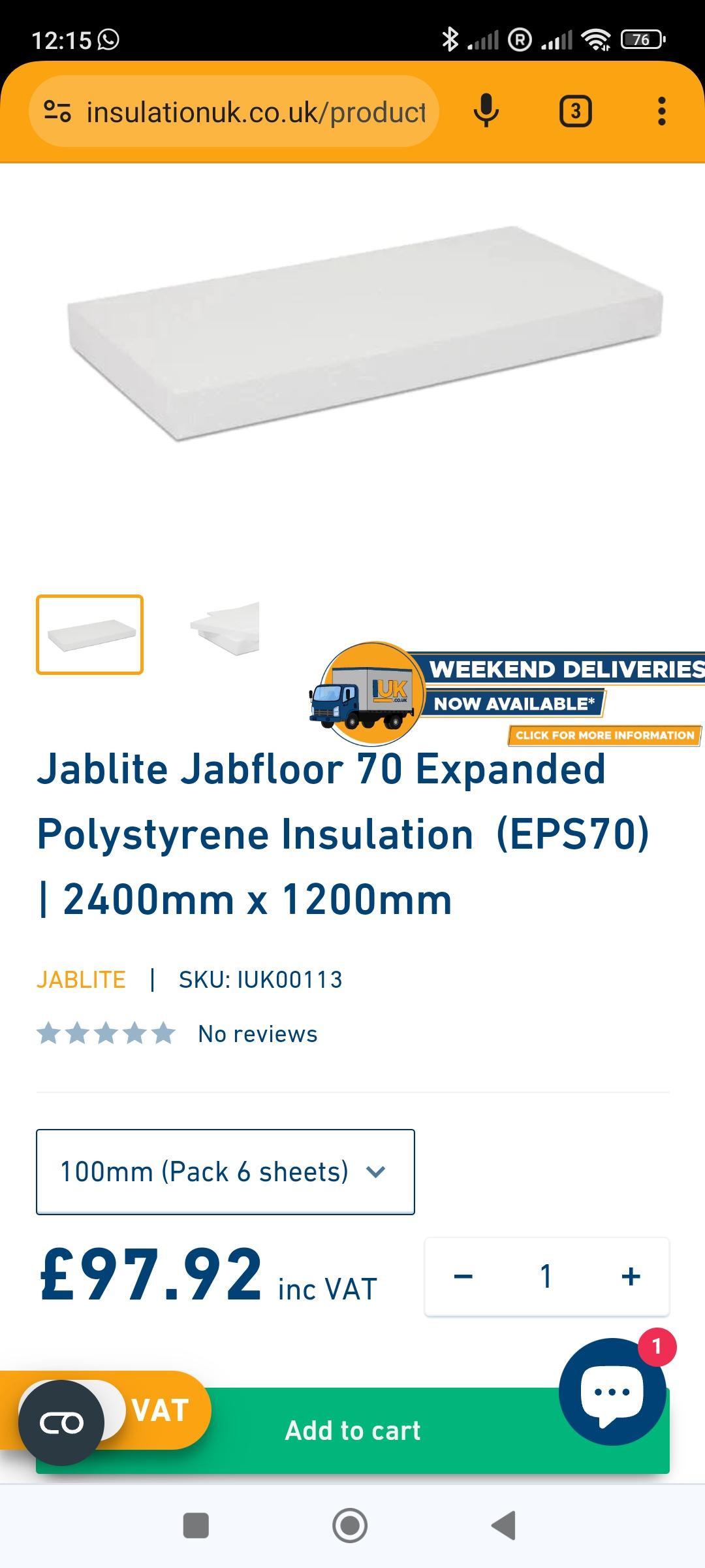

Iceverge Posted April 18, 2024 Posted April 18, 2024 If you want to make up volume then 270mm isn't really that much. 200mm of EPS would do the trick nicely. From the top down. 70mm screed with UFH Pipes stapled into EPS with long staples. Slip membrane. 100mm EPS 70 DPM wrapped up the walls. 100mm EPS joints staggered to the top layer. Sand levelling layer £11.33/m² is the cheapest I found after a 2 minute Google for 200mm and a U-value of about 0.18 W/m²K You could go even thicker, say 225mm to save the screed depending on the minimum required thickness of that. 1
Russell griffiths Posted April 18, 2024 Posted April 18, 2024 Go to band p eps, they are a manufacturer not a re seller, save a fortune they will cut what thickness you want so you could go 100mm eps 90eps 80mm traditional sand and cement screed. good thickness to keep the ufh pipes well covered and a good lump to use as a big radiator. 3
saveasteading Posted April 18, 2024 Posted April 18, 2024 Looks like a typo for s and b eps in Dudley ?? A great link thanks.
Russell griffiths Posted April 18, 2024 Posted April 18, 2024 3 minutes ago, saveasteading said: Looks like a typo for s and b eps in Dudley ?? A great link thanks. Not a typo, can’t remember the name of the company, so I thought a bit of google would find it, even with the wrong initials. 😉 1
saveasteading Posted April 18, 2024 Posted April 18, 2024 2 hours ago, Russell griffiths said: save a fortune No prices stated. They deliver direct to site. I'm predicting 20% saving cf merchants and presumably they want prepayment which could be quite a big sum.
Del-inquent Posted April 18, 2024 Author Posted April 18, 2024 3 hours ago, Russell griffiths said: Go to band p eps, they are a manufacturer not a re seller, save a fortune they will cut what thickness you want so you could go 100mm eps 90eps 80mm traditional sand and cement screed. good thickness to keep the ufh pipes well covered and a good lump to use as a big radiator. Just had a chat with them, very helpful people. Can't sell to me direct but gave me the name of a contact they sell to regularly that can help. Cheers for that!
