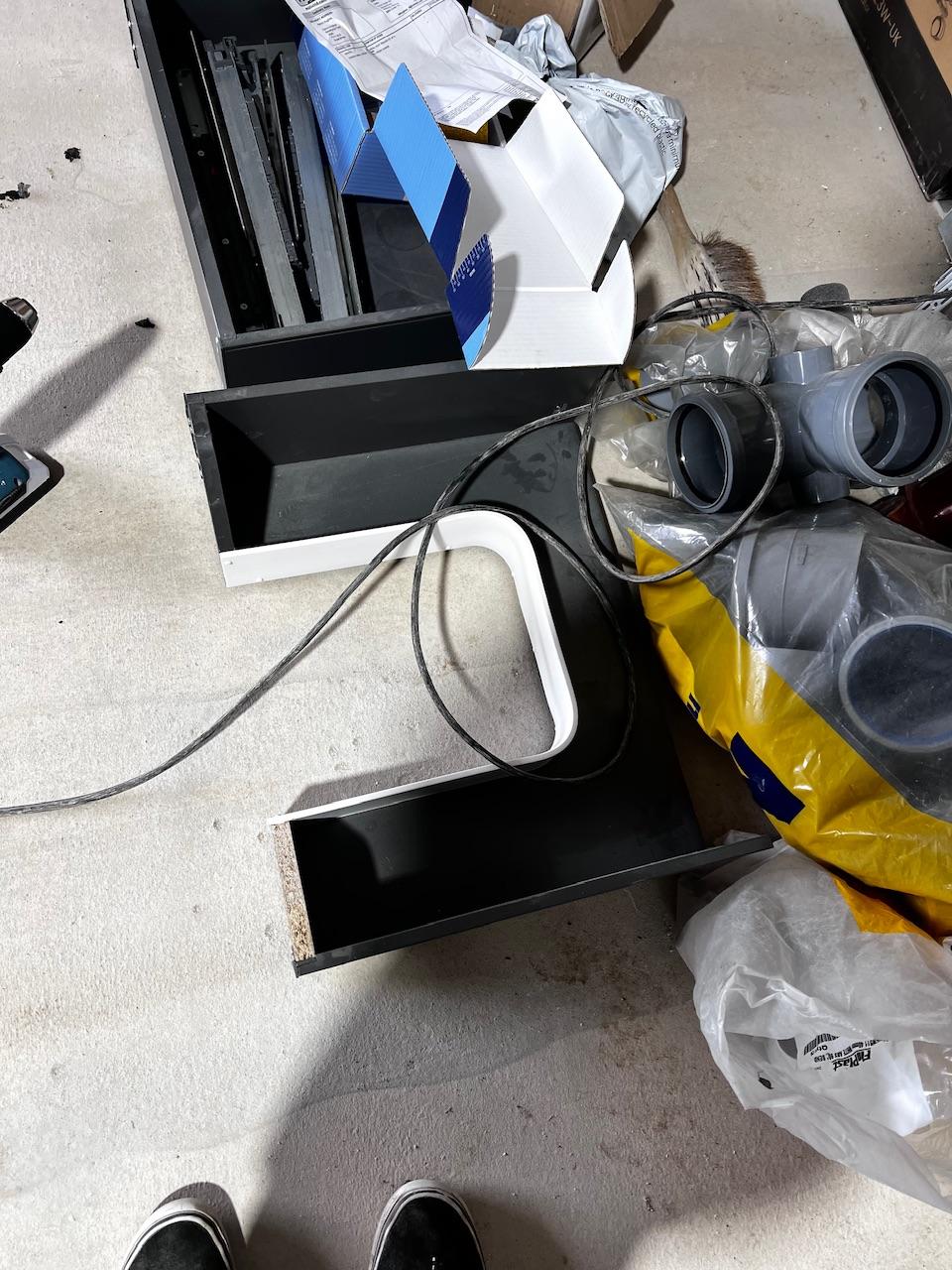

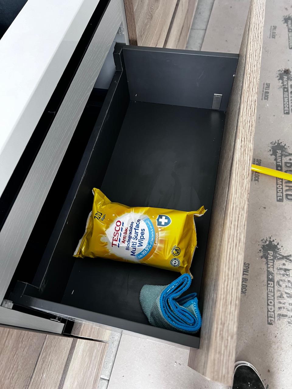

We have drawers everywhere £££. But they are a lot more useful. You can get the U shaped drawers for under the sink as we have one. However it fouled the bottom of our sink and didn’t leave enough room for the Quooker so be mindful of that. How we got around that was to have half depth drawers made up. They are big enough to be practical.

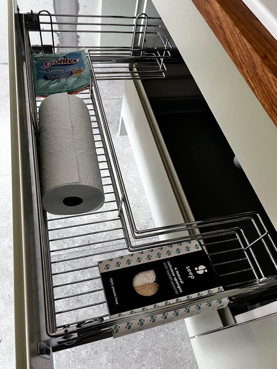

Diy kitchens on-line also do undersink U shaped drawers. We have one of those in the utility room. It’s a wire drawer.

Just to complete this with pictures. The top picture is the Diy online kitchens under sink drawer. The second picture is the U shaped Blum under sink drawer that didn’t fit as it fouled the bottom of the sink and the Quooker wouldn’t fit behind it. The bottom picture is how we fixed that problem with the two half depth drawers one of which  I cut down at the back to get it to clear the sink.
