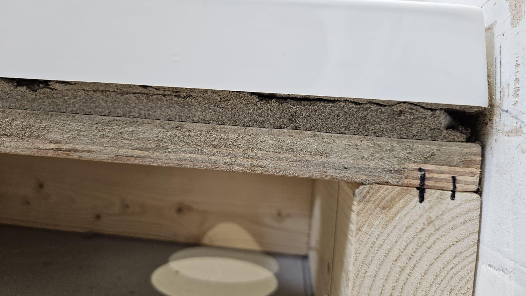

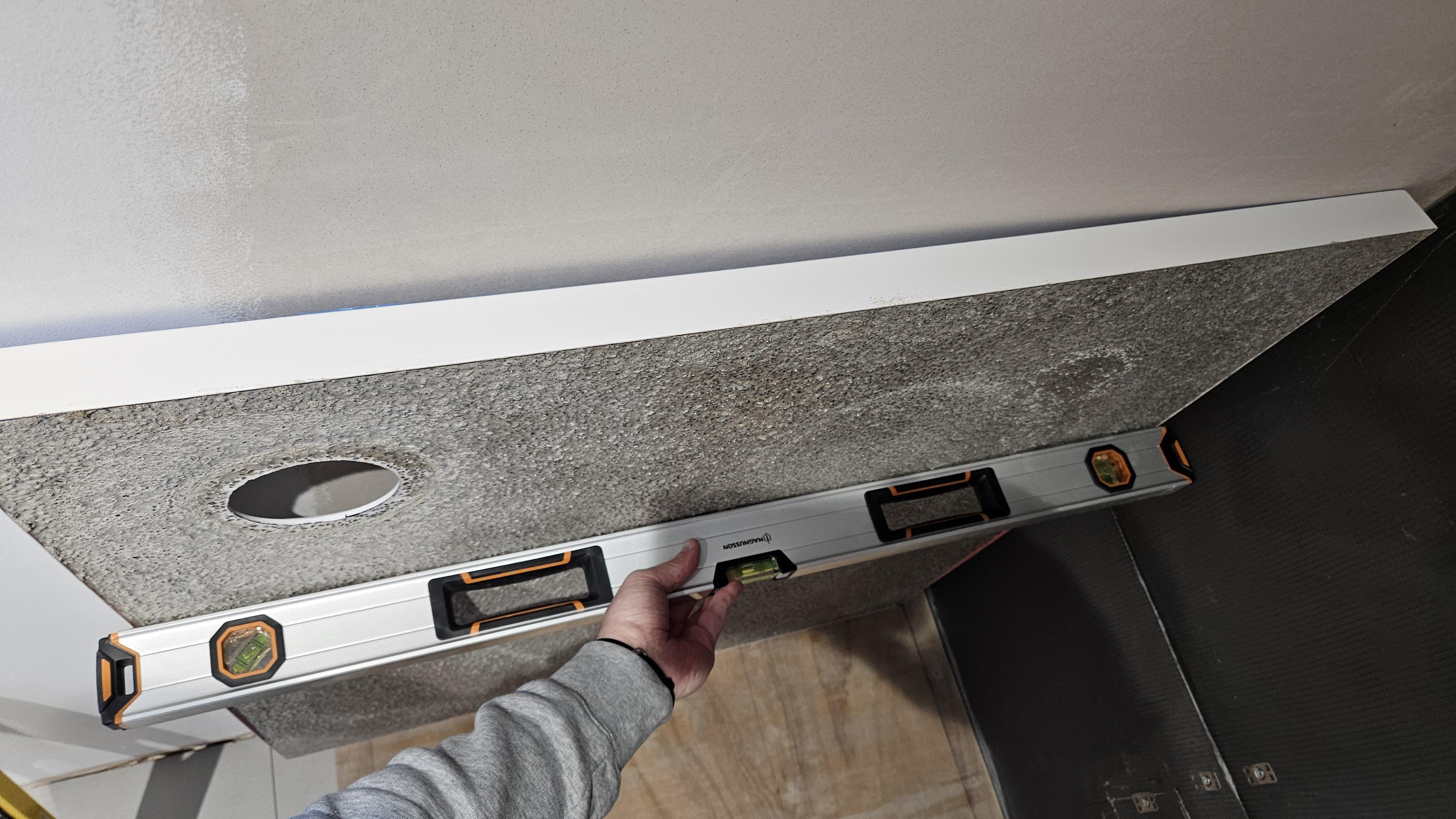

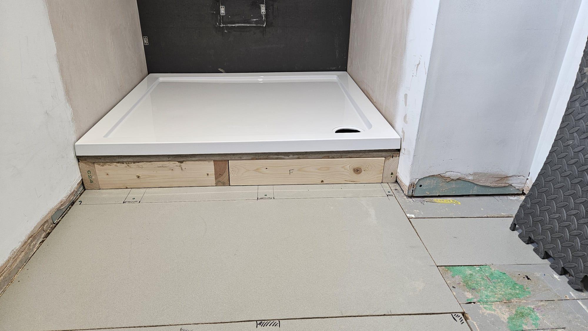

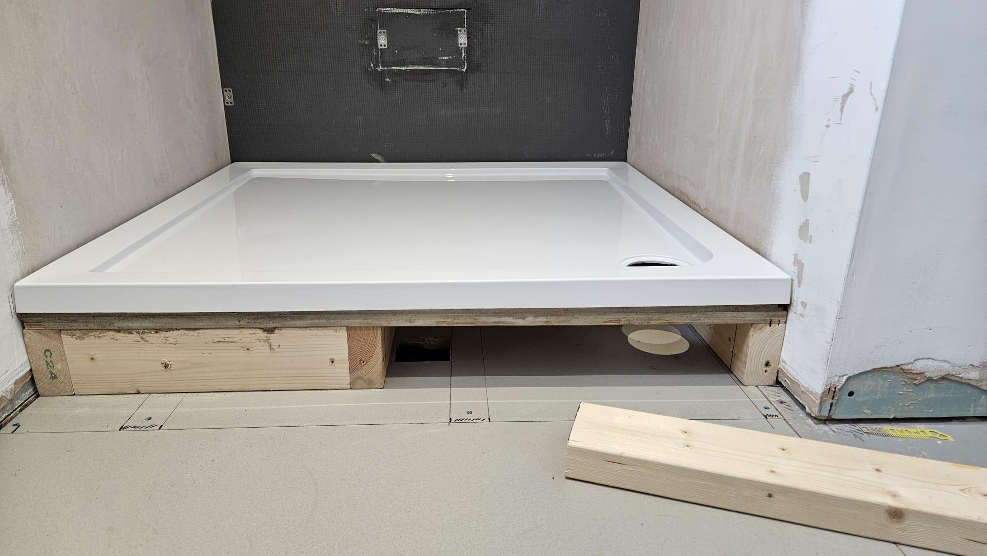

JamieG1985 Posted April 13 Share Posted April 13 Afternoon all, I'm currently in the middle of refurbishing our ensuite and having some issues bedding a stone resin shower tray on a 5:1 sand cement mix with a bit of plasticiser which is specified in the tray fitting instructions. It is being set on 18mm wbp plywood screwed to a fixed frame with plenty of support which is solid with no movement and is screwed into adjacent stud walls. There is access in the frame to fit the trap but a length of cls will be fixed in the void for full support. I primed the ply with 1:3 sbr/water mix before applying mortar mix. I'm not sure what I am doing wrong but the mortar seems to crack after a few days drying out and leaves a slight movement in the shower tray. This is now my second attempt and the same thing has happened again but not as bad this time, although there is a very slight movement on the corner where the waste is if i push it down. I've not yet sealed around the tray and I'm now convincing myself to rip it out again and just use a flexible tile adhesive which the manufacturer has agreed in an email that I can use as an alternative without voiding warranty. I've enquired about adhesive today and the guy in the shop recommended to use s2 flexible adhesive as opposed to s1 due to it having fibres and can flex more so the adhesive will never crack. I have since read online that s2 does not provide as much support as s1 so I'm just wondering if there is a prefered type to use in my situation. They quoted £30 for a bag of ultra tile s2 which I thought was steep but is available cheaper online. I've read a bit on the forum and I'd just like to check my methods before taking the plunge with tile adhesive... 1. Sbr the tray 1 part sbr 3 part water as per priming instructions on bottle (everbuild sbr bond). Not sure if I need to do the same to the tray, it's a hudson reed pearlstone tray and has a rough finish - photo attached. Also not sure if I should leave sbr to fully dry or apply adhesive when it is still wet. 2. The base is level front to back but there is a run of 5mm across the 1m wide tray. I could have packed frame but I thought it would be better to fix the frame solid against the floor and level out with the original mortar mix instead. With this in mind I was thinking to use a 12mm notch trowel to lay a 12mm bed of adhesive on the ply and also back butter the tray. Would this be a sufficient bed thickness to allow for the 5mm run when levelling out? 3. Fit and level tray. After adhesive has dried out, seal around edges and fit trap and remainder of pipework. Any advice or answers to my queries above are appreciated. Link to comment Share on other sites More sharing options...
