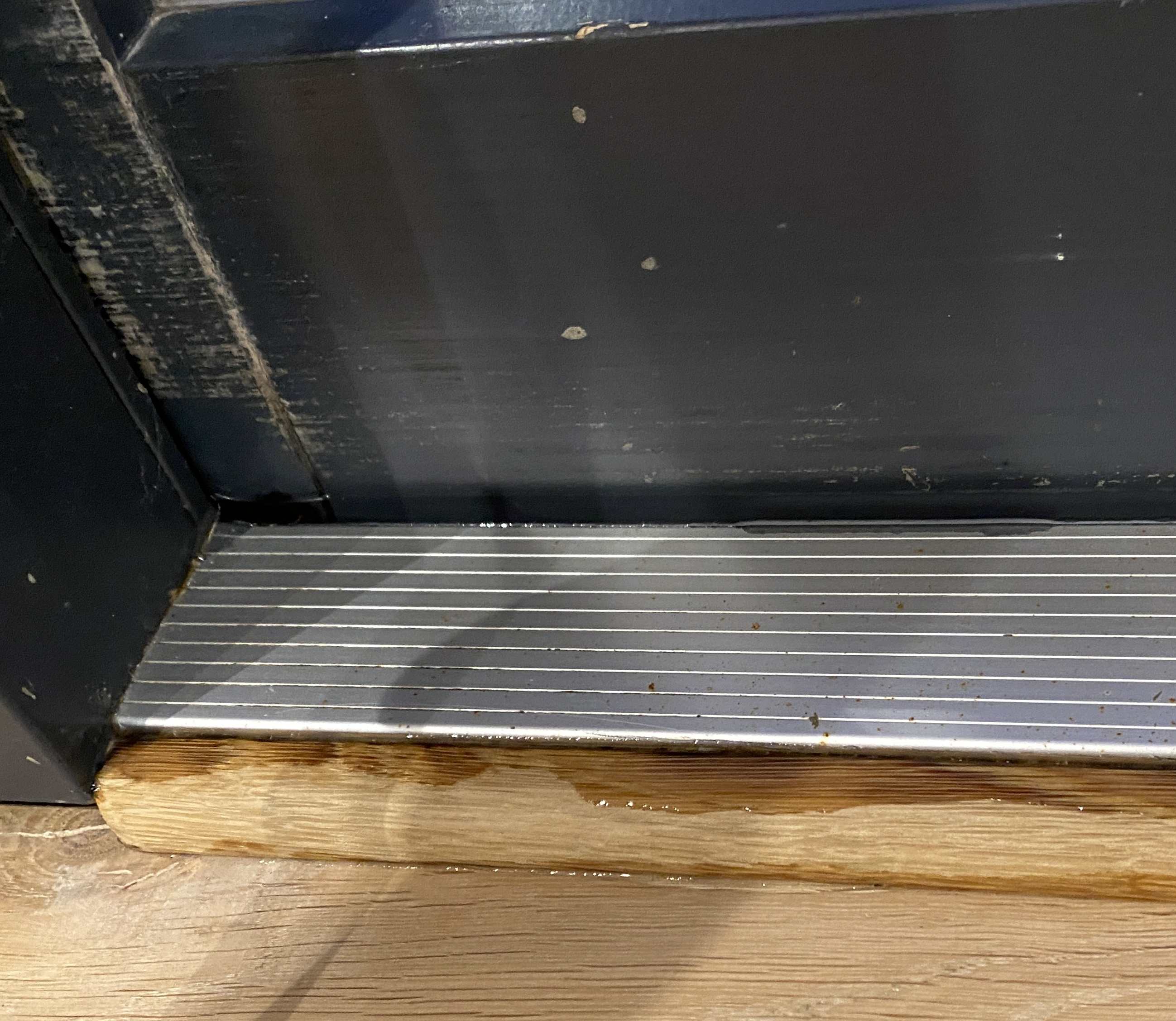

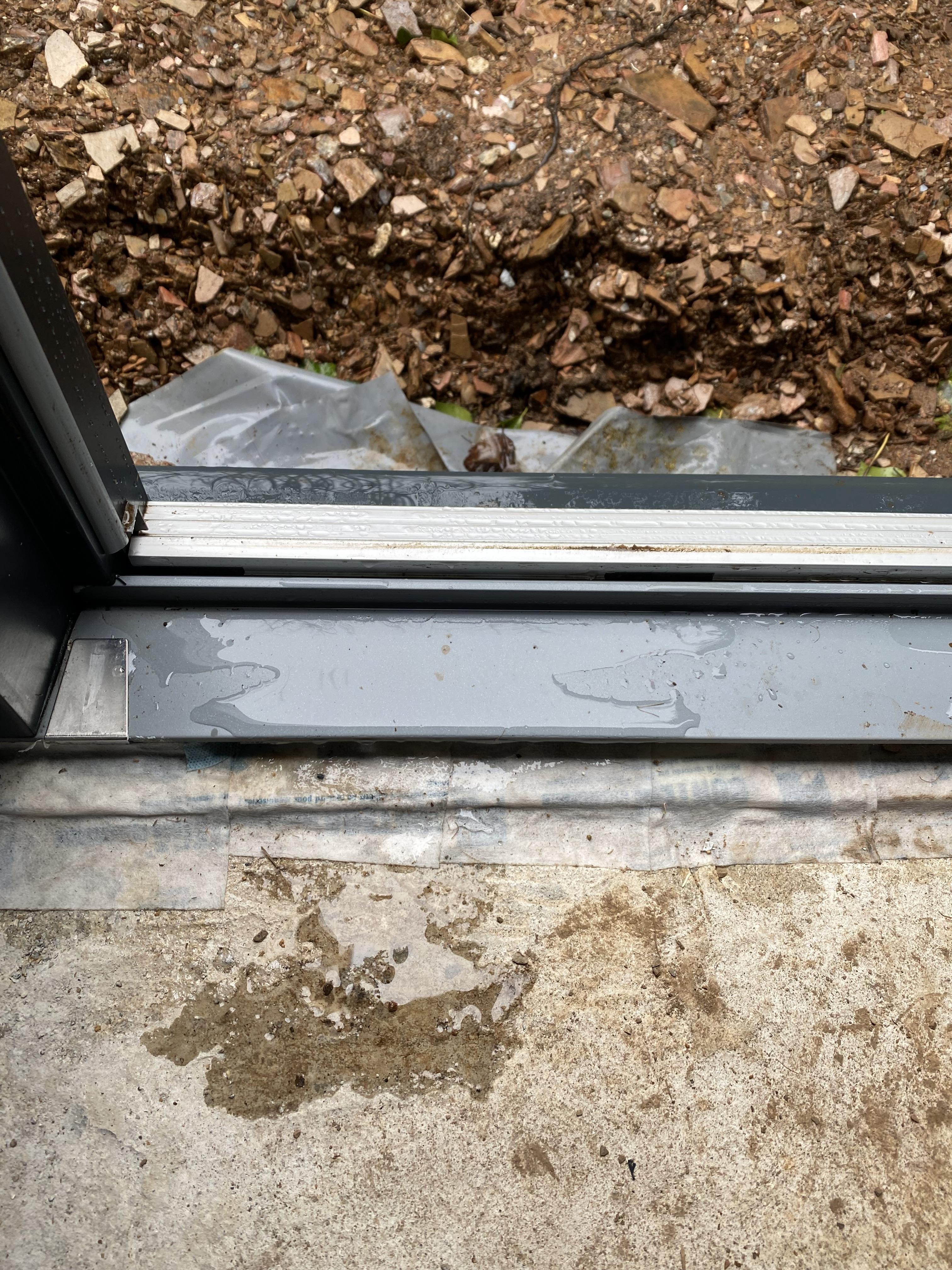

During the storm that passed through on Monday night we had a great deal of water come in through the back door. On opening it the door threshold was covered in water (see pic). Any thoughts about what might be causing this? The door and frame are aluclad timber frame from Rationel. IMG_5116.thumb.jpeg.81726b85ef60dc73dcd43e44872ba2d1.jpegIMG_5115.thumb.jpeg.8387da1ab21bb1dc2f590766881b47ce.jpeg
We have 1 set of inward opening Alitherm Heritage french doors which leak like this when the rain is being blown by the wind in the right direction. The doors drainage system gets overwhelmed. I used a hose pipe to test my theory. It is on my todo list to sort out. Luckily the rain usually comes from a different direction. I am hoping I can beef up the seals with a larger gasket. I might also drill two more drain holes.

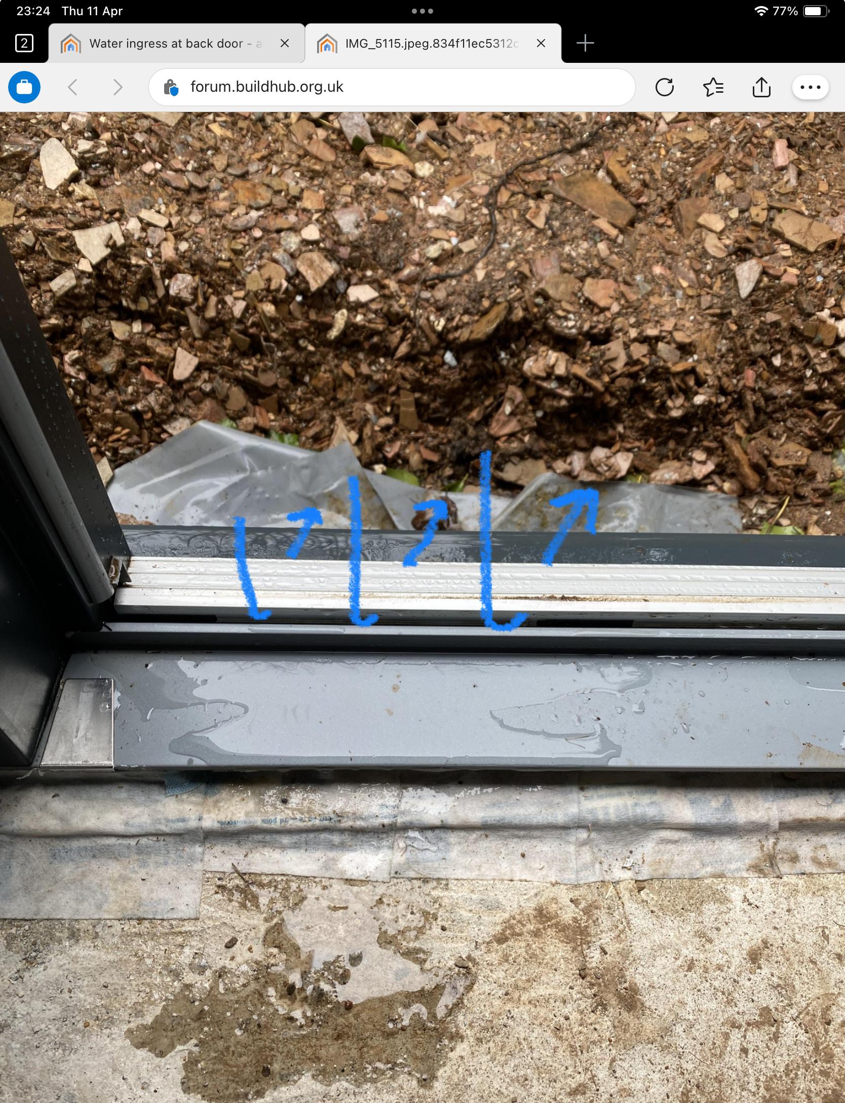

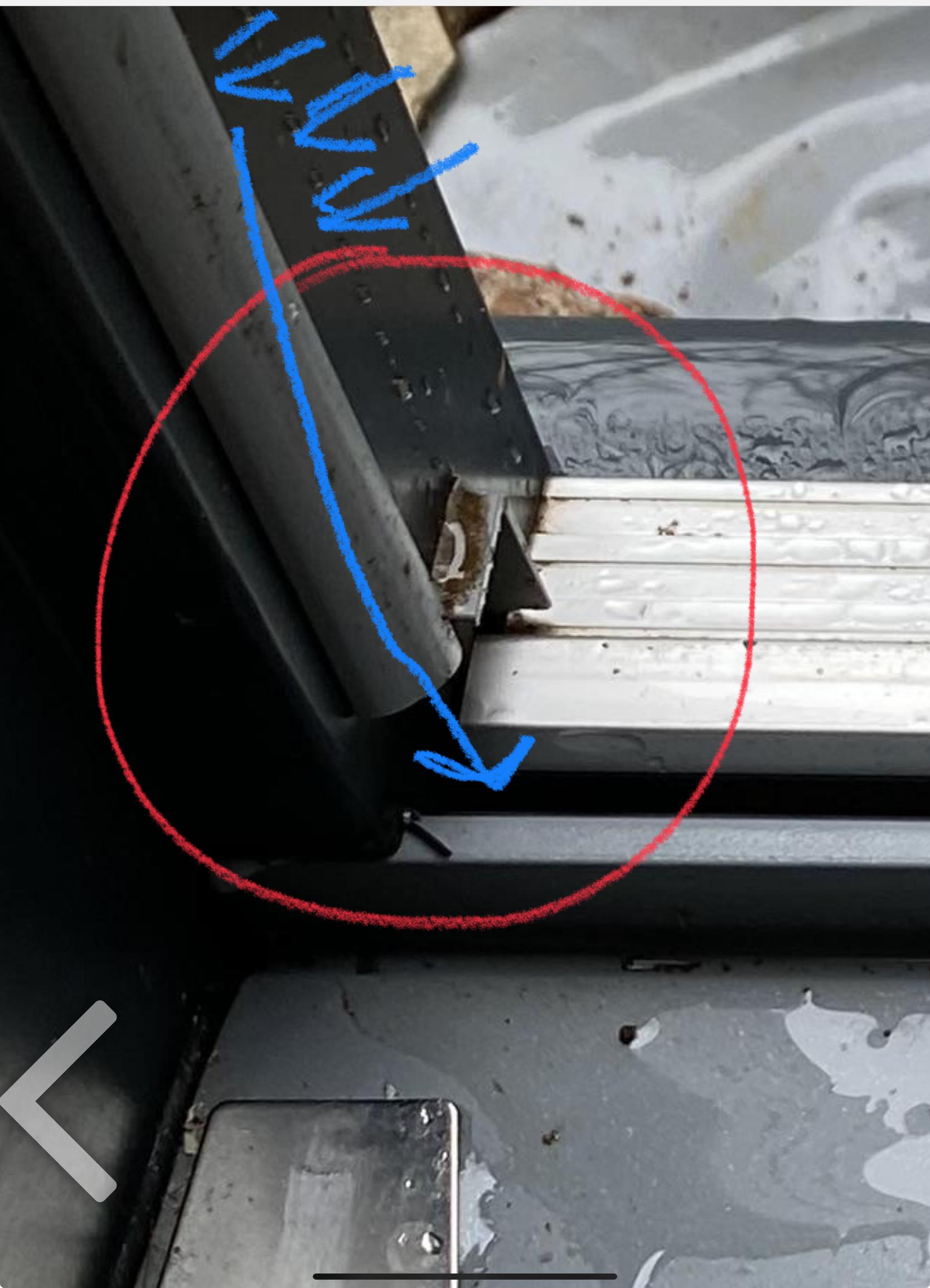

Looks like the rain runs down and is directed into the channel here and cannot escape.
Can it follow the route of my arrows to any external drainage holes?
Are they blocked?
Thanks Iceverge. There are wide drainage slots in that channel and I don’t think they are blocked, but I will check tomorrow. Looking at an earlier thread on this topic, it is an issue several people have had with Rationel doors due to improperly fitting door not compressing the rubber seal.

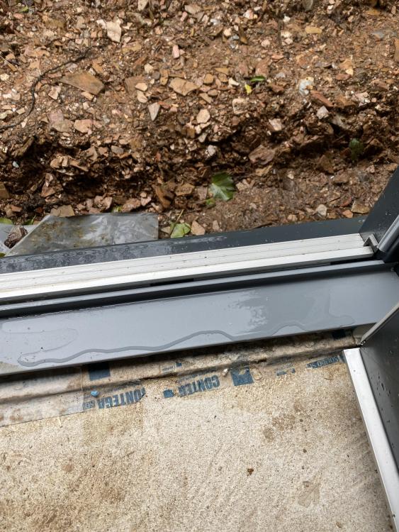

Hi Omnibuswoman - coming to this late but we’ve just experienced the same problem with our Rationel sliding doors during a fierce westerly storm in Scotland. Did you get a resolution? Reason I ask is that I have found the manufacturer less than helpful on another quality issue. I’m very much regretting that we spent £20k+ on 17 frames & doors from Rationel, especially as we are now up to 3 serious quality issues in the 3 years since installation. I’m afraid there will be some expensive post warranty problems to come. Thanks.
