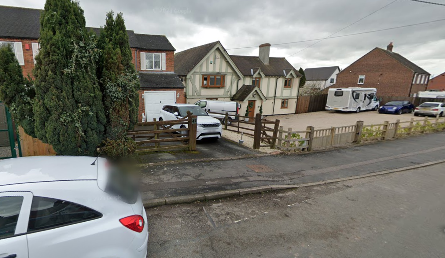

My mate self built a house just down the road from the place in the photo in this village, in the 90's
The day the earth caught fire underneath a Leicestershire village - Leicestershire Live (leicestermercury.co.uk)
(Sorry about the amount of Ads on the page.)
The BCO came to view the [deep] foundations, she said something like, "These are ok now, as we are down to natural" my mate had to correct her telling her there was a 50ft deep excavation there 10 years ago, so they are no where near "natural".
Same place now [see below] with builds on the place with the digger.
Not really answered your question, but puts some context into what can be done.
