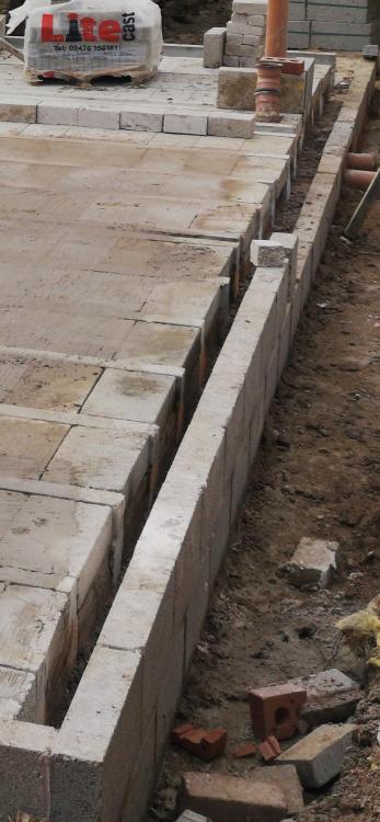

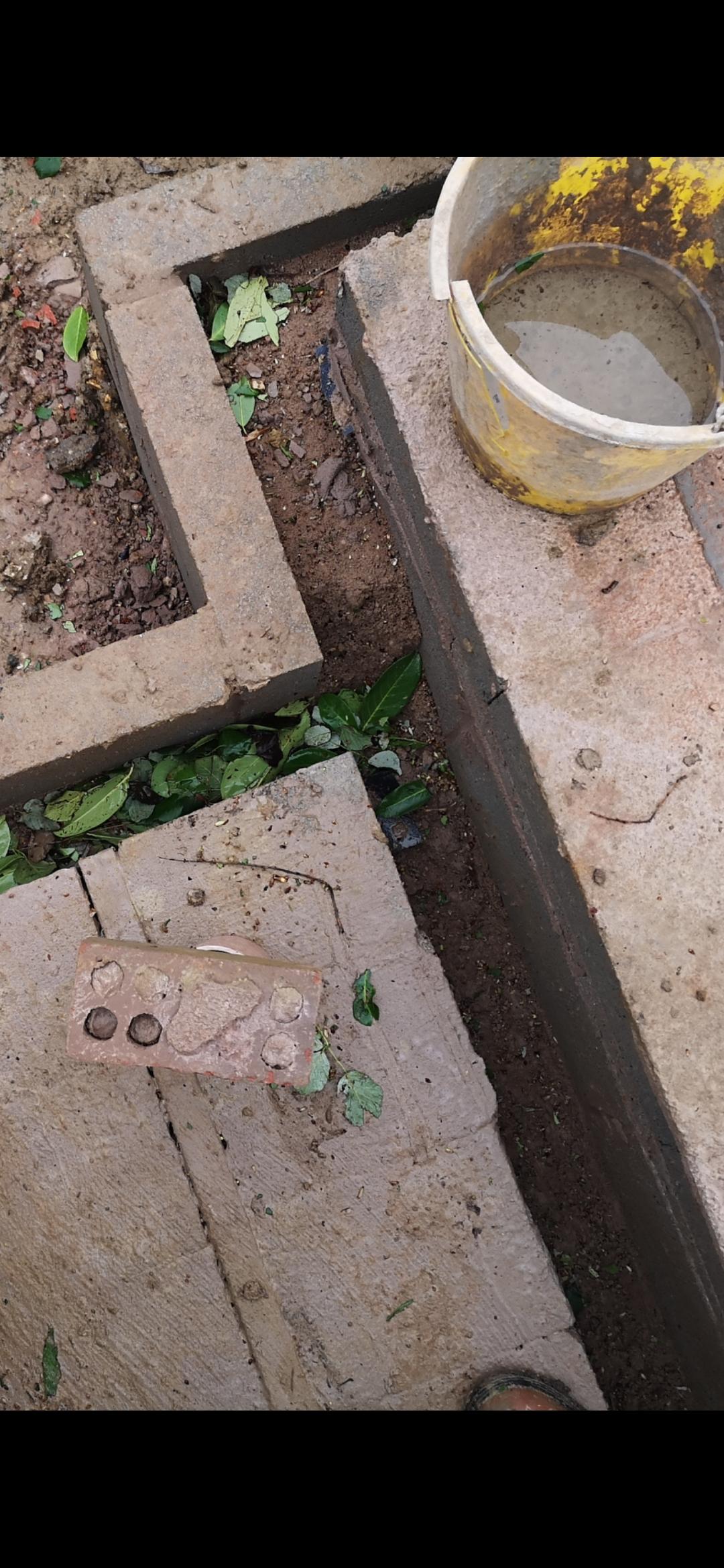

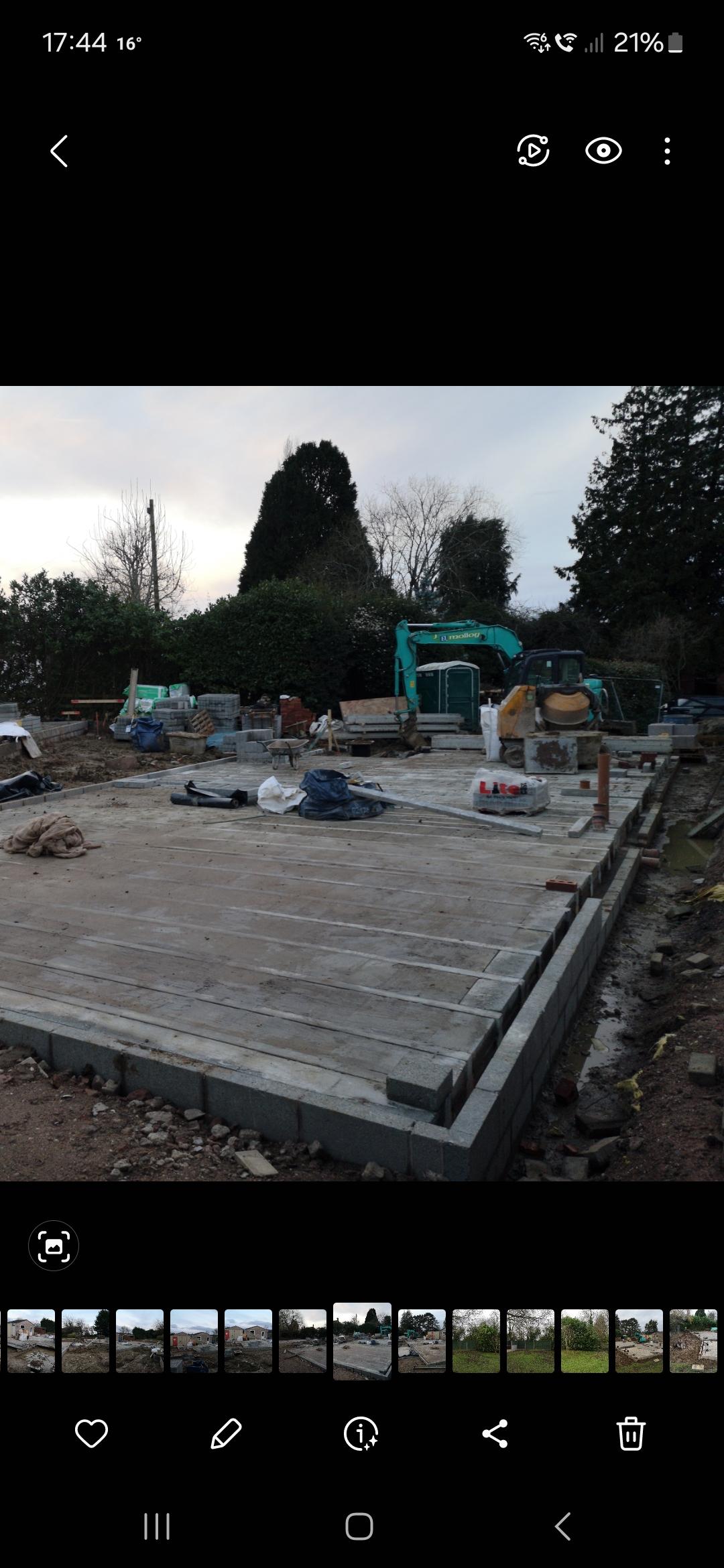

vik2001 Posted April 6, 2024 Author Posted April 6, 2024 Have a question on 1 side of the wall the builder hasn't built a inner leaf, he's using the concrete beam to act as the inner leaf to build the inner wall off. Is this OK to do?
Mr Punter Posted April 6, 2024 Posted April 6, 2024 20 minutes ago, vik2001 said: Have a question on 1 side of the wall the builder hasn't built a inner leaf, he's using the concrete beam to act as the inner leaf to build the inner wall off. Is this OK to do? If the beam is supported along its length you will be fine, if it only supported at the ends you are not at all fine.
Canski Posted April 6, 2024 Posted April 6, 2024 If there’s a cavity in that then the inner skin looks like it will be resting on the block. That’s a no no.
vik2001 Posted April 6, 2024 Author Posted April 6, 2024 This will be a cavity wall and the beam.is only supported at the ends, there is nothing supporting it below. It's a single storey wall 3m in length. What should I tell the builder?

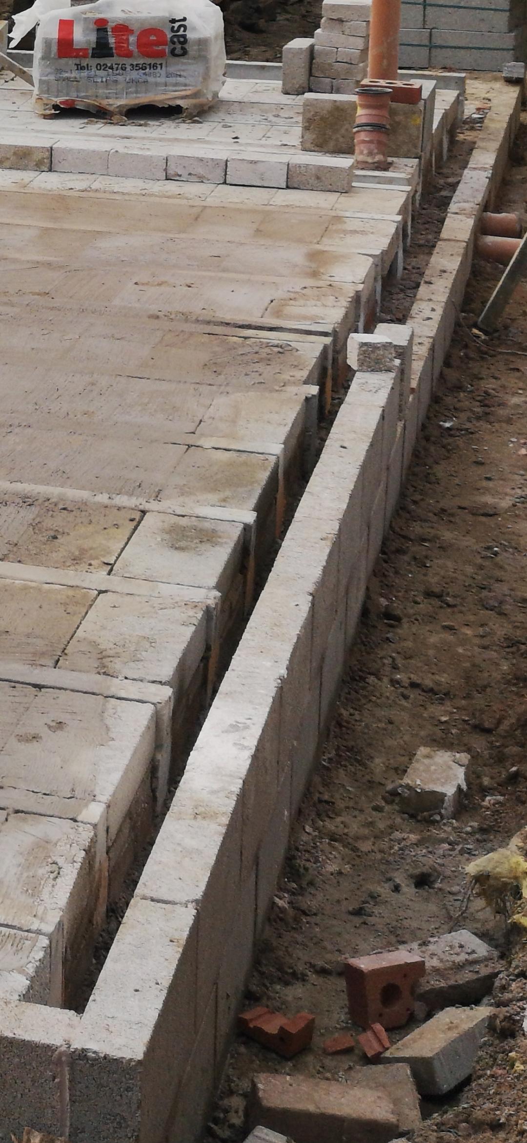

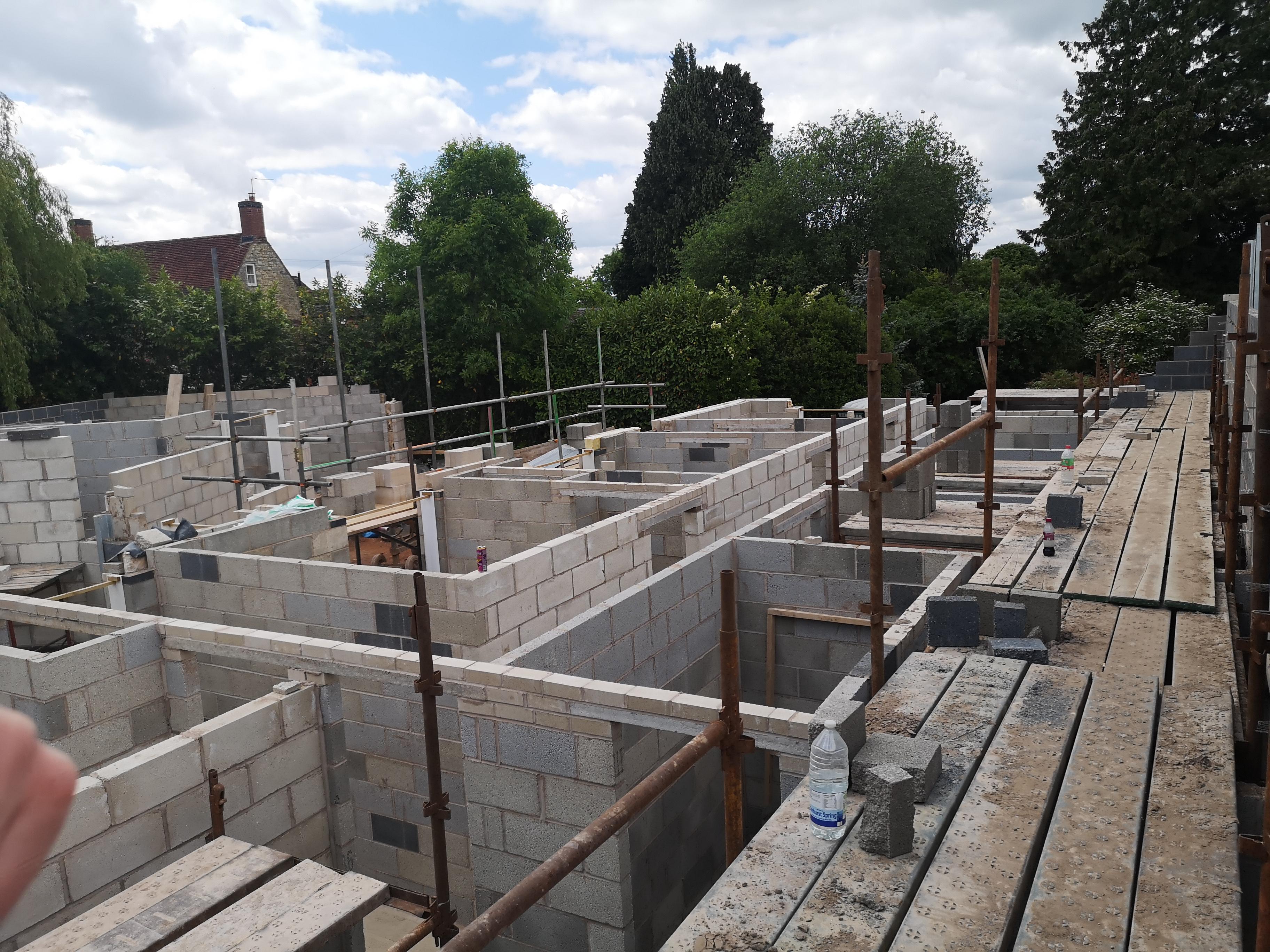

Andeh Posted April 7, 2024 Posted April 7, 2024 (edited) Show him my picture above, though maybe not this thread (avoid pissing him off by showing how much you distrust his work...) and ask him why 'my' picture has the beams sitting on the inner leaf and a cavity built out from them. Ill try and get you a batter picture. Edit... That being said, I don't think it's fixable without breaking out the brick wall and laying it again further out.... If your foundations are wide enough to do so. I'm also not sure what the 'issue' is with what he did other then a smaller cavity depth cavity (work hard to keep it cleaned of mortar dropping in) Edited April 7, 2024 by Andehh
Andeh Posted April 7, 2024 Posted April 7, 2024 (edited) For the edges I remember them laying a half brick down on the outside, then the block was supported by the beam on the inside and this half brick in the outside. Then again same done between the beams around the outside. I guess technically this means my inner cavity walls are sitting on the blocks, but these blocks are sitting on a half brick for the core of the strength. Sort of see them in this pic here. Edited April 7, 2024 by Andehh 1
Mr Punter Posted April 7, 2024 Posted April 7, 2024 I would arrange to meet with Building Control on site. Let them break the news to the "builder".
Andeh Posted April 7, 2024 Posted April 7, 2024 12 minutes ago, Mr Punter said: I would arrange to meet with Building Control on site. Let them break the news to the "builder". Even better idea!
