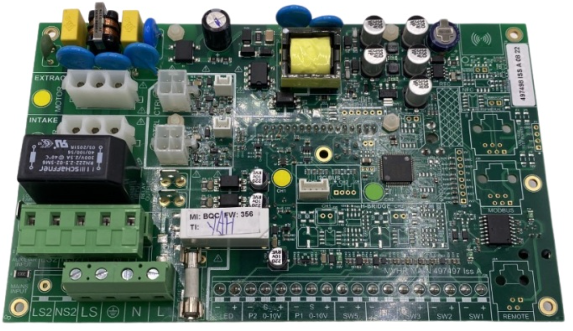

MikeSharp01 Posted April 8 Share Posted April 8 35 minutes ago, Jonro99 said: The PCB blew, I had it repaired but it still isn't working. OK so what blew the PCB one wonders. Does your board look like this: Found this here: www.uk-spares.com/ventilation-spares/heat-recovery/vent-axia/441486/vent-axia-497808 but not worth getting unless we can identify the cause of the blow out! Link to comment Share on other sites More sharing options...
joe90 Posted April 8 Share Posted April 8 1 hour ago, Jonro99 said: The PCB blew, I had it repaired but it still isn't working. Can your repairer point to what May have caused the fault? Link to comment Share on other sites More sharing options...

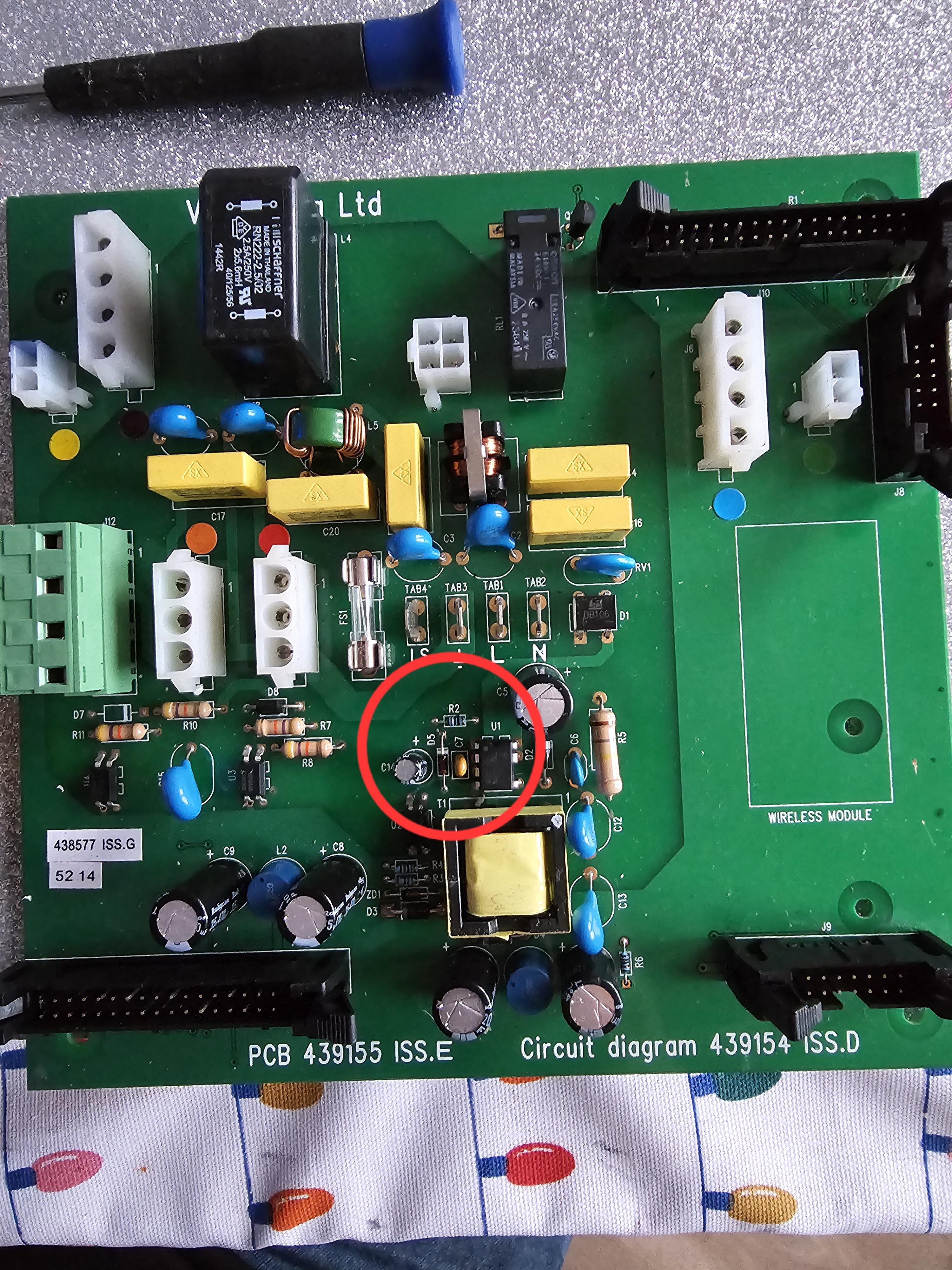

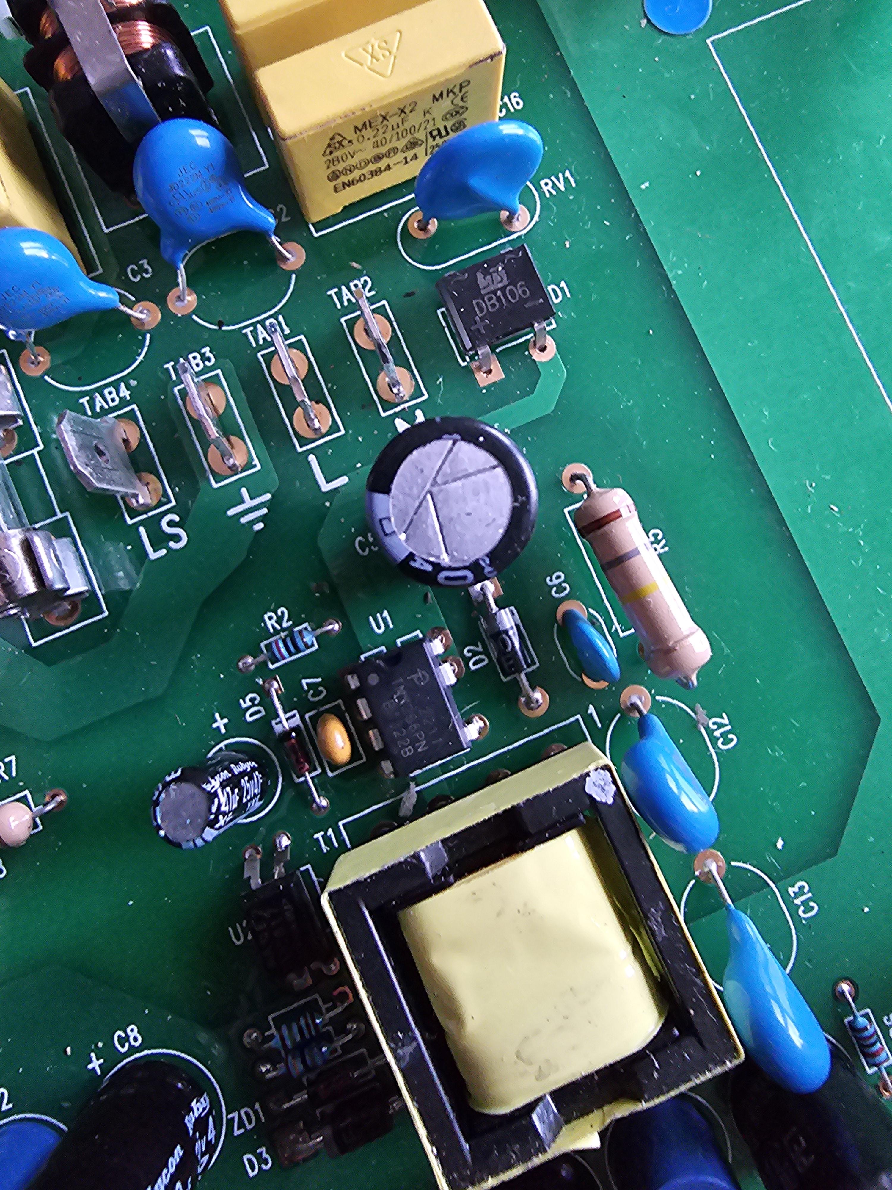

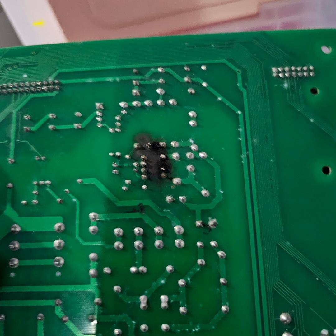

Jonro99 Posted April 8 Author Share Posted April 8 19 minutes ago, joe90 said: Can your repairer point to what May have caused the fault? the repairer isn't sure, it was an ic chip. 41 minutes ago, MikeSharp01 said: OK so what blew the PCB one wonders. Does your board look like this: 19 minutes ago, joe90 said: Can your repairer point to what May have caused the fault? Found this here: www.uk-spares.com/ventilation-spares/heat-recovery/vent-axia/441486/vent-axia-497808 but not worth getting unless we can identify the cause of the blow out! We aren't sure what blew it. Prior to it stopping working the panel showed an error code of 02 which is the extract fan. It was running very very loud so I turned it off at the breaker board. Turned it back on 24hrs later and it ran fine, then I noticed it was very quiet so I checked the display and it was blank. Went up in the loft and internal glass fuse had blown but so had one of the components. It was IC that blew. It think the chip in the above photo is the one that was replaced. I spoke to uk spares earlier today, they have 6 in stock. My board looks like the picture in the attachments. Link to comment Share on other sites More sharing options...

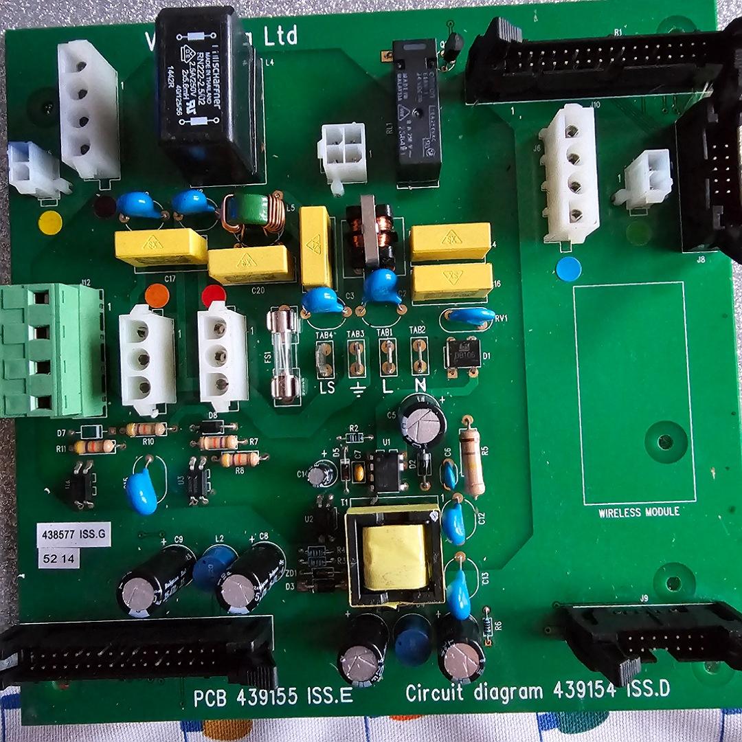

Jonro99 Posted April 8 Author Share Posted April 8 That is my board, one of the pre 2016 ones. one of these components blew before the internal fuse could protect the board. Now when I connect the board back up, with just the power to the board for the panel and then powering the main board (no components connected) it makes a terrible noise, which I think is coming from the black box at the top of the board next to the ribbon connector. Link to comment Share on other sites More sharing options...
Jonro99 Posted April 8 Author Share Posted April 8 (edited) Video The above link takes you to a one drive video of the noise the board is making. At this point the components were plugged in, when i turned the system off, removed the components the noise became constant rather than pulsing. Edited April 8 by Jonro99 Add information Link to comment Share on other sites More sharing options...
MikeSharp01 Posted April 8 Share Posted April 8 That's a relay - the black block, so assume it is turning on and off very fast if its making a noise - won't let me watch the video for some reason. The chip that blew up is part of the low voltage power conditioning circuit I suspect. The little yellow block close to it is a giveaway for that. The if we could know the number of the chip replaced we could confirm that. Link to comment Share on other sites More sharing options...
Jonro99 Posted April 8 Author Share Posted April 8 9 minutes ago, MikeSharp01 said: That's a relay - the black block, so assume it is turning on and off very fast if its making a noise - won't let me watch the video for some reason. The chip that blew up is part of the low voltage power conditioning circuit I suspect. The little yellow block close to it is a giveaway for that. The if we could know the number of the chip replaced we could confirm that. I can ask the guy tomorrow which chip it was. Do you have a wiring schematic for that board? Link to comment Share on other sites More sharing options...
