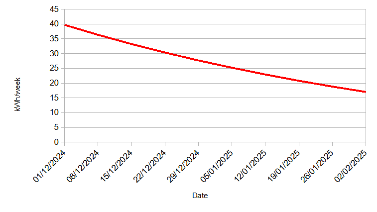

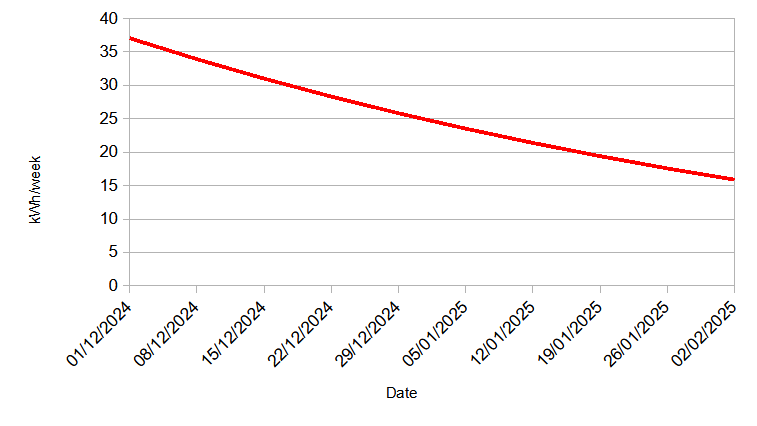

SteamyTea Posted April 4 Share Posted April 4 I use about 300 kWh/month in the winter to keep my house warm. So approximately 10 kWh/day. Initially I shall assume that there is no added input in December and January, so I need to store 600 kWh. Water would be the most cost effective medium to store energy in as it is cheap and easily transportable. Water stores about 0.00116 kWh.kg-1.K-1. So I would need, if I could get a ΔT of 40K (40°C up to 80°C as anything below 40°C would not really be useful) to store approximately 6,500 litres. If they were stored in rectangular vessels, I would need 7 m3, so quite a big hole. That is before adding insulation. Realistically PIR with a k-value 0.025 W.m-1K-1 is the most practical. So how much would I need. Assuming that my ground is at 10°C once deeper than 1 meter, the vessel is 7 metres long, by 1 metre wide and 1 metre tall, I would have a surface area of 30m2 to insulate. If I added 1 metre of insulation onto each side, then that is 9m by 3m by 3m hole I would need to dig, 81m3, the surface area would be 126m2, that is about half the volume of my house and nearly the same surface area (house is 184m2). So what would the heat losses be. R-Value = 1 [m] / 0.025 [k-value] = 40 U-Value = 1 / 40 [R-Value] = 0.025 W.m-2.K-1 Power [W] = 0.025 [W.m-2.K-1] x 126 [m2] x 70 [ΔT] = 220 W or 5.3 kWh/day. Knocking up a quick mathematical model, the losses, before any usage, look like this: So that is 254 kWh of useful energy lost. So what to do. Two options really (well 3). Add more insulation, which is expensive. Doubling the thickness will give a surface area of 270 m2 and a volume of 275m3. That is now much larger than my house, but no matter, lets work out the losses as I am full of hope. 2 metre thickness of insulation works out as a U-Value of 0.0125 W.m-2.K-1. Now this throws up a strange result, the losses are actually greater, 272 kWh total, because the total surface area has increased by 144 m2. Now there is some dispute as to where the thermal losses should me measured. I always use the outside area as this is larger. Just for a laugh, and I had a good snooze this afternoon, let us see what the losses are when using the surface area of just the water container, the 7m x 1m x 1m, 30m2. At a U-Value of 0.025, it is 60 kWh total, and at 0.0125 30 kWh. Now the truth is it will be somewhere between the two and without a much more detailed model, which allows for the corner affects i.e. effectively thicker insulation. So shall we settle on 155 kWh total losses. The second way is to increase the volume of storage by an extra cubic meter, that would store an extra 45 kWh but loose some of that to losses, about 7 kWh total. So we would actually have to add another 4m3, so a total storage of 11m3 of water. Now we could change the geometry to get the smallest surface area to insulate. This may need a custom container that is cube 2.25m on each side. Adding a metre thickness of insulation would expand that to 4.25m on each side, so a volume of 77m3 and an area of 108m2. The losses would now be 208 kWh total out of the original capacity of 510 kWh. Still not enough. Let us for a cube 3m on each side, that is easy as you can buy 1m by 1m by 1m vessels easy enough, and stack them in a cube. So that would have a storage capacity of 1254 kWh initially (at Δ40) and losses with 1m of insulation of 301 kWh, leaving a possible useful amount of 950 kWh. Big hole in the ground though, 5m on each side, 125m3 which is only 35m3 less than my house volume. Now I have only worked this out for a laugh, but I did it a few years back when @DamonHD and myself discussed it before, I think I came to the same conclusion, which is my third option, don't (expletive deleted)ing bother. 1 2 Link to comment Share on other sites More sharing options...

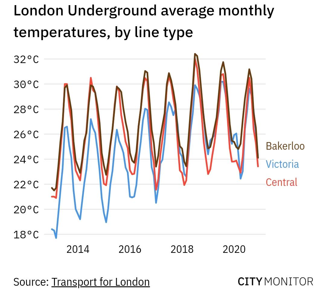

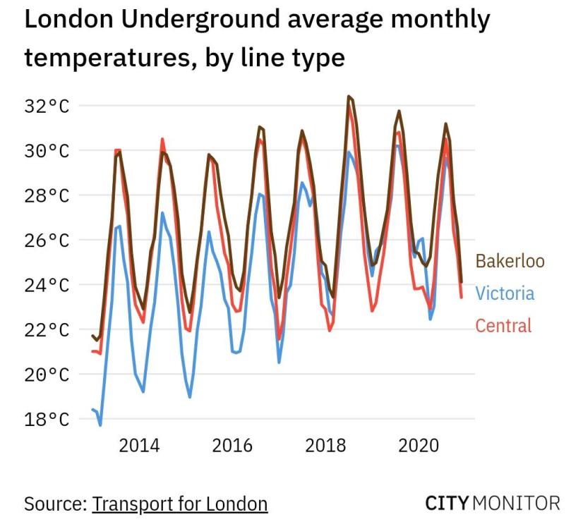

Iceverge Posted April 6 Share Posted April 6 There was a project in Drakes Landing in Canada. https://www.dlsc.ca/ Scanhome did one in Galway with an EPS insulted water store. https://www.scanhome.ie/pdf/Storing-Sunshine.pdf I think there was one near the Watford gap of the M25 to defrost the road in winter. The deep tube lines in London are probably the only successful (if accidentally) examples. They're heating up every year. Moral of the story, Build your house 50m underground. Link to comment Share on other sites More sharing options...
SteamyTea Posted April 6 Share Posted April 6 2 minutes ago, Iceverge said: The deep tube lines in London are probably the only successful (if accidentally) examples. They're heating up every year How much is caused by all the electric motors, and brakes, on the trains? Also, if the average OAT goes up, the thermal losses will go down. That should be easy enough to check. 5 minutes ago, Iceverge said: Drakes Landing One of the few towns that is a similar latitude as London. But. https://www.cbc.ca/news/canada/calgary/okotoks-drake-landing-solar-energy-repairs-future-1.7148389 Link to comment Share on other sites More sharing options...
Iceverge Posted April 6 Share Posted April 6 3 minutes ago, SteamyTea said: How much is caused by all the electric motors, and brakes, on the trains? A huge chunk of it I imagine. I suppose if you were able to install a subway train in your house that would account for a significant amount of the annual heat demand. It'd be irritating though. 1 Link to comment Share on other sites More sharing options...
