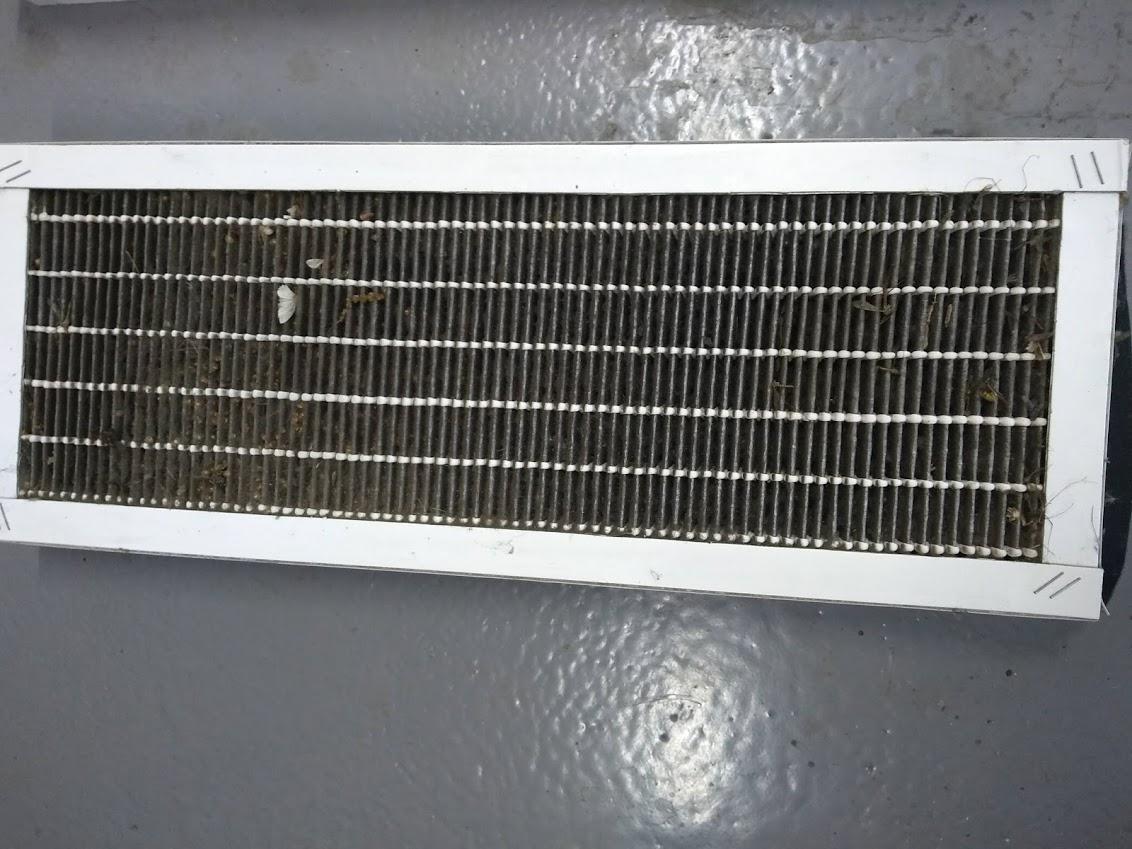

I have PAUL Novus 450 MVHR for a 5 bed house. I don't live a a city environment but in a semi-rural environment but near to a busy road.
PAUL recommend changing the filters every 3 - 6 months.  They are synthetic material/paper filters that cannot be cleaned, so have to be replaced.
  • I change the inlet F7 filter every 4 months  approximately as they get very dirty - see photo
  • I change the G4 exhaust filter every 2 years or so

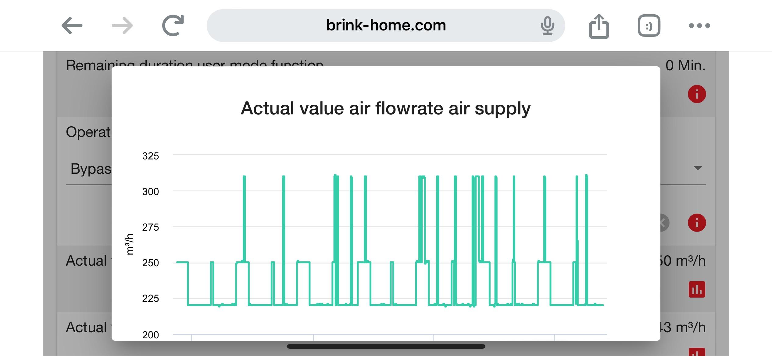

10 hours ago, dpmiller said:
is there any pressure-drop or flow monitoring on your unit?
Flow monitoring looks like this:
In addition to tracking flowrate supplied as per the above graph, it also tracks flow rate of the exhaust. The peaks shown here must be when we boost, although I'm not sure why it is showing three different flowrates: 225, 250 and 310 as i would have expected just two: our standard rate and our boost rate. Delving into this a bit deeper, I see that the unit is in "automatic mode" and that this seems to move the ventilation between three settings, 1, 2 and 3. The boost is definitely working because when we press the boost button, we hear the machine (whereas when it is not in boost mode it is virtually silent). The exhaust graph looks similar.
As for pressure, i believe I can check the current pressure levels on the unit itself, but not as a graph of historic data.
Is fan speed under closed-loop cantrol?
I'm afraid I don't know what you mean by this?
Link to comment
Share on other sites
some systems just display the "programmed" fan speed whereas some can I believe alter the fan speed to keep airflow constant as filter restriction rises. Seing a marked change in fan speed would hint at the filter being blocked in this case.
