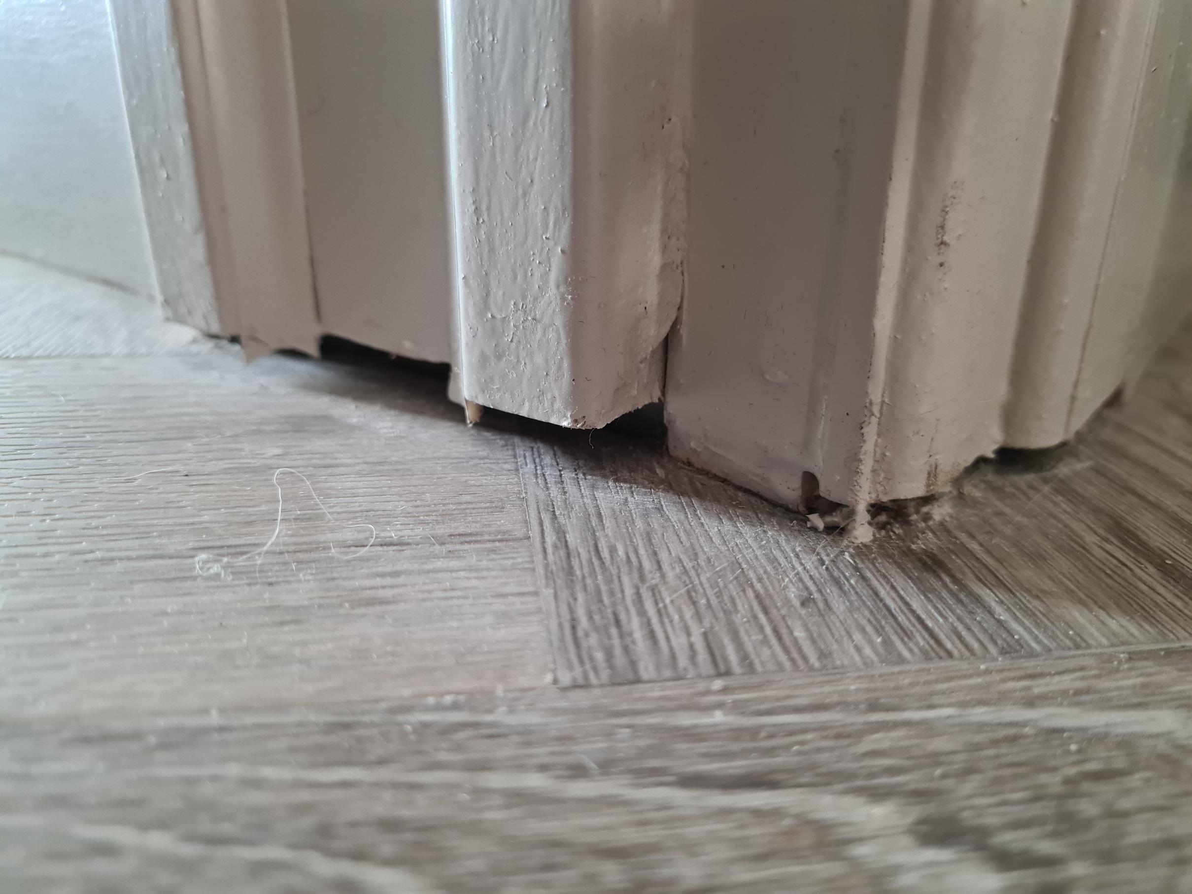

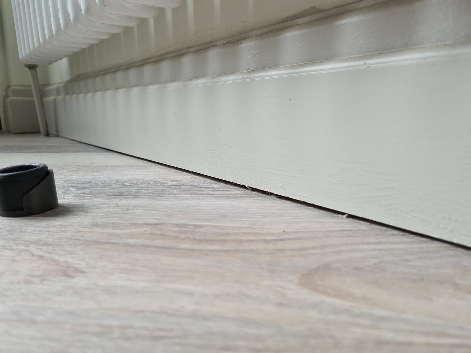

embra Posted March 30 Share Posted March 30 I'd like to fill and seal these gaps between our skirting boards and hard floor. They vary between 0 and 5mm. I'd like to paint whatever filler material is used to match the skirting. Ideally whatever is used would form an air seal to stop any draughts too. I'd thought of masking the floor align the line of skirting, and filling with decorators caulk finished at a 90° angle to the floor. Then painting as normal. Any other ideas? Not sure if there is any more robust putty etc that would do the trick? Link to comment Share on other sites More sharing options...

stu w Posted March 30 Share Posted March 30 Orcon f , it does not crack or shrink like decorators caulk etc Link to comment Share on other sites More sharing options...
JohnMo Posted March 30 Share Posted March 30 The smaller gaps should remain as they are to allow expansion and contraction of the wooden floor boards. If you seal the completely it will look great for a short while and the look rubbish with a few weather changes. Link to comment Share on other sites More sharing options...
embra Posted March 30 Author Share Posted March 30 3 hours ago, stu w said: Orcon f , it does not crack or shrink like decorators caulk etc Thanks for the recommendation, does it take paint ok? Link to comment Share on other sites More sharing options...
embra Posted March 30 Author Share Posted March 30 1 hour ago, JohnMo said: The smaller gaps should remain as they are to allow expansion and contraction of the wooden floor boards. If you seal the completely it will look great for a short while and the look rubbish with a few weather changes. The flooring is SPC, which apparently has much lower thermal expansion than wood / laminate etc. I think I'm willing to risk giving it a try on some of the larger gaps, worst case I can always rake it out if it cracks. Link to comment Share on other sites More sharing options...
Redbeard Posted March 30 Share Posted March 30 2 hours ago, embra said: Thanks for the recommendation, does it take paint ok? Hmm. Exactly what I was going to ask. I have used it a lot, but always hidden, so I have never tried to paint it. Anyone tried painting Orcon F? Link to comment Share on other sites More sharing options...
Chanmenie Posted March 30 Share Posted March 30 6 hours ago, embra said: The flooring is SPC, which apparently has much lower thermal expansion than wood / laminate etc. What’s your opinion of the SPC flooring ? Link to comment Share on other sites More sharing options...
Mike Posted March 30 Share Posted March 30 8 hours ago, embra said: 11 hours ago, stu w said: Orcon f , it does not crack or shrink like decorators caulk etc Thanks for the recommendation, does it take paint ok? Orcon F would be good as a bead on the floor to bed new skirtings into, but as it stays sticky I'd not want to paint it. Personally I'd just use a flexible caulk from a reputable brand. Link to comment Share on other sites More sharing options...
Hastings Posted June 19 Share Posted June 19 Expanding foam tape might work just for the draft-proofing, if you can get it into the bigger gaps. I used a lot of it between all my structural wall panels in building a timber frame house. It helps prevent thermal by-pass. It's also used by the best tradefolk, to fit windows. Link to comment Share on other sites More sharing options...
Dave Jones Posted June 21 Share Posted June 21 take it off and scribe it. Link to comment Share on other sites More sharing options...
