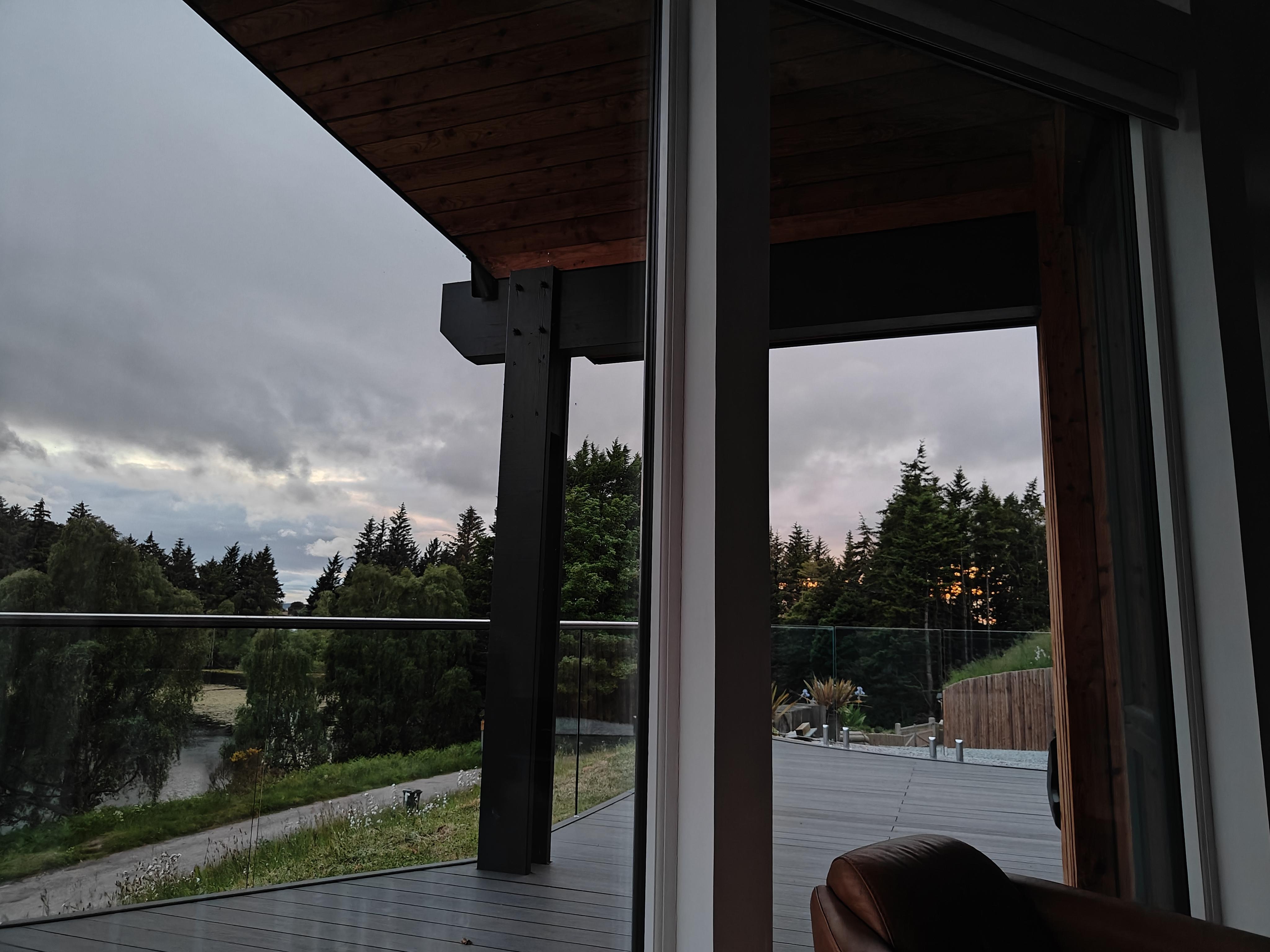

JohnMo Posted June 2, 2024 Share Posted June 2, 2024 15 minutes ago, mjc55 said: glazing for our West elevation, are also planning a large overhang (around 2.5 m.) on this elevation This is unlikely to help, as when the sun gets to the west the sun will be low enough to shine straight under the overhang 1 Link to comment Share on other sites More sharing options...
mjc55 Posted June 2, 2024 Share Posted June 2, 2024 2 minutes ago, JohnMo said: This is unlikely to help, as when the sun gets to the west the sun will be low enough to shine straight under the overhang This did occur to me! What doesn't make sense is that in the times of the year when the Sun is strong enough to be an issue, it will not sink below the overhang until much later when it is losing it's strength. In the winter months surely solar gain is as much of an advantage and would outweigh any gain! I need to look into this further, there must be ways of mitigating, how else would some of the "grand designs" that exist nowadays ever get through planning and Building regs? Link to comment Share on other sites More sharing options...
JohnMo Posted June 2, 2024 Share Posted June 2, 2024 35 minutes ago, mjc55 said: What doesn't make sense is that in the times of the year when the Sun is strong enough to be an issue, Winter gain and summer gains are different sides of the same coin. Winter you will take all you can get from solar gain. We have close to 4m overhang, but a wall of glass some of it due west, by 2.30pm today we had to close the blinds to keep the sun out. Currently 23 in living room and 14 outside and we had the UFH cooling on for about 6 hrs today. Don't underestimate the power of the sun when mixed with glazing. This is a photo taken just now, due west the sky you see is the path the sun takes and it drops behind the trees. You can see the glow of the sun behind the trees to right. 1 Link to comment Share on other sites More sharing options...
PNAmble Posted June 3, 2024 Share Posted June 3, 2024 We have a 1.2m overhang which ‘shifted’ the peak solar gain by a few weeks, plus reduced the maximum modelled room temp by a couple of degrees. We’ve also added external Venetian blinds on our south facing 5m sliding doors and windows. The Part O modelling will also inform which windows should be opening as well to provide purging. it’s also worth saying if you are going airtight and MVHR, the simplified spreadsheet doesn’t take this into account, if you get it modelled MVHR is accounted for in the over heating assessment. 2 Link to comment Share on other sites More sharing options...
