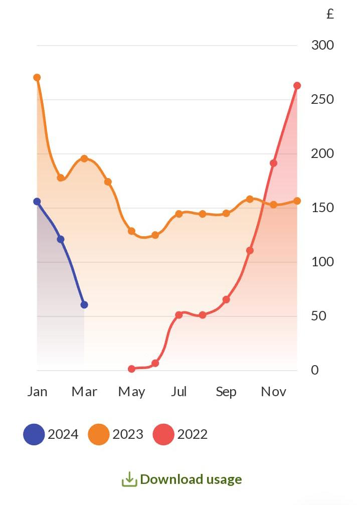

All the reading of posts on here at the design stage  and the hard work implementing the experience of others on your own self build can be summed  up / justified with just 1 image. Even when building on a very tight budget.
This is my energy usage @ The Windy Roost since we got here.  Upto January 24 we were in the static, we were never really warm used Air to Air heatpump for heating, hot water and cooking was LPG. We also had around 4 summer months of our cabins being used, again electricity for heating and cooking, DHW is LPG.
The blue line makes me feel warm and fuzzy inside. That's our electricity for the self build, a whole house fully electric and blissfully warm with ample DHW. (With some limited cabin usage).
To all self builders going through this, it's worth the effort👍.

Just now, Iceverge said:
@Jenki
Is it an ASHP you use?
Yes. 5KW Samsung with Gen6 controller. UFH in 120mm Concrete
I agree. Many things can also be done to an existing house. My annual usage is a gnats over a quarter what they were when I moved in.
