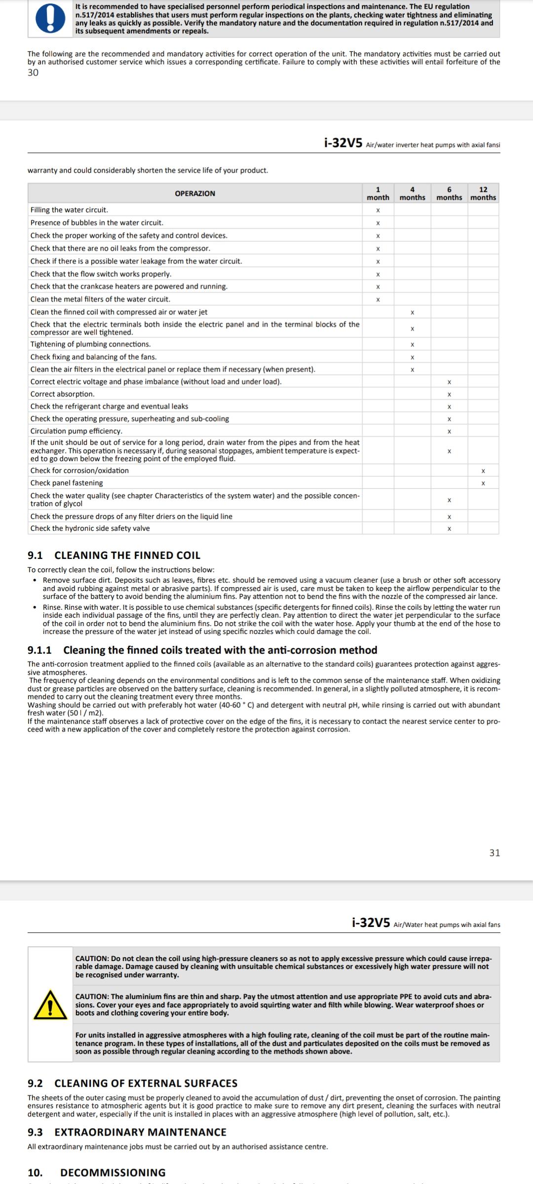

Out of interest, how much is a typical annual service?
Often things like G3 can be hidden in UVCs and filters in MVHR which often have a very large % impact in annual costs, especially for efficient users.
I've just paid £85 +vat for a service on the external unit, but as they're principally aircon engineers they don't do any more than a cursory glance over the indoor unit.  I check/clean the water strainer on the indoor unit myself. I tried to get a plumber to service the uvc/expansion vessel, but they pretty much said its a waste of time and no-one bothers...
Would the same £85 be the same for a monoblock do you think or is it only the split gas system you were interested in?
A snippet from my ASHP manual, showing the service requirements. Would doubt most is actually done.
