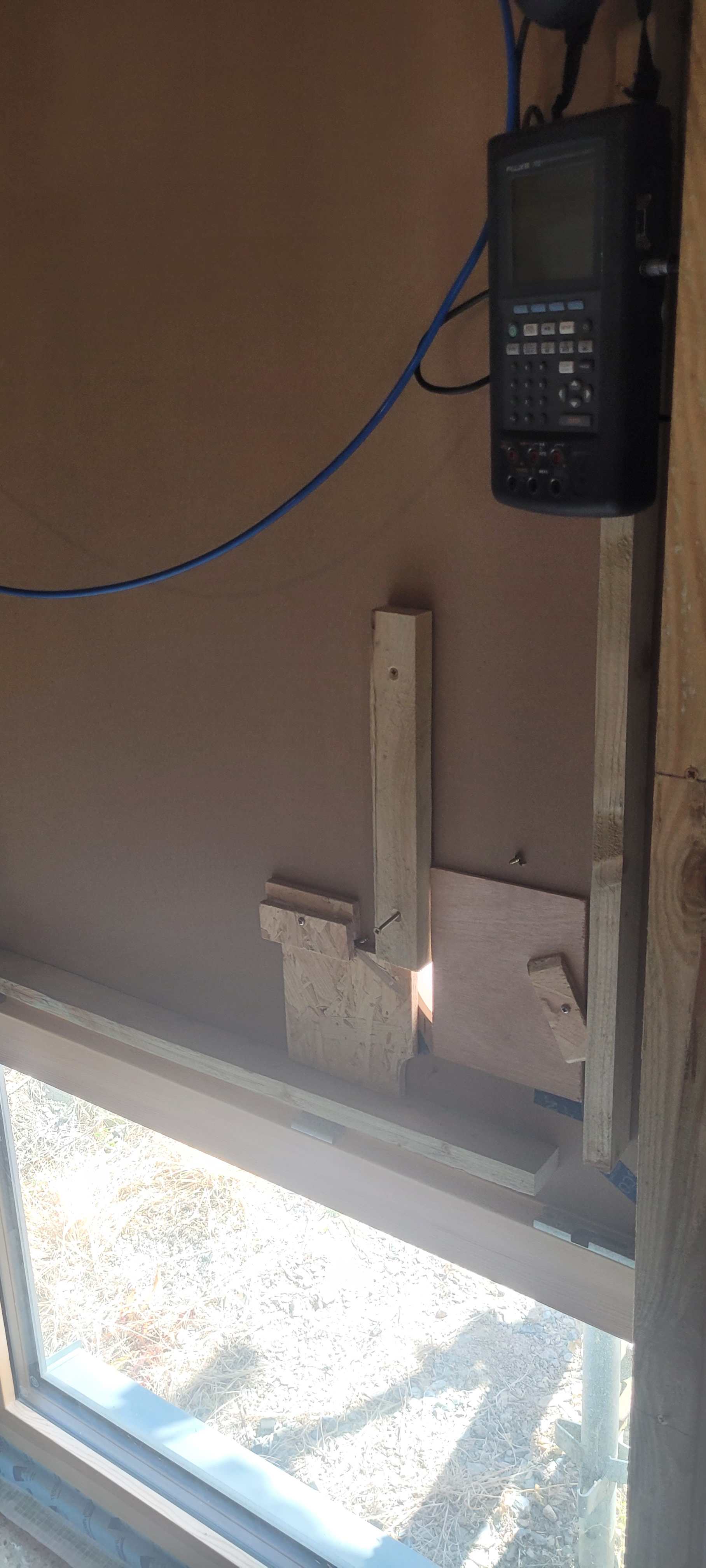

Iceverge Posted December 8, 2024 Posted December 8, 2024 Make a DIY blowerdoor fan yourself before Aerobarrier come. You will get 90% of the way there by yourself.
TerryE Posted December 8, 2024 Posted December 8, 2024 27 minutes ago, Iceverge said: Make a DIY blowerdoor fan yourself before Aerobarrier come. It doesn't have to be a door of course. Depending on the diameter of your fan, it might be easier to fit one to an opened window light.
Iceverge Posted December 8, 2024 Posted December 8, 2024 (edited) 20 hours ago, TerryE said: It doesn't have to be a door of course. Depending on the diameter of your fan, it might be easier to fit one to an opened window light. Yeah we did a sheet of OSB with a fan in a window. It sealed nicely against the gaskets. Dead easy, just measure the tilt and turn sash and cut the OSB the same. It stayed in there for weeks. Edited December 8, 2024 by Iceverge 1

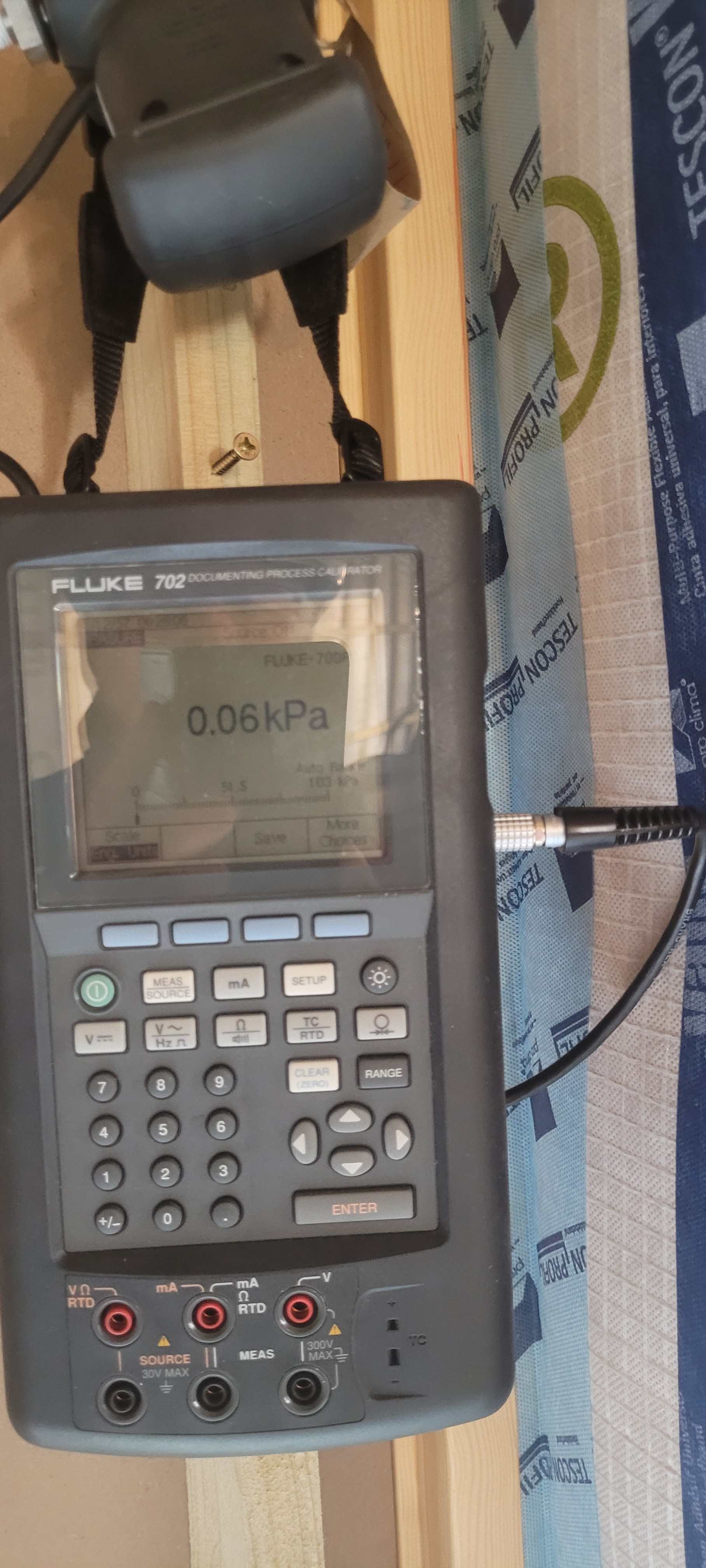

MikeSharp01 Posted December 8, 2024 Posted December 8, 2024 We did the same but I used a variable speed dust extraction unit and even on the slowest speed I had to restrict the hole so much to get it to hold the pressure. 1
Iceverge Posted December 9, 2024 Posted December 9, 2024 Did you manage to get any useful readings from it?
MikeSharp01 Posted December 11, 2024 Posted December 11, 2024 Yes - were within 5% of the official test a few days later.
