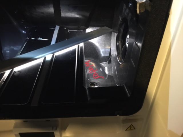

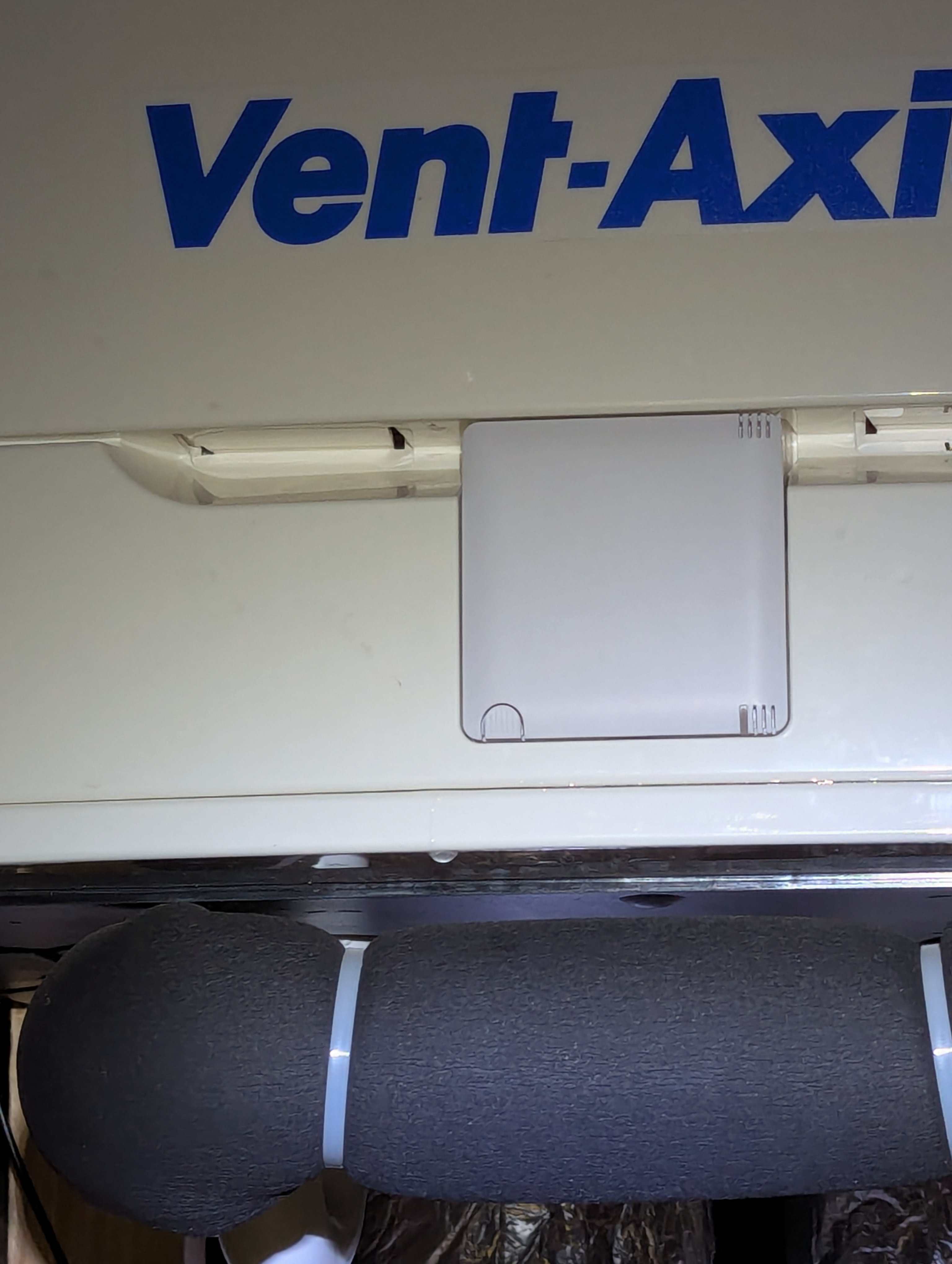

March 14, 20242 yr Vent Axia Sentinel Kinetic Advance S (405215) - The installation engineer has come back quite a few times and Vent Axia came on Monday but it's still not clear why I have this problem. Wondered whether anyone has any suggestions? In colder or wetter weather (maybe both?) I have water leaking out of my MVHR unit - I've had it leaking out of drain and front of unit. Also the heat recovery seems very poor to me (eg 0 degrees outside, supply temp 11 degrees, room temp 20.5 degrees). And the machine reads a significantly higher RH than my hygrometer in a bathroom and the house doesn't feel damp (eg. 76% vs. 66% RH). First of all it seemed to be working brilliantly and condensation disappeared overnight (weather was warm for December), supply air was around 19 degrees on the app. We had a very cold spell in January and I don't think it's been working right since then. We also had ASHP installed at the start of the cold spell. Last Friday it was leaking out of the front of the machine near the bottom. I took the cover off and removed the heat exchanger which had condensation on the outside and lots of water slooshing around inside it. I tipped it up and emptied most of the water out. There was also water in the RH (unused) drain which there shouldn't be as the unit is left-handed. I removed the RH blanking cap and got rid of the water. I poured a jug of water and Milton down the LH drain - def not blocked. This week I removed the drain cap on the RH side and put a bowl underneath because the unit still sounded very wet after Vent Axia visit but since I drained the water that was sitting in the RH drain there's hardly been any water from the RH side (over 2 days). The weather has been warmer and dryer. I put the RH drain cap back on today. I have the installer coming to fit a drain on the RH (supposedly redundant) drain. VA engineer thought this might be a good idea even though it shouldn't be needed. The unit can be left- or right-handed depending on where you vent to the atmosphere and you use either a left or right drain. Background: I bought an MVHR system from BPC and had it installed by someone BPC suggested in December 2023. retrofitting a 1961 bungalow, 134 m2 main purpose - to get rid of condensation problem and allow me to get more airtight secondary purpose - heat recovery (save energy) unit and ducting in cold loft, ducting is insulated (25mm foil backed glass fibre - should I have got 50mm? I was told no one uses that) unit is mounted on the north gable wall (brick) this is a branched system with 125mm METAL ducting (my choice) 4 extracts, 7 supply vents commissioned normal extract 35% / supply 55% speed setting boost - extract 45% / 56% supply speed setting condensate drains into a gutter (under the eaves) because there isn't a bathroom near enough to get a 5 degree fall I changed filters a few weeks ago as they were very dirty.

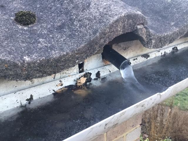

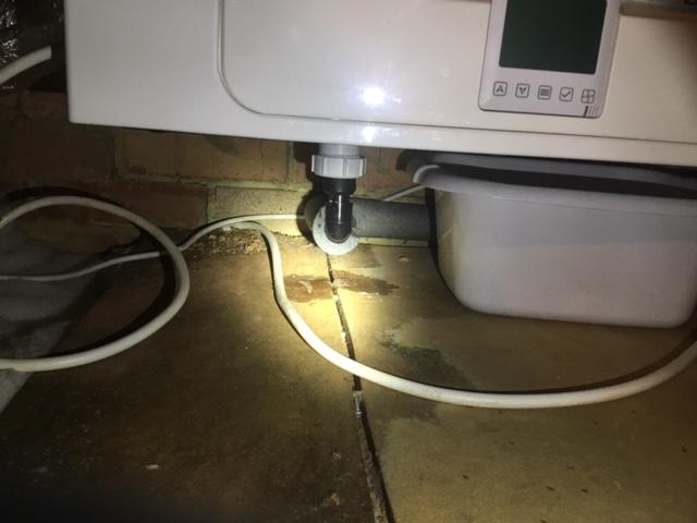

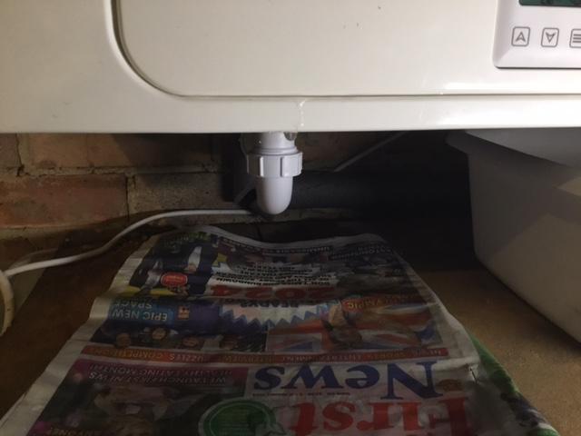

March 14, 20242 yr Author FROZEN CONDENSATE The installer initially refused to insulate the condensate pipe (I told them building regs and instruction manual said this was essential) then it froze (and machine was leaking) and so they decided they would insulate the pipe (they claimed they'd never seen a loft freeze before). They didn't insulate along the entire length into the eaves so when we had the very cold weather it froze and the machine was leaking out of the RH drain cap. I was concerned that the machine had been damaged by this but Vent Axia seemed to think the machine was fine when they inspected this week. They agreed that there shouldn't be water in the RH drain. They said there was excess water coming from the duct/ducts connected to the atmosphere but they didn't know why. Their tech team said they might replace PCB but engineer didn't think that was the problem. I've never had an error message. I've insulated the condensate pipe.

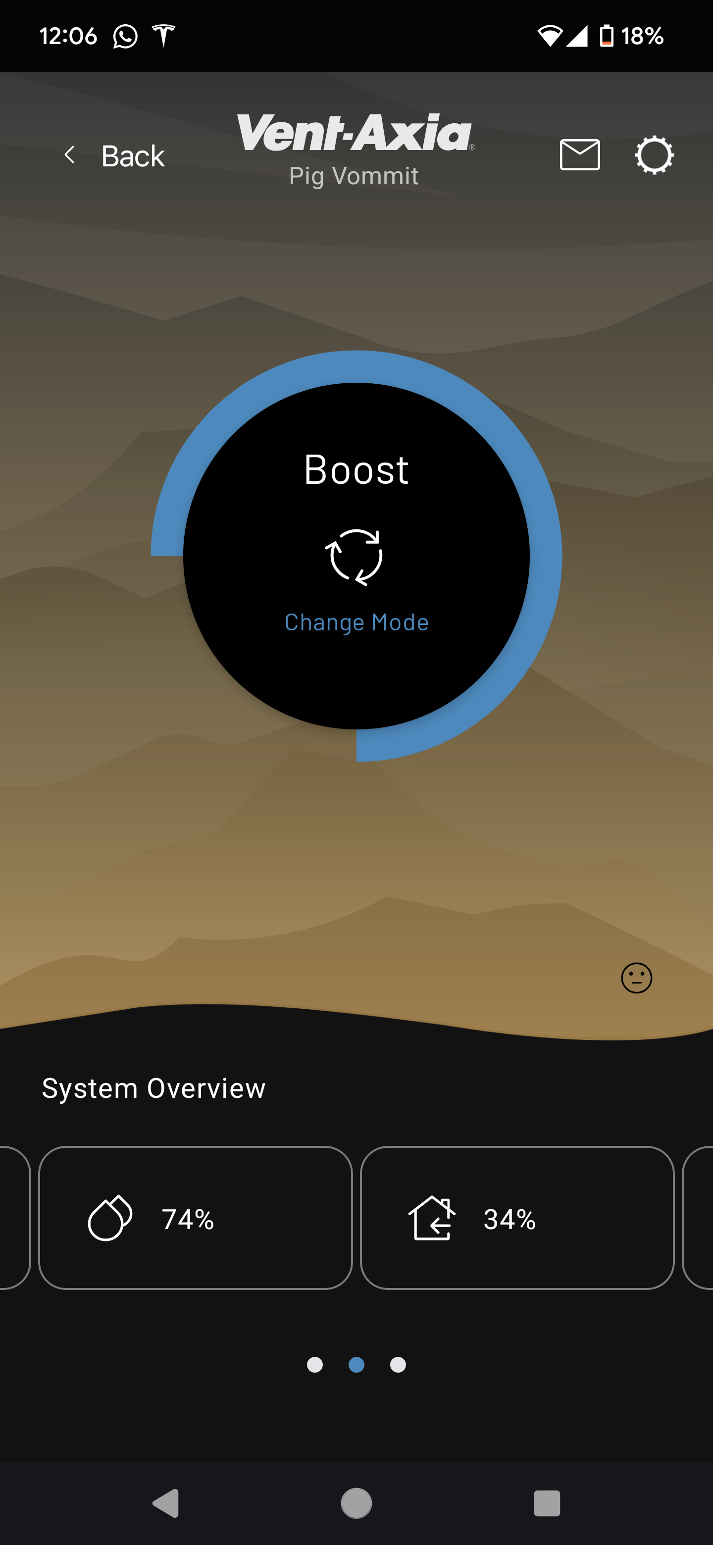

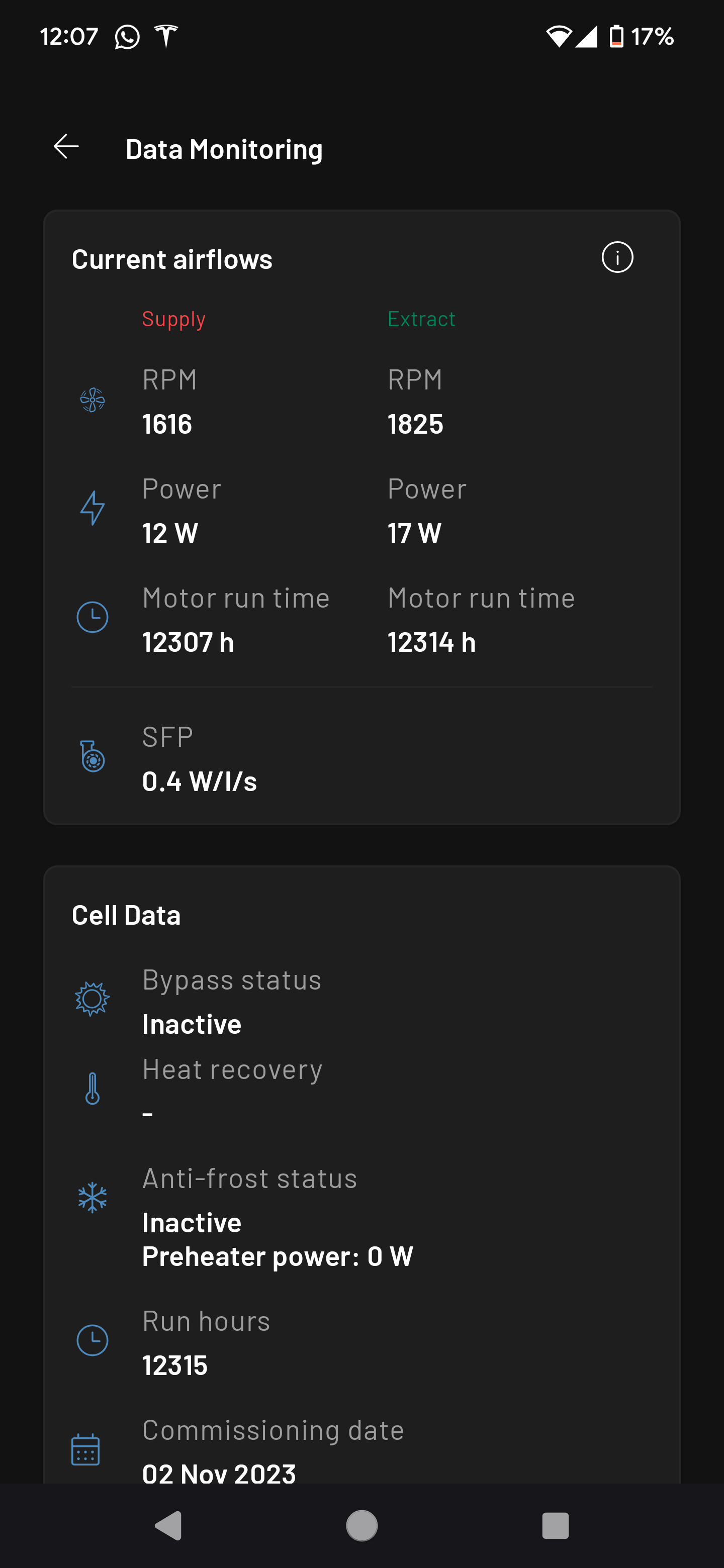

March 14, 20242 yr Author MACHINE ON BOOST The machine seems to be on boost the whole time (but often at a lower fan speed % than on the preset value for boost). The installer upped the fan speed on the settings to about 60% but that didn't do anything. I let it do what it wanted for several days and it continued to be on boost. The house is not damp. This morning 7am info said 9 degrees outside, supply air temp 16 degrees. Living area was 21 degrees. RH 72% on MVHR (63% on hygrometer in bathroom) This afternoon was unusually warm and sunny - MVHR said 17 degrees OUTSIDE (correct), supply air temp 21 degrees. Living area was 22 degrees. RH on MVHR 64% (about the same in bathroom) but machine was still on boost (intake 54%, extract 47%).

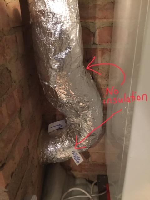

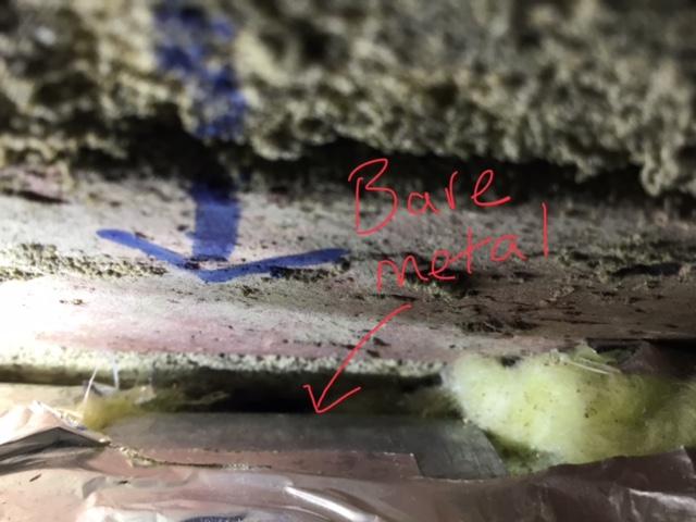

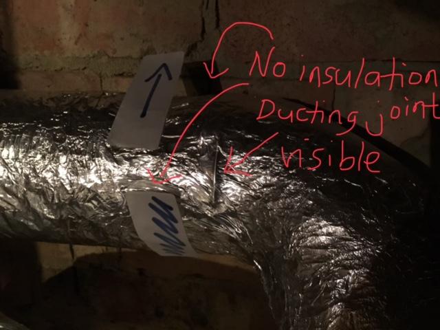

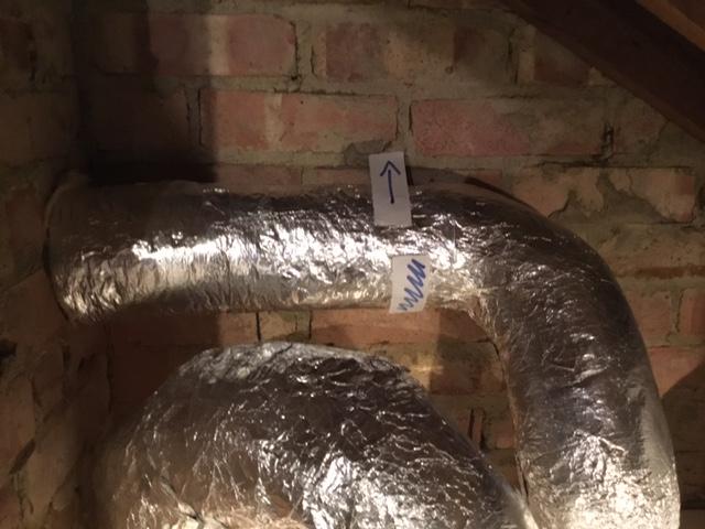

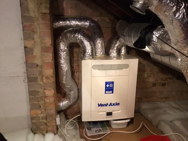

March 14, 20242 yr Author POORLY INSULATED DUCTING TO ATMOSPHERE Today I have closely inspected the insulation on the ducts to/from atmosphere. There are sections of uninsulated ducting on the supply and extract to atmosphere (photos). There are some areas where I don't think you can get insulation on the ducting because the ducting is right up against the brick. And some areas are covered with aluminium tape but there is no insulation under the tape. I've asked the installer to reposition the duct work so there's room for insulation. The installer is currently saying no - he says the main reason for insulating the ductwork on the air intake and exhaust to atmosphere is to stop condensation forming on the outside of the duct, not inside. Could this poorly insulated ducting be the cause?
March 14, 20242 yr I wouldn't put the condensate out the roof it really needs to be down a drain, it also needs a drin trap. Otherwise it will suck outside air in also, adding to the issues. I can spiral wound duct without insulation, not good. 14 minutes ago, Novice Becky said: supply temp 11 degrees, room temp 20.5 degrees) If the supply and extract flows are poorly balanced the flow temperature gets messed up, these figures should be within a degree.

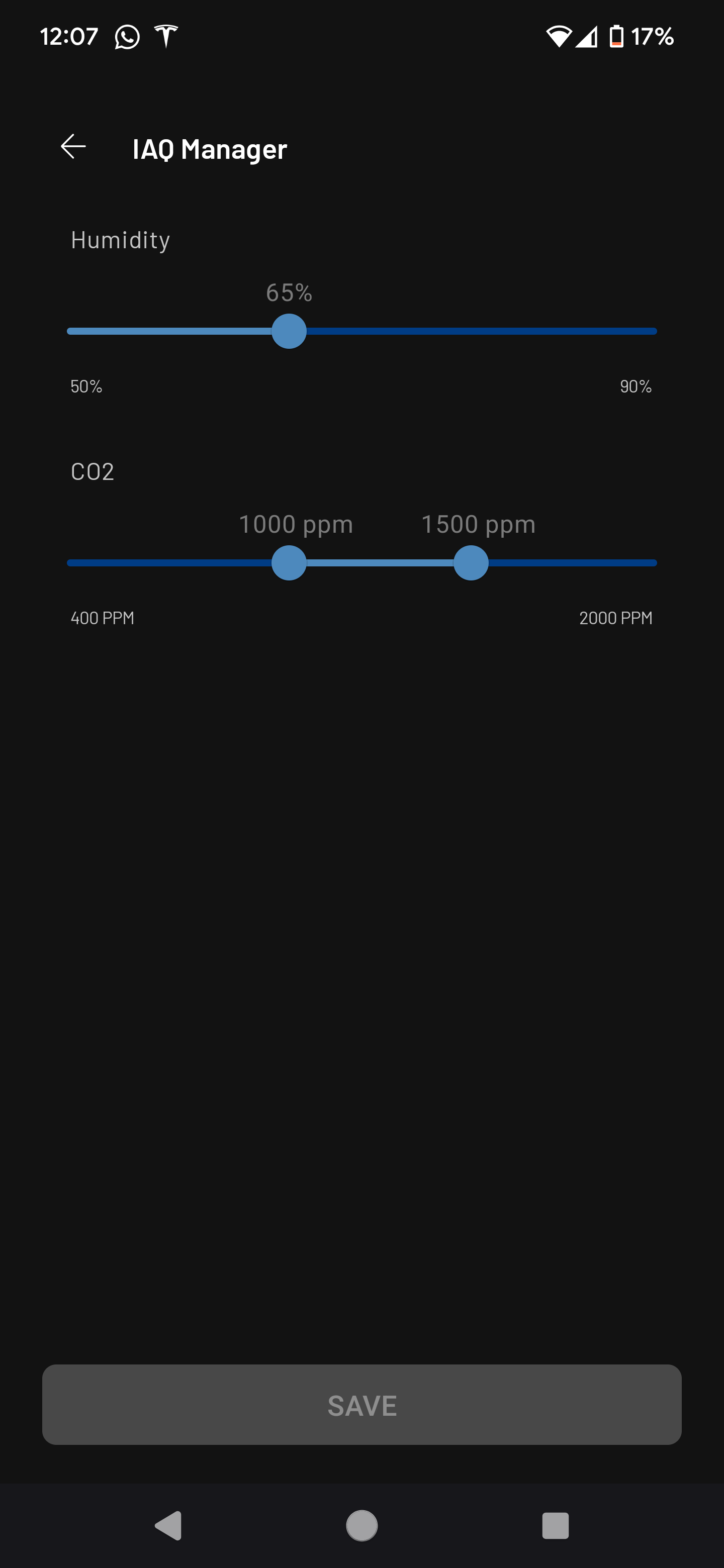

March 15, 20242 yr is the unit switching to humidity-controlled boost? try upping the humidity threshold a few %, the sensor's are n't that accurate in my experience
March 15, 20242 yr Author 14 hours ago, JohnMo said: it also needs a drin trap Thanks @JohnMo. Do you mean dry trap? There wasn't clearance under the machine for a dry trap. I'm lucky I have a trap at all - they are still saying it doesn't really need a trap because it's going straight outside?! Helpful comments - I've been thinking about running the condensate to a bathroom. I've calculated I could get a fall of at least 3.3 degrees to a bathroom. Instructions say min 3 degree fall. Building regs say 5 degrees. Has anyone been ok with a 3 degree fall or do I need a pump or maybe I need to conceal the pipe at ceiling level.
March 15, 20242 yr Author 15 hours ago, JohnMo said: I can spiral wound duct without insulation, not good Thanks. Do you mean the large steel attenuators? I assumed they weren't insulated because they have insulation inside them. Do the attenuators need insulating?
March 15, 20242 yr Becky, In a cold space like that it is best to insulate everything you can to reduce the possibility of condensation on the outside of the pipes/ducts. The condensate drain pipe MUST be insulated. Well done for ignoring the installer. Do try to get the condensate drain pipe to an internal drain, and not to the external guttering. I fear that what happened is during the freezing conditions, the condensate pipe froze from the outside as in your picture and blocked that pipe completely. The condensate that was being collected inside the unit now had nowhere to go and so "overflowed" inside the unit to place/s where it could go, and then came out in all the wrong places. There is one good piece of news in all that - freezing conditions do not seem to be affecting the inside of your MVHR unit 🙂 I think that re-routing that condensate drain pipe will solve your problems

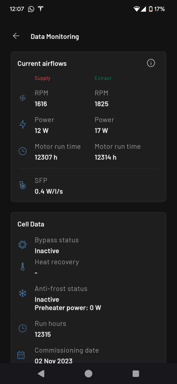

March 15, 20242 yr Author 5 hours ago, dpmiller said: is the unit switching to humidity-controlled boost? Thanks @dpmiller. Yes. Yesterday (warm day) it was in humidity-controlled boost all day - even when machine said RH was 61%. Humidity threshold is set to 70%. I read that the machine can go into boost even if it's below the set threshold (70%) if it detects sudden or sharp increases in humidity. But there wasn't a lot going on in the afternoon - just me at home. Surely it should have switched off boost at 61% rather than just slowed down a bit? 14 March Air Temp (C) Time external internal RH % supply speed % extract speed % Mode 13:19 16 20 65 Humidity controlled boost 13:38 17 21 64 54 47 Humidity controlled boost 14:04 17 21 63 54 47 Humidity controlled boost 14:13 17 21 64 55 48 Humidity controlled boost 14:40 16 21 61 51 42 Humidity controlled boost 16:09 14 21 70 61 60 Humidity controlled boost 23:29 12 18 71 20 20 switched to low 8 hrs overnight (88% outdoor) (Zone 1: 22) (Zone 1: 51%) In the evening I discovered some extra pages on the app. See 11:30pm. Internal air temp 18C. How does it even know the room temp is 22C? There's no thermometer or hygrometer/humidistat linked to the machine but it's correct and has been correct each time I look. 18C is quite a lot colder than 22C. Room humidity is 51%? And why is machine humidity much higher 71%? SCRAP THAT - just looked on the app. It says Zone 1 is 25C! It's actually 21C. The sun is shining. Maybe heating up the loft?
March 15, 20242 yr Author Thanks @BotusBuild. OK I will def get the condensate to an internal drain (really irritating that the expert installer ignored me in the first place and then I doubt myself). Your fears are the same as mine! I sent photos to installer to prove it was seriously frozen but obviously they weren't taking any blame for this. VA seemed to think it was all ok and couldn't see any installation errors other than tipping the machine back slightly (installer looked relieved at that news). I'm now not so sure. The date was being weird for a week a while ago and it wouldn't let me or the installer set the date to the correct date. It has since corrected itself. Today when I pressed the momentary boost switch with the installer here it went to 18 hours 11mins! It should be 15 mins. Does that sound like dodgy/damaged pcb?
March 15, 20242 yr 1 hour ago, Novice Becky said: Today when I pressed the momentary boost switch with the installer here it went to 18 hours 11mins! It should be 15 mins. Does that sound like dodgy/damaged pcb? I would be asking for a replacement PCB at the minimum. Something sounds wrong with the electronic brain.
March 15, 20242 yr I got a replacement PCB from vent axia, after some random uncontrolled boosts. Their tech help were pretty user friendly. It's plug and play and only took 15mins to replace, just label/photo the before you disconnect and not all the plugs are pokey yoke. Label/colour coordinate to be safe!

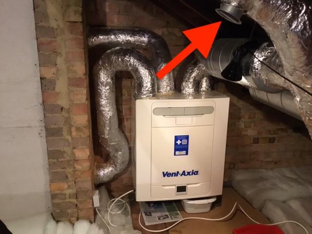

March 15, 20242 yr Can you identify what the arrow is pointing to, looks like a vent and what temperature is the attic during a cold spell?
March 15, 20242 yr Author @JamesP Thanks for looking at this. Your arrow is pointing to a VCD single blade damper (https://www.bpcventilation.com/vcd-in-line-spiral-duct-single-blade-damper) to help with balancing the air flows. There are 7 of them. MVHR layout attached Novice Becky MVHR nov.pdf
March 15, 20242 yr Author 1 hour ago, JamesP said: what temperature is the attic during a cold spell? I don't have a thermometer up there but it's cold (30cm of insulation). When there was extreme cold like -7C there was ice under the machine where it had dripped. I had the boiler and hot and cold water tanks in the loft until recently but all the pipes were all lagged and seemed ok. I'll go and grab a max/min thermometer and put it up there - but we don't have any cold spells forecast at the moment.

March 20, 20242 yr Author Thanks @JamesP. That's a useful suggestion. I'm pretty sure they've insulated the VCDs except for the switch/dial bit. If I'd done the insulation myself I would have used 50mm. The installer said no one used 50mm because it's too hard to handle. Has anyone used 50mm instead of 25mm? I was thinking about re-insulating the whole lot to increase the insulation and ensure it's all done properly. I think I had a bad batch of aluminium tape and it's come undone in places and I expect more will come unstuck over time. Do I have to remove the existing insulation rather than go over the top of it? It's foil-backed.
March 20, 20242 yr Hi @Novice Becky Not an expert but I think the condensation must be very high in the cold loft during winter months. I would insulate the silencers first and any obvious areas before you re-insulate the entire system. But the unit itself is very exposed to the cold.
March 20, 20242 yr Author 16 minutes ago, JamesP said: But the unit itself is very exposed to the cold. Yes it's very exposed to the cold but this machine is supposed to be ok in a cold loft. Vent-Axia said that it doesn't need to be insulated (I could if I wanted but I didn't have to). The machine has polystyrene insulation inside. The manual says -20C to +40C. That's why I didn't build an insulated cupboard for it. The summer could be a problem though. I thought about retrofitting an insulated cupboard for it but I'd have to get it off the wall to insulate behind the machine and then I'd have to alter the metal ducting which seems a bit of a headache!

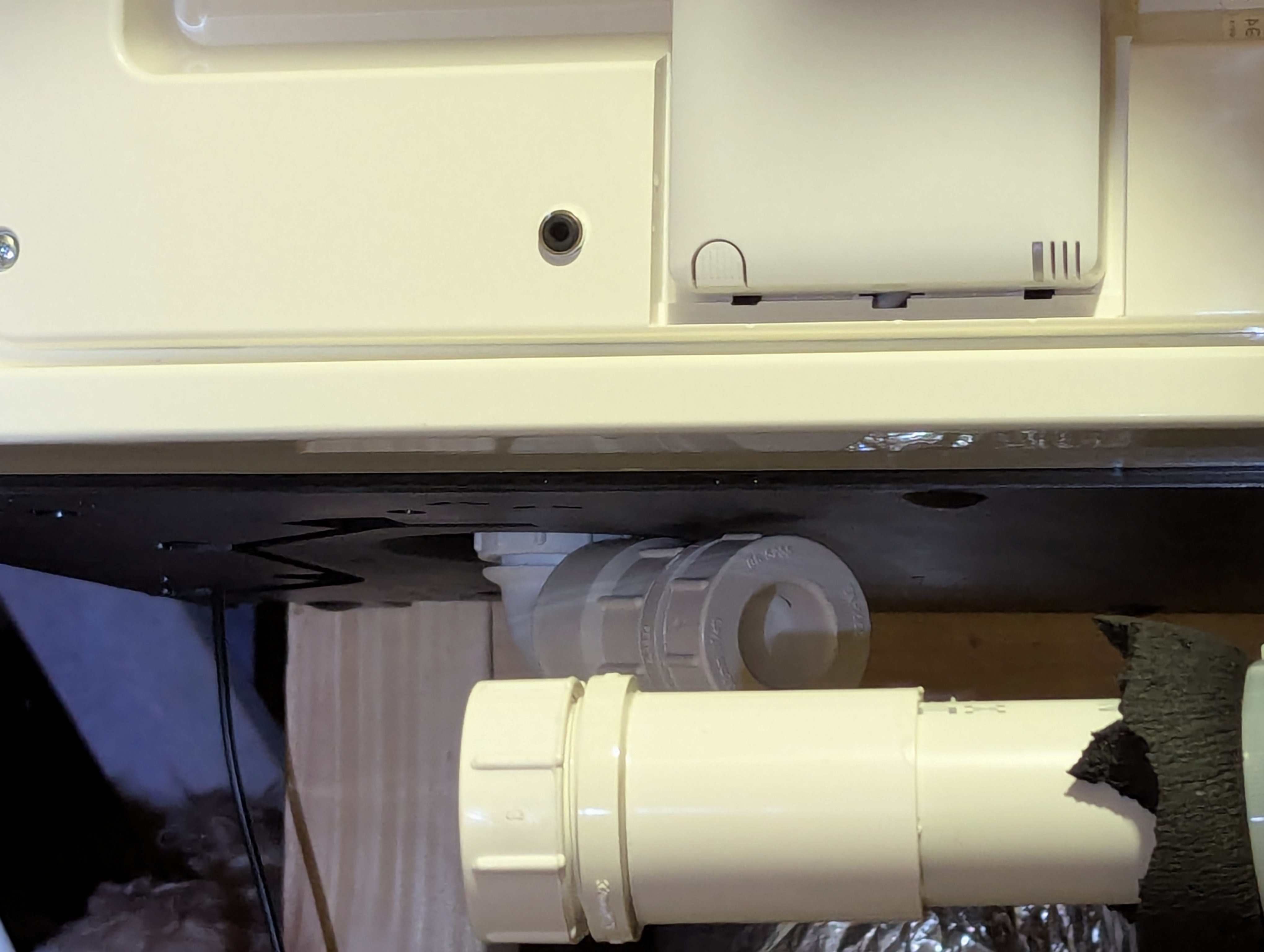

January 27, 20251 yr Hi Becky, Same model, same problem here. Noticed a wet patch on my roof which lead me to investigate. Drains were fine, not blocked and iny case were into an internal drain and trapped with a hepa trap. I've called installer who is due to come, but going a little investigation I forgot and an article that mentioned checking levels in both axis. I did this and noticed that the machine is not level on the axis and pitches forward towards where the dripping is. Looking inside this unit would suggest the condensation should enter the drain at the rear. Might be a nothing but installer back tomorrow to correct. Note in picture my installer but drains on both? Who knows why. It's my understanding that the machine vents to atmosphere on the right side, and this is where water is. Thanks Justin
January 30, 20251 yr Author Hi Justin, my installer ended up putting drains on both LH and RH too. This is not correct but I've left it. The insulation you have on the condensate is much better than my foam lagging. Do you know what it's called (so I can get some)? Is your machine in a loft/cold space? If so I'd say check your insulation. Here's my story ... The Vent Axia engineer adjusted the tilt of my machine like you said. It did improve things (got rid of the slooshing as far as I'm aware), but RH was still too high so machine was in boost most of the time and heat recovery was very poor (I have a thermometer in one of the ceiling vents). I think I have resolved the problem (well I haven't finished the job yet) - the problem is that the whole ducting system was/is insufficiently insulated. I asked for 50mm insulation, the installer said nobody uses 50mm - 25mm (building regs min) will be fine. When it was done and I had problems, the Vent Axia engineer looked at my installation and said it all looked really well-insulated and was a good job - which got my installer off the hook. Anyway, I bought a whole load of new ducting insulation, 50mm - https://insulationandlagging.co.uk/Pipe-Insulation-Lagging/Duct-Insulation/25mm-Thick-Thermo-tek-RL-ECO-ALu-18m-Long-1.2m-Wide-Duct-Insulation-Roll-21.6m_2. The 25mm insulation from BPC is like a bit of crepe paper in comparison. I can't see it's possibly 25mm. Plus the installers compressed it by wrapping the rubbish BPC aluminium tape round it. I am using Rhino cold weather tape (https://www.vikingtapes.co.uk/products/rhino-cold-weather-aluminium-foil-tape?variant=33273303728191). I recommend opening the insulation in advance to give it time to expand before installing it. So far I have re-insulated over half of the ducting, including the silencers, and I can see already it has made a massive difference. The RH is down indoors (about 50%) and the machine has a happy face on the app and is not continually on boost. Also the heat recovery has improved (still below par). There was a long section of the extract that had been installed following the apex of the roof, ie. high up in the coldest point of the loft. I think the moisture in the wet air had cooled down and was condensing before it got back to the machine. There is a nice big downward slope for it to run down into the machine and overwhelm the machine with water. I feel confident that this 50mm insulation is going to resolve the problem and improve heat recovery. I will also insulate the machine by building a sort of cupboard out of PIR sheets. Also, I had my cavity wall insulation sucked out and replaced with bonded EPS - I got them to fill the gable wall in the loft where the machine is.
February 1, 20251 yr Thanks for the reply. My unit is in the cold loft space. As far as I can tell, all ducting is insulated in the silver lagging. In addition to this a lot of the ducting is under/surrounded by the rock wool insulation in my attic, so without ripping the place apart I would say I'm ok here. Regarding the drain on both sides, vent Axia tech strongly advised to fix this. They said water would just be pulled back in from one drain to the next. They also said it would create an imbalance. I've since had a plumber out to fix this. So now my machine is level in all directions and drain is correctly installed. Hoping for improvement. Silly question but where is your source of truth for RH and heat recovery. Mine shows nothing in app. Will attach pic
