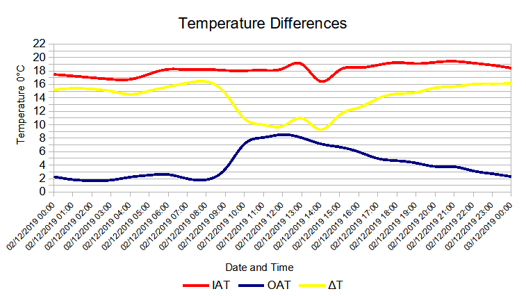

SteamyTea Posted March 12 Share Posted March 12 1 minute ago, mk1_man said: Assuming it is 10Kw does this mean I need a 10Kw heat source running 24 hrs a day Yes, and to add more conflict to it, no. Overall, if the mean temperature difference, say a ΔT 20°C, produces a result of 10 kW (that is the power), then over a day that is 240 kWh (the energy). Now the confusion will arise that the temperatures inside and outside the house will not stay the same i.e. 0°C outside and 20°C inside. This will produce a picture like this. Now these are real readings for my house. The mean inside air temperature (IAT) is 18.2°C, the mean outside air temperature (OAT) 4.1°C, the mean ΔT is 14°C (or K, for kelvin in real science). Just looking at the ΔT, the yellow line, you can see that it starts high at around 15°C, then drops to about 10°C then rises again back, peaking at 16°C. The IAT, is fairly stable apart from the dip between 1PM and 2PM (probably cooking and opened the window). The OAT is stable during the first hours of darkness until 8AM at around 2°C, then rises quite fast 8°C, then the day slowly cools back to 2°C. It was probably a day with a sunny morning and then a slow wind direction change (to the SE) during the afternoon. The relevant part as far as heat pump (or any heat source) part is concerned is the biggest temperature difference (ΔT). This happened between 10 PM and midnight, though it can happen at any time of day, and on some days can happen multiple times (spring and autumn stormy days, lowish sun angle and scattered showers). You need to know not just the the greatest temperature differences, but also what performance hit your heating system will have when it is cold outside. This is more important for A2AHP's as they may have a lower rating at low OATs. It is usual to size a heating system to cover 99% of the loads that can be expected, that leaves 88 hours when the systems will not deliver enough power to keep the IAT at the desired level. It is usual to use supplementary heating i.e. a fan heat to fill in that gap (or just be tight and have a slightly colder house). During those few hours, which may or may not be contiguous, the heating system is still supply thermal energy, just not enough to keep the IAT at the desired level. It is generally cheaper to run a resistance heater for a few hours than fit an oversized heat pump that will take a performance hit because is cycling on and off. This is why a buffer tank is fitted as it allows a heat pump to deliver energy for a longer time, which generally translates to a better coefficient of performance (CoP) for the ΔT. Not always ideal, but better than if the system was cycling. In brief, if your house takes 0.5 kW of power for every Δ°C, when you hit the really large ΔTs, and your pump can only deliver 3kW, rather than the stated 8kW, which is what you need, you have to have supplementary heating, or accept that the ideal IAT (say 20°C) will drop by 10°C, so down to 10°C, not very nice, but not fatal. These will be very rare events as most houses store a fairly high amount of energy in the first few millimetres of internal wall, and temperature loses are not linear, the colder it gets inside, the slower the energy release is from the walls (and other parts of the structure and fittings). This will, over a few hours, help to keep the temperature reasonable enough (it is why buildings do not instantly change temperature). Link to comment Share on other sites More sharing options...

SteamyTea Posted March 12 Share Posted March 12 5 minutes ago, Bramco said: Has anyone else looked at the wind chill factor when doing the heat loss analysis As windchill is a function of evaporation, relative humidity and surface boundary windspeed, it will make for an interesting partial differential equation solution. Many years ago I looked at the correlations between windspeed, wind direction, solar power and air temperature. Basically as windspeed increased, so did air temperature (for my location), solar power went up with more northerly winds, but I did not look at relative humidity. I am not sure how buildings are affected by external evaporation. One way to check would be to put calibrated probes just under a sample of the wall surface and another on a similar sized bit of glass, or an identical bit of wall surface but sealed to stop evaporation i.e. a clear varnish. The idea being that glass does not absorb water and will dry off fast, while brick or render will absorb a bit and evaporate over time. If it is done at night, then solar power does not enter the calculations, daylight testing would become a secondary experiment. A more comprehensive experiment could be done with added sensing i.e. RH, solar power and airspeed near the samples. Link to comment Share on other sites More sharing options...
