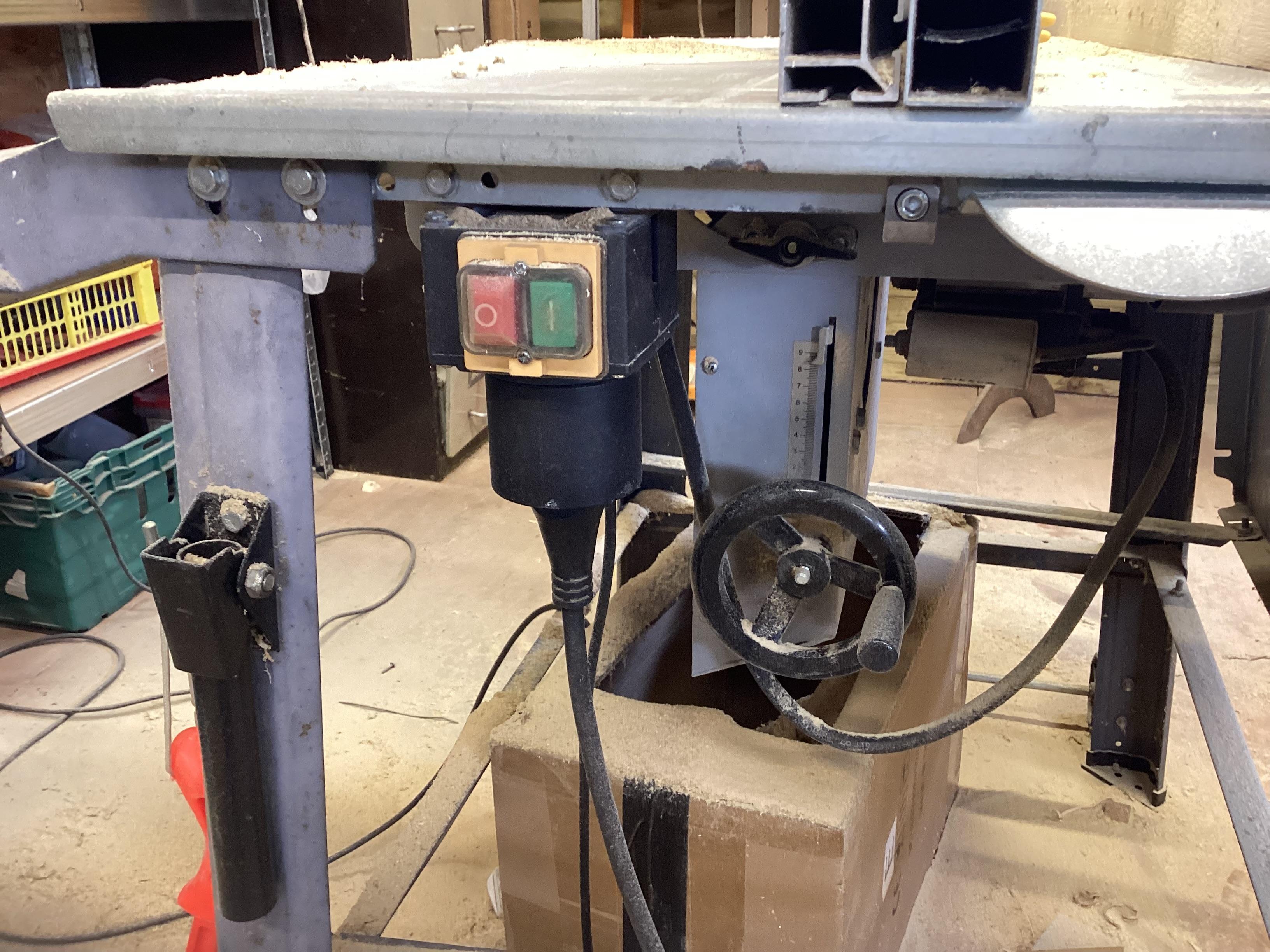

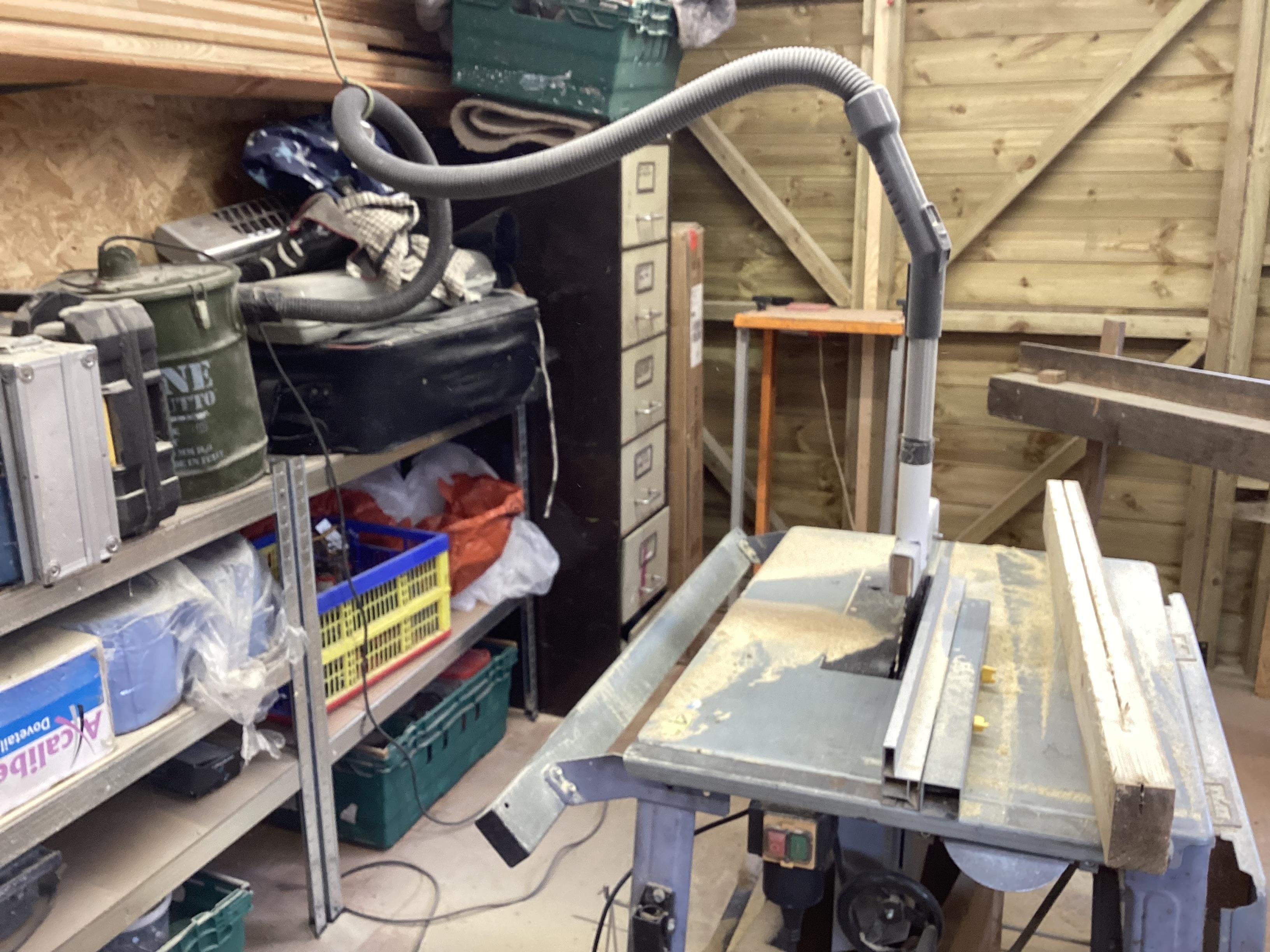

joe90 Posted March 10, 2024 Posted March 10, 2024 Just using my table saw (soft start with no volt switching) and it packed up, will run if I hold the on button in but will not hold itself. It was modified with an extra mains socket to run a vacuum for dust removal. Any ideas please chaps π€·ββοΈ
ProDave Posted March 10, 2024 Posted March 10, 2024 Post some pics of the controls.Β If a proper start / stop, check the start button is pusming the contactor in all the way 1
joe90 Posted March 10, 2024 Author Posted March 10, 2024 (edited) Ah, itβs working now!!, overheating? The additional socket i have never used (installed by the previous owner) and I have not used it before but as I recently had a bad chest infection thought I would rig it up, so could the extra load of the vaccuum cause a fault? I have been working it hard this morning ripping timber into usable pieces. Edited March 10, 2024 by joe90
