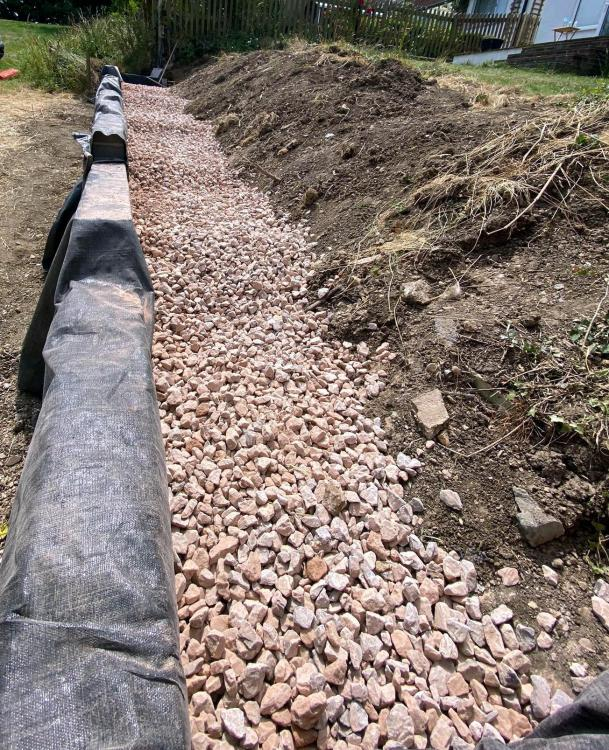

Conor Posted March 11, 2024 Posted March 11, 2024 22 minutes ago, Canski said: Is that membrane permeable ? Was thinking the same. Woven weed membrane.
Canski Posted March 12, 2024 Posted March 12, 2024 19 hours ago, Steve06 said: Yes it is permeable, terram matting. Ahh I used DPM for mine to prevent the water soaking through the wall.
Steve06 Posted March 14, 2024 Author Posted March 14, 2024 (edited) https://geotextilemembranes.co.uk/blog/post/why-do-you-need-geotextile-membranes.html Please remove this link if not permitted. Does this not stop pressure building up against the wall? Edited March 14, 2024 by Steve06
saveasteading Posted March 14, 2024 Posted March 14, 2024 1 hour ago, Steve06 said: Does this not stop pressure building up against the wall? No. Geotextile is permeable. Its function is to keep muck and clean stone separate. The pressure is reduced by having weep holes through the wall. 1

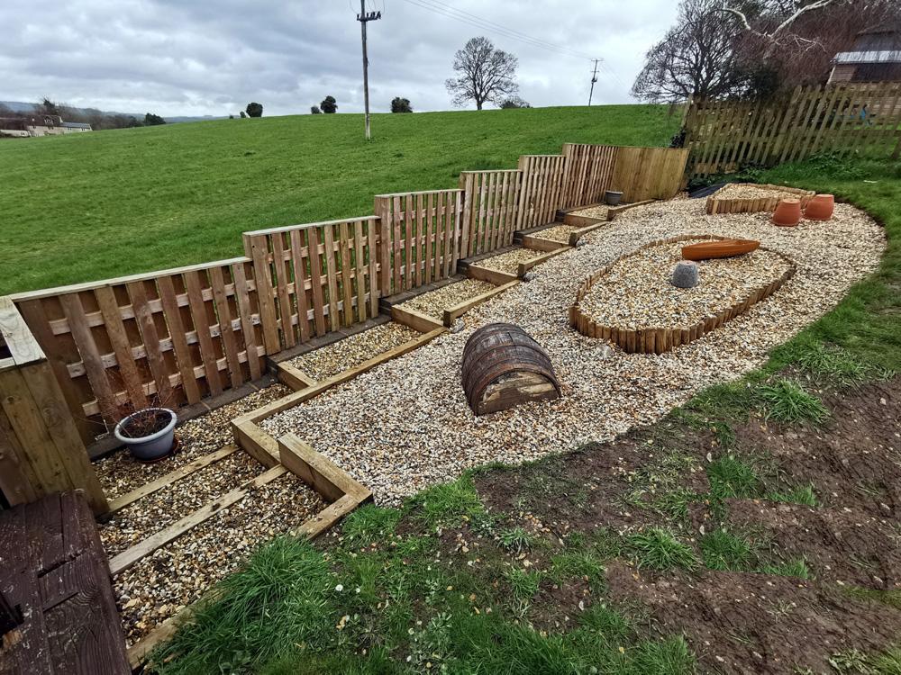

Steve06 Posted March 14, 2024 Author Posted March 14, 2024 Looking at this image with the following, should I be able to sleep at night:- a) 3ft high x 40ft wide retaining wall to the left, with the permeable matting. b) 2 ft width of backfill up against the garden slope. c) 5 x weep holes. Thank you very much 🙏🏻
saveasteading Posted March 14, 2024 Posted March 14, 2024 The gravel let's the water flow to the weepholes. So it's OK. Geotextile folded back and between the gravel and topsoil presumably? And relax. 1

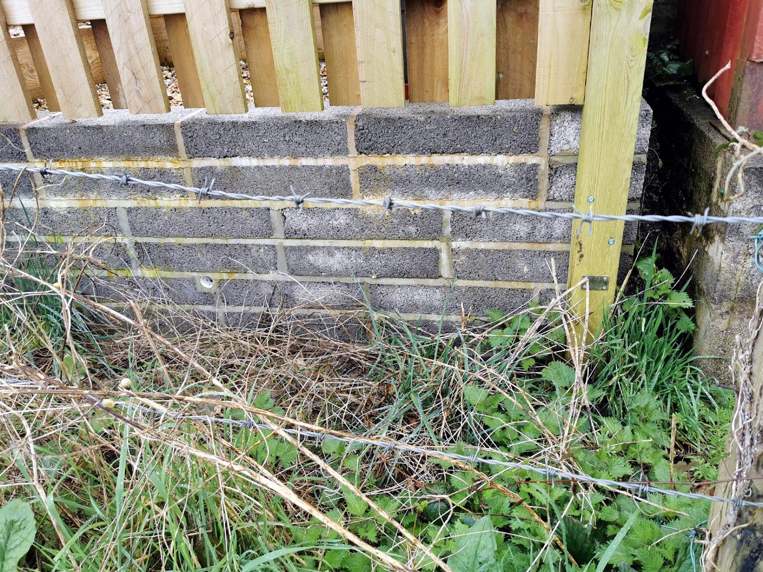

Steve06 Posted March 14, 2024 Author Posted March 14, 2024 All this build issue only to came to light this week when I noticed the efflorescence on the rear and then following internet links I was getting VERY worried that this wall was not reinforced enough for the garden load and should have had hollow concrete bricks with metal rods. We have since unknowingly added 3 x 900kg bags of gravel 🥺 Can I still sleep at night?
saveasteading Posted March 14, 2024 Posted March 14, 2024 1 hour ago, Steve06 said: Can I still sleep at night Ideally there would be hollow blocks and reinforcement, or some other stiffening. But it's not high and you are draining the water. It will be OK. 1
Steve06 Posted March 14, 2024 Author Posted March 14, 2024 4 hours ago, saveasteading said: Ideally there would be hollow blocks and reinforcement, or some other stiffening. But it's not high and you are draining the water. It will be OK. Thank you so much, really needed to hear this.
Onoff Posted March 15, 2024 Posted March 15, 2024 14 hours ago, Steve06 said: All this build issue only to came to light this week when I noticed the efflorescence on the rear and then following internet links I was getting VERY worried that this wall was not reinforced enough for the garden load and should have had hollow concrete bricks with metal rods. We have since unknowingly added 3 x 900kg bags of gravel 🥺 Can I still sleep at night? That fence shows just what can be done with old pallets 👍
saveasteading Posted March 15, 2024 Posted March 15, 2024 Sudden thought. With that slope, any water teaching the gravel will travel down the slope to the return at the bottom. You must have at least one outlet there or it will build up locally.
Steve06 Posted March 15, 2024 Author Posted March 15, 2024 5 hours ago, saveasteading said: Sudden thought. With that slope, any water teaching the gravel will travel down the slope to the return at the bottom. You must have at least one outlet there or it will build up locally. Thank you, I will check once it stops raining!
saveasteading Posted March 15, 2024 Posted March 15, 2024 15 minutes ago, Steve06 said: once it stops raining! It's the best time to check. Presumably you've had record rainfall like everywhere else. So if it's OK now it will be until the next fludde. 1

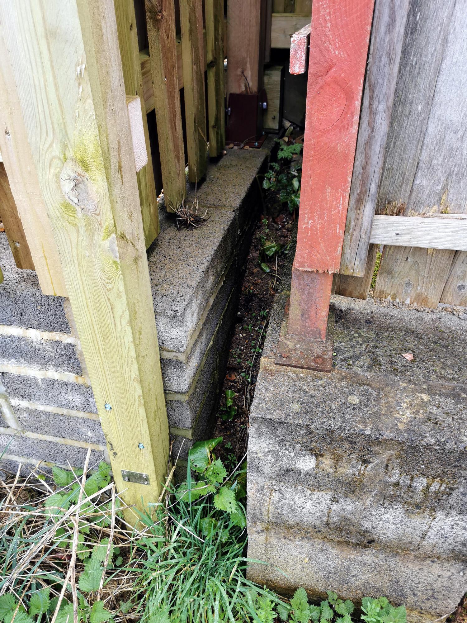

Steve06 Posted March 15, 2024 Author Posted March 15, 2024 Hi 2 hours ago, saveasteading said: It's the best time to check. Presumably you've had record rainfall like everywhere else. So if it's OK now it will be until the next fludde. Hi, This is the lowest front view of the lowest panel and the side view. Never occured to me but would it be prudent to remove the built up soil at the side to allow the blocks to breathe? Again, thank you so much for your invaluable advise 👍
Pocster Posted March 15, 2024 Posted March 15, 2024 26 minutes ago, Steve06 said: Again, thank you so much for your invaluable advise 👍 One day someone will say that to me . On that day the world will end .
saveasteading Posted March 15, 2024 Posted March 15, 2024 32 minutes ago, Steve06 said: would it be prudent to remove the built up soil at the side to allow the blocks to breathe I don't think it matters. That's an outlet on the left and so water won't rise above that.
