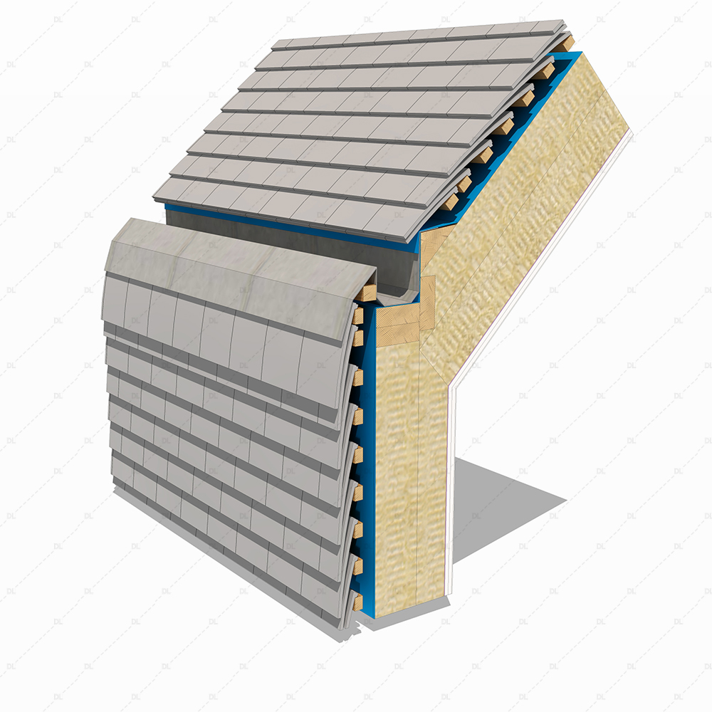

flanagaj Posted March 5 Share Posted March 5 (edited) I am not a fan of eaves, and am trying to understand whether I could dispense with them if you are having a clay tile roof. If you had fascia the same colour as your windows, I think this would potentially look very slick. The link below shows an image of what I am talking about. https://www.archdaily.com/952573/4-solutions-for-roofs-without-eaves-and-their-construction-details/5fc7ad6263c0179a2100009b-4-solutions-for-roofs-without-eaves-and-their-construction-details-image Edited March 5 by flanagaj Link to comment Share on other sites More sharing options...
markc Posted March 5 Share Posted March 5 Internal gutters… omg noooo! Hiding gutters behind cladding but still outside the envelope would be ok … but a PITA for maintenance etc. gutters will leak or overflow at some point and you def don’t want this inside your house Link to comment Share on other sites More sharing options...
flanagaj Posted March 5 Author Share Posted March 5 12 minutes ago, markc said: Internal gutters… omg noooo! Hiding gutters behind cladding but still outside the envelope would be ok … but a PITA for maintenance etc. gutters will leak or overflow at some point and you def don’t want this inside your house This what I had in mind. Link to comment Share on other sites More sharing options...
markc Posted March 5 Share Posted March 5 @flanagaj I agree they would look very neat, it’s just the consequences of any leak. The above detail is a definite improvement as an overflow does go onto the outside but any hole, split, crack or open joint in the gutter will wet the wall without knowing about it until serious damage has been done. I suppose you could add a secondary membrane under the gutter and out onto the outside and if you saw water coming from this area then you would know there was a gutter problem. Link to comment Share on other sites More sharing options...
Redbeard Posted March 5 Share Posted March 5 I supervised an EWI job for a client and, because they preferred not to extend the roof-line, we specified an 'EWI gutter', which was/is a double-depth (front-back, not top-bottom) alu gutter which forms a 'roof-ette' to the EWI and projects as far over the new wall surface as the gutter did over the original wall-line. It looks fine but since it is made of 2 lengths I worry about the joint in the long term. The contractor just said 'it's good stuff; it'll last forever' which may be slightly optimistic. I'd have the same worries with your set-up, and more, since 'un-building' the EWI gutter would not involve stripping off some of the roof. I think yours might. 1 Link to comment Share on other sites More sharing options...
