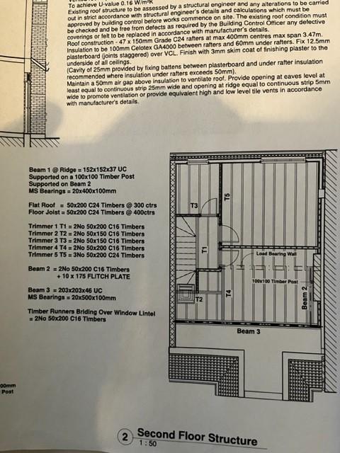

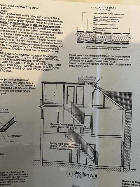

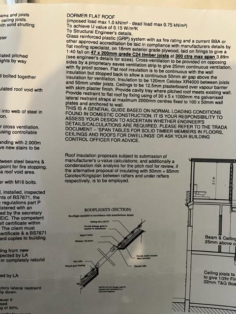

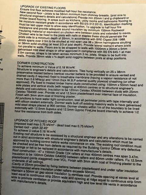

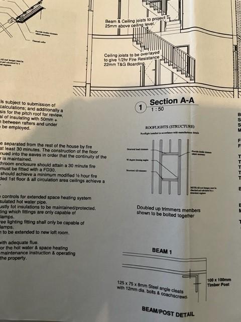

Willl Posted March 5, 2024 Author Share Posted March 5, 2024 That was discussed but couldnt be faced! Here are the plans if they 'shine any light'? (I'm now thinking it was something they said as part of the 'sell'!) Thanks, Will Link to comment Share on other sites More sharing options...
