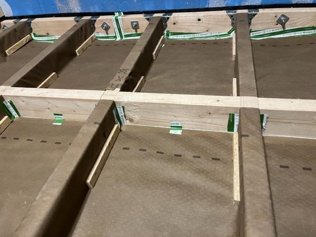

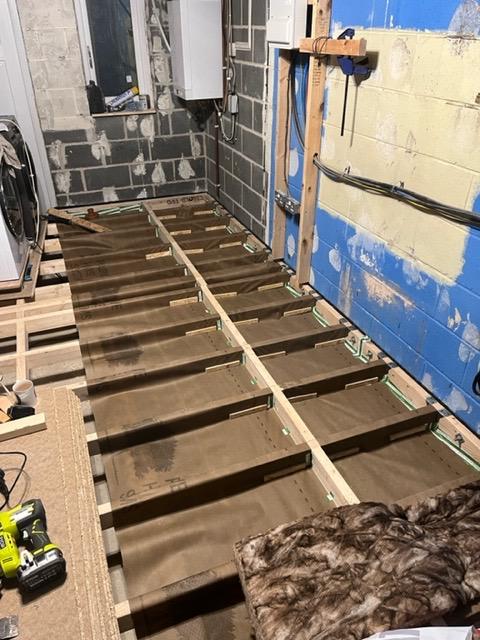

OwenF Posted February 29, 2024 Share Posted February 29, 2024 I’m currently installing breather membrane for wool insulated suspended floor. I’m using the ‘up and over’ method (only 150mm gap beneath joists) and I can tell you- THAT is a pain in the arse. Especially around the noggins I’d say if you have access from below, then do it. Will be loads easier. Staple up, tape joins, done 2 Link to comment Share on other sites More sharing options...

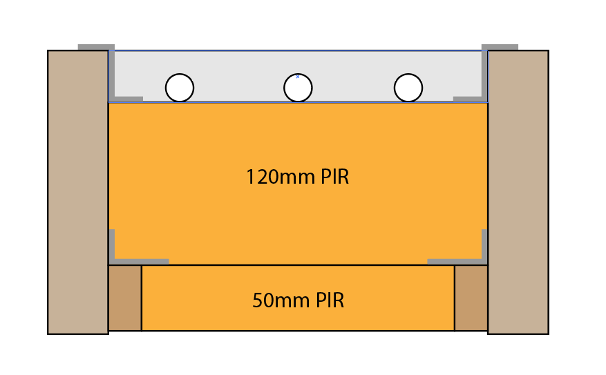

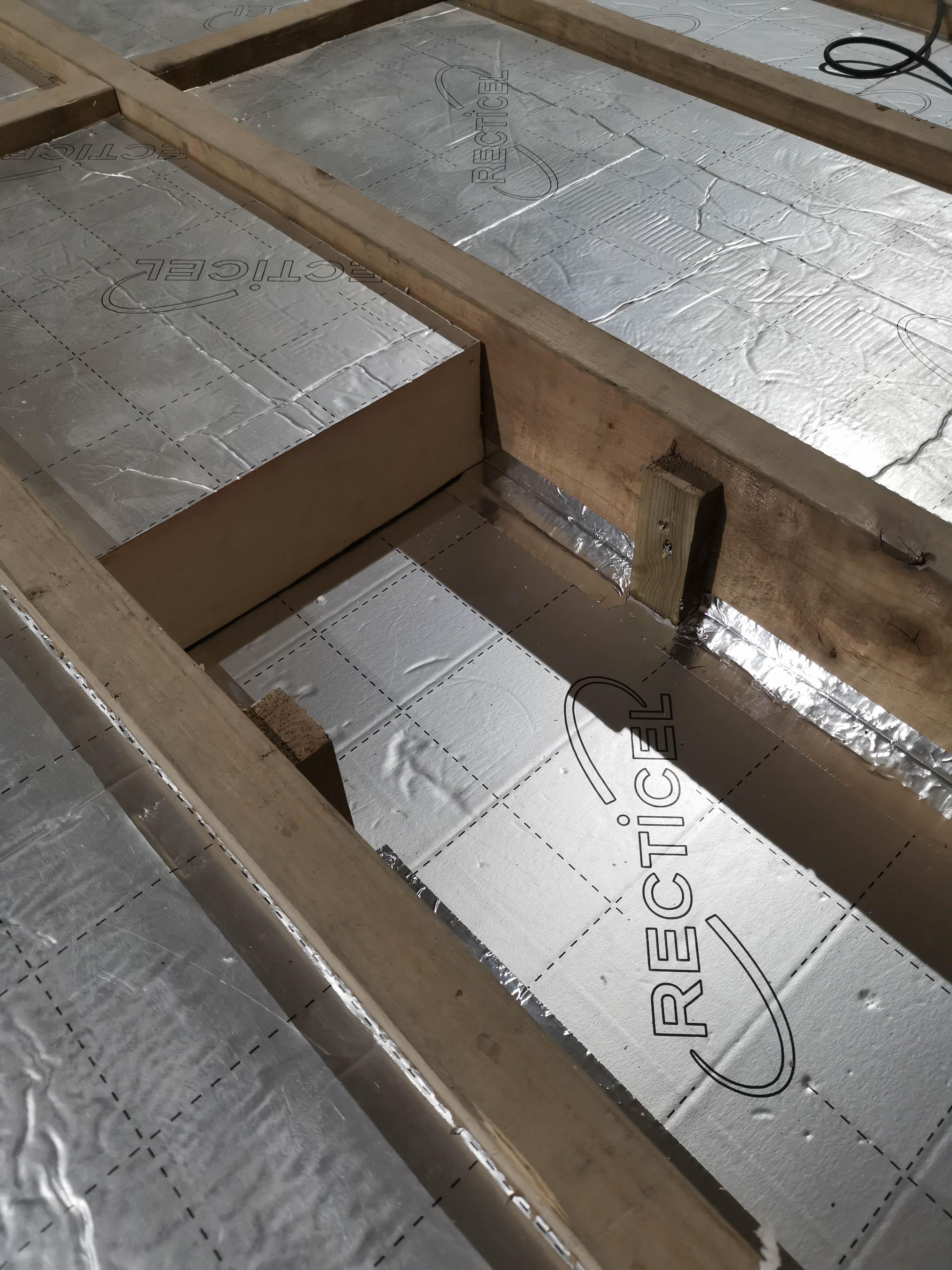

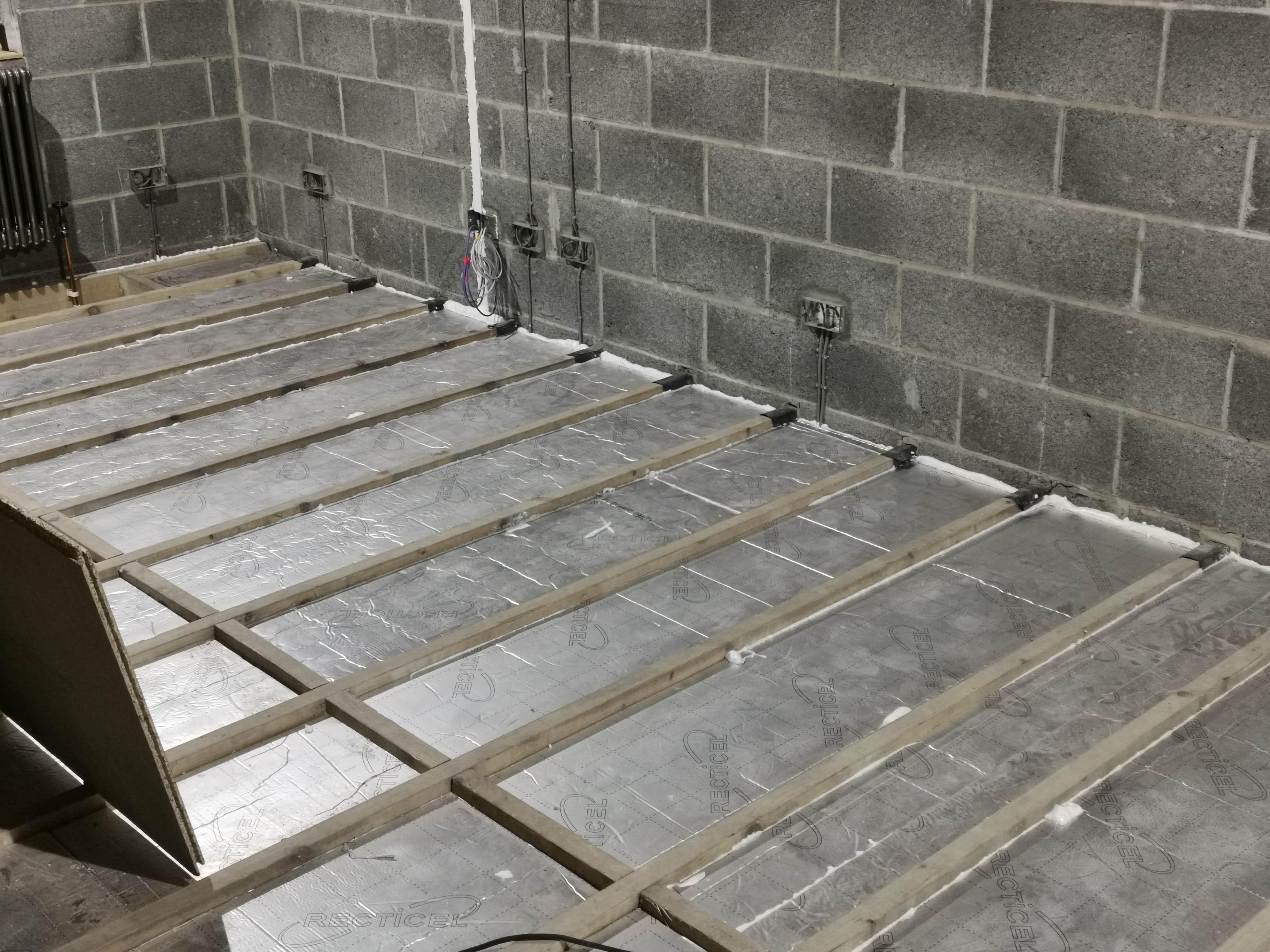

Super_Paulie Posted February 29, 2024 Share Posted February 29, 2024 (edited) im just doing the job in my place now but im using PIR, 2 layers of with the lower PIR between battens on nails and foamed in, the top layer on battens. Air-tight foamed where necessary, taped over and then the next layer of PIR foamed and taped. Then foam all around the perimeter. Zero drafts, cant feel any air movement at all but it wasnt an easy or quick job but it looks like it'll do the trick for my UFH. Too late to go back now anyways 😆 When i got down to the last piece it was like a howling gale underneath from the airbricks, all gone now. Edited February 29, 2024 by Super_Paulie 2 Link to comment Share on other sites More sharing options...
