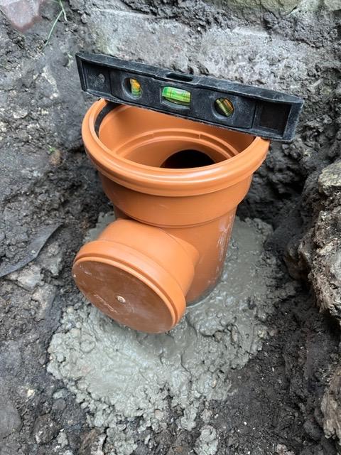

Builder has run 110mm underground  drainage pipe through footings into a new utility room to provide drainage for sinks and appliances.
There is a 110mm 90 degree bend on the end of the pipe to bring the drain in and up to floor level.
Is this ‘correct’ or should there be a 110mm water trap fitted to bring the drain in and up whilst stopping toilet/drain smells from coming up into the utility room ?
Also a boiler condensate and a HW cylinder tun dish will discharge into this drain.

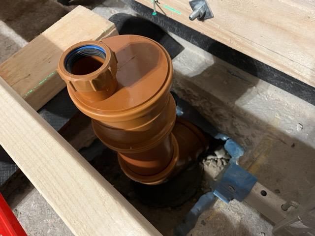

Thanks. He has currently fitted the first of these.
I am uncomfortable with this as it doesn’t seem like a fully permanent seal. We have had an occasional blocked drain and if this happened in the future things could back-up along the drain. If it isn’t a good seal, in the worst case we could end up with toilet waste leaking out into the subfloor void hidden from view & access. So I think the second seems better.
Q1 But maybe the 110mm pipe should be extended up to just above floor level anyway (rather than hidden under the floor?)

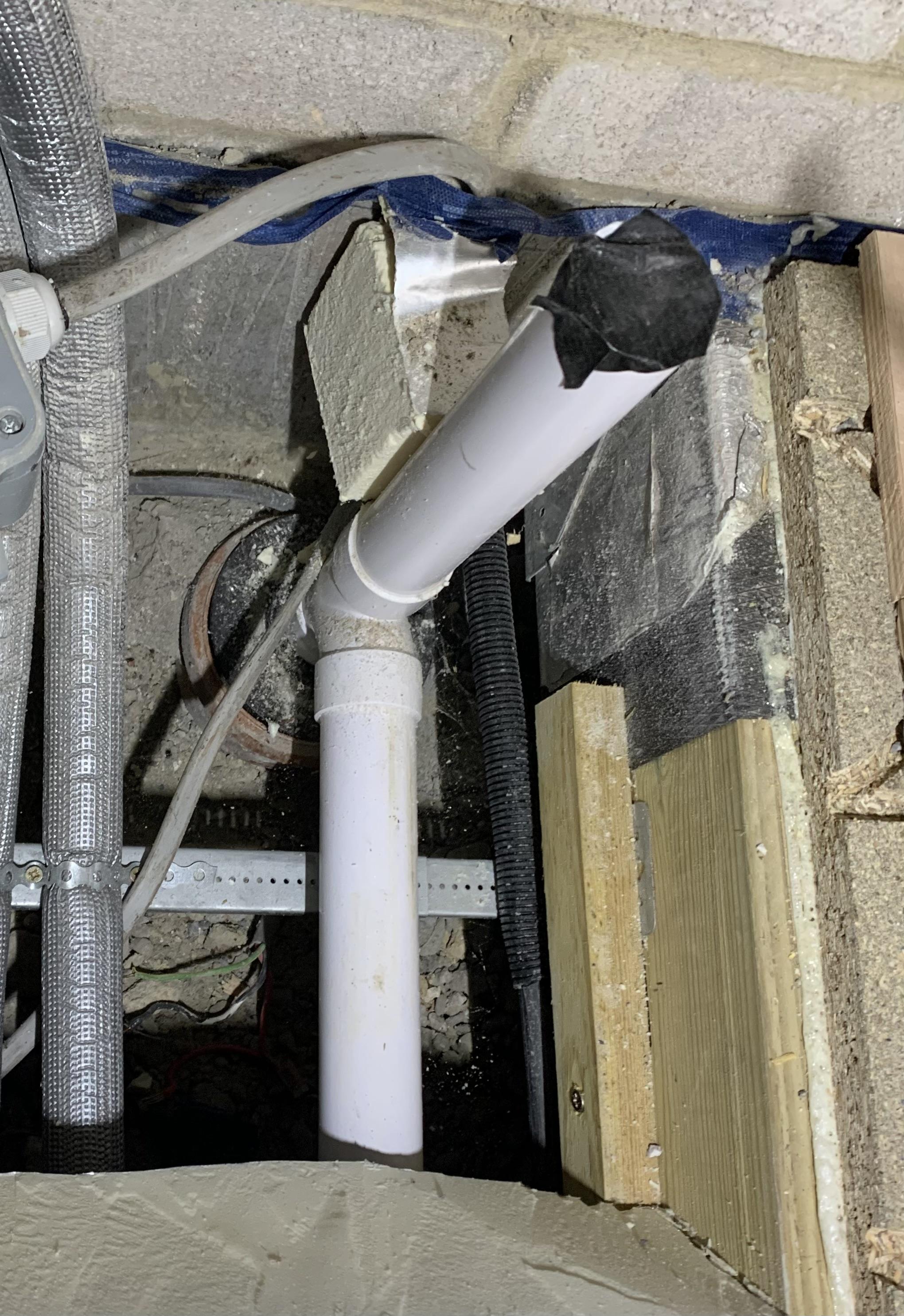

Q2 The smaller horizontal waste pipe is for boiler condensate. Can’t see anything to stop smells coming up that pipe ?
Q3 A UVC tundish needs an outlet which might be routed into this drain pipe - how can I tell if the soil pipe is good enough for high temp (95C) water ?
Q4 Is there a PB or PEX waste pipe fitting with a mechanical seal to comply with section 3.60 of the G3 regs ?
where is the 110 going- could you put a back-inlet trap just outside the house?
This. I’ve just done the same for my utility (going to be taking sink, washing machine, condensate and tundish)
However, this has got me wondering if the back entry gulley forms an effective trap. The invert of incoming/outgoing is above the reservoir. I guess the little bottle insert must do the ‘trapping’
I extended the 90 up so the ‘nut’ of the 40mm adaptor sits just above structural floor level (chipboard). This will be below a base unit, which won’t get tiled so theoretically I could get to the 110mm opening with a minor floor cut.
at worst I can rod direct at the adaptor
