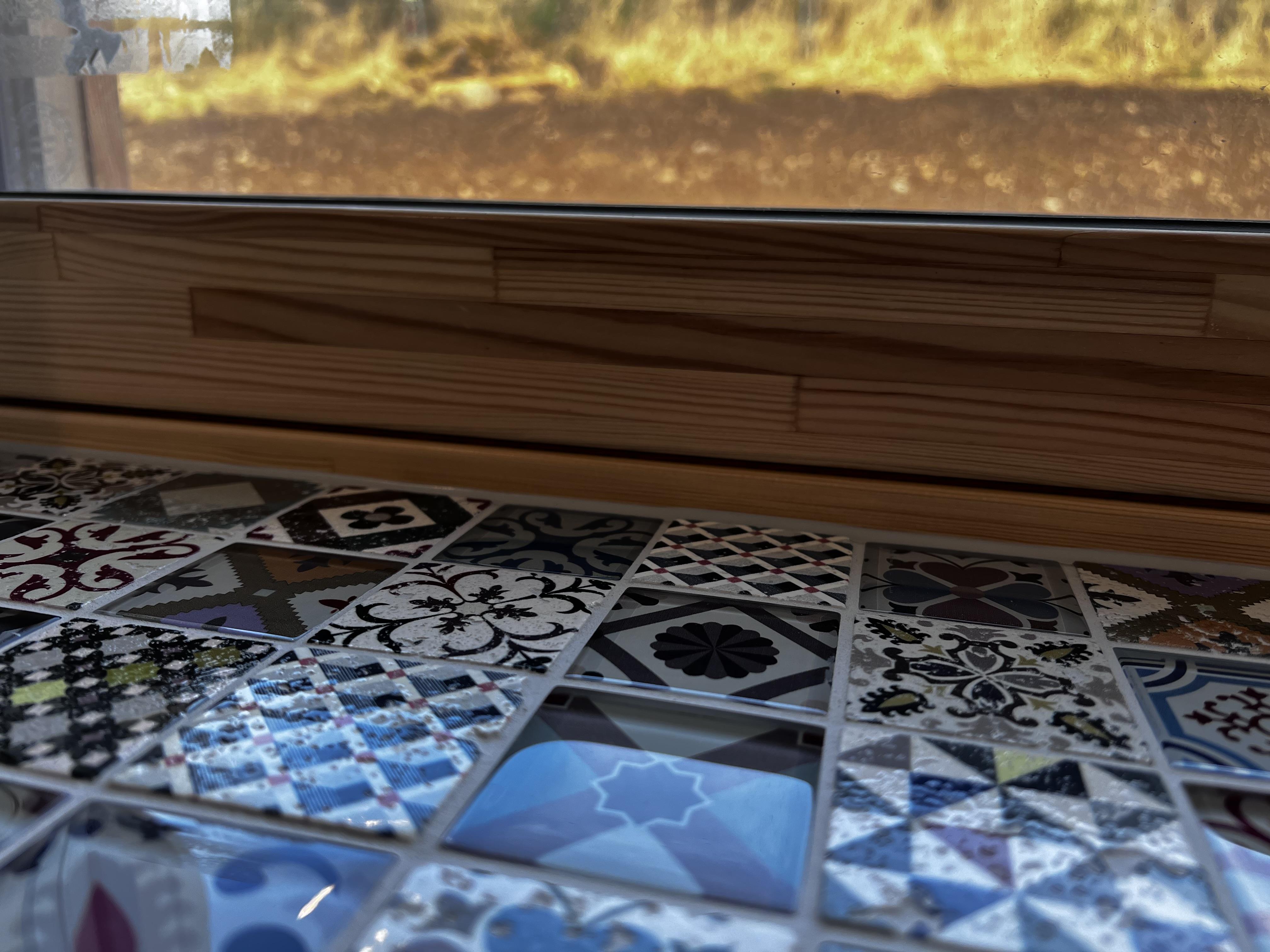

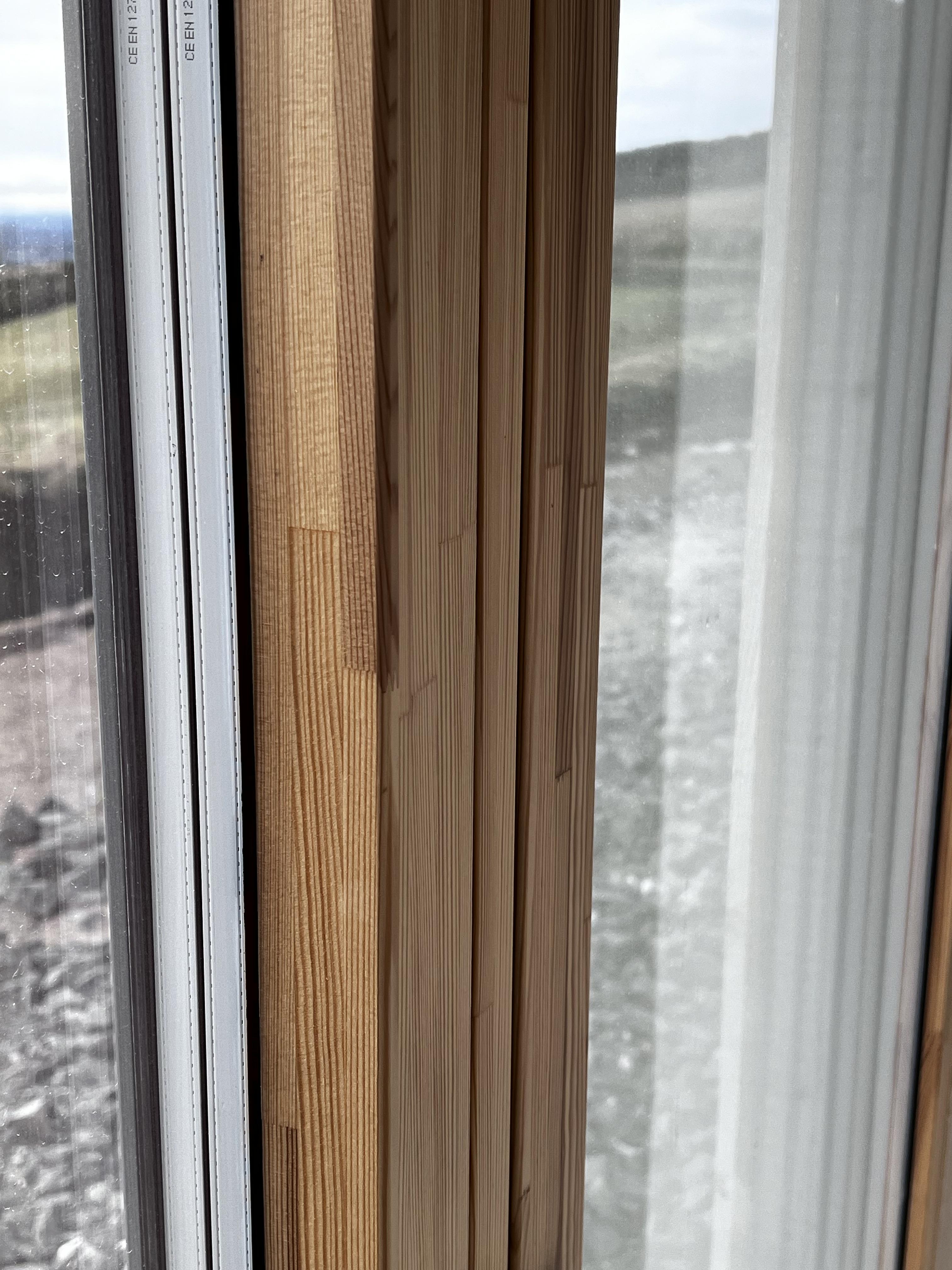

Kelvin Posted February 23, 2024 Share Posted February 23, 2024 Conversely it was jointed look that drew us to clear coating them. We were in a hotel in Are in Sweden several years ago and they had very similar looking windows and my wife was smitten with that look so was an easy decision for us (well her) Link to comment Share on other sites More sharing options...

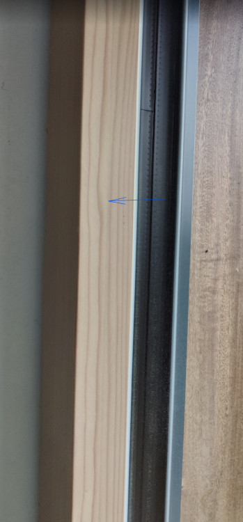

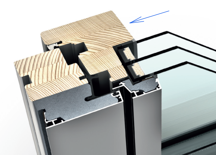

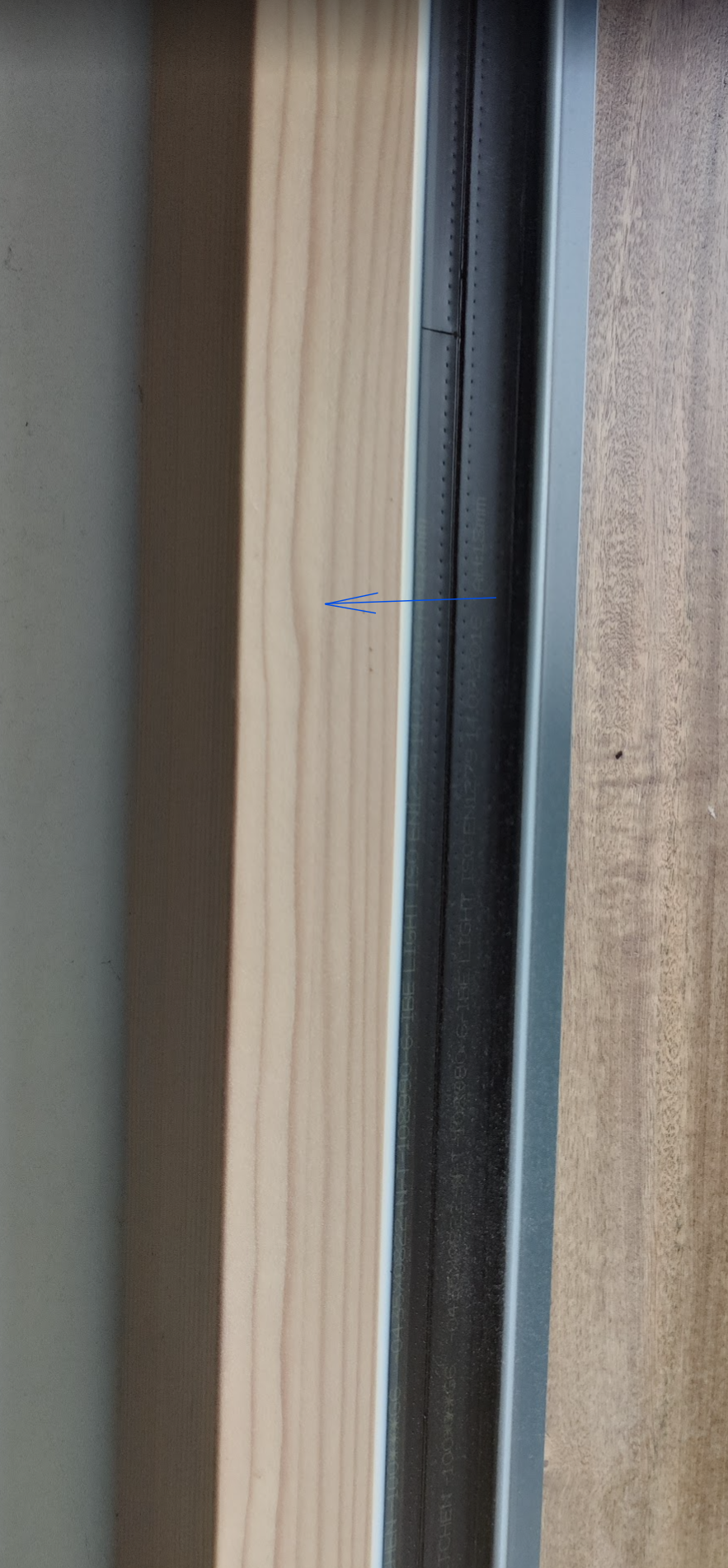

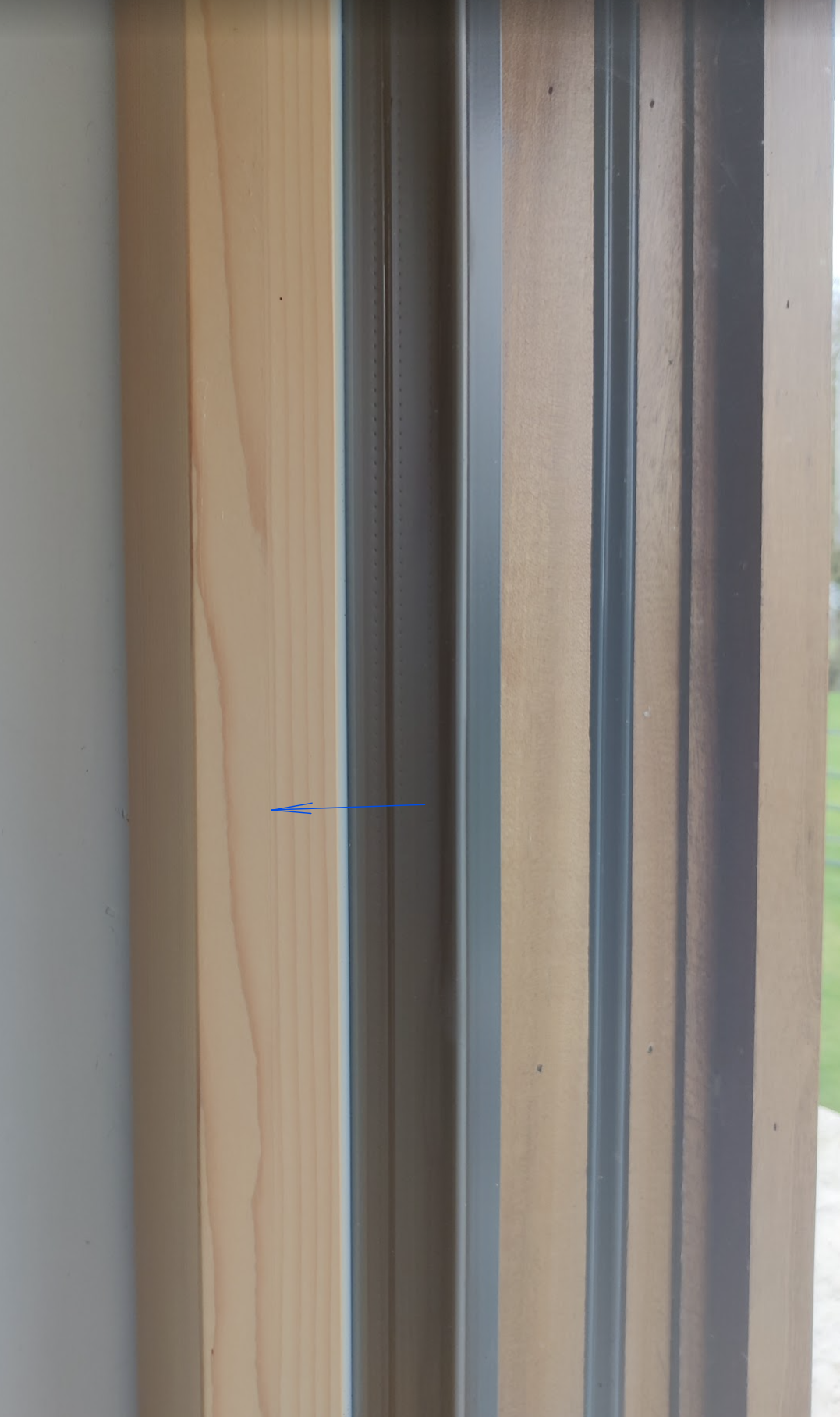

IanR Posted February 23, 2024 Share Posted February 23, 2024 1 hour ago, allthatpebbledash said: How about the lamination of the timbers put together? If you could, can you share some images please. There are no visible joints on the frames. The only laminate joint visible is on the inner return of a sash: Below is on two different windows. The left hand image is the worst I could find. All others are more similar to the right image where the grain better disguises the joint. 1 Link to comment Share on other sites More sharing options...
allthatpebbledash Posted February 23, 2024 Author Share Posted February 23, 2024 1 hour ago, IanR said: There are no visible joints on the frames. The only laminate joint visible is on the inner return of a sash: Below is on two different windows. The left hand image is the worst I could find. All others are more similar to the right image where the grain better disguises the joint. Thanks for the images. The timber finish looks really nice. Suppose it’ll now come down to price once we get to that stage. Link to comment Share on other sites More sharing options...
