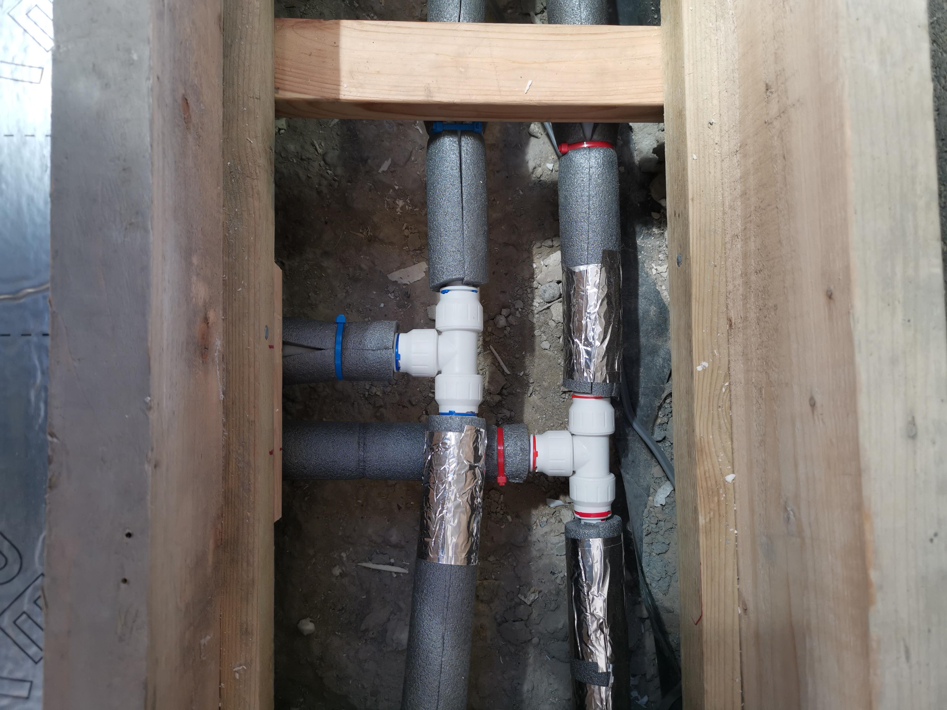

Super_Paulie Posted February 19, 2024 Posted February 19, 2024 I'm just about to seal up my floor. Forever. Before I do, what are people's preferred methods on insulation of the fittings within the void of a suspended floor? Or should I not bother?
Russell griffiths Posted February 19, 2024 Posted February 19, 2024 Buy a length of 25/ 28mm internal insulation and cut and secure around the fittings. 2
BotusBuild Posted February 19, 2024 Posted February 19, 2024 If you've got any bits of PIR and some thin bits of cushion type foam lying around: - two pieces PIR either side of the fitting - carve/gouge/fettle out some of the PIR to get each piece to fit snug as possible - a thin layer of cushion foam around the fitting, then tie-wrap the two pieces of PIR around that. Think of the PIR as two pieces of bread, the cushion foam as the butter, and the fitting as the cheese in between 1
Super_Paulie Posted February 19, 2024 Author Posted February 19, 2024 7 minutes ago, BotusBuild said: If you've got any bits of PIR and some thin bits of cushion type foam lying around: - two pieces PIR either side of the fitting - carve/gouge/fettle out some of the PIR to get each piece to fit snug as possible - a thin layer of cushion foam around the fitting, then tie-wrap the two pieces of PIR around that. Think of the PIR as two pieces of bread, the cushion foam as the butter, and the fitting as the cheese in between I don't think I have it in me to start to carve up PIR again, was the most brutal part of the build so far! Nice analogy though 😆
JohnMo Posted February 19, 2024 Posted February 19, 2024 If you go to a plumbers merchant you can get 35mm x 15mm insulation, goes over Hep2O fittings nicely. 2
Super_Paulie Posted February 19, 2024 Author Posted February 19, 2024 I've just picked up some 28mm from Screwfix, see how that goes. That's as big as they went so I'll see how I feel about it.
SimonD Posted February 19, 2024 Posted February 19, 2024 Try here: (Used to be JTM Plumbing) Good supply of all types of pipe insulation: https://www.plumbingsuperstore.co.uk/browse/pipe-insulation.html
Super_Paulie Posted February 19, 2024 Author Posted February 19, 2024 (edited) Cheers gents. The 28mm goes on with a bit of cutting, slicing and cable ties. 35mm would have been better as JohnMo says, but this will work for me. Much appreciated as per 👍 Edited February 19, 2024 by Super_Paulie
