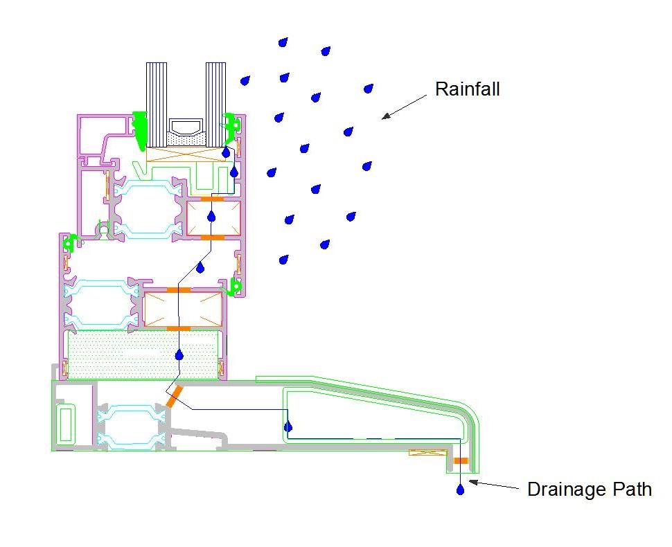

oliwoodings Posted February 18, 2024 Share Posted February 18, 2024 Is the door frame sitting on top of the slate, or is the slate butting up against the side of the frame? The choice to not have a cill seems really odd - how is water meant to drain out of the frame? If you're not aware, no matter how well a pvc door is made and installed, water can still end up entering the frame. To handle it, the frame has drainage holes which leads down to the cill. It then either drains over the top of the cill or through it and out the bottom. Something like this: With your setup, I don't see how any water that enters the frame can drain out. That, plus capillary action on the cladding, seems like a likely cause. 1 Link to comment Share on other sites More sharing options...

RobertW Posted February 19, 2024 Author Share Posted February 19, 2024 @oliwoodings Thank you for your reply and your detailed image. @markc Thank you also for your observation. The bottom slate rests on the concrete base and the top slate rests on the bottom slate to elevate the door (to make up for the mistake involving ground clearance) the door frame then rests on the top of the top slate. They have used sealant underneath the door frame threshold as well as sealant between the slates and around the edges of the slates. I've drawn a little diagram. I think you're right though. The water is soaking into the wood and there appears to nowhere for the water to from out from. Also the slates do seem to be level which means the water rests on the slates rather than running off. We can't (easily) take the door out without causing damage to door edging and the internal plasterboard so my current thinking, rather than try nearly cut away the cladding is to actually take away the problem, the slate. If I were to chisel it away then the water would have somewhere to run and then we can worry about how to make it look neat and tidy later. What you have said is really helpful though. Thank you. What is even more soul-destroying is that we got the builders to build two buildings and the other one has a larger slate step but exactly the same problem - so I can see why now. even though they have put loads of sealant all around it, the water is clearly soaking into the wood but then has nowhere to go. I may have to cut away the slate underneath and then make a channel for the water to run out of and off to the side and either a channel underneath or remove some of the cladding. Either way, i have a better understanding of the problem now. Thank you. Rob Link to comment Share on other sites More sharing options...

markc Posted February 19, 2024 Share Posted February 19, 2024 @RobertW have you identified the frame drain holes? The bottom of the frame should have some, just thinking if any water getting into the lower frame has no means of escape (usually into the cill) then it could find its way out at the end of the mitres - effectively inside the building. Link to comment Share on other sites More sharing options...
oliwoodings Posted February 19, 2024 Share Posted February 19, 2024 6 hours ago, markc said: @RobertW have you identified the frame drain holes? The bottom of the frame should have some, just thinking if any water getting into the lower frame has no means of escape (usually into the cill) then it could find its way out at the end of the mitres - effectively inside the building. That's exactly my thinking, I don't see how water can drain anywhere unless there are front drainage holes, but I don't see any in the pictures. @RobertW why don't you get the builders back to sort their dodgy job out? 1 Link to comment Share on other sites More sharing options...

RobertW Posted February 20, 2024 Author Share Posted February 20, 2024 Thank you all again for your replies. @RoundtuitThey are UPVC doors. You've all hit the nail on the head and you have all been incredibly helpful and I appreciate it. I will go back to the builders and now I have a better understanding of the problem, I can't be fobbed off and I can tell them exactly what we want. Many thanks, Rob 1 Link to comment Share on other sites More sharing options...
saveasteading Posted February 20, 2024 Share Posted February 20, 2024 58 minutes ago, RobertW said: a better understanding of the problem, I can't be fobbed off and I can tell them exactly what we want I've just seen this and the advice is very good. I'd just advise that you approach the builder in friendly fashion. Every building is different and challenges do present themselves. No builder knows everything. This is an easy one to sort, with the expert advice above, and a smile. Cut back the timber (and perhaps add a drip). Add protection to the raw cut end. You are left with some exposed concrete which perhaps paint in bitumen. Add weep holes to the frame. They need to be a decent size or the water will stick there. Will the water run away from it even then, if the slate is level? Link to comment Share on other sites More sharing options...
