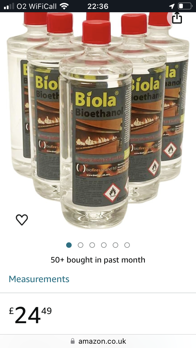

1 hour ago, Russdl said:
We get ours from Amazon.
Care to post an example?  Can you get it in sensible size quantities.
I ask because we have a spirit burning stove on our boat and we currently burn meths which stinks.  I would like to find an alternative fuel for it that has no smell, and is available in larger bottles than the usual silly little 500ml meths bottles.  And preferably cheaper than that (hence wanting to buy in larger quantity)
This is the stuff we’ve ordered. 6 x1L bottles, £24.49
