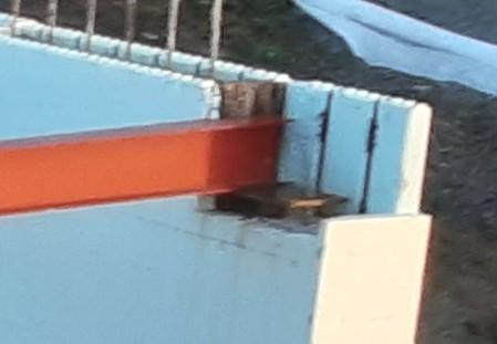

Cropped photo , so not focussed, but you should get the idea. We added the extra Nudura forms around the steel, braced it excessively, and then hand poured these pockets to enclose the steel.

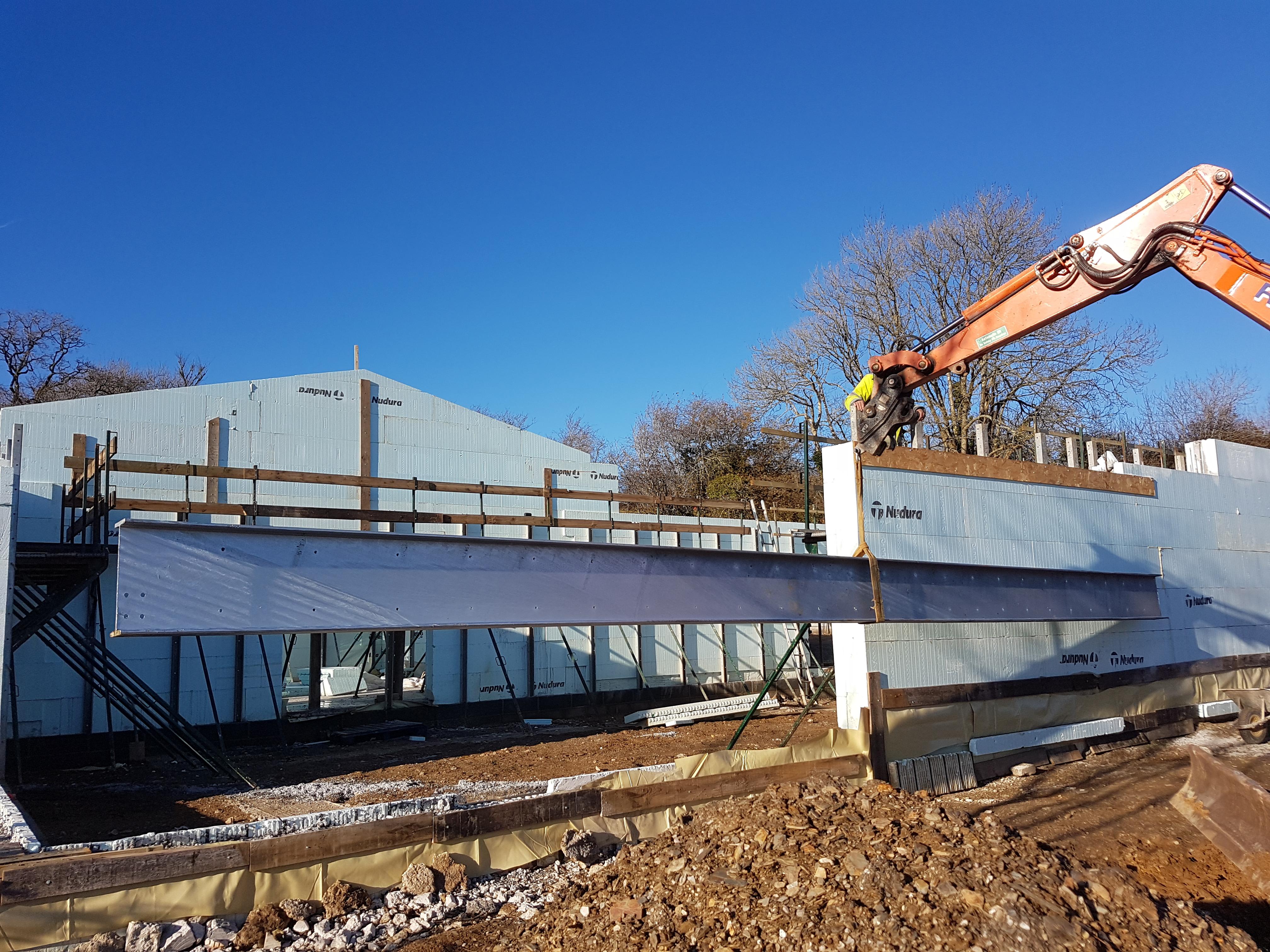

We had to use a large steel for a similar span. Our builder cut the Nudura block exactly level with the bottom of the steel, then the concrete was poured and screeded to this (with some bolts cast in too for attaching the steel. The block was then reinstated around the steel for the second pour. Pic is of the steel being lifted in to place but you can see the cut Nudura on the right

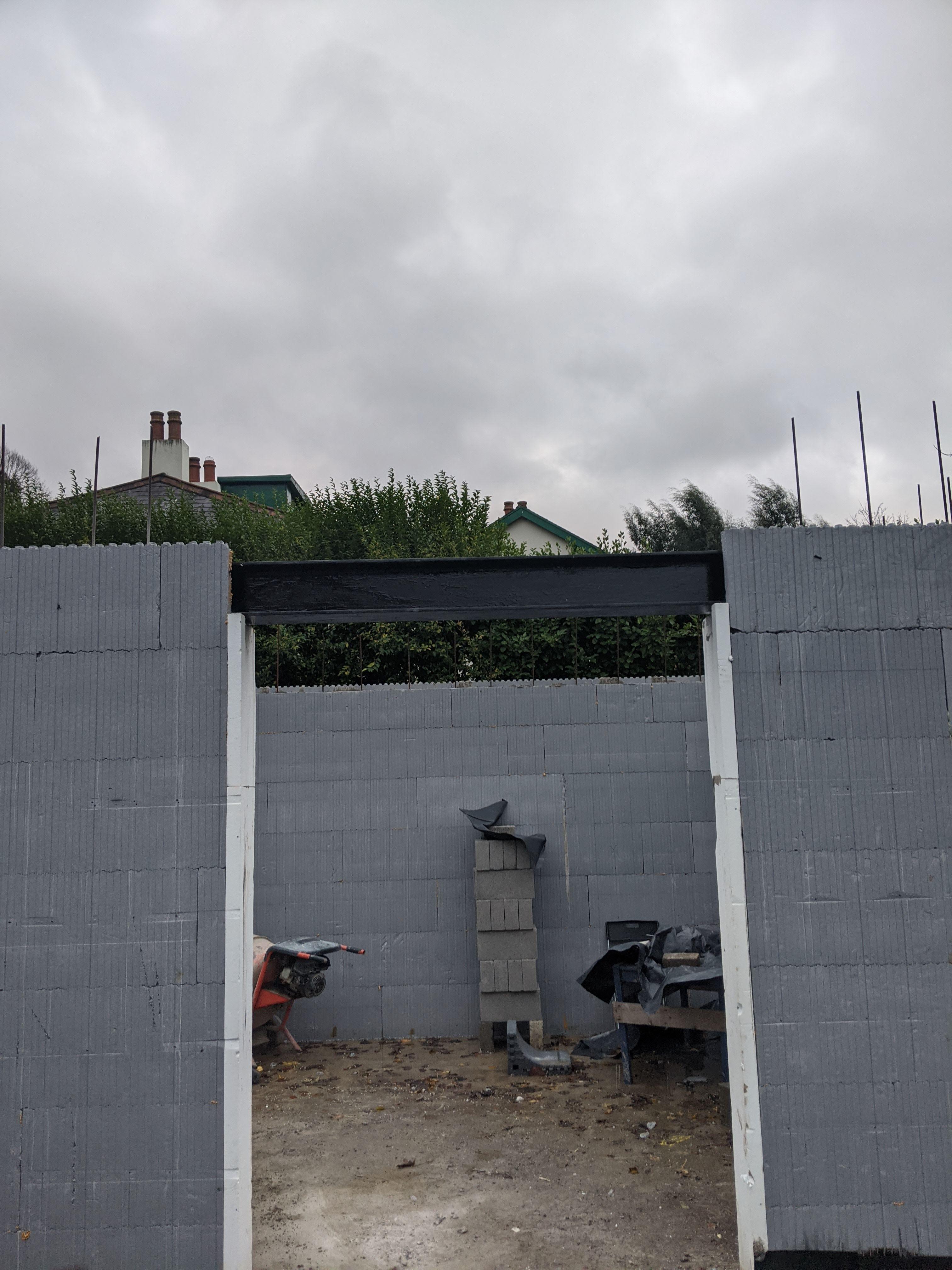

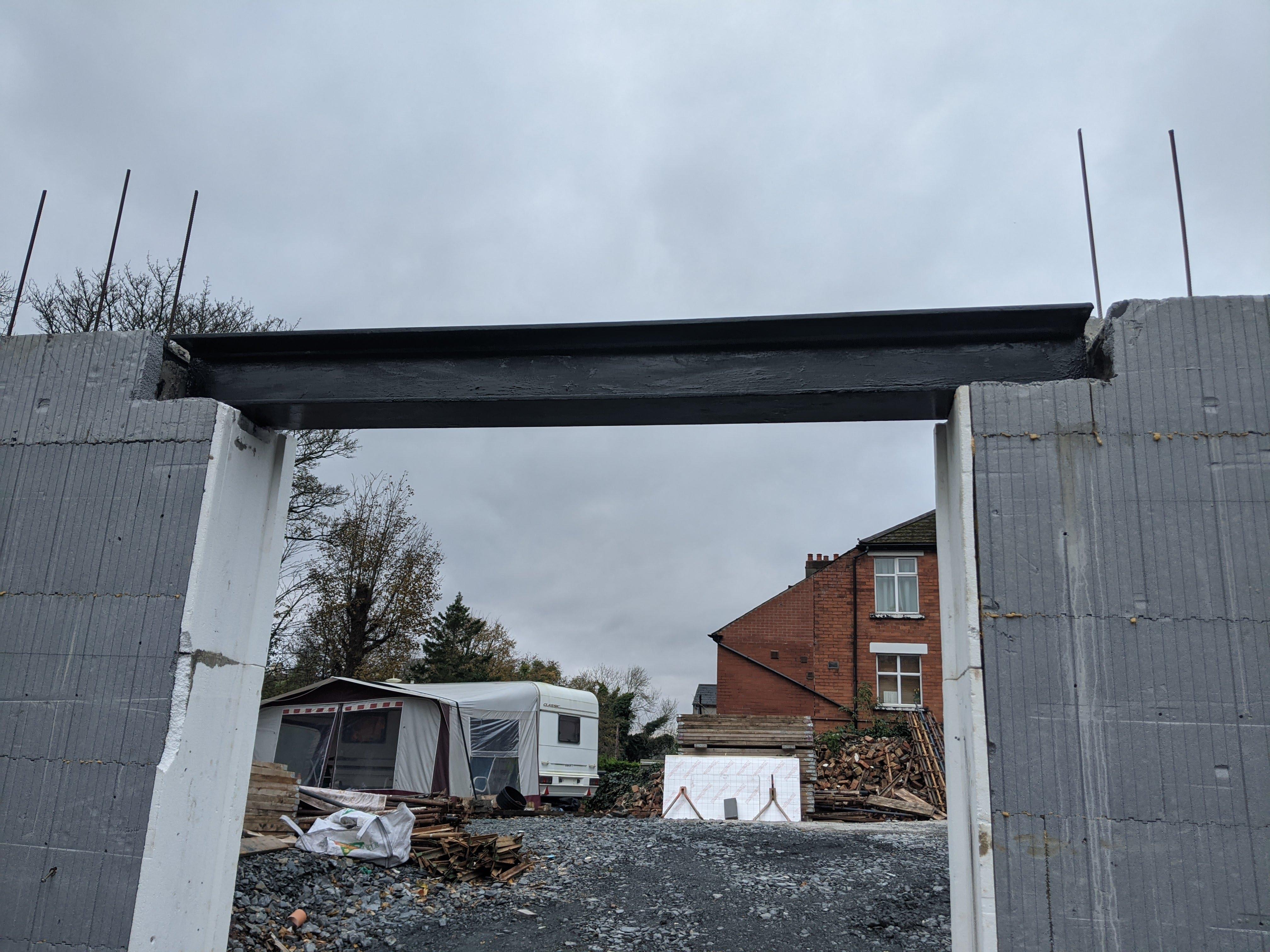

That detail is not constructable as there will be nothing keeping the blocks together as you've effectively turned them in to two flat lengths of EPS. You put concrete to the level the beam will set, set the beam on, then build up the rest of the ICF around/over it. You then come back and fix insulation around the beam.
PXL_20201112_155246540.thumb.jpg.4fc58af7062327b187305d6ba7b48fde.jpgPXL_20201112_155147934.thumb.jpg.f95d4f4717b354e3014c401251be68c0.jpg
 It clearly is, see my picture above! Depends on what residual webbing is left between the EPS faces when the blocks are cut, and what external bracing you add
Agree!
Link to comment
Share on other sites
Well, yes I suppose lol!! What I mean is it's a pain in the arse and depends on the depth of beam, positioning, and the type of ICF block and it's webbing. The method we used was fast and low risk. With the 203x203 beam, it's wider than the cavity and leaves no webbing in the block.
