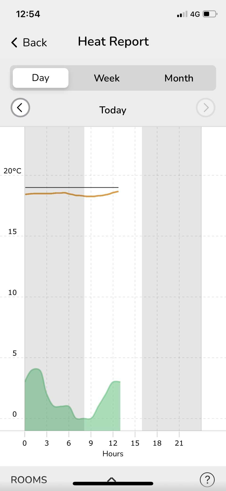

DamonHD Posted Friday at 12:39 Share Posted Friday at 12:39 (edited) FWIW my own live-ish TRV percentage-open chart (for most of the rads): and call for space heat: Note that there is currently a problem with this system and it hasn't been fully commissioned (or paid for!) yet, and I am continuing to tweak as householder and researcher. So have a good laugh! B^> Edited Friday at 12:54 by DamonHD Link to comment Share on other sites More sharing options...
