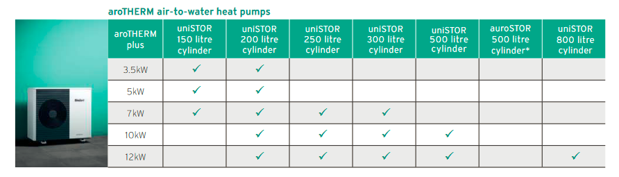

Bruce Posted January 30 Share Posted January 30 We are about to get a new hot water cylinder in the loft that we will run on immersion until we get the heat pump installed later this spring and our plumber has recommended the Vaillant 200l heat pump-ready cylinder, uniStor. I suspect he has recommended this mainly because they also install heat pumps under Vaillant umbrella scheme. These cylinder seems quite popular and it has the advantage that it is a bit shorter than many others of the same size, this is good as we can only fit a 1400mm tall cylinder with a 50-55cm in diameter. My concern is that these cylinders have a coil size of 1.4m2 whilst others from Gledhill, Telford etc have about 2-3.5m2 coil area, quite a lot bigger. Does this actually affect the SCOP of the heat pump or is it more of a matter that it takes longer to heat up the water when it has a smaller coil and such the house sits without heating for longer? Any other reason to not use a Vaillant cylinder when not knowing what heat pump we might end up with later this year? Link to comment Share on other sites More sharing options...
TonyT Posted January 30 Share Posted January 30 Is 200litres enough for your needs is the first question? cylinder manufacturers generally advise on how many kW required to heat the cylinder from cold to hot in 20 minutes I recall larger coil size = less reheat time. do you have PV? Will you have top/bottom immersions too to provide back up and utilise excess PV generation? can the hatch be made larger, a day’s joinery work will Have the hatch enlarged, giving more options for larger diameter cylinders? will the loft take the weight? Good luck Link to comment Share on other sites More sharing options...

sharpener Posted January 30 Share Posted January 30 (edited) If you can, it would be better to decide what HP you are going to have as they (or their installers) can be picky about what cylinders they will work with. Installers will also want to make sure you have a big enough tank, one popular formula is (no. of bedrooms + 1) x 45 litres, and may argue that even if you need less HW than that now a subsequent purchaser might want more. You do not say what size HP you are planning (for the purposes of calculation 1 kW provides 861 litre-degrees of water heating per hour, so about 4 deg/hr for a 200 l tank). Vaillant have in the past said that they need a 3 sq m coil for any of their HPs, but their own compatibilty chart does not actually require it. In reality it will almost certainly be OK. After a lot of work (see my and @JamesPa's postings dating back months) I finally secured Vaillant's agreement that my existing OSO 210 l tank can be used with their 12kW HP, even though it has an assumed 0.75 sq m coil, provided I fit a bronze secondary circulation pump to increase the heat transfer. The recovery time is in any case not very important if you heat the bulk of the water overnight at cheap rate, while the heating is on setback anyway. OTOH if you have a high demand in the early evening for 4 ppl showering before going out (another recent thread), or for childrens' bathtime, then you might need a re-heat after lunch, when the air temp will be higher and so the CoP a fraction better. And Octopus Cosy is cheap again. Edited January 30 by sharpener Link to comment Share on other sites More sharing options...

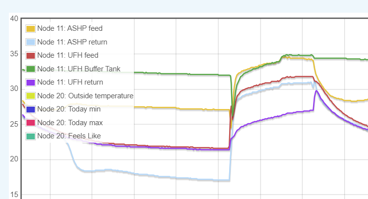

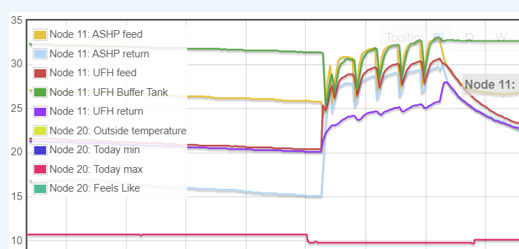

JohnMo Posted January 31 Share Posted January 31 7 minutes ago, Bramco said: We now run the ASHP on heating for 4 hours at night Out of interest what flow temp do you use? Link to comment Share on other sites More sharing options...
Bramco Posted February 1 Share Posted February 1 18 hours ago, JohnMo said: Out of interest what flow temp do you use? @JamesPa Flow out is about 30C and back is around 25C. The ASHP is set to 35C but even when it's not defrosting, it never reaches this, so it runs continuously for the full 4 hours. When it has to defrost, you can see a dip in both the ASHP output and input and the UFH feed and return. I think we'd set the ASHP setpoint to 35C to aim to get a flow temp approaching that but with the way things work, i.e. the ASHP never really reaching the setpoint, it's actually probably working optimally, in that when the ASHP doesn't have to defrost it runs continuously, so is probably getting a great COP. Sadly can't see this on the Cool Energy units - I'm considering putting one of the open energy monitor ASHP kits in so that we can see what we're really achieving but that means draining down the ASHP loop to put a heat meter in, so will have to be done in the summer. Graphs below to give you an idea of how things work - our build was almost passive house, very airtight, MVHR, insulated slab with embedded UFH loops, so we don't need much heat and when the slab is warm we don't lose heat v fast. Warm night, so a bit above normal, no defrost. Cold night with defrost. Given it was very cold, the immersion in the UFH tank we use for a boost when it's below 5C was probably also on. Link to comment Share on other sites More sharing options...
