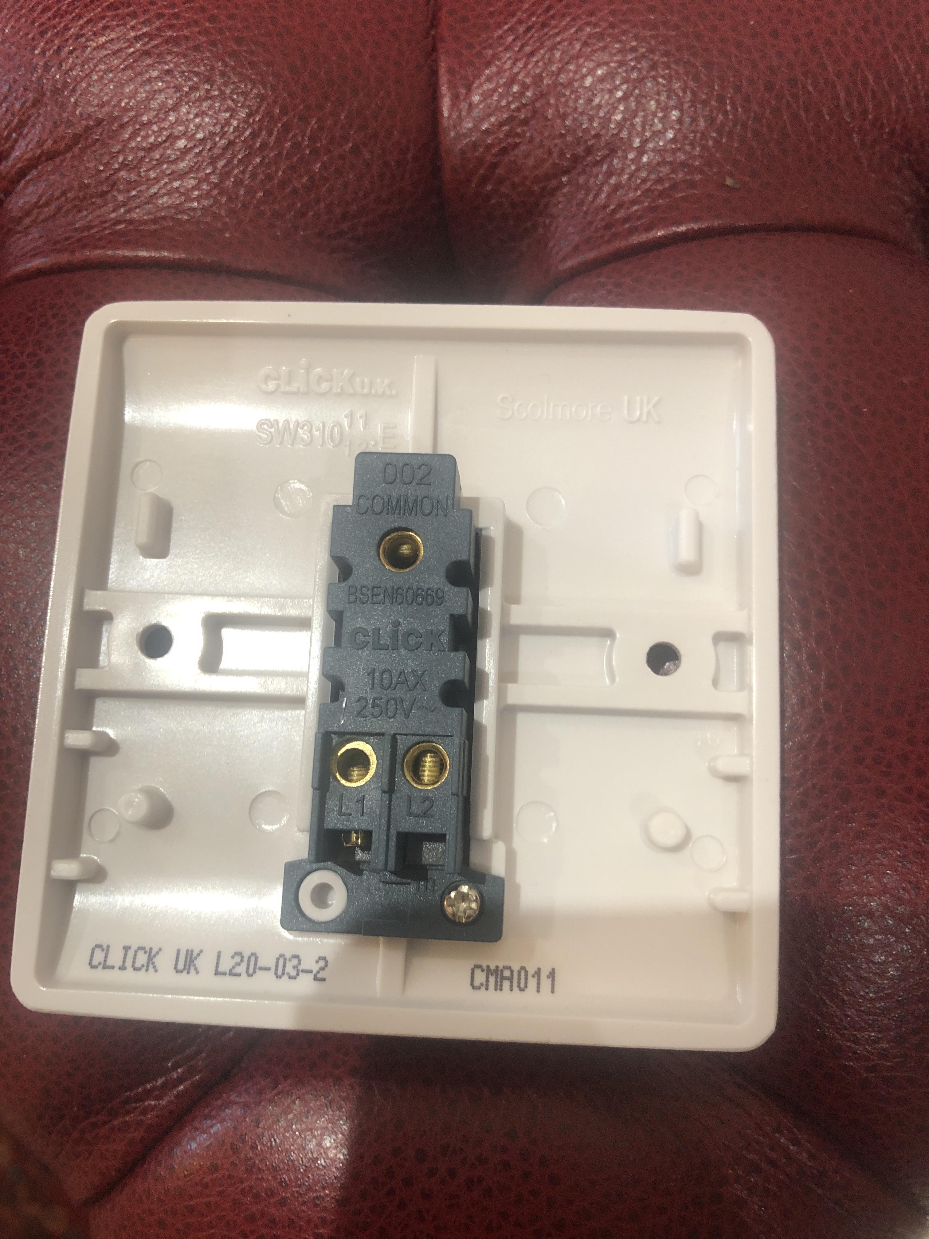

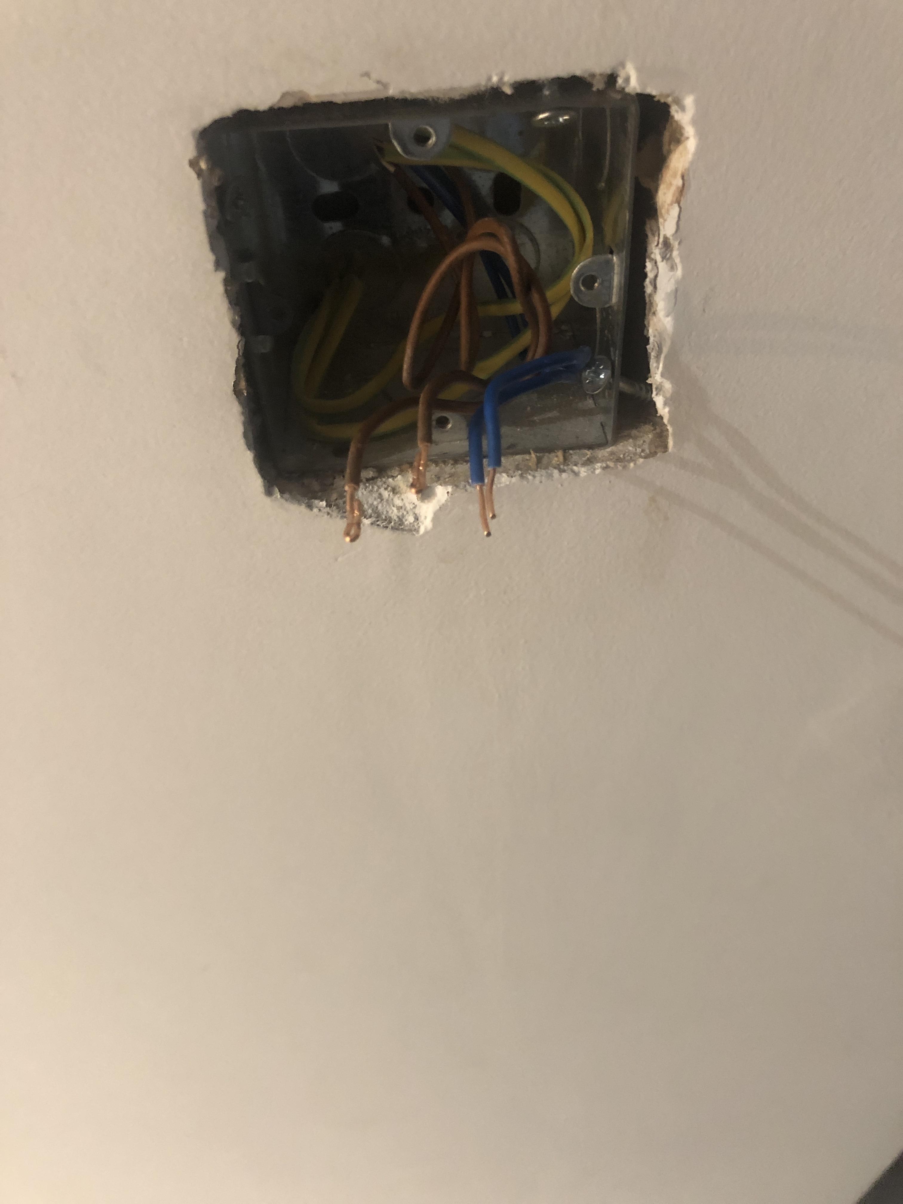

Pocster Posted January 29, 2024 Posted January 29, 2024 About to wire a simple light switch . Switch has L1 , L2 and common Wall wiring has 2 lives and 2 neutrals . Googling is confusing me ! Is it just brown live into L1 , other into L2 ( single gang ) ; then both neutrals into the common ? Confidence I’m right , becomes hesitation, which becomes doubt , which becomes ask !
Pocster Posted January 29, 2024 Author Posted January 29, 2024 Hmmmm I think L2 isn’t used and neither of the neutrals ? ( just tape and push out the way ) . So maybe simply live into L1 and other live into common ? Now I clearly don’t know ….
joe90 Posted January 29, 2024 Posted January 29, 2024 I would guess that one cable is incoming (power supply) and the other feeds the actual light 🤷♂️, therefore one live into common and the other into either l1 or l2 (does not matter) and the two neutrals connected together in a separate cable connector. 1
Pocster Posted January 29, 2024 Author Posted January 29, 2024 On 29/01/2024 at 11:54, joe90 said: I would guess that one cable is incoming (power supply) and the other feeds the actual light 🤷♂️, therefore one live into common and the other into either l1 or l2 (does not matter) and the two neutrals connected together in a separate cable connector. Expand This is what I’m thinking @joe90 ( now ) . But you said ‘guess’ 🤣 - I don’t like guessing on electrics . I think we are correct but will wait before I commit to electrocuting… 😎
markc Posted January 29, 2024 Posted January 29, 2024 (edited) On 29/01/2024 at 11:45, Pocster said: About to wire a simple light switch . Switch has L1 , L2 and common Wall wiring has 2 lives and 2 neutrals . Googling is confusing me ! Is it just brown live into L1 , other into L2 ( single gang ) ; then both neutrals into the common ? Confidence I’m right , becomes hesitation, which becomes doubt , which becomes ask ! Expand No! Do not put neutrals in common, neutrals stay separate. Post a pic of what you have in the other box. simple switch is common and L1 or L2 Edited January 29, 2024 by markc 1

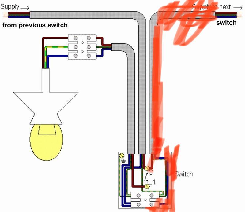

Gone West Posted January 29, 2024 Posted January 29, 2024 @Pocster One way loop at switch diagram. 1 1
Pocster Posted January 29, 2024 Author Posted January 29, 2024 (edited) On 29/01/2024 at 12:19, markc said: No! Do not put neutrals in common, neutrals stay separate. Post a pic of what you have in the other box. simple switch is common and L1 or L2 Expand After my re think I’m going with neutrals tied together and out the way . 1 live in common other in L1 . I bet my life ( literally ) on that being correct . Edited January 29, 2024 by Pocster 1

Pocster Posted January 29, 2024 Author Posted January 29, 2024 On 29/01/2024 at 12:23, Gone West said: @Pocster One way loop at switch diagram. Expand That what I said isn’t it ? . I’ll make a few alterations

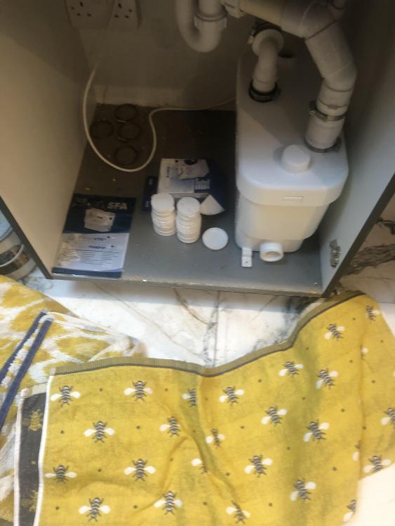

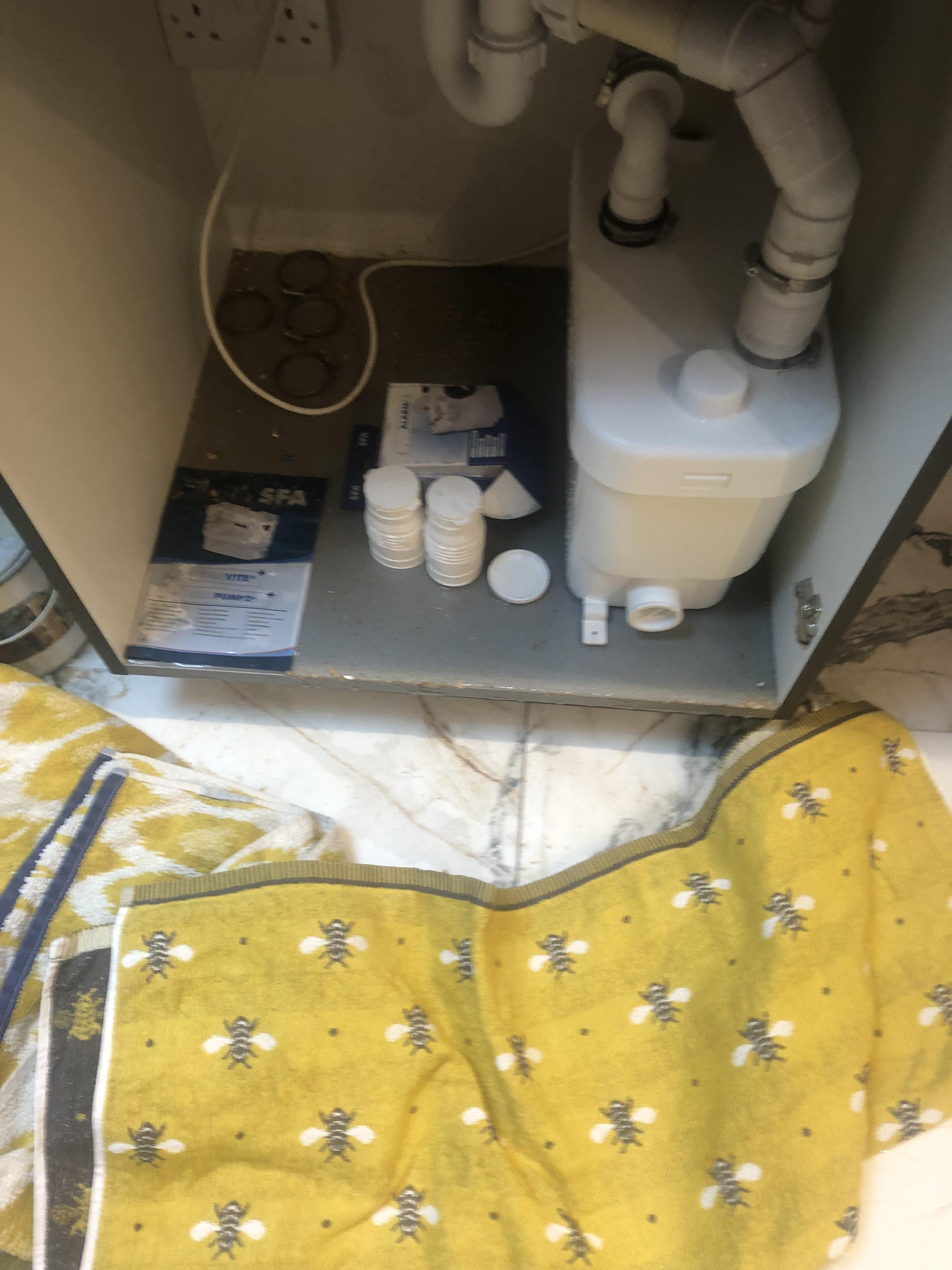

Pocster Posted January 29, 2024 Author Posted January 29, 2024 Ffs ! Over enthusiastic cutting on pump causes jubilee clip to come apart and flood . No lights or sink now ! 🙄 (expletive deleted)ing Mondays
markc Posted January 29, 2024 Posted January 29, 2024 Going back to the switch, yes I recon the neutrals were linked in the box, not on the switch plate. .. they could have been used as lives but should have been taped accordingly if so. Put them in a wago or block on their own …. For now lol 1
Gone West Posted January 29, 2024 Posted January 29, 2024 On 29/01/2024 at 12:56, Pocster said: That what I said isn’t it ? Expand Quite possibly, I just find following a diagram easier. 1
Pocster Posted January 29, 2024 Author Posted January 29, 2024 On 29/01/2024 at 13:55, Gone West said: Quite possibly, I just find following a diagram easier. Expand I find diagrams confusing I find what I read confusing I find what I post confusing 1
