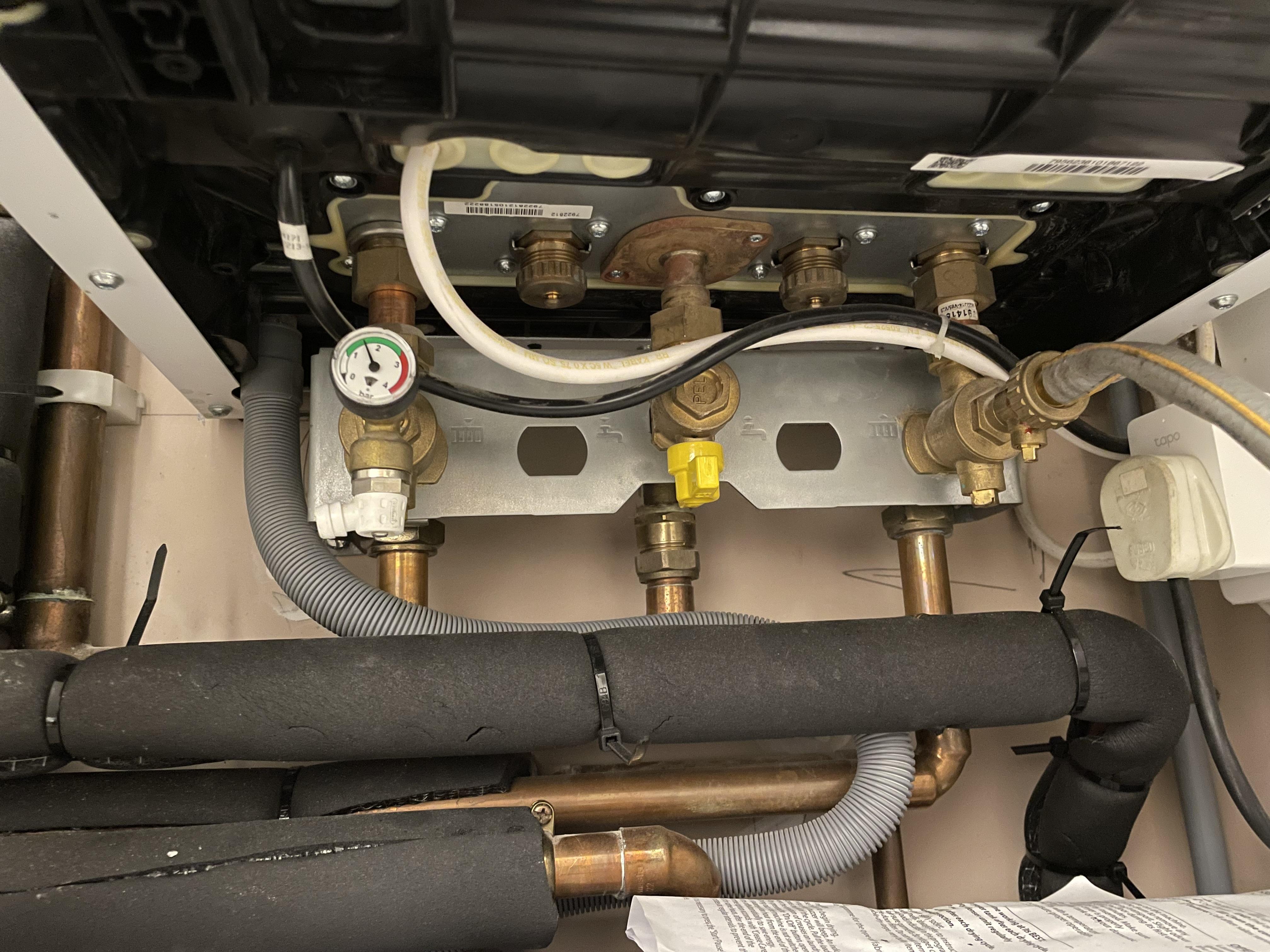

SimonD Posted January 28, 2024 Posted January 28, 2024 On 28/01/2024 at 14:45, Adsibob said: But the HW control is separate to the UFh controls. And whereas the UFh controls are zoned and use low temp water, the HW control doesn’t. So if you could recommend a smart controller for the Hw I’d be grateful. Expand Do you know if your boiler has been installed with the 4 pipe system or 2 pipe system? Take a pic of boiler and pipework below maybe?

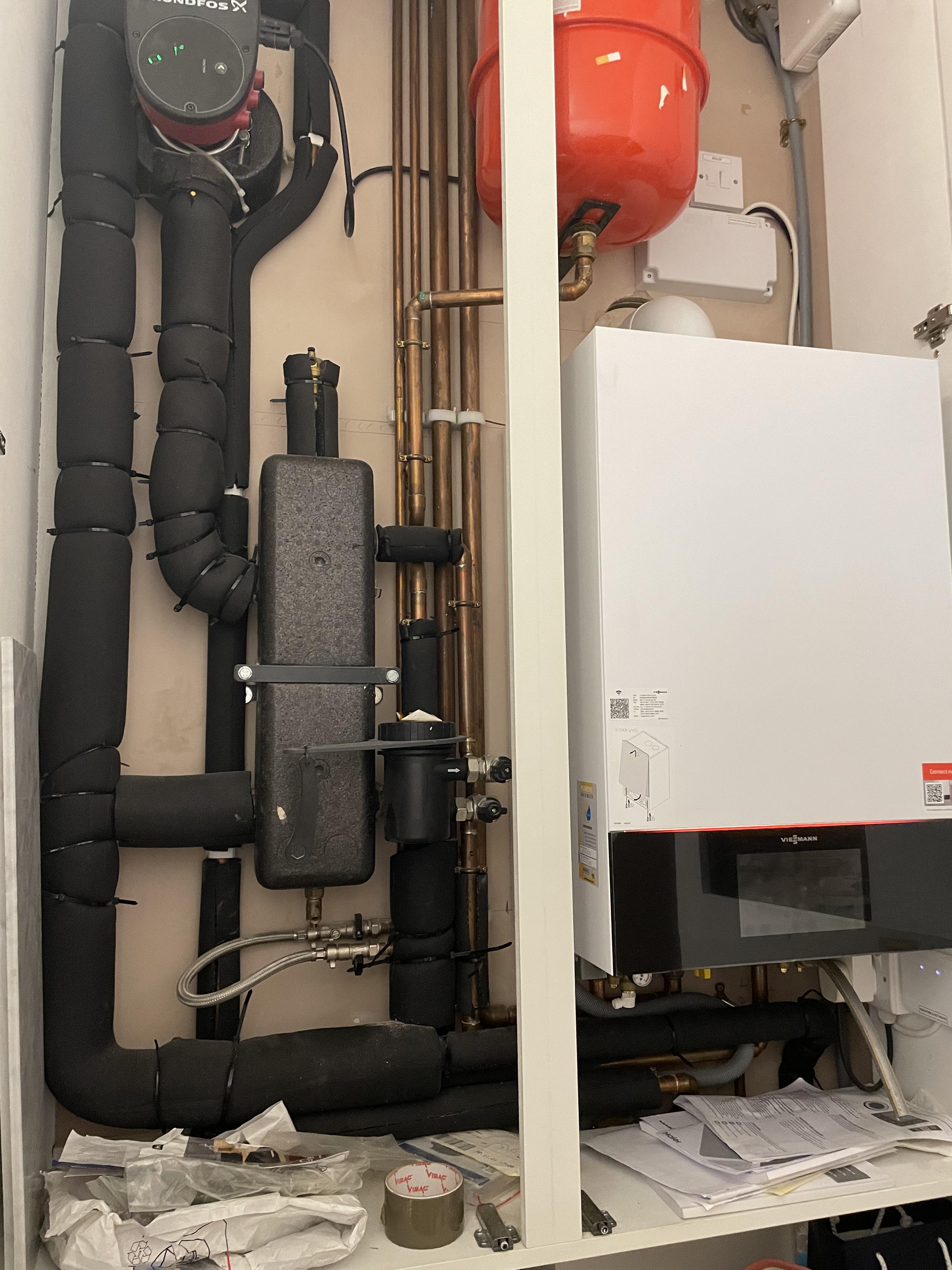

Adsibob Posted January 28, 2024 Author Posted January 28, 2024 On 28/01/2024 at 17:47, SimonD said: Do you know if your boiler has been installed with the 4 pipe system or 2 pipe system? Take a pic of boiler and pipework below maybe? Expand From what I can see, it’s two pipes, plus a gas pipe: I also have a low loss header, not sure if that impacts your views (see next post)
Adsibob Posted January 28, 2024 Author Posted January 28, 2024 On 28/01/2024 at 19:08, Adsibob said: next post Expand
SimonD Posted January 28, 2024 Posted January 28, 2024 On 28/01/2024 at 19:08, Adsibob said: From what I can see, it’s two pipes, plus a gas pipe: I also have a low loss header, not sure if that impacts your views (see next post) Expand Yes, it's a 2 pipe install. For PDHW the two pipes between the outer flow and returns and gas pipe would be used to supply the DHW. So it is possible to modify your existing installation, but not without some work. I can't quite make out all the pipework in your photos, but you'd need to run pipes from these boiler connections straight to your hot water cylinder and this can bypass your low loss header pipework completely. You'd then modify the existing pipework that currently goes through the motorised valves to your water cylinder and just cap it off. Wiring wise, you could still use your existing cylinder stat, but wire in a Viessmann cylinder demand terminal box which converts the 230v call from the cylinder to low voltage to go into your boiler to run the 4 pipe PDHW. That way you can still control the schedule from your Tado app. Otherwise, you could rewire to hot water control using the low voltage DHW cylinder temperature sensor. That should, in theory, work...
Adsibob Posted January 28, 2024 Author Posted January 28, 2024 @SimonD thanks. Please could you explain what is wrong with my current setup and how much more efficient heating the cylinder would be if I did this work? Just trying to understand the cost benefit analysis.
Adsibob Posted January 28, 2024 Author Posted January 28, 2024 To at to my previous post, my understanding is that for a boiler to go into “condensing mode” the return temperature should not be higher than about 55C and a low loss header can assist with this. So I’m just trying to figure out if the benefit I’m getting from the low loss header might be cancelling out the efficiency deficit of not having PDHW.

TonyT Posted January 29, 2024 Posted January 29, 2024 You don’t add a low loss header for adding efficiency, generally used if you have more than one boiler or multiple pumps to provide hydraulic separation to the system. you have a decent boiler I wouldn’t stress any more .
