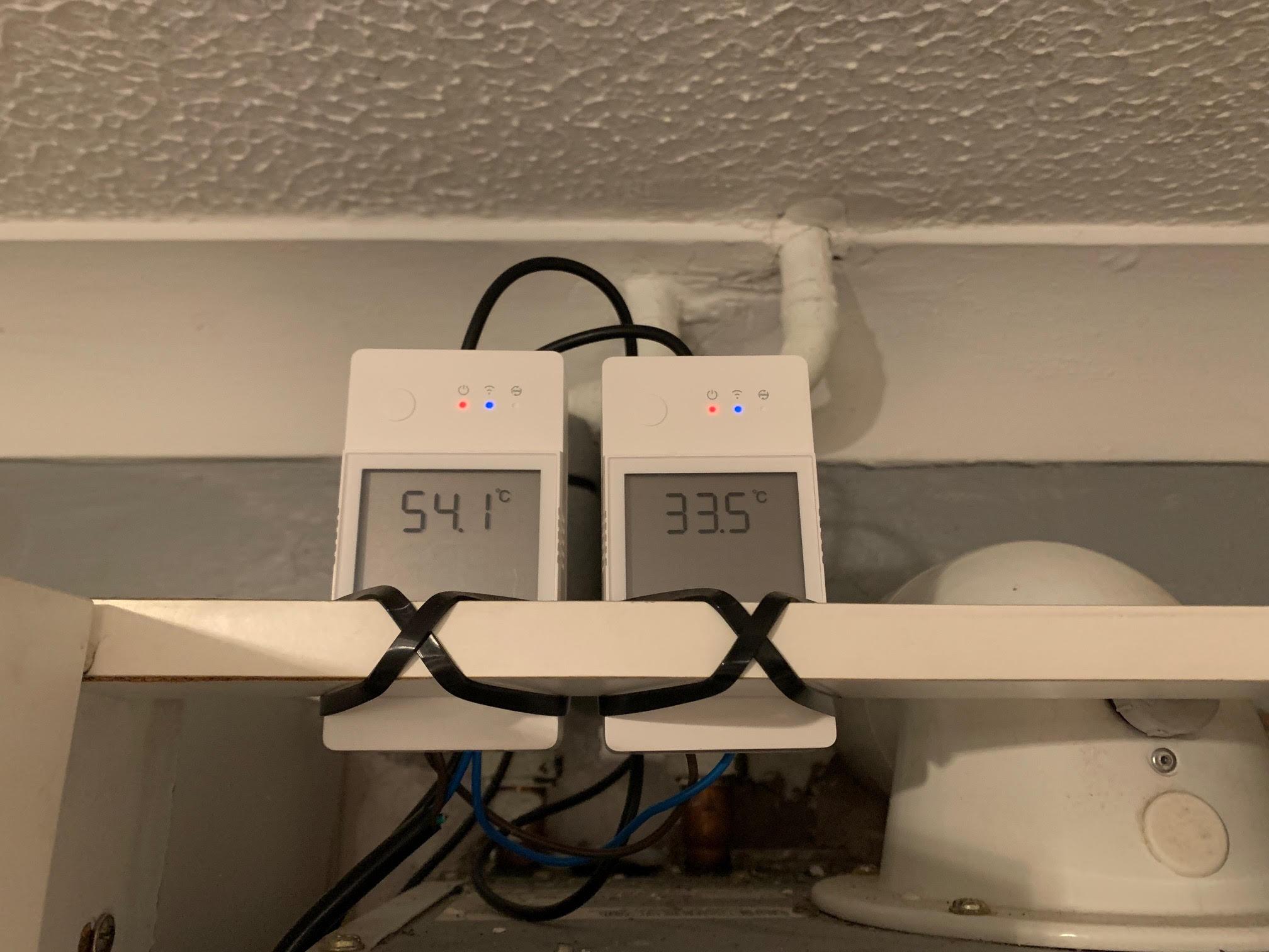

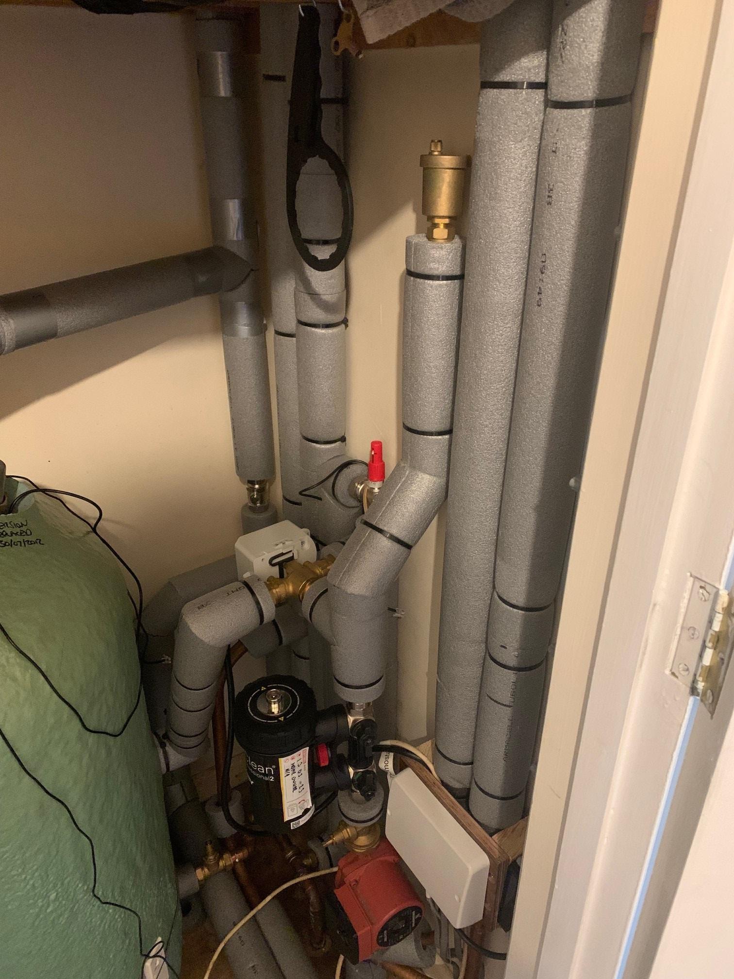

marshian Posted January 25 Share Posted January 25 Rather than continue to threadjack another post System info Y plan system Vented cylinder 112 Litres (Installed 2011 from memory) Insulation on all the pipes around the tank - extending to loft and in loft to header tanks. I still think my losses are too high 0.5-0.7 deg per hour Lagging is good quality Turbolit (a considerable improvement on std DIY stuff - albeit that was better than bare copper pipes) 22mm copper pipes have 9.5 mm wall insulation 15mm copper have 12.5 mm insulation I use a pipe lager pro mitre box to get neat joints and most are glued But I think I might have a reason but I'd like an opinion on it My three port valve is at rest on HW and powered to mid position or CH At the end of every CH cycle the time runs the HW for a min to reset the valve to rest (if left in HW the motor body gets warm - warm = electricity - constant running = wear and tear on the valve head) Hot moves to cold - water in the coil is heated back by the hot in the tank and convection currents move the water/heat back to the boiler - if I swapped the 3 port valve round (and the wiring) I could make the CH position the rest and it would block any flow back to the boiler - however the other end of the coil would still be connected to the boiler by the return pipe?? Link to comment Share on other sites More sharing options...

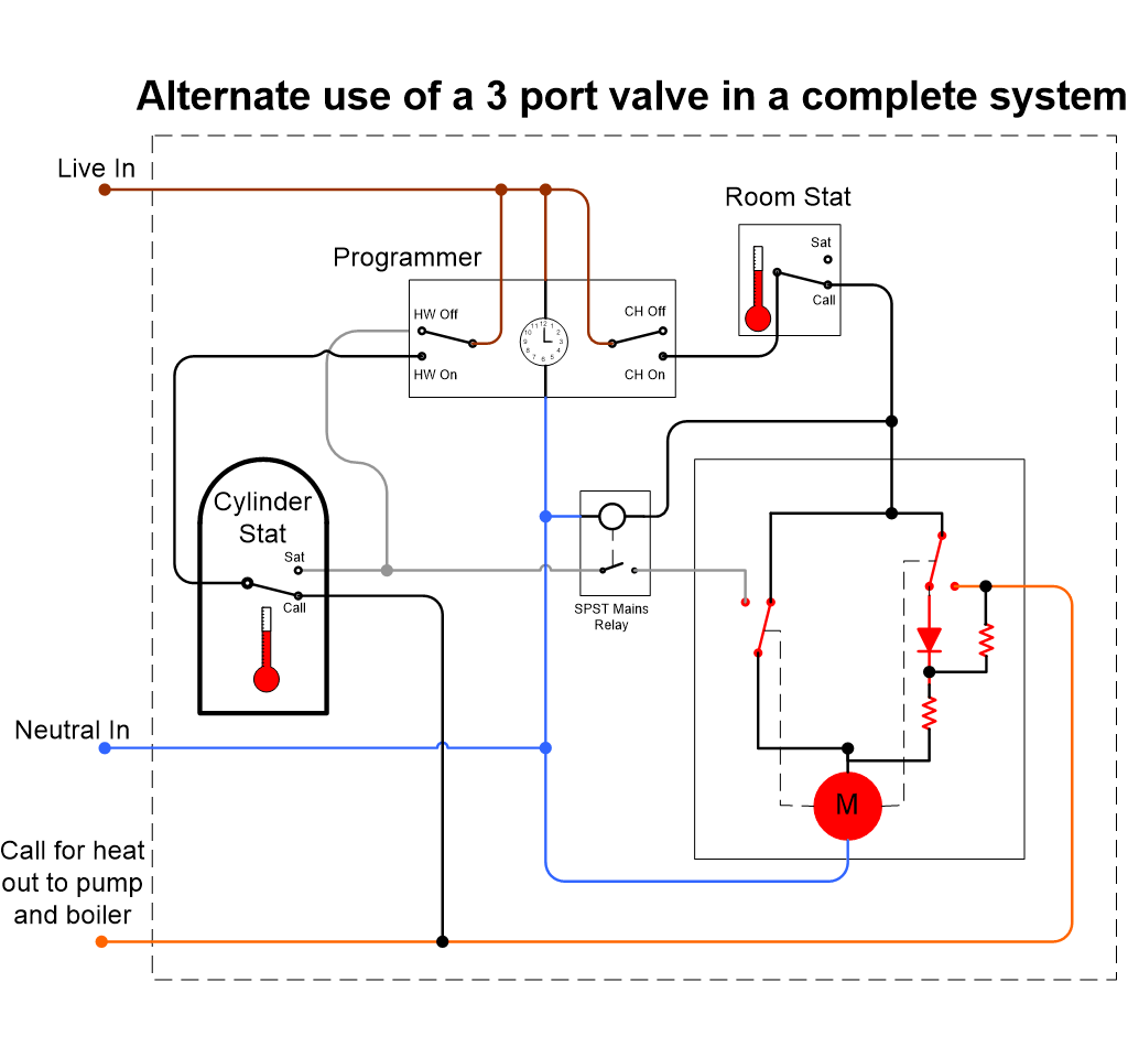

OwenF Posted January 26 Share Posted January 26 I’m struggling to wrap my head around the perceived issue, but initial thoughts are that CH for ‘at rest’ position generally is not desirable as it doesn’t allow the pump to overrun in event all TRVs close (assuming no automatic bypass). I switched my 3-port valve, but that was to retrofit PDHW using a relay demand box. This has same outcome of having CH on the NO side of the valve. I had two non-TRV towel rails to ensure path for pump overrun. Link to comment Share on other sites More sharing options...
marshian Posted January 26 Author Share Posted January 26 1 hour ago, OwenF said: I’m struggling to wrap my head around the perceived issue, but initial thoughts are that CH for ‘at rest’ position generally is not desirable as it doesn’t allow the pump to overrun in event all TRVs close (assuming no automatic bypass). I switched my 3-port valve, but that was to retrofit PDHW using a relay demand box. This has same outcome of having CH on the NO side of the valve. I had two non-TRV towel rails to ensure path for pump overrun. The issue is I think my heat losses from the HW tank are a bit high and I'd like to lower the losses. My thoughts are that having HW to NO is allowing the HW circuit to steal heat (via the coil) to the circuit thereby increasing my tank losses I have Automatic bypass because all Rads are on TRV's DHWP is NO to CH and that's the system I will go to when I replace the boiler in the summer I'll let the 3 port stay at CH for a few days and see if that changes the HW heat losses Link to comment Share on other sites More sharing options...

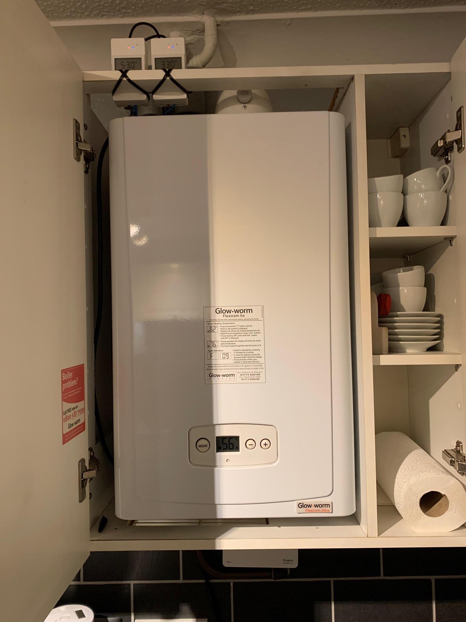

SimonD Posted January 26 Share Posted January 26 5 hours ago, marshian said: I am going Viessmann but it will be 100-W at 50/30 flow and return it's 3.2 kW I don't want a system boiler (or a combi) - I want a heat only with the outlets for Flow and return on the top of the boiler because that's where my pipework is routed thro the kitchen ceiling void If you go for the heat only 100-W you lose the built in PDHW capability that comes with the system version which supports a 4 pipe installation and weather comp., plus it has better connected functionality out of the box. That way you also get the full benefit of the modulating pump working with the boiler where you wouldn't get that with the heat only. A small bit of extra pipework is a small price to pay for the long-term benefits. Link to comment Share on other sites More sharing options...
marshian Posted January 26 Author Share Posted January 26 29 minutes ago, SimonD said: If you go for the heat only 100-W you lose the built in PDHW capability that comes with the system version which supports a 4 pipe installation and weather comp., plus it has better connected functionality out of the box. That way you also get the full benefit of the modulating pump working with the boiler where you wouldn't get that with the heat only. A small bit of extra pipework is a small price to pay for the long-term benefits. The pipework I can cope with - However it's depth exceeds a std 300mm wall cupboard which means it's going to need to be on show - imagine if you can a line of lets say black wall units broken by a bright white boiler.......... I can live with that - SWMBO can't - life is full of compromises I know when I can win this isn't one of those times Link to comment Share on other sites More sharing options...

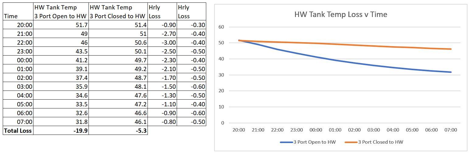

marshian Posted January 28 Author Share Posted January 28 I think I've answered my own question Last two nights tank has been heated to 51 Deg (this is the lowest the tank stat will accomodate) Note - I normally only heat to 45 deg (To minimise losses) and do it based on a timed cycle with a set boiler flow temp (30 mins and 68 deg Flow normally sees it settle at 44-46 which is spot on) Attached is the Tank Temps by Hour and Losses By hour over the two nights and a graph showing the difference It's pretty clear to me with the 3 port valve open to the boiler (AK at rest) I lose temp from the tank far faster than with the 3 port valve closed to HW and open to CH Link to comment Share on other sites More sharing options...
TonyT Posted January 28 Share Posted January 28 Can the boiler not go in the loft? or above the cylinder with vertical flue? 1 Link to comment Share on other sites More sharing options...
marshian Posted January 28 Author Share Posted January 28 2 hours ago, TonyT said: Can the boiler not go in the loft? or above the cylinder with vertical flue? Good question - really good question....... I'd need a 5m extension to the gas supply and that would have to be run externally (not so keen on that) or internally in a boxed section thro kitchen and bedroom above - boiler is currently right above the gas meter box so the supply is just 15mm and less than 1m. I guess if you increase the length of the supply pipe you'd need to increase the pipe size but I've no idea what any of that would cost? I'd have to brick up the existing flue inside and out but that's not a deal breaker as I already had to brick up the bloody great hole the original non condescending boiler flue left when I last changed the boiler in 2009 I'd need to have the flow and return pipes changed to suit the new boiler location but if I've got to run a gas pipe up inside the house in a boxed section I can run the flow and return back down the same or re-route and go straight to the airing cupboard where the tank is. The question is do I want a boiler in the loft in order to gain a single cupboard space in the kitchen - I'm also pretty sure I'd need to move the cold water store and header tank as I don't really want a system boiler - Do I want a gas engineer to have to go into the loft every year when it needs a service and safety check as opposed to just having to grant access to the kitchen. I think a few houses around mine have done it so it's an option for sure Airing cupboard unfortunately is quite restrictive size wise and having boiler above the tank might be a pain for servicing - SWMBO definitely wouldn't be happy losing her towel warming area (despite the fact I've never had a warm towel from the cupboard ever!!! She'd also whinge at the loss of her summer/autumn/winter duvet storage (in vacuum bags to get them into the space) I could suggest we store them in the additional kitchen cupboard - that would be a fun conversation The loft is certainly something to consider....... Link to comment Share on other sites More sharing options...
TonyT Posted January 28 Share Posted January 28 When I’m talking about loft, I also mean floored, lighting, safe working space not standing on trusses servicing boiler. pipe boxes can easily, be made, painted to blend in. not sure about gas pipes running inside, but you could run one parallel with a rainwater down pipe Link to comment Share on other sites More sharing options...
TonyT Posted January 28 Share Posted January 28 You probably get more saving swapping the pump for a more energy efficient model, wrap some extra insulation around the cylinder too Link to comment Share on other sites More sharing options...
SimonD Posted January 28 Share Posted January 28 1 hour ago, marshian said: The loft is certainly something to consider....... 18 minutes ago, TonyT said: When I’m talking about loft, I also mean floored, lighting, safe working space not standing on trusses servicing boiler. Link to comment Share on other sites More sharing options...
marshian Posted January 28 Author Share Posted January 28 2 hours ago, SimonD said: A comprehensive destruction of the loft advantage Link to comment Share on other sites More sharing options...

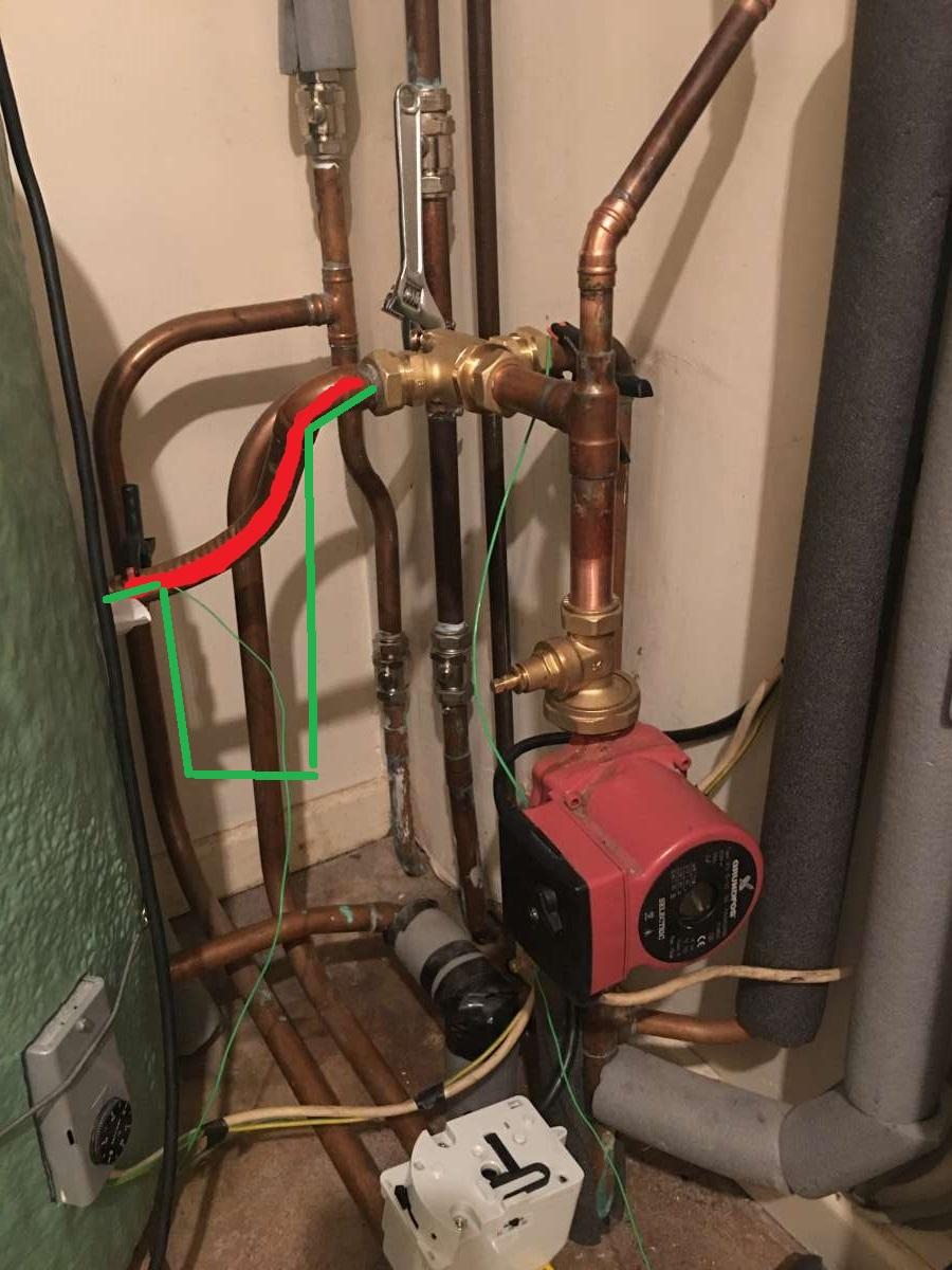

JohnMo Posted January 28 Share Posted January 28 On 25/01/2024 at 16:29, marshian said: Rather than continue to threadjack another post System info Y plan system Vented cylinder 112 Litres (Installed 2011 from memory) Insulation on all the pipes around the tank - extending to loft and in loft to header tanks. I still think my losses are too high 0.5-0.7 deg per hour Lagging is good quality Turbolit (a considerable improvement on std DIY stuff - albeit that was better than bare copper pipes) 22mm copper pipes have 9.5 mm wall insulation 15mm copper have 12.5 mm insulation I use a pipe lager pro mitre box to get neat joints and most are glued But I think I might have a reason but I'd like an opinion on it My three port valve is at rest on HW and powered to mid position or CH At the end of every CH cycle the time runs the HW for a min to reset the valve to rest (if left in HW the motor body gets warm - warm = electricity - constant running = wear and tear on the valve head) Hot moves to cold - water in the coil is heated back by the hot in the tank and convection currents move the water/heat back to the boiler - if I swapped the 3 port valve round (and the wiring) I could make the CH position the rest and it would block any flow back to the boiler - however the other end of the coil would still be connected to the boiler by the return pipe?? Just looking at the photo, your issue could be the vertical section of pipe from the cylinder coil to the 3 port valve. Very likely you have a nice internal current in that pipe. Ideal would be to take the pipe down 150mm then up to the valve. That would eliminate any likelihood of a thermosyphon. Link to comment Share on other sites More sharing options...
marshian Posted January 28 Author Share Posted January 28 20 minutes ago, JohnMo said: Just looking at the photo, your issue could be the vertical section of pipe from the cylinder coil to the 3 port valve. Very likely you have a nice internal current in that pipe. Ideal would be to take the pipe down 150mm then up to the valve. That would eliminate any likelihood of a thermosyphon. Very interesting - thanks for that observation Link to comment Share on other sites More sharing options...

marshian Posted January 29 Author Share Posted January 29 15 hours ago, JohnMo said: Just looking at the photo, your issue could be the vertical section of pipe from the cylinder coil to the 3 port valve. Very likely you have a nice internal current in that pipe. Ideal would be to take the pipe down 150mm then up to the valve. That would eliminate any likelihood of a thermosyphon. Just to make sure I've highlighted the section in red on an old picture before I insulated it all and added the proposed amendment in green (Distance not to scale) Link to comment Share on other sites More sharing options...
JohnMo Posted January 29 Share Posted January 29 32 minutes ago, marshian said: Just to make sure I've highlighted the section in red on an old picture before I insulated it all and added the proposed amendment in green (Distance not to scale) That's the idea. Link to comment Share on other sites More sharing options...
