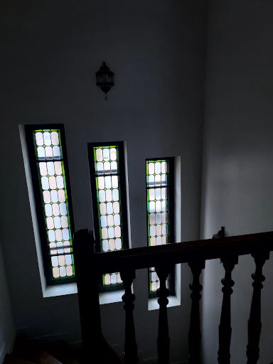

Garald Posted January 23 Share Posted January 23 (edited) 1 hour ago, Mike said: Yes historic glass is certainly worth keeping if you can. Sounds like adding a secondary window (double fenêtre) might be worth considering, even if only in certain rooms. Yes, did that with stained glass. The secondary windows (on the outside) are really not great, though (just a couple of degrees warmer than the outside) - I wasn't keeping tabs on every single detail at that point. Still, it helps. Outside temperature = - 2C. Of course, because of the secondary windows, the stained glass is now less visible from the outside. Edited January 23 by Garald Link to comment Share on other sites More sharing options...

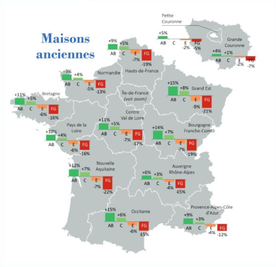

Mike Posted January 23 Share Posted January 23 42 minutes ago, Garald said: losing m^2 means losing property value However, in France, having a higher DPE increases the property value, so there may be a gain rather than a loss. 30 minutes ago, Garald said: Used BioFib Trio I'm using the same - it seems good stuff. Link to comment Share on other sites More sharing options...
Garald Posted January 23 Share Posted January 23 1 minute ago, Mike said: However, in France, having a higher DPE increases the property value, so there may be a gain rather than a loss. Well, obviously. Prices (particularly in the Paris area) do not yet reflect DPEs enough, but that ought to gradually change as people realize how much it costs to raise a DPE even by one single grade. The point is that you want to lose as few m^2 as possible for a given insulation performance. 1 minute ago, Mike said: I'm using the same - it seems good stuff. Right - similar performance to rock wool, fully "natural" (whether rock wool really poses any sort of danger or not is up for debate - no doubt it's a lot better than fiberglass, and any fibrous material, natural or not, poses *some* risk if not properly sealed - but better safe than sorry), moderate cost. The only downside I can see is its fire rating of F. I guess it's fine behind fireproof plasterboard? Good sound absorber too (so is rockwool), for what that's worth. Link to comment Share on other sites More sharing options...
Garald Posted January 23 Share Posted January 23 (edited) PS. If you look at the thermal-camera picture of the stained glass closely, you will see some sort of frame within the wall. That's one of the walls where I have 5cm of BioFib + reflective insulation (which comes with its own insulating backing). As you can see, it works well enough (surprisingly so given @SteamyTea's experiments), but you do see the metal grid there, whereas I don't think I ever spotted it in the thermal-camera pictures of the walls where I have a thick layer of BioFib. Not sure how to interpret that. Edited January 23 by Garald Link to comment Share on other sites More sharing options...
Mike Posted January 23 Share Posted January 23 33 minutes ago, Garald said: Prices (particularly in the Paris area) do not yet reflect DPEs enough Just checked and the price variance in Paris is fairly modest compared to other regions. For those in the UK, where the EPC rating still seems to be a minor factor, here's a map from the Notaires de France showing the difference the rating made to 2022 sales prices in France: 47 minutes ago, Garald said: BioFib Trio... ...I guess it's fine behind fireproof plasterboard? AFAIK it's fine behind any plasterboard, though I am using fireproof board throughout (GypsoLignum / GypsoOmnia) - for its other properties, rather than as a fire board. 1 Link to comment Share on other sites More sharing options...
